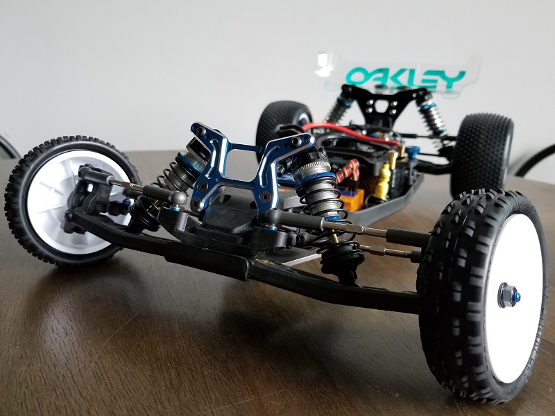

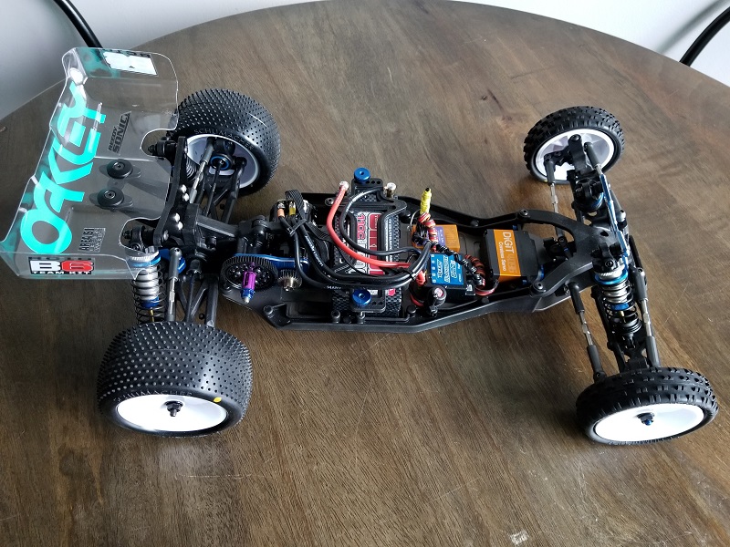

Well here it is. Built for turf, so laydown conversion, exotek slipper eliminator, VRP aluminum front shock tower, 30g brass front arm mount and narrow front wheels. Oakley decal for Vintage touch. Noticed I used short shock eyelets on front shocks and set up called for long but seems local guys going for low as can be do that anyways in some cases so I will see when I get it on track.

Does the new B6 not use e-clips anymore?
Also why are there two size rear and front wheels now? I saw 61mm rear which is bigger than the 2.2” right? I get the thin front wheels for carpet racing.
Also for official racing 2W buggies, does everyone have to have the same turn engines? Same size tires? How does that work?

There are no e-clips. Suspension pins are held in by retaining screws. My track does not regulate 2.2 vs. 2.4 tires just motors by class. In my pic I have narrow wheels with normal size width front tires on them, they look odd when you glue them but work. I believe Schumacher and others now are even making a specific narrow tire for the slimmer front wheels.

I also noticed you don’t have all your tie rods in the same direction?
