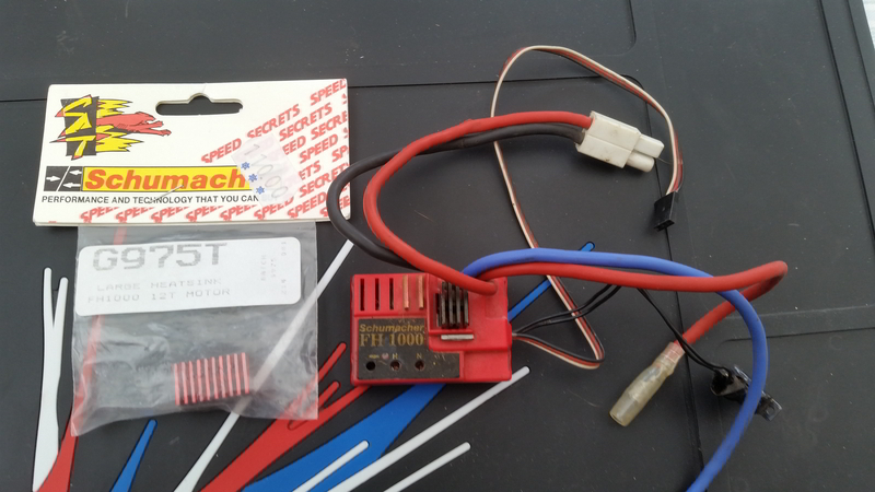

I decided to build the car with a brushed motor and wanted to keep the car as Schumacher as possible including the electrics. I have found an FH1000 esc and a few choices of Schumacher motor to power it and to future proof the car it needed a slipper clutch so I ordered a cougar 2 works transmission for parts.

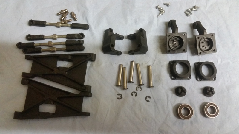

losiXXXman wrote: Fri Jan 20, 2017 10:38 pmThis may be off topic, but do the front axle carriers/ steering blocks only house one bearing per side? I was looking at a scan of the cougar manual a few weeks back and thats what it looked like.
Yes, the standard Top Cat / Cougar / Cougar2 / Club 10 / Shotgun / Storm / Nitro 10 vehicles all had single bearing hubs as standard. A twin bearing upgrade was available, though.... just bought a few packets a few weeks ago!

My favorite cars are Schumachers which works out well in the Uk. If you can stomach paying the postage the Cougar mk1, 2 and club 10 have come up quite regularly on ebay uk since I've been looking these last few months.
I have the single bearing hubs at the moment. But would like the upgrade to dual, the wheels are designed for 4wd which use dual in the hubs. I have had to cut the inside of the wheel down a bit to stop them rubing the hub carrier time will tell jf I have weakened them to much :? I guess the dual bearing hubs would look similar to the 4wd one on my Procat and not foul in the same way? Could you tell the part number so I can look out for them?

CVRrc wrote: Sat Jan 21, 2017 8:01 amI have the single bearing hubs at the moment. But would like the upgrade to dual, the wheels are designed for 4wd which use dual in the hubs. I have had to cut the inside of the wheel down a bit to stop them rubing the hub carrier time will tell jf I have weakened them to much :? I guess the dual bearing hubs would look similar to the 4wd one on my Procat and not foul in the same way? Could you tell the part number so I can look out for them?
Here you go mate, part number U815K:
Pretty much the same as the single bearing hub, to look at....

Thanks Alex. Looks like I would have to do the same wheel trimming but the extra bearing definitely looks worth while. The hunt begins.
