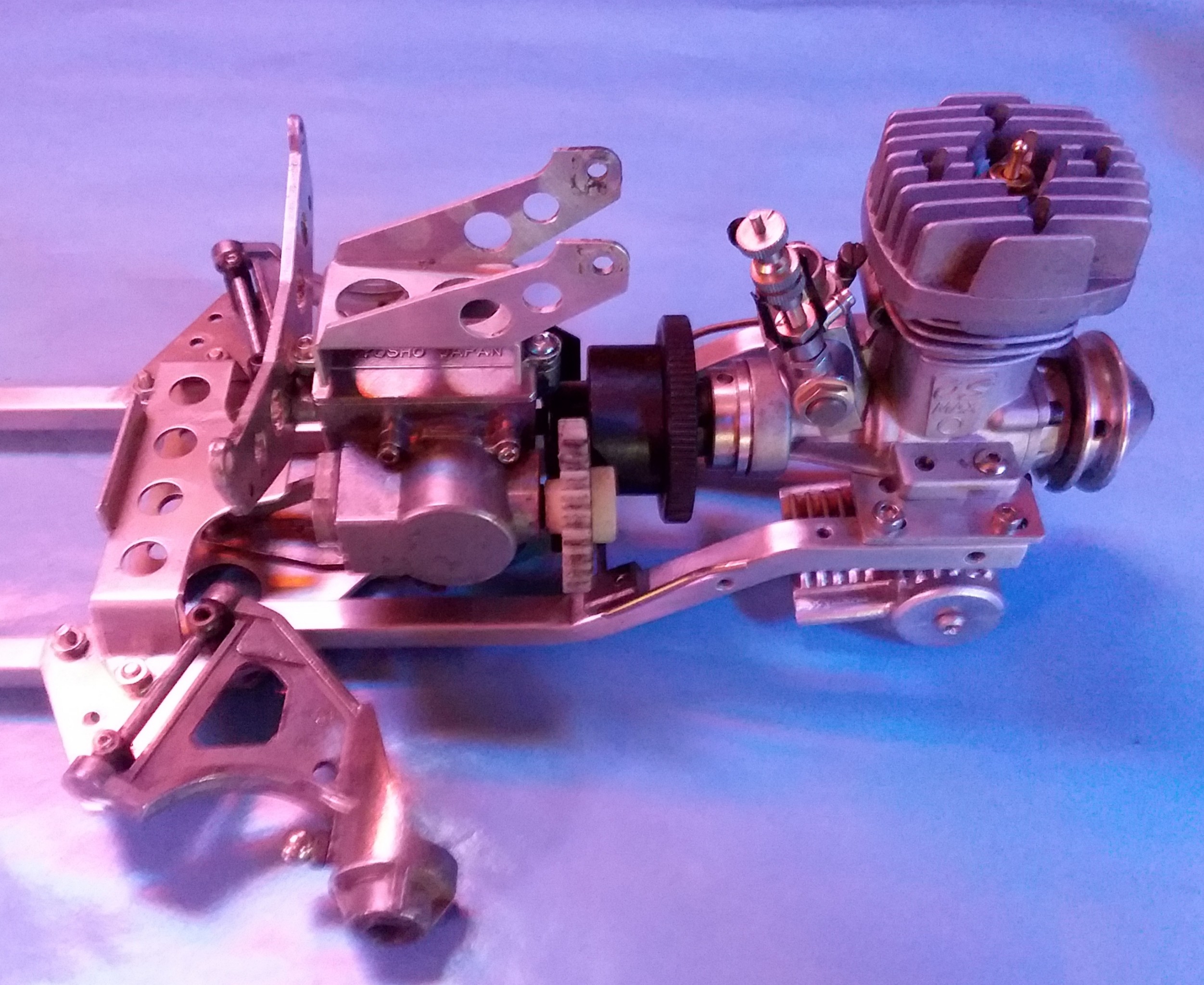

Re: Kyosho Assault Box Art Restoration
Test fitting the engine. This is actually the engine from the other car, waitn on a clutchbell for the engine for this
New engine i will use on left, after i put the crankshaft and cone starter from original engine on right
Top used crank has tit for starter i need
There it is all done with cars original crank
