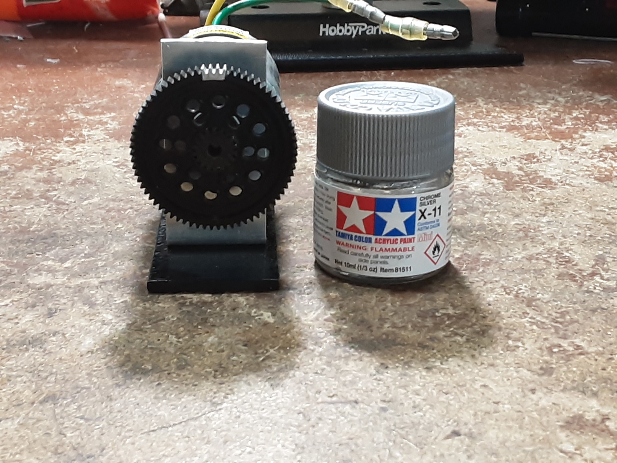

Re: Thinking about dyno's for brushed motors
I've read that reflective paint will work instead of the tape. So I'm going to give this Tamiya X-11 chrome silver a try. I'll use the tape if necessary but would rather not.
You tryin to one up us? .....we'll u did! Nice!
Looked up a you tube review and one guy tried different reflective materials and even blue paint worked ! Seems they also run up to 99,999 rpm reliably !

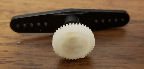

Now it's my turn to share how I'm building my motor dyno. A little late to the party, but I got to borrow from some of your guys' great ideas.

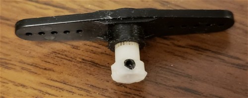

The trickiest part is finding a way to attach something to the motor shaft. I originally was thinking to use a spare motor pinion gear and somehow affix it to the shaft, and possibly a spare larger gear, but the idea of using a servo horn instead kept getting in the way of those intentions. Sticking a gear inside a spur gear would involve some kind of chopping and gluing. I opened up a beat-up old Futaba servo and found this white gear inside, it already has the splines for a large servo horn. I drilled a 3mm hole through the center and it snugly fit on the motor shaft.
The horn fits super-snug onto the splines, there's no way it'll ever slip. I actually need to put it in a vise to carefully pull it off once it's pressed all the way on. That's fine though because once it's on, it doesn't need to be removed.

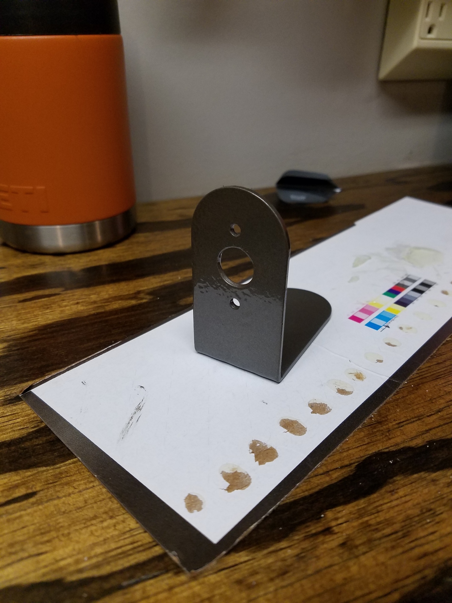

Looking at the gear, I saw that the shoulder was thick and beefy enough for me to drill and tap a 3mm hole to install a grub screw. I cut down the rest of the outer part of the gear as it's not needed. I originally fabricated a motor mount from steel, but I found that the motor magnets, especially with the stronger motors, were significantly affected by the steel in the mount. I have a good feeling that would negatively affect motor RPM. So, if you're making your own dyno, use aluminum or plastic or some other non-magnetic material. I decided to use 2.5mm Kydex. I gave it the 90-degree bend by putting it in a vise and heating the area to be bent with a heat gun.

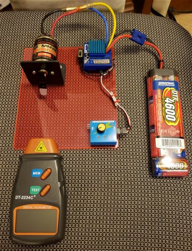

Next to do was the base plate. I didn't want to use up more of my Kydex sheet, and I thought wood would be too bulky. I have tons of this fancy acrylic sheet from my years doing computer case modding, so out came the Dremel and I chopped off a section of red UV-reactive acrylic. I don't intend to make it glow but it looks cool and it's lightweight and easy to work with, and I might as well use something that costs me nothing. I gave myself room to add the other dyno components, that's the next part of the project.
Here's the dyno station complete, I took a short video showing how it works...I just wanted to make sure it was functional and used a 360 Gold motor and a half-discharged 8.4V NiMH battery that was sitting in storage. All my LiPos are currently in storage mode so I'll need to charge one up and do some proper testing.

I originally did the same, fab'd a motor mount out of 14 gauge steel today. I have some aluminum of the same thickness so I'll fab an identical bracket out of it. Now, for sh*ts and giggles, I'll test using both and see how much the steel bracket affects performance.Coelacanth wrote: ↑Sun Feb 21, 2021 6:52 pm I originally fabricated a motor mount from steel, but I found that the motor magnets, especially with the stronger motors, were significantly affected by the steel in the mount. I have a good feeling that would negatively affect motor RPM. So, if you're making your own dyno, use aluminum or plastic or some other non-magnetic material. I decided to use 2.5mm Kydex. I gave it the 90-degree bend by putting it in a vise and heating the area to be bent with a heat gun.

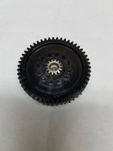

I borrowed juicedcoupe's pinion/spur combo idea. Drilled the center of the spur so the pinion fit tightly into it. Then tightened it onto an 1/8" drill bit and spun the drill full speed to make sure the spur was sitting true on the pinion. Then filled the small voids of the pinion teeth with epoxy.

I think your steel mount might work better than mine did, as the motor would be mounted a fair distance above the horizontal foot of the mount. My initial design had the motor positioned only 1/4" or so from the horizontal foot of the mount. I could definitely feel the motor pulling into the foot while I tried screwing on the motor. I don't think the magnetic attraction of the vertical motor mounting part would affect performance much. Nice job epoxying on the spur gear, I considered that option too.R6cowboy wrote: ↑Sun Feb 21, 2021 9:54 pm I originally did the same, fab'd a motor mount out of 14 gauge steel today. I have some aluminum of the same thickness so I'll fab an identical bracket out of it. Now, for sh*ts and giggles, I'll test using both and see how much the steel bracket affects performance.
I kept some space open on my red base to mount an additional brushless ESC, so I can easily test both brushed or brushless motors.
