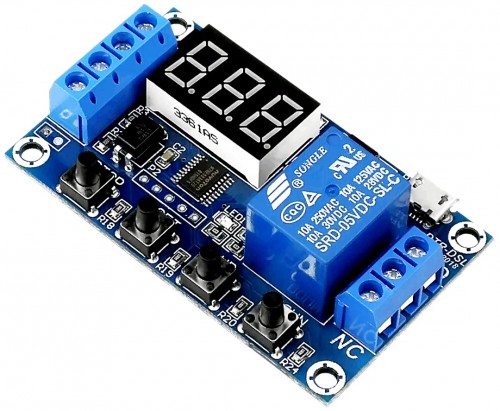

Scored this mini timer for 8 bucks...gone use it to time the parachute deployment so I can concentrate on the wheel only keeping it going straight....once I kit the rocket igniters, the timer will start counting and hit the shoot depending on how long I want it to delay

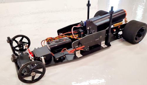

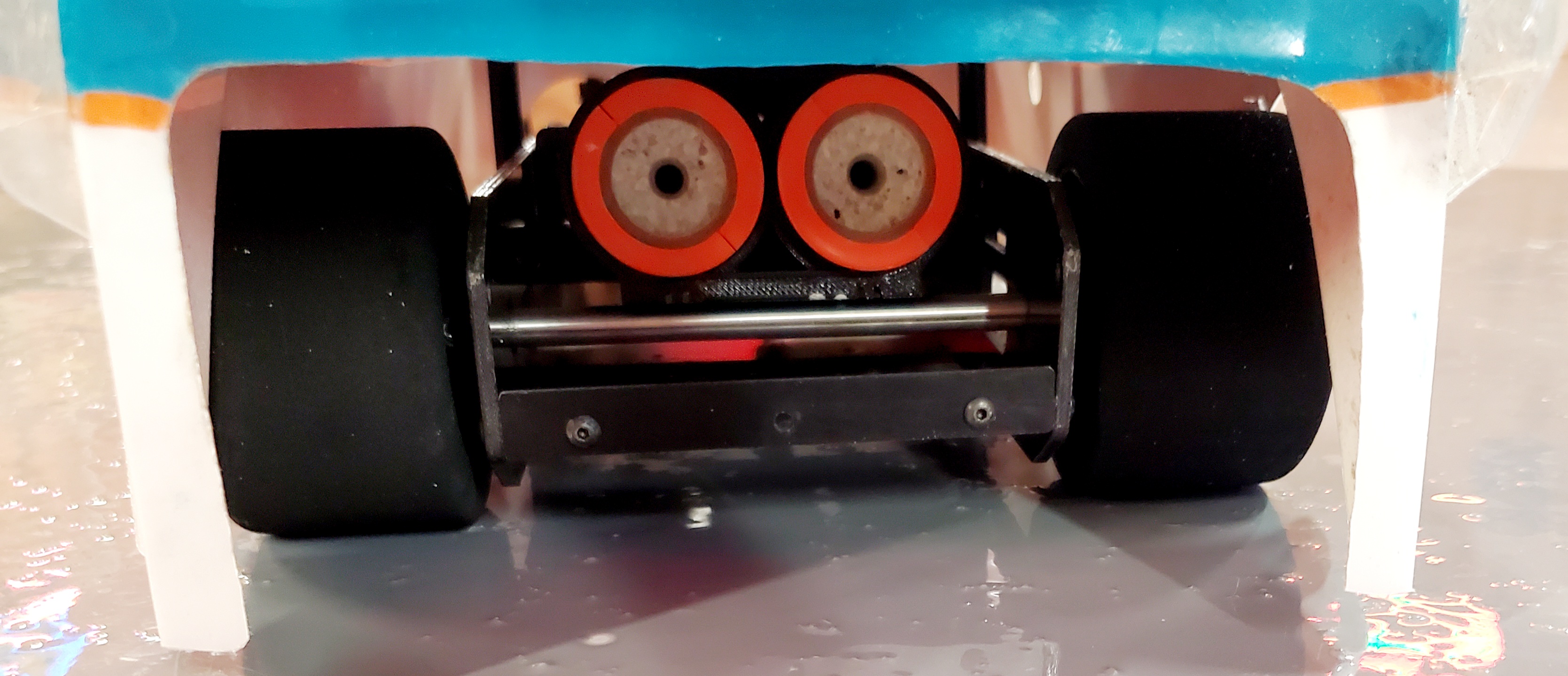

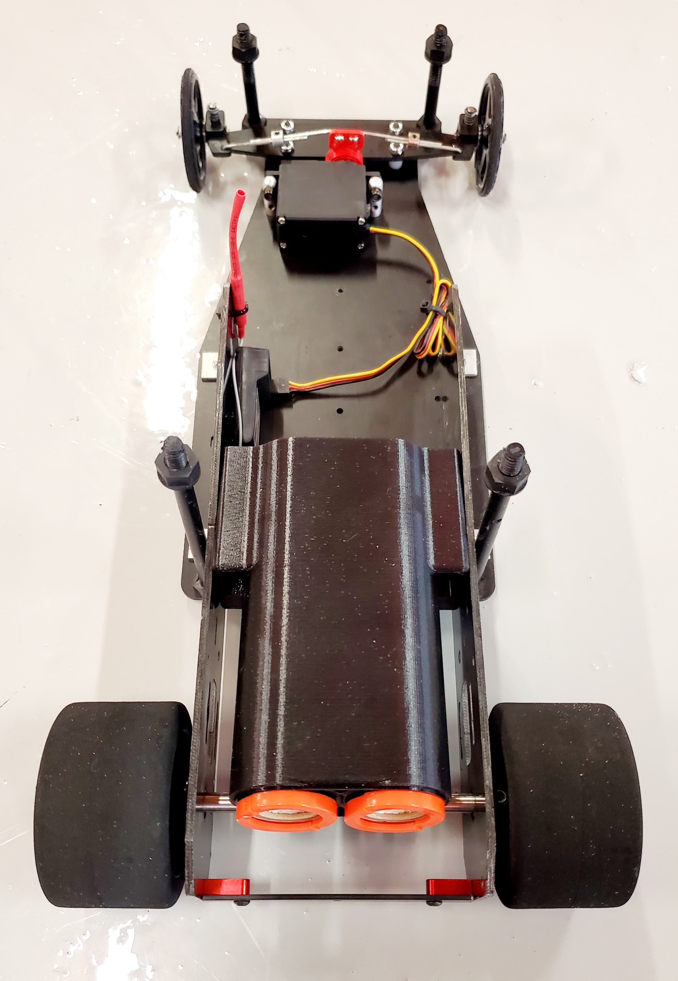

Made some decent headway....mounted the rockets furthback like recommended...so they won't overheat the axle
That's an airplane receiver, I don't want to loose signal!
Modified the old Pro Mod body for now, had to lengthen rear wheel opening 1.5 inches back.... it isn't the final body, just something I can test run to see if the car will at least work
Car weighs 806grams way it sets, totally done it will be around 2lbs
Looks like I will have to run heat protection in the back of the body

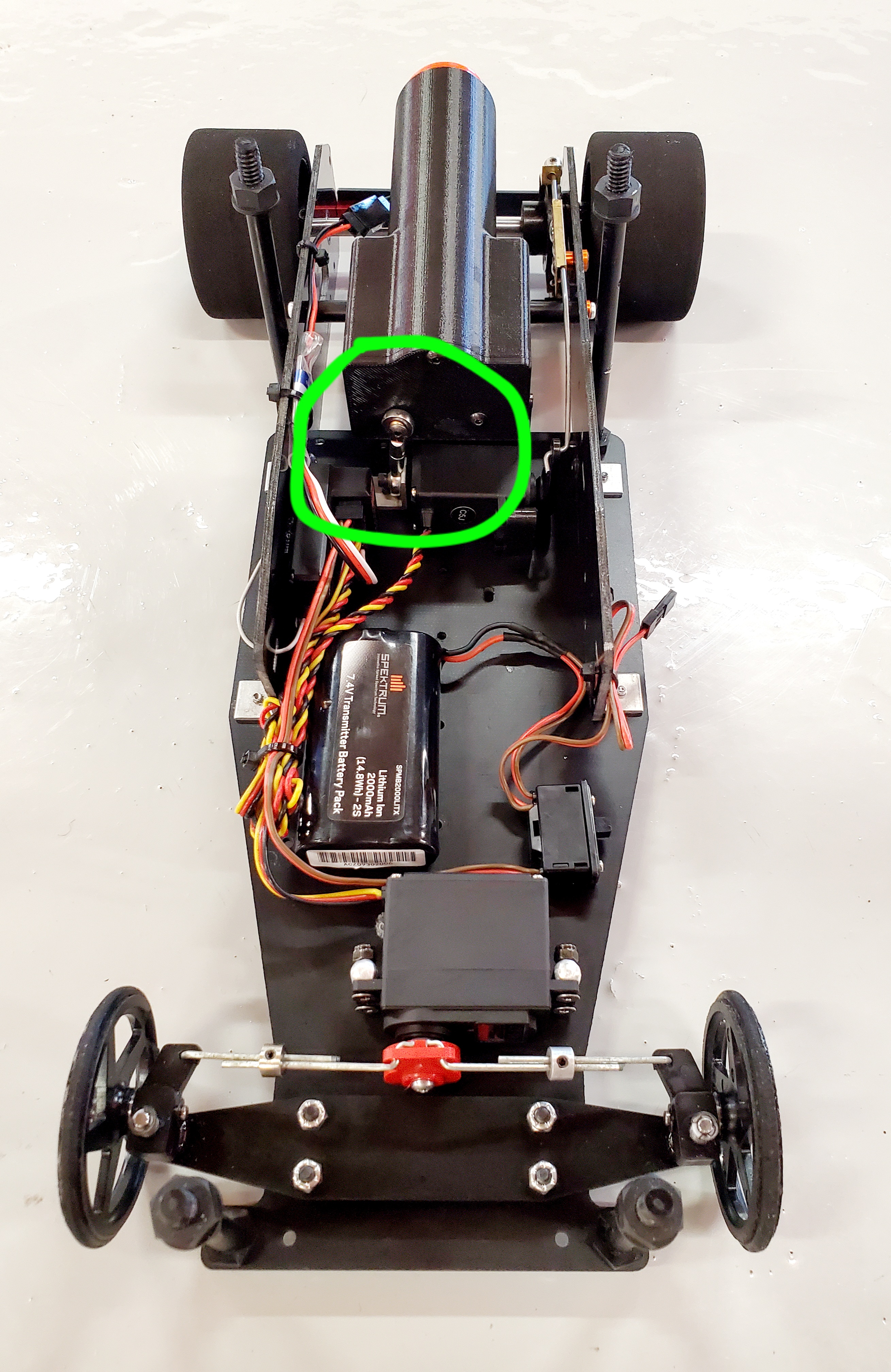

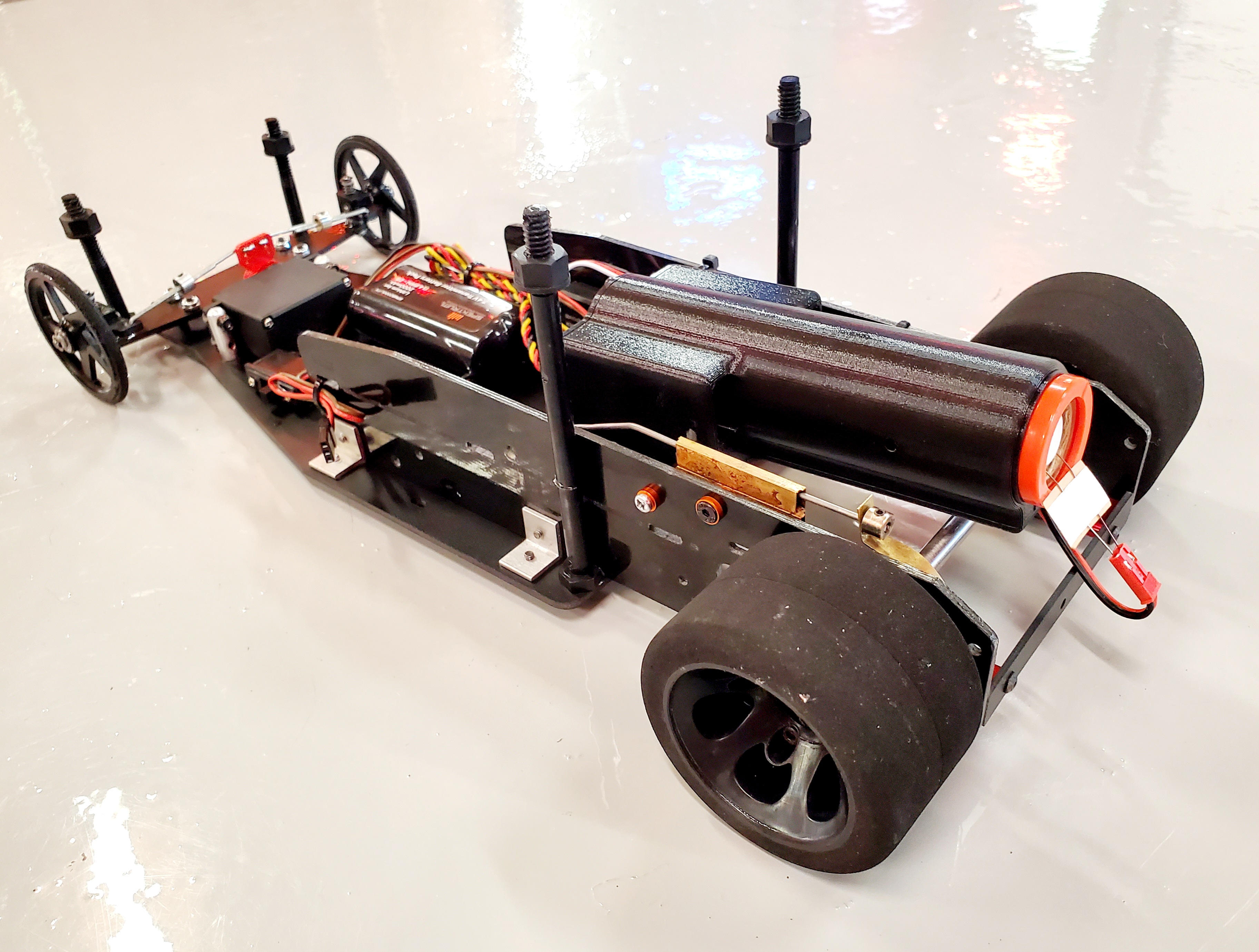

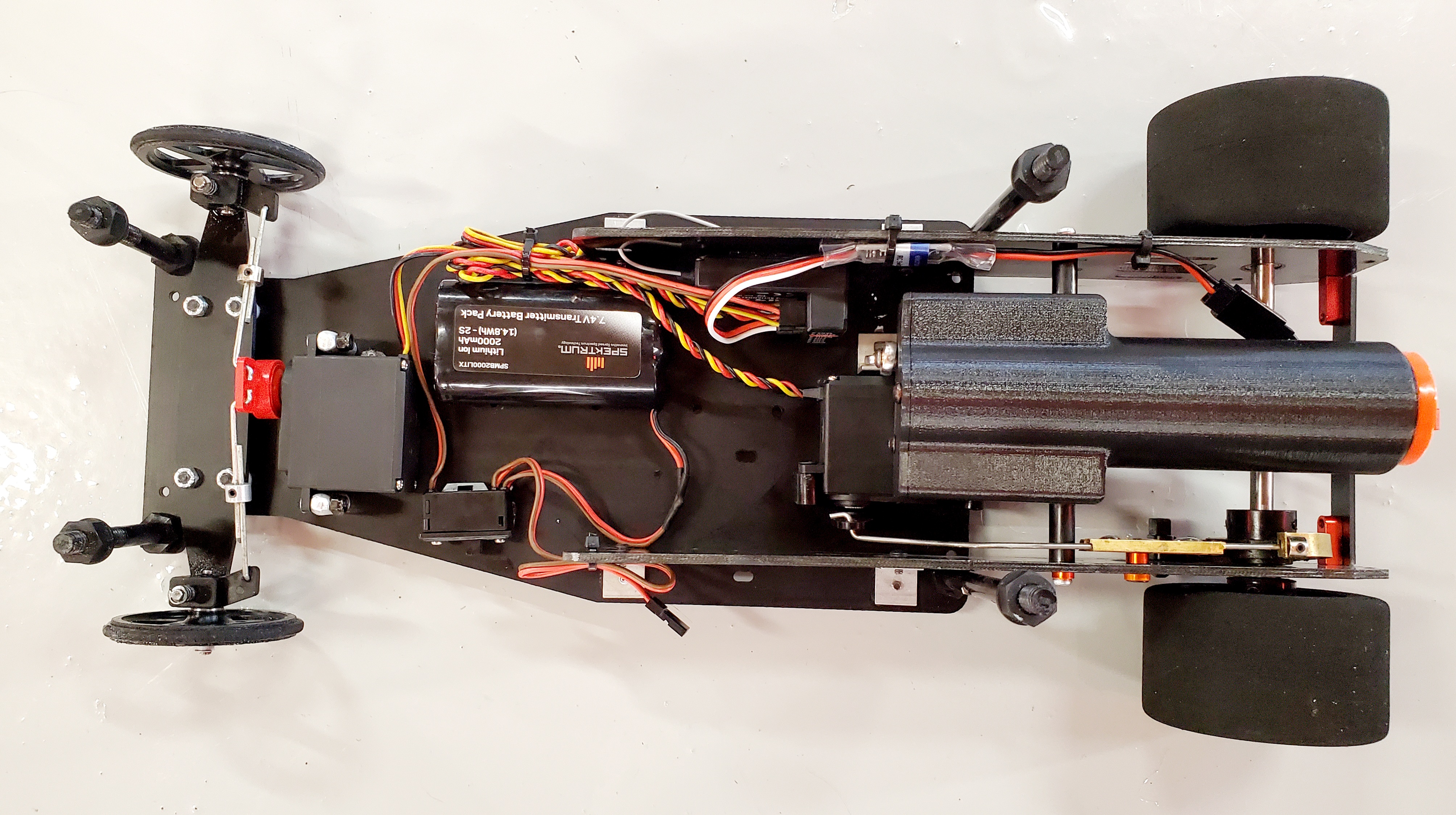

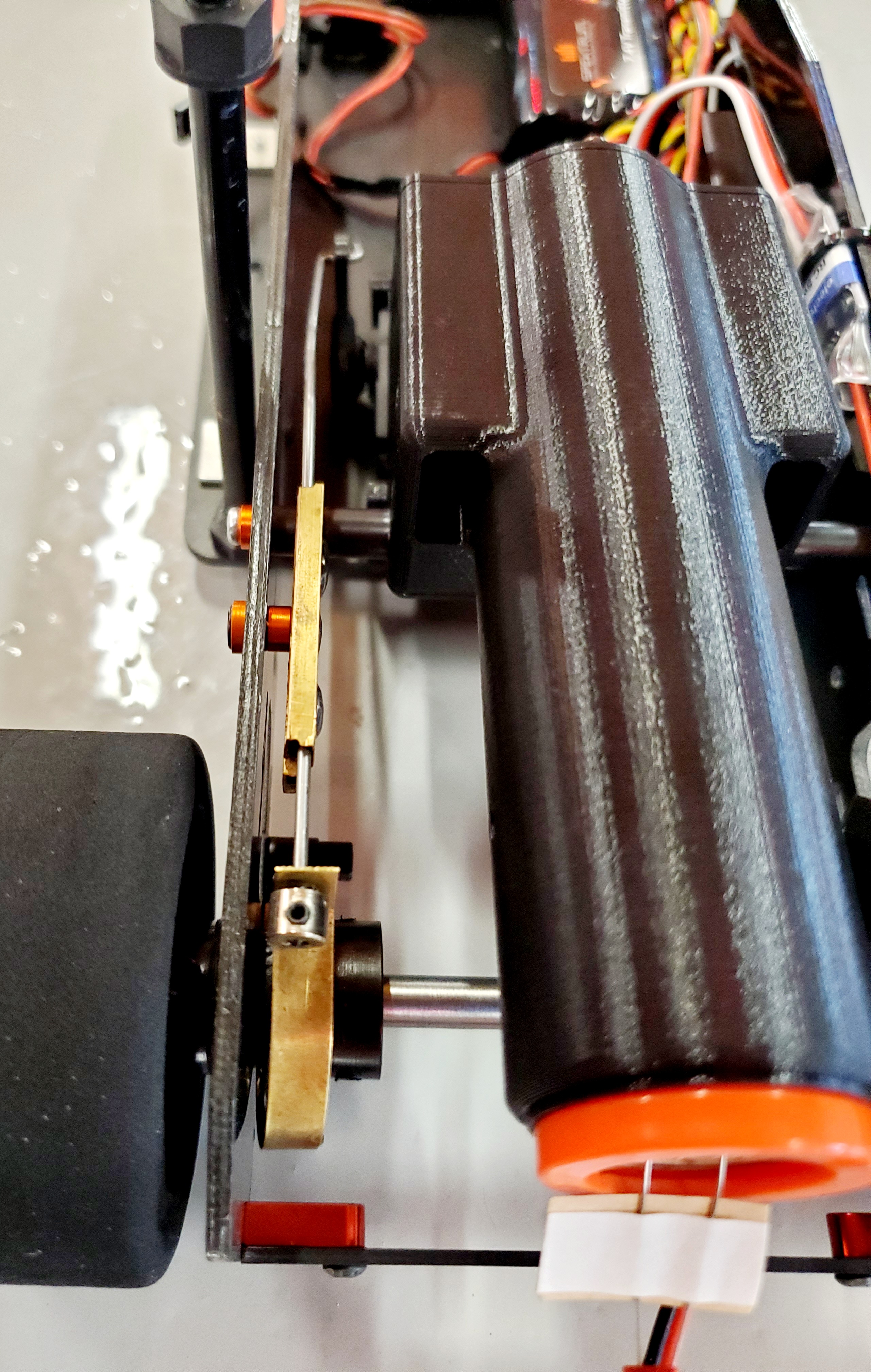

Got the car all done except the parachute system, chute timer, body....everything has been tested and works...including the rocket igniter from the transmitter...weighs 2.01lbs with ProMod body on it...I converted to single engine for now, will work my way up to the duals...this is serious stuff...I put an "old school" brake system on it, works perfect!...also made the engine mount angle adjustible at the front
adjustible engine mount
Brakes!
