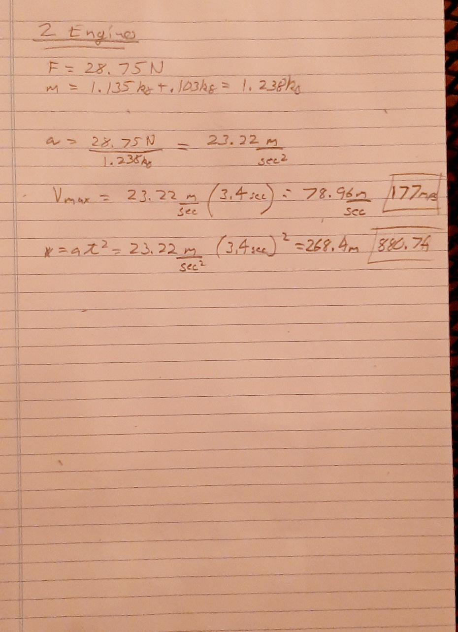

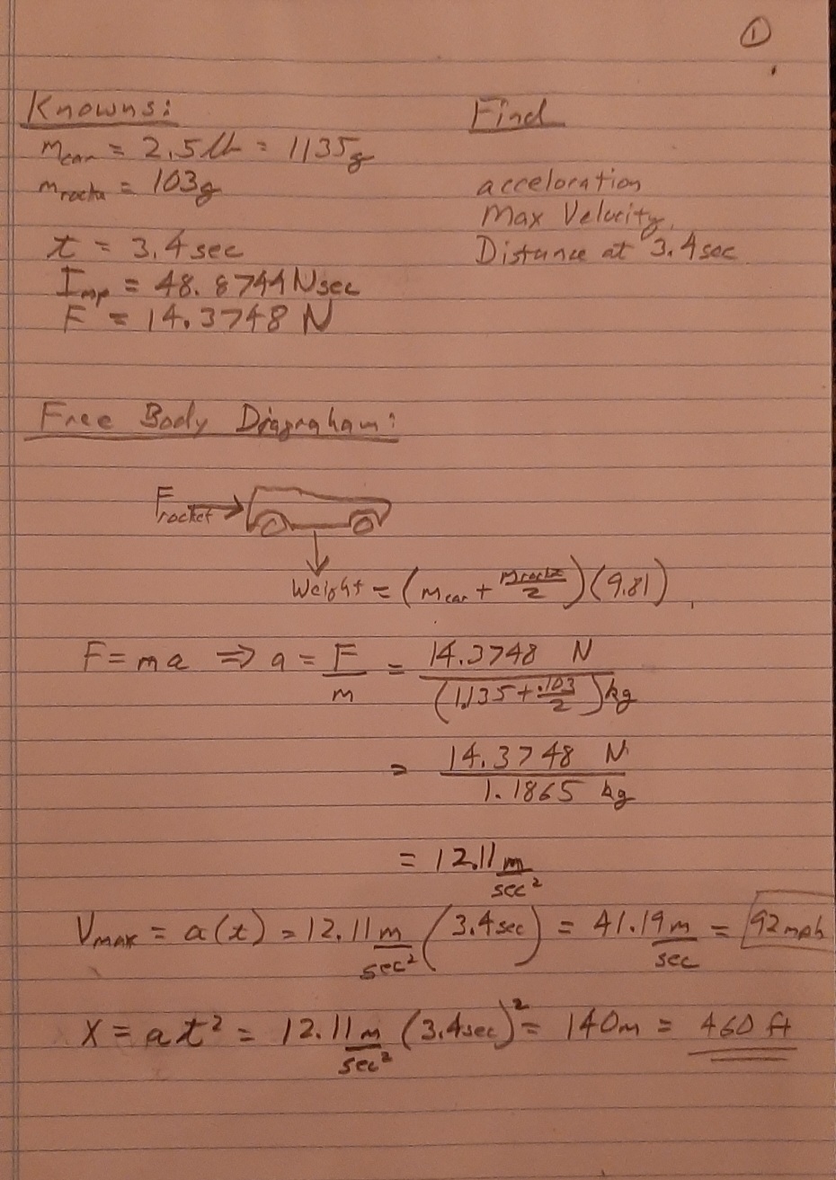

The entry in Build of the Month has striked my interest on a new build...using some vintage Bolink/and RJ Speed parts I am going to build a rocket car that will look authentic, be purely ran by the rocket engine/engines....and hopefully run 100mph in 3.5 seconds from a standing start(on video)...stopped by a parachute...I have the rocket engine mounts coming...I haven't build the car yet...and here are some figures from an engineering friend of mine...this project will take some time...the Diamond 💎 One will be doing a very stylish 70s body/paint...this project is all I think about all day while at work

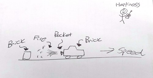

I blame RC10 for his BOTM entry and the rocket documentary they watched recently for this development. Should be interesting though. 🤔 That guy's math is way off by my calculations though...

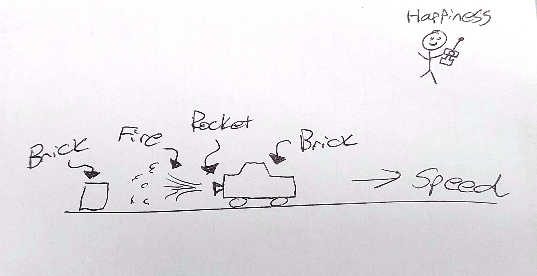

I'm glad I could provide some form of inspiration :lol:
My plan was slightly less elaborate

Had to look twice as I thought that was a bottle of alcohol in the drawings hand not a transmitter😂…. Either way good plan to = happiness

Those calculations above were for Estes "F" engines...I am gonna start with 2 "D" engines if it will fit that burn for 1.7 seconds instead of the 3.5 seconds of the powerful F engines...177mph just seems like too much! 😆

RC10th wrote: Fri Apr 14, 2023 3:23 am I'm glad I could provide some form of inspiration :lol:
Brick, fire, rocket, BRICK !! Absolutely hilarious :lol:
Too funny I actually laughed out loud when I seen and read it.

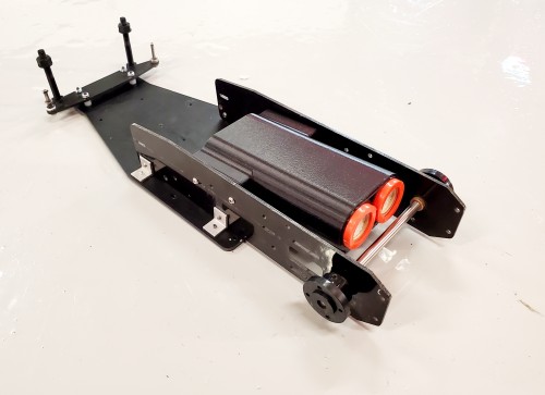

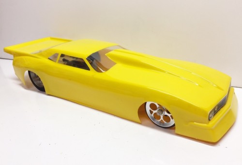

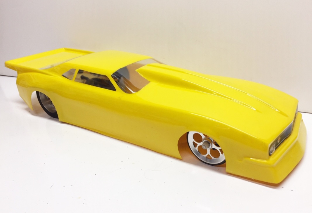

Small update...Chassis has been picked...converting an old RJ Speed Nitro Pro Mod ...body has been bought..67' Camaro...2 sets of of rocket engines (D and F) on the way....2 engine mounts have been purchased...one single, one dual...both mounts will hold F and D engines with reducers...just gathering parts for the build

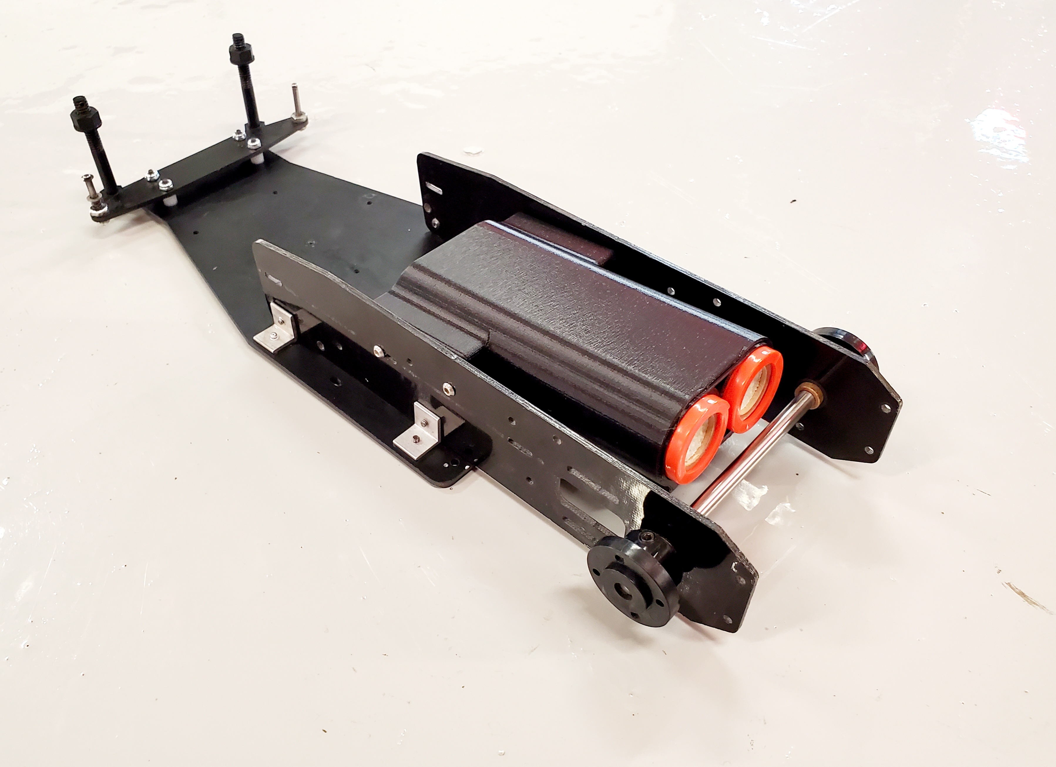

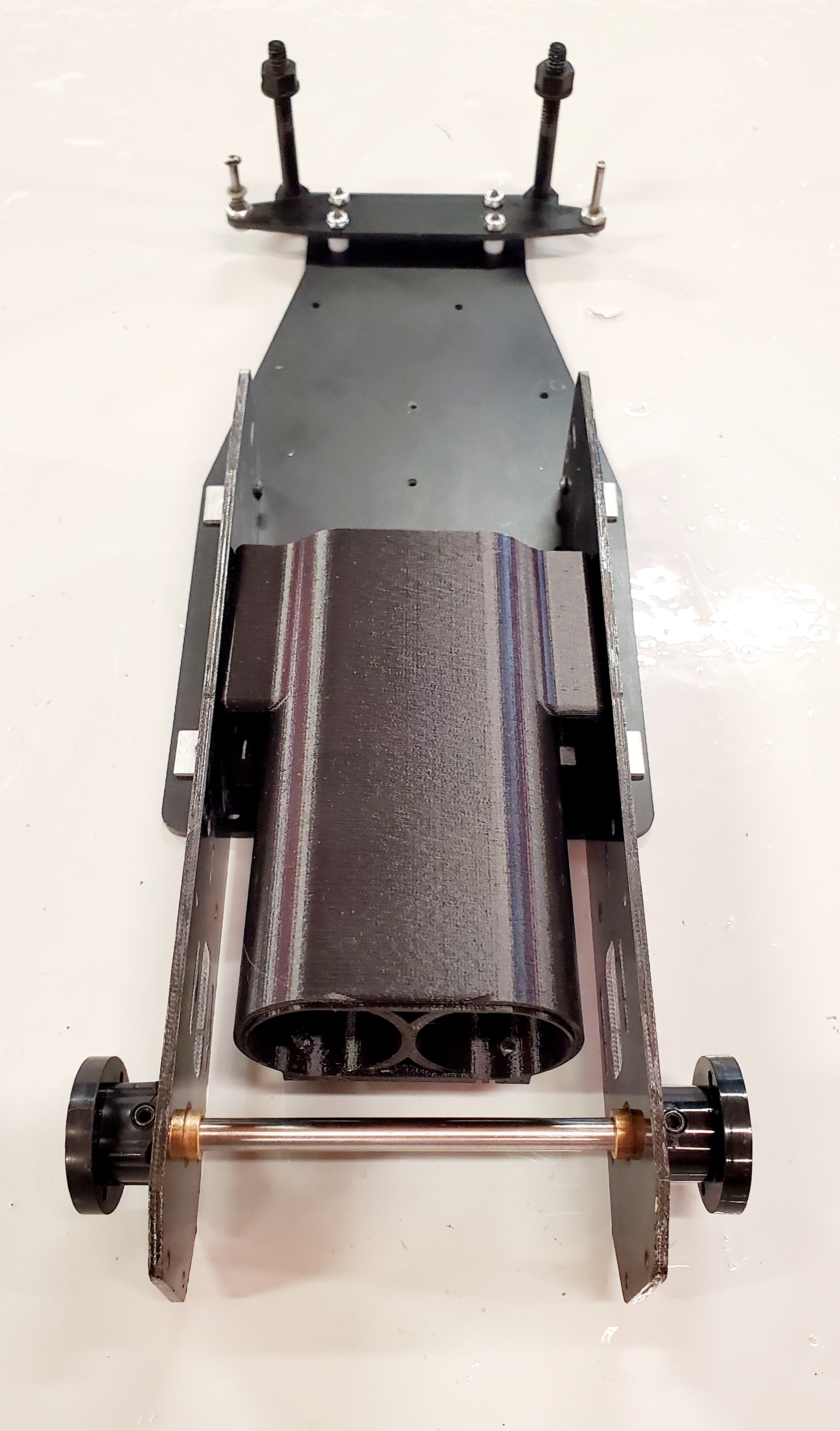

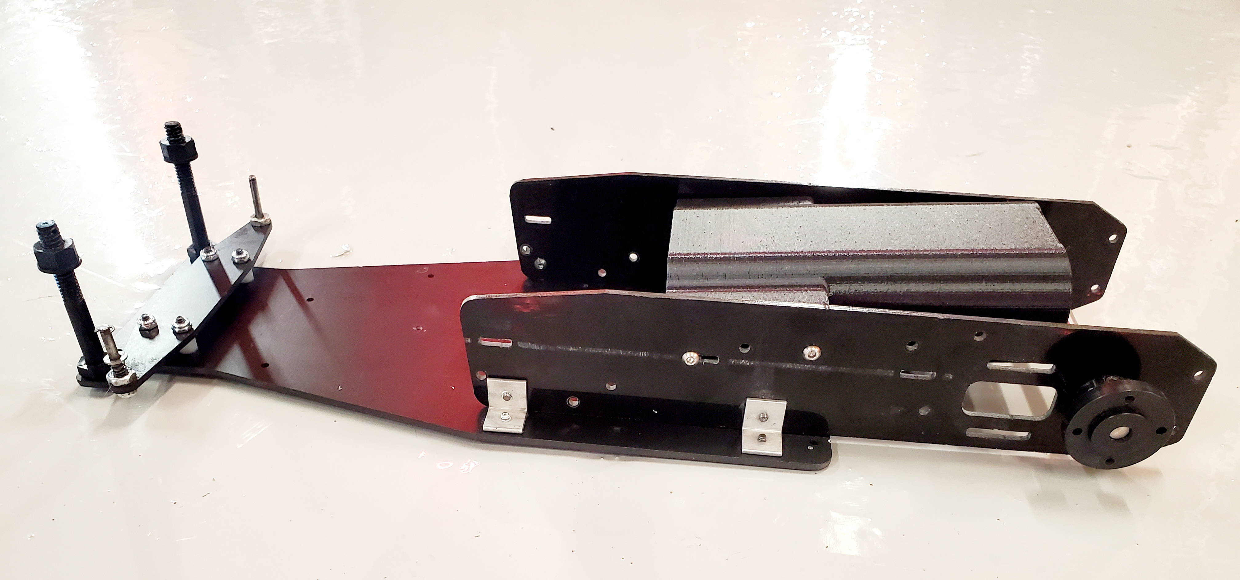

Alot left to do, but here is the basic chassis setup with the dual engine holder in place....wheelbase is 12"....rear width is 6.8" with tires on...fits the body I picked out perfectly!
With the "D" engines mounted
Pic of body I purchased, not my car
