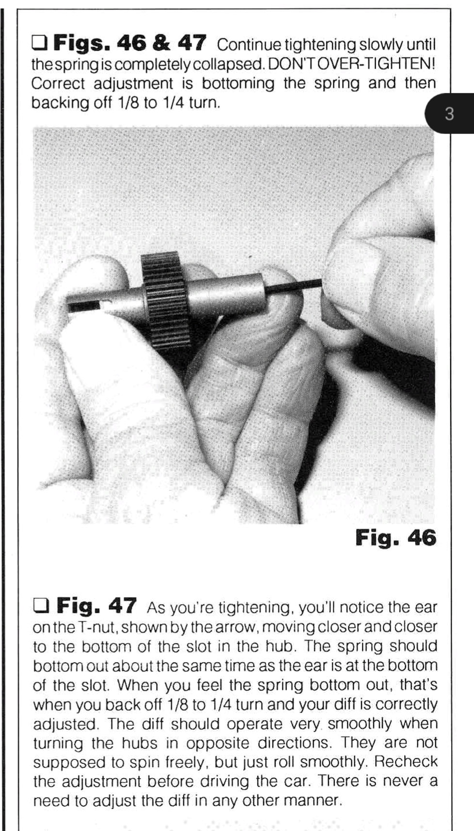

To tighten the diff this would be the thrust bearing, correct?juicedcoupe wrote: ↑Sat Sep 30, 2023 6:58 am Is the diff tight? The old diff and/or slipper springs could be weak as well.
I like my diffs a little tighter than normal. It might not corner quite as well but it will be easier on the ( hard to find and kinda expensive) diff parts.

The Championship Edition 1992 manuals here go through stealth gearbox build:Frankensteined RC10T3 / Franky Jr RC10GT-e (x2) / A+ stamp / Toy Story RC / Graphite replica / B1.5 BFG 5LTi / Clonewald / Hyper Hornet

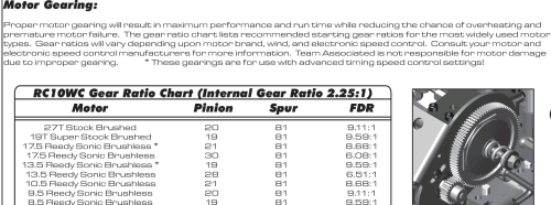

Hi all,
Wrapping up my refresh of the Goldpan. I did wonder about gearing recommendations. It’s a Stealth car, and I’ll be running a Trinity Midnight in it. I have a 16t 48p pinion. Any thoughts on the spur?

In what manner do you intend on driving it? Cruising around/light "bashing" or racing?

This is the gearing guidance from the RC10 Worlds car manual

- Posts: 16748
- Has thanked: 33 times
- Been thanked: 1216 times
Re: RC10 Goldpan ESC advice
A 16 is too small for a stock motor. You'd have to run such a small spur to compensate they probably wouldn't even mesh. Get an 81 Kimbrough spur and a cheap assortment of pinions off ebay. If you use the link for the spur for purchase, make sure you choose the proper tooth count.
Good point - no idea why the guy at the hobby shop insisted on a 16t! I’ll order a 20t for my 27 turn motor and an 81t spur. Both 48 pitch.
