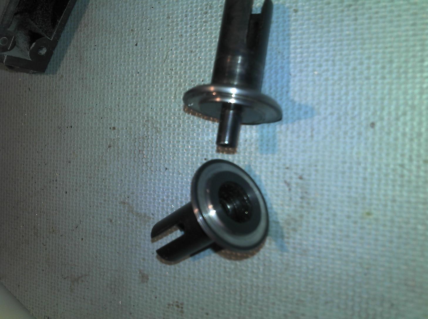

Since I last replied to this thread, I had some time at the lathe, double checking all my machine settings, for tight gibs and proper tool geometry, etc. Happy to say that I managed to hit a sweet spot for the machine, and was able to spin up both left and right halves to use in a 2.25:1 trans. The trick to it was to bring the tool into the work at an angle, rather than straight in, of course it could be my cheap (probably chinese) inserts, and tool height was extremely critical. It did appear that the parts were either not as hard as I thought, or case hardened. I'll try and snap a pic tonight.

BTW, since these only cost around 5 bucks each, if they can be modified, it would cost way less than buying raw material and spending all the machining time at the going machine shop rates.
here is a crappy cell phone pic:

i have done that on aluminum outdrives before but never on stock steel ones.
jwscab
Posts: 6580
Location: Chalfont, PA
Been thanked: 505 times
Re: Discussion about possible aluminum transmission and part
Post by jwscab »
yes, it look a little bit of learning curve to get it right, but it worked.

Looks good, yep that hardened steel needs a super rigid setup and the right tool position-height-spindle speed to cut properly.

I haven't put them in a trans to run, but i did a test build and they assemble fine and work as they should. The only real 'problem' that happens is you lose that little ridge on the outside of the diff ring. Most diffs in the industry have a flat surface for the diff rings anyway, so worst case, a drop of CA on the back side to help secure the rings would probably be fine.
