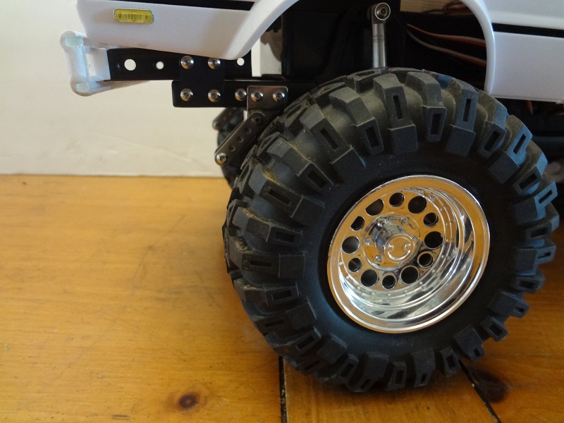

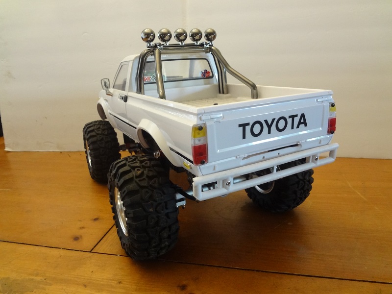

Did a little rear bumper work. I never liked the stock one. Too wide and sat too low. I trimmed down the stock bumper and made some small plates to attach the bumper mounts on top of the frame rails. The results won't win a concours show, but it is very effective at protecting the rear of the body without losing much departure angle. Also, since I made the little plates from material laying around, it was free.

Your modded front and rear bumpers are a big improvement over the stock ones. I don't run the stock bumpers on either of my HG trucks because I really don't like the look. However, with a little creative trim work, they look good.

That's probably a better rear bumper solution than mine , I just drilled an extra hole each side and pushed the mounts further onto the chassis rail , it brings it in well but not higher like your idea

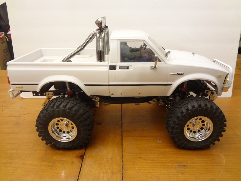

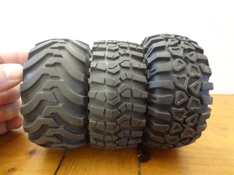

I got lucky and found a set of used, but still new condition, Proline Flat Iron 2.2 crawler tires. I confirmed with my LHS owner that these are unfortunately discontinued. These are THE tire to run if you want to really try crawling with this truck using the stock wheels. They are nearly identical in size to the stock tire. They are super soft and super grippy. You can see in the pics that the weight of the truck squishes them down quite a bit. I will be trying out some 2 stage foam inserts to keep the tire more stable and still have the conformity in the tread area. The first set of tires I tried previously (taller ones on the right) were a great upgrade and good all around trail tire, but these prolines are on another level. I thought they looked pretty good too.

Yep, they do look great. Should definitely do the job. You're lucky to have found them.
