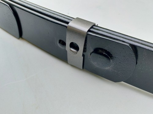

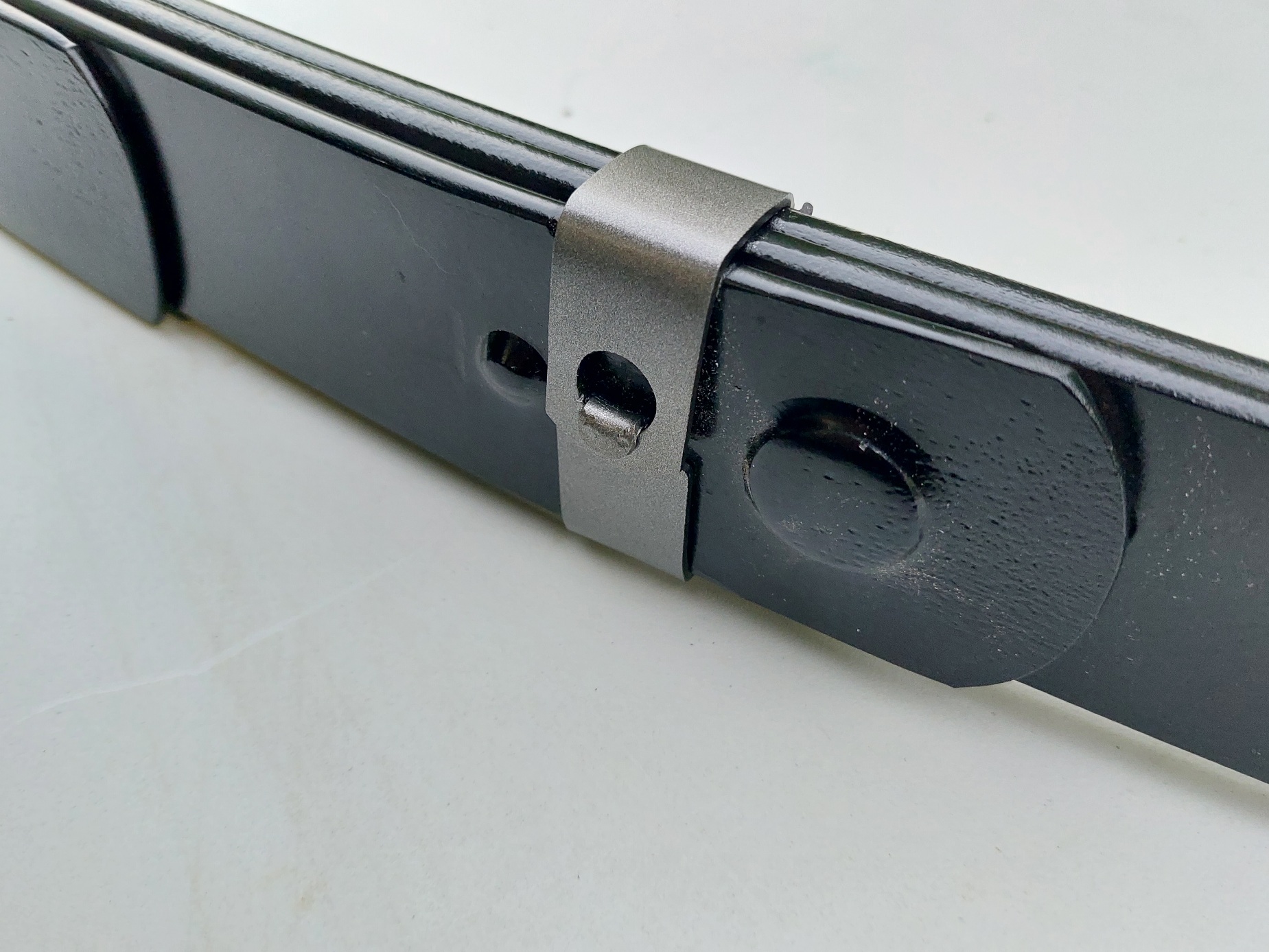

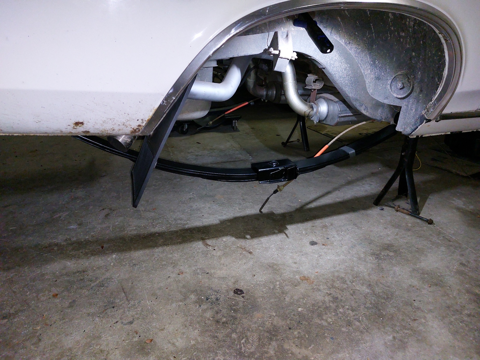

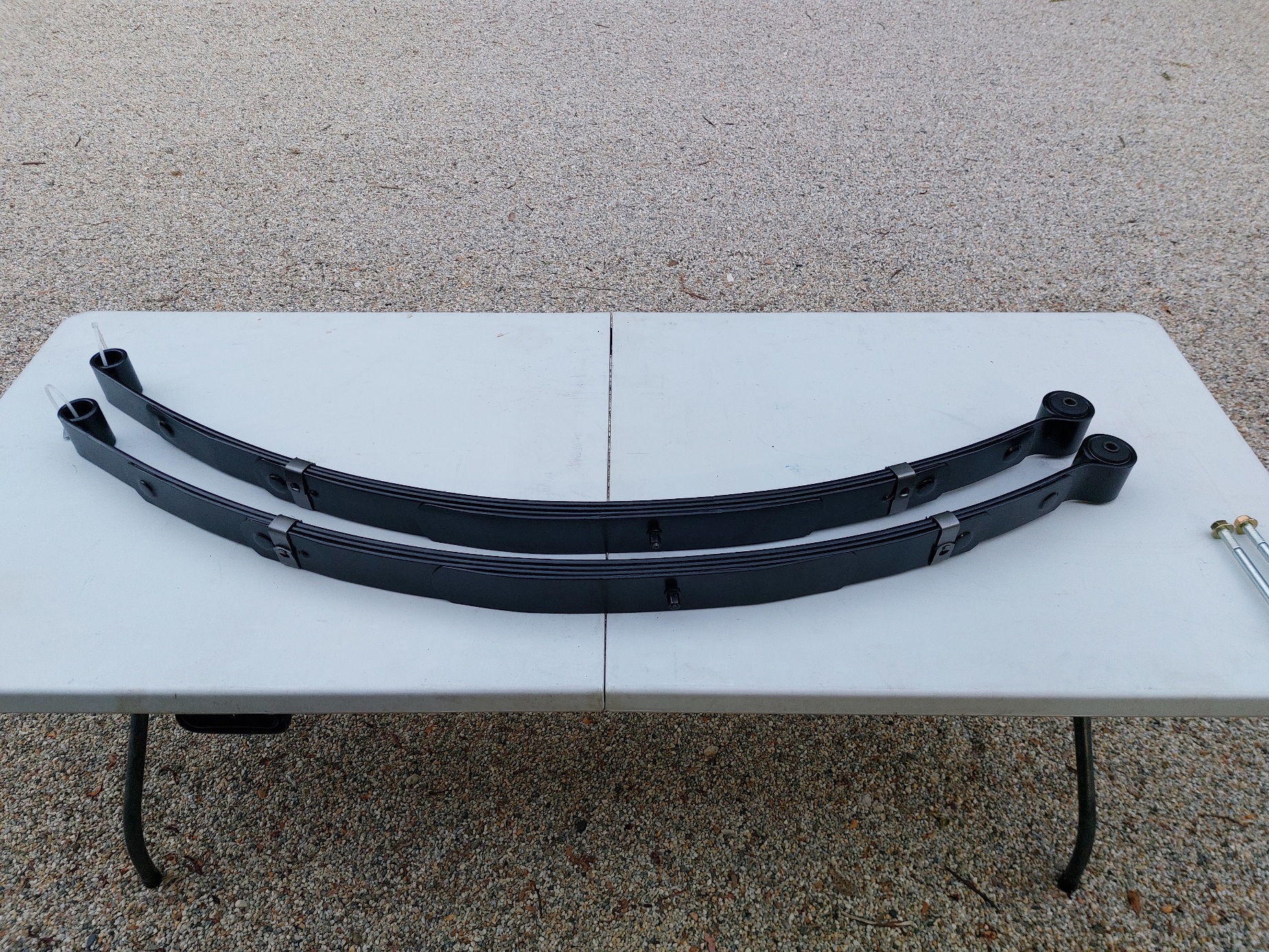

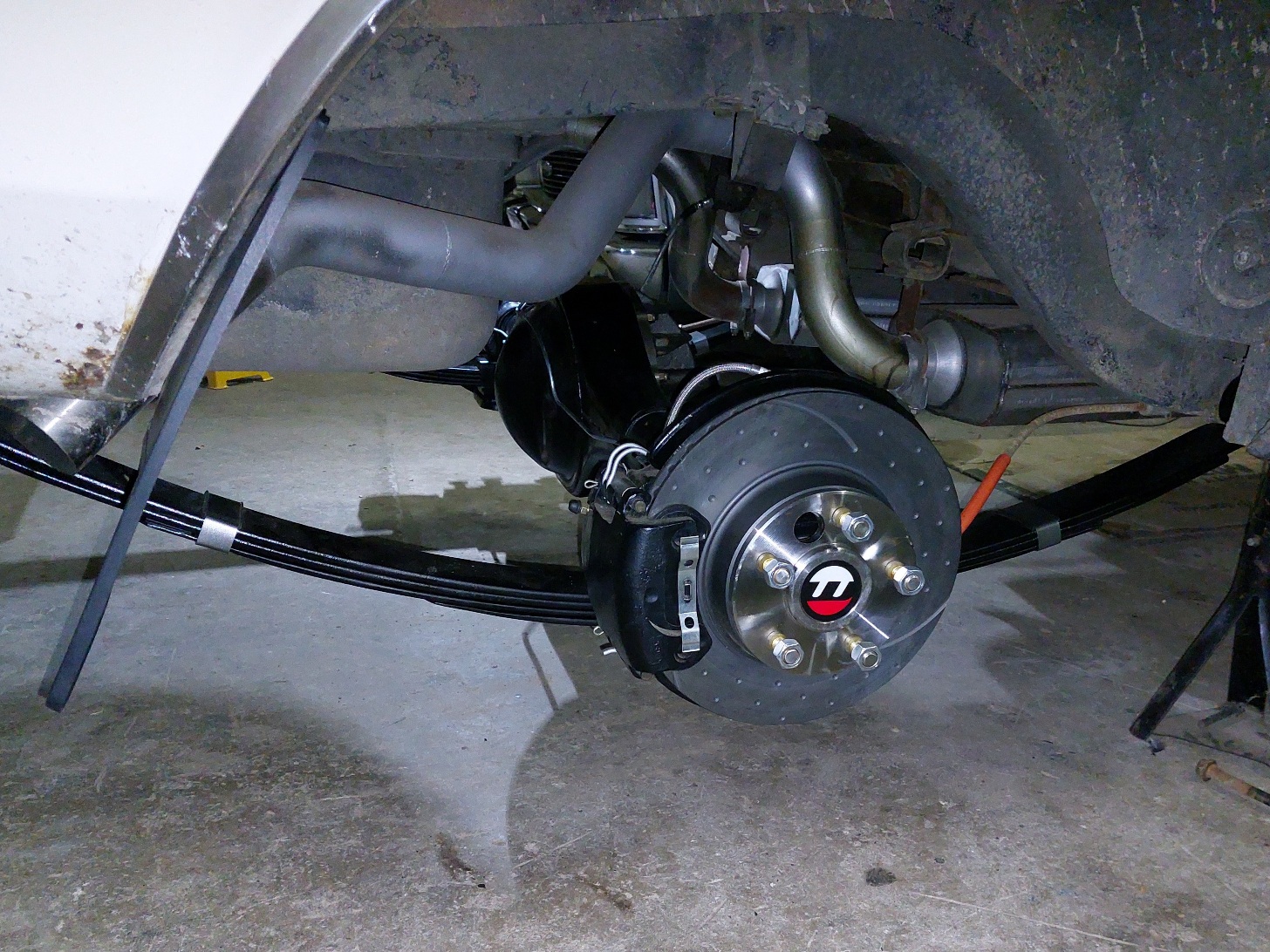

Springs are done and test fit....
There was a little bit of an unexpected consequence for rebuilding the spring packs that I never thought about, but makes perfect sense. Replacing the 45 year old spring slipper pads with new ones put a little more arch back into the springs, so it will be interesting to see where the car settles once it is on its own feet.
These clamps were a real pain to put on. I think they were for a 3 leaf spring without slipper pads as they were tighter than the old ones, but the rubber insulator is a little thinner, so I dunno. I kinda wish I cleaned up and reused the originals instead of buying new ones. At least I still have them as backups.
And test fit so I could bolt the exhaust back up and check the shackles since they are from a different car .......

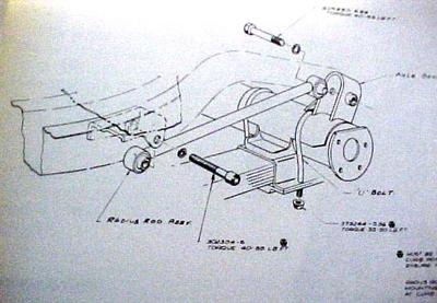

Sorry, I didn't see your post. Probably not at this stage as I bought a set of tramp rod brackets which sort of 4 link the rear. It's a pretty simple but clever idea, I like the fact that it's inconspicuous for the sleeper aspect.

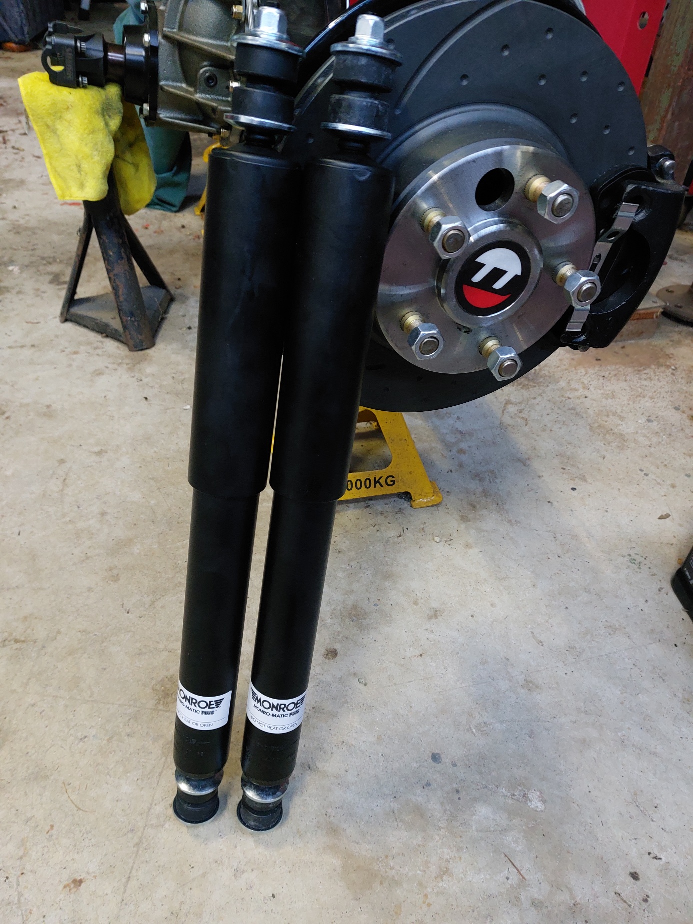

I bought the finest drag shocks that money can buy..... Monroe Matics, They have a poor review rating :lol:
There aren't really any double adjustable shocks in the lengths I need so these cheapies will do. The old shocks that came off the car were Wylie, Monroe bought the company in 1985.

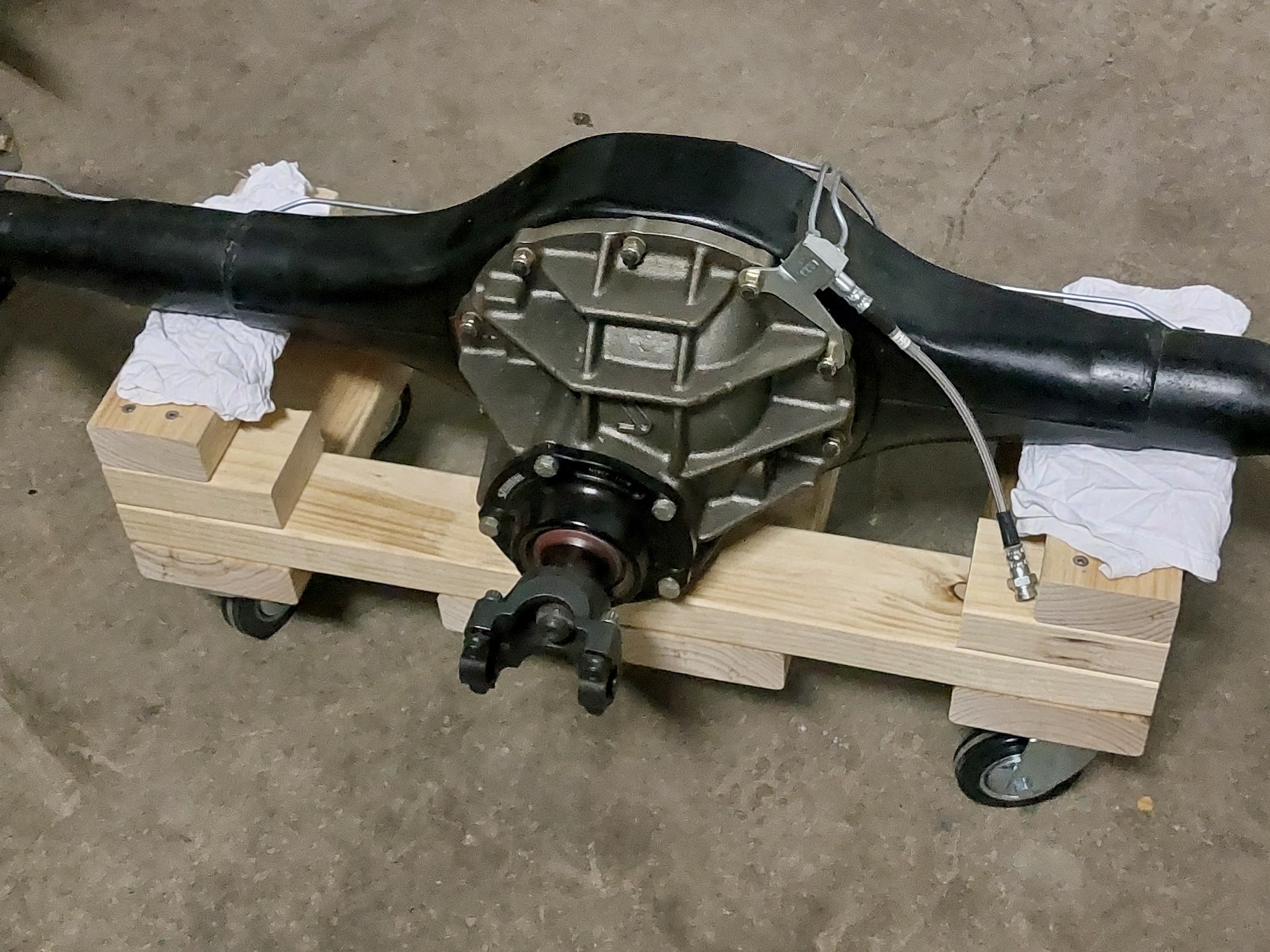

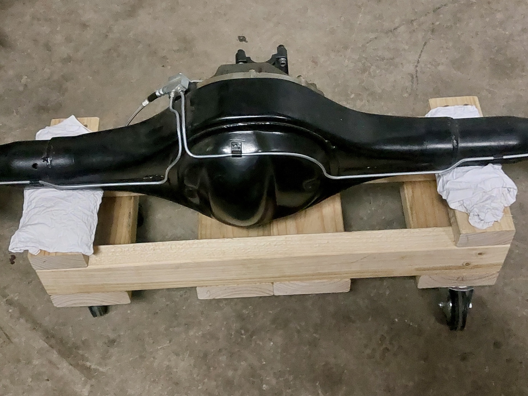

Also after a bit of thought (being a one man show) I made a basic cart/cradle to roll the diff around and jack it up underneath without having to wrestle with it or balance it on the jack pad.

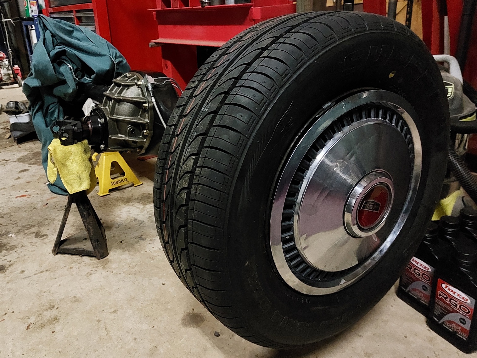

I wasn't going to post this but speaking of sleeper I checked that the stock 14" rims still fit the Moser axles and the speed discs :lol: Those Bridgestone tires also have a poor rating, and occasionally they come up on a buy 3 get one free deal, I don't really expect them to last too long anyways, lol.

RC10th wrote: Thu Feb 22, 2024 5:54 am I bought the finest drag shocks that money can buy..... Monroe Matics, They have a poor review rating :lol:
Before I upgraded the suspension in my car, it ran high 6's in the 1/8 with cheap Monroe shocks and drag radials.
If you are having traction issues at this power level, it probably isn't because of the shocks.

That's not too shabby. I was looking at the cheap competition engineering 3 way shocks since the Calvert's lengths were all wrong. I couldn't get past the poor quality issues and short lifespan that seemed to be a reoccurring theme with them. I would have bought the Koni red's but I didn't want a sporty ride either, lol.

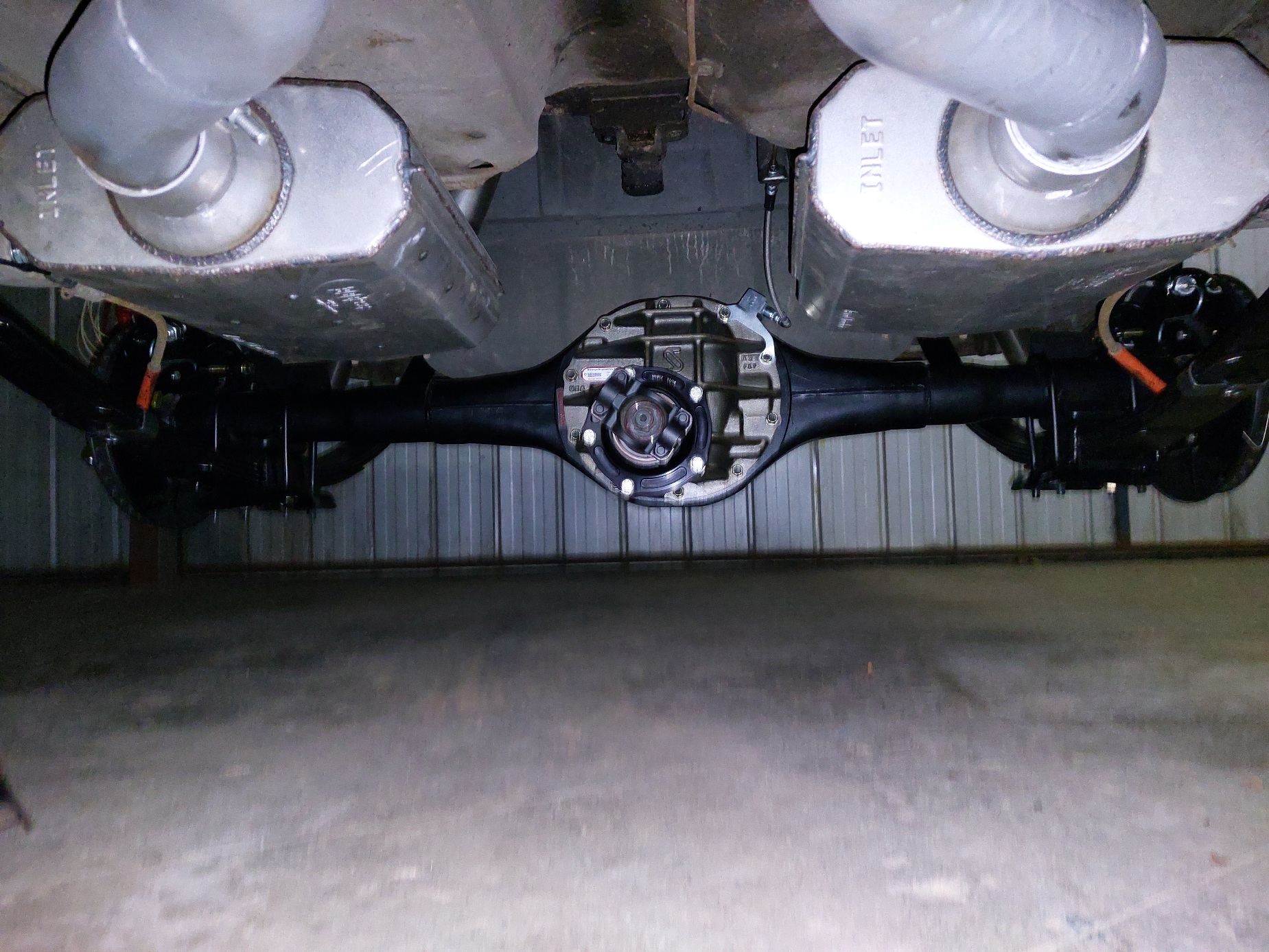

Nearly done..... Just gotta torque the u-bolts so I can set the car down under its own weight to measure for drive shaft length. Those Strange 1350 u-joints are pretty big, and couple them with a 3.5" driveshaft... beefy.!
I don't know why those parking brake cable sleeves are orange, I'll have to paint them.
