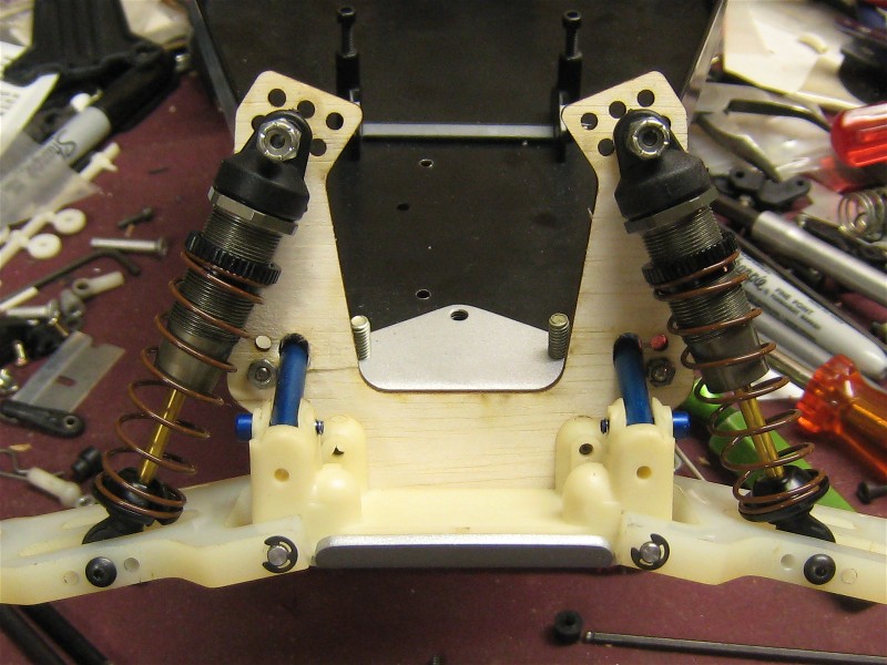

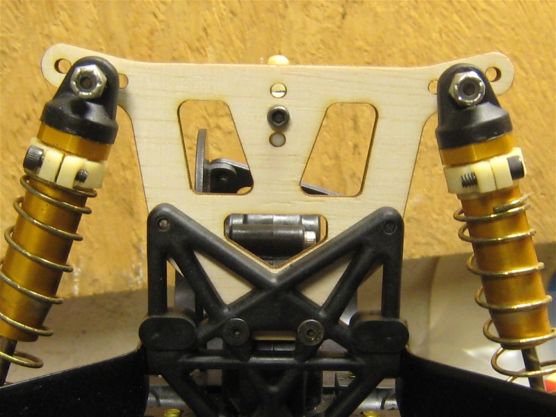

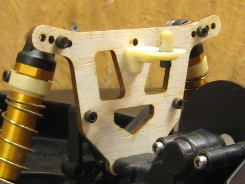

alright, got the prototype towers from atlas. they turned out great. now that i have parts i can acutally hold in my hands and bolt to the chassis, i can see some changes need to be made. the rear tower is pretty much good to go. but the holes for the body mount need to be changed. the top one needs to go bye bye, and one needs to be added at the bottom. another thing is where the b4 wing mounts are gonna end up mounting to the tower. i didn't have them when brian drew it up (and still don't yet :oops: ), but i have a feeling they're probably gonna end up in the middle of the side cutouts. but we'll see....

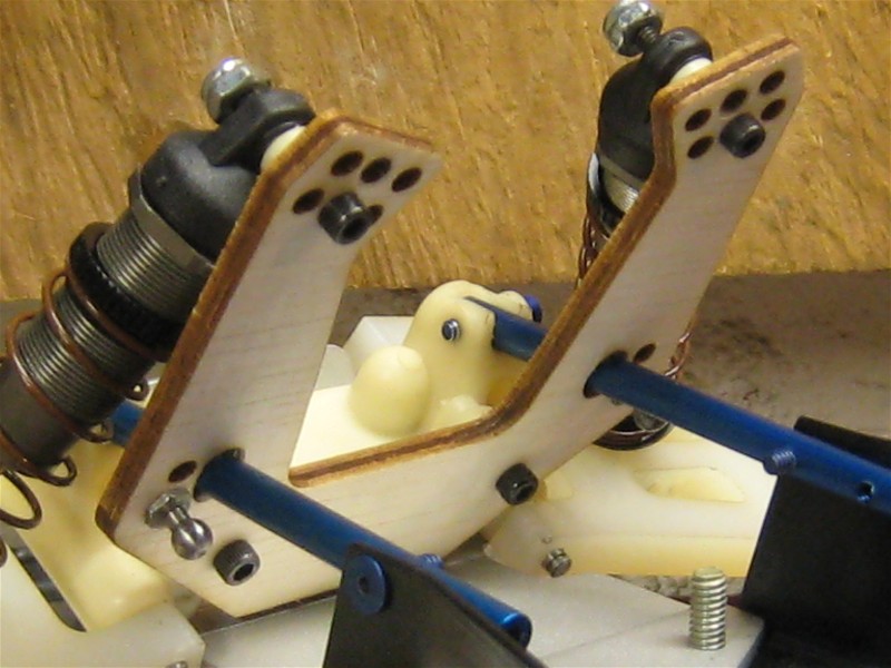

on the front, there's more of an issue. i think it's something i did drawing it up, and brian thinks it's something he did, but either way we'll get it figured out. :wink:
my plan was to have the top holes fit the .89 shocks, and the lowers fit .71's. well, the way it is now, the tower is a bit too tall. so we'll get it shortened up. another thing that needs a little tweaking is the angle of the shock mounting holes. they just need to be pivoted a tiny bit. after those changes, the front will be ready to go as well.

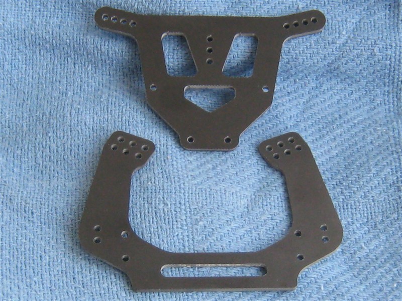

alright, time to update. :)
well, i changed my mind as to what front end i'm gonna use on this build. the front arms that i had thought would work on this car are not gonna fly. so, i decided to just use a standard buggy front end (nose plate, wide track arms, etc). the front tower that i designed to use on this car with a truck nose plate will now be used on another car (i'll update that thread shortly :wink: ).
i also decided that CF towers was not the way to go on this build. it's too early of a car to go with a "factory team" theme. so i asked atlas if he could cut the custom rear tower out of 1/8" matte black fiberglass, and one of his .89 front tower out of 3/32 matte black fiberglass. he said he could, and here they are. i'm super happy with how they look, and i think i made the right decision on the material choice.
