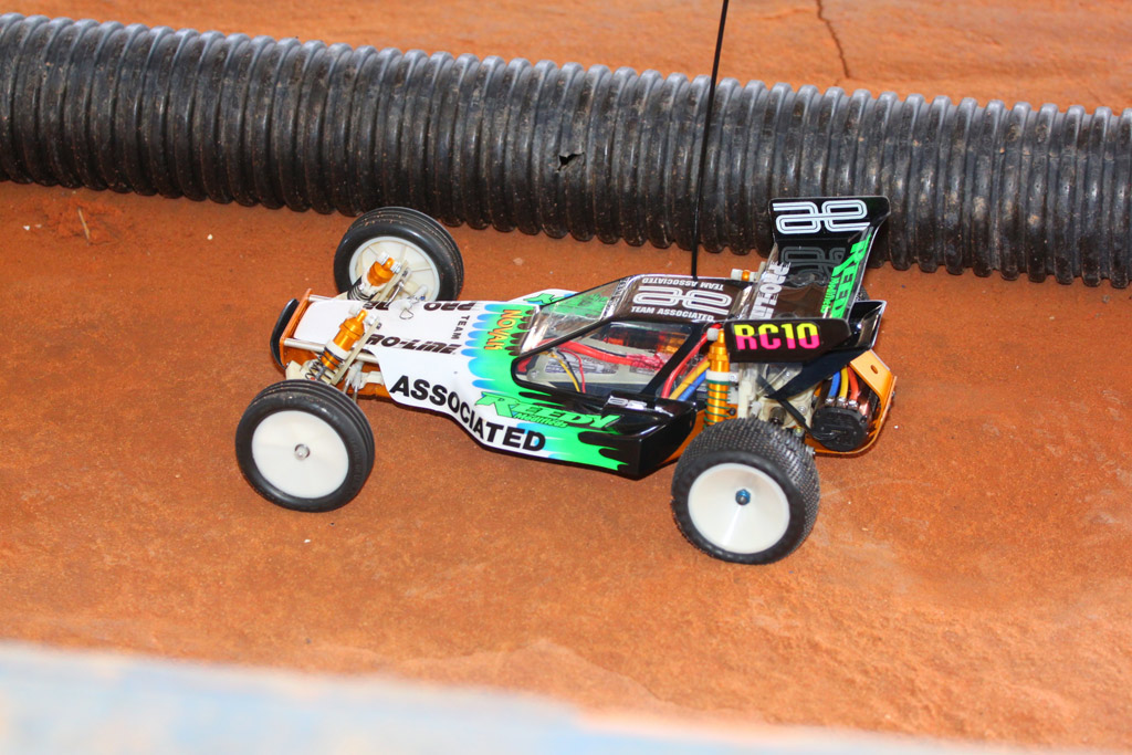

I am running the regular 2WD modified class and I probably had the slowest motor in the main and in qualifying... a 13.5 brushless LRP X-12 motor which they run as stock-class down here. Most all of the guys in that A-Main picture are running from a 7.5 to 9.5 motor in their B4's.
I have an LRP X-12 9.5 motor stored, but was just too lazy to put it in my RC10, then after the 1st qualifiying round was over and I was TQ, I decided to just leave it in as I didn't feel the need for more power to go faster. I'm not a big fan of wheel spin (increased tire wear) or wheelies when the track blue-grooves and like having just enough power.
On one weekend race event, I ran the 2WD Stock and 2WD mod classes with the same car, same motor (13.5) and same battery back to back. It is hilarious when people realize you are running a stock class motor in the modified class and are doing the same or faster laptimes than the top 3 or 4 racers in the mod class with a 20 yr old style buggy and to boot, 1990 style wheels and tires (not the new wheels or tire compounds)! :lol:
On this day in the pics, I ran Associated Team Car front wheels with Proline Edge tires, and in the rear Team Car wheels and Losi X-2000 tires I have had glued to rims after trying them way back in 1994-95.

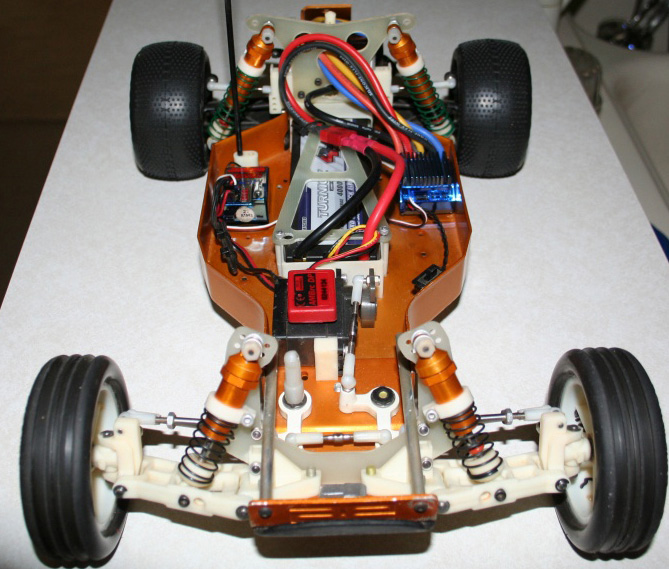

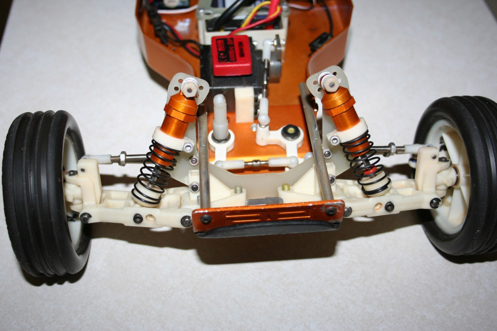

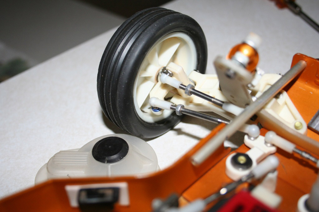

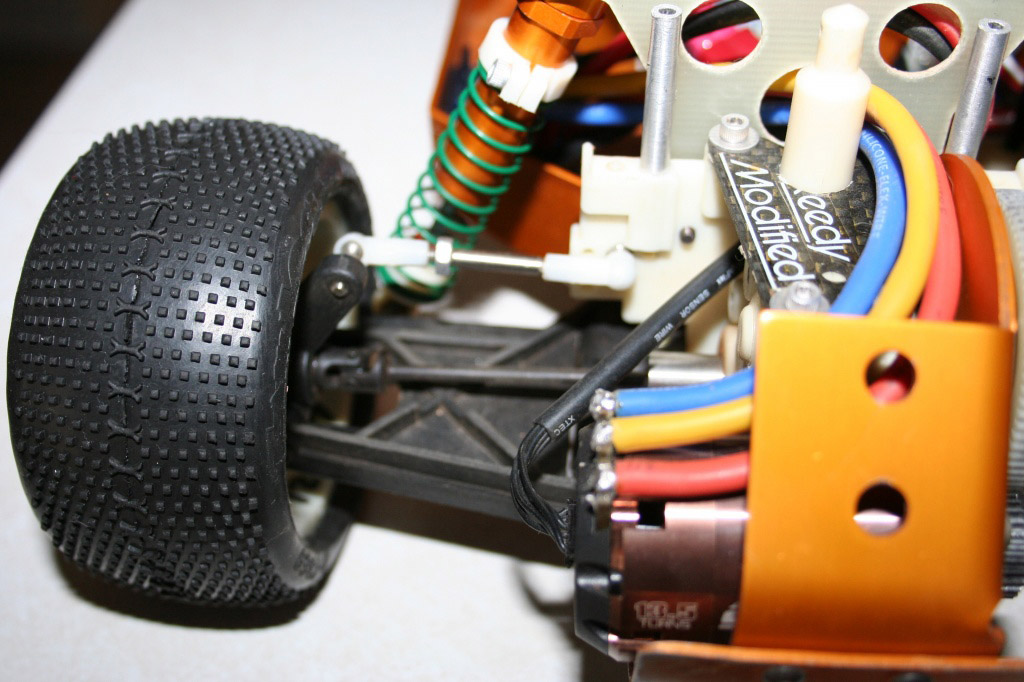

Here are pictures of my car (I haven't cleaned her yet since last run) and setup sheet:
Just for reference JK, this track setup works great on what your outdoor track sounds like, by the choice of tires. Most here use Double Dees.
As you can see here I am using the stock rear inner suspension mount (1.5 deg) with B2-B3 Associated Universals and RC10T2-T3 0 deg rear truck hubs so that I can run those axles and run B2-B3 wheels that are 2.2 diam. You coud also run the truck 3 deg hubs if you need more rear bite, but you might have a problem then with the loss of front end traction you might have.
For the 1st time in my life, I also added a little block of lead weight to the front noseplate that you can see. I don't know how much, I just did a trial and error on a practice day until the car had a very neutral feeling with no delay in steering input traction. The size of the lead is 1/2" x 1/2" x 1/8" thick.
*Added: I forgot to state that I have one red o-ring on the outside of the front shock shafts, and two red o-rings on the rear shock shafts to prevent the chassis from bottoming out on the huge jump-landings.
I hope this helps you and others a little.
:D
Ruffy's RC10 Current Setup PDF

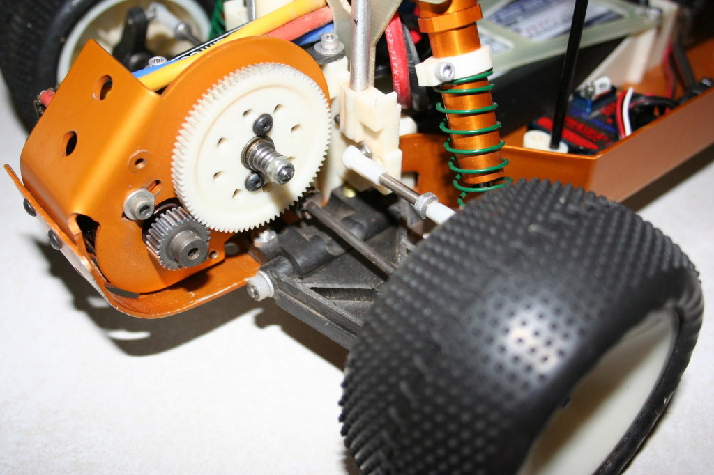

No slipper...I'm running a 6 gear 8)

What did you change to run the 48p spur and pinion with the 6 gear trans? I have one I am going to restore but figured I would need to find a stealth before I started anything else. After reading this thread I might just stick with the 6 gear and get to work on the other stuff.
