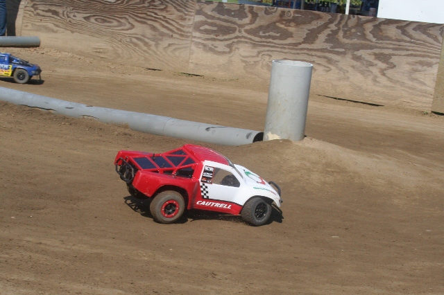

Ok, its been a long time. Time for an update. This season has been going pretty good. currently leading points in 17.5 short course. Not by much but enough for now. No major changes from last year just some updating and weight trimming. Up front the RPM front bumper is gone and a stock SC10 bumper is in its place. There was an ounce off the front end there. Mounting was fairly easy.
With the blitz hubs I got rid of the stock associated front wheels and picked up a set of goosebumps on some unknown wheels. Those were 2 ounces lighter for the pair. The shorty packs were a big help at loosing some weight. With alot of the weight coming off of the front I had to do another remodel to get the rearweight back down. Last year and beginning of this year it worked best around 60.5-61% rear. With the bumper and front tires The weight dropped but the rearweight was up to 62.5 and it was getting a little pushy. So once again everything came out and it got shifted again. I switched to a low profile servo just to try it out. It fit real cozy up a little farther in the nose and the reciever right next to it. That gave me about 1 1/2" that I can move the battery forward or back depending on what I need. That all together got the rearweight down to 60.9 with the battery to the front and 62.0 with it to the back. That gives me some adjustment without adding weight right away. Other thing I added was carried over from the stock car. If you look in the pic of the front bumper there is a screw sticking up with a plastic nut on it. I have 5 1/2 ounce weights with a 1/8 inch hole drilled through them. I can add nose weight on the bumper or hang it on the back where the mudflaps mount depending on track conditions. Its fast and I dont have to mess with tape.
Also got rid of the viper and went with a tekin this year. The difference was unreal. I cant say how the rest of the vipers are but that one was a dud. It functionally ran but it had no torque, or top end. Right now its in my sons shortcourse for the novice class. Good place for it.
The body is getting pretty rough so a new one is in order over the winter. The 4wd slash body doesent look that bad but the main thing is its light.
Thats along ways from last years starting weight.
