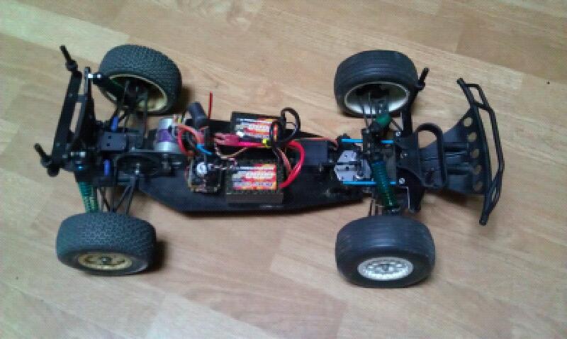

Interesting conversation here. My brother and I recently built a SC truck out of an RC10GT converted to electric and our main focus was on keeping the wheelbase relatively short, weight as low as possible, and weight distribution to be perfect 50/50 f/b l/r so far the biggest hurdle has been rethink the suspension tuning because we went way to light in the front shock department due to not knowing how the larger front weight ratio would react. We ended up with a truck that had way to light of front suspension and you could visibly see the front tires and a-arms come up and back into the body over the bumps. I think I might even try this setup with 0 front kickup and get better results than the stock gt kickup.
Crappy phone pic attached.

For off road I don't personally think 50/50 weight distribution is optimal. At least not for 2wd. I prefer sometime more along the lines of 35/65 but with the weight within the wheelbase.

I too would agree that a bit more weight behind center, towards the drive wheels, is the ideal situation for *most* conditions--for 4WD too. With my upcoming Barney build, I'm doing the opposite of what I did with CYANide; instead of narrowing the track, I'm widening it for a more stable stance for offroad use.
