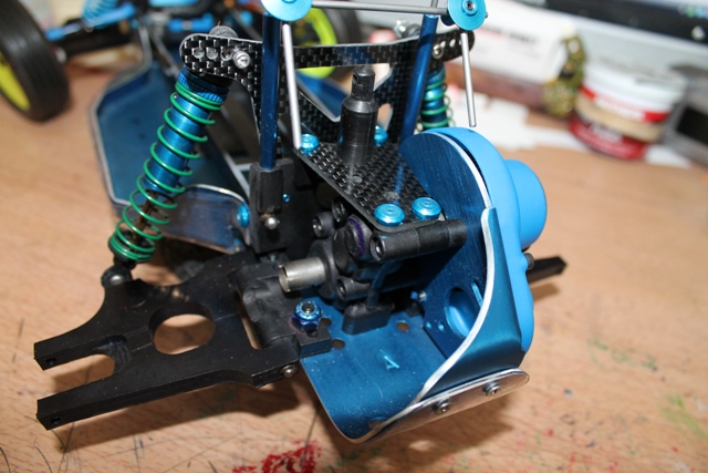

I currently run my rear shocks all the way in, plus an extra hole. You might try drilling another hole further in (so you would end up with 5 per side total). The rear towers I produce, come with this hole btw. -Jeff

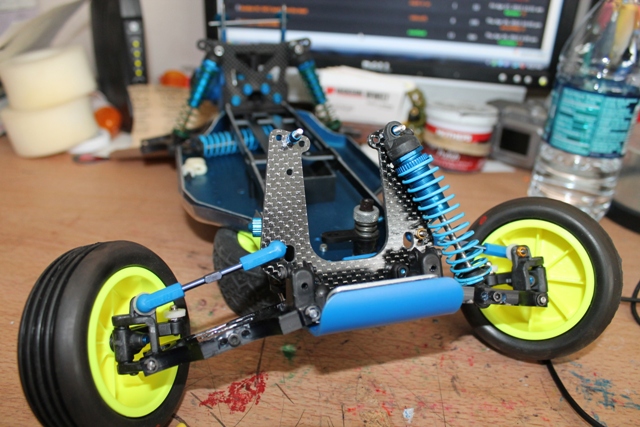

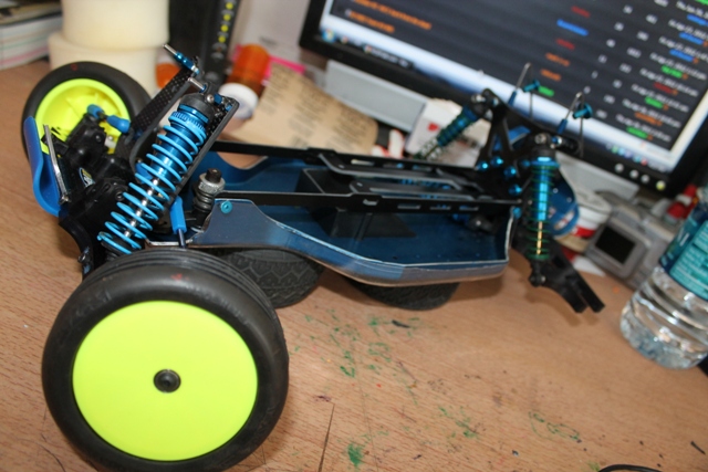

Everytime I put this car back together I see something I forgot to do while a part was off
I wanted to file the nose plate back a little for the servo mount to sit flat and forgot again.
oh well makeing alittle progress its coming along. I really like the new towers. I am waiting on parts again. that really takes the wind out of my sails on a build to haveing to keep stopping and wait for parts.
do the Yellow wheels look good or Bad? I used B4 blocks and carriers is that going to cause me any problems? and what rear hubs do you guys use with the B4 CVD's?
I know the rod is on the wrong side of the tower I was trying out something. it didnt work

Wow, this is really looking good! Not sure if i said this before, but this build is going to cause me to rebuild my RC-10 old is new.
I am running RPM 70272 RC10T Bearing Carriers with Jake's arms and B4 CVDs.

SonciCJ5 is correct on the rear RPM hub, very easy to find. Also make sure to pick up four 1/2 x 3/16 bearings for the hubs if you don't have any. You won't get far without those.
Car looks great.

Car looks good Rick! Since you asked, I'm not a fan of the yellow wheels. Maybe because I have to look at coats that color all day long at my job!
I wouls probably go with white or blue wheels if it was my car but it looks pretty good that way too.

Rick, I say black wheels and Losi Blue spec tires
, gotta get some Losi on it, right?
