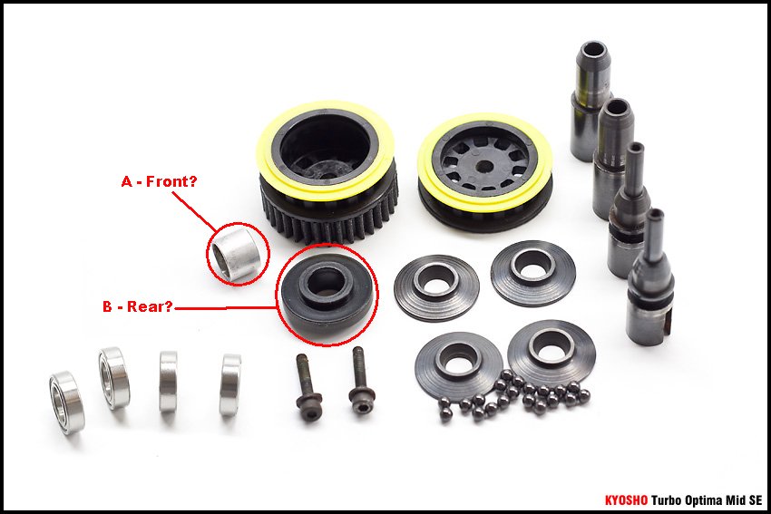

Thanks j0pp3...there's just one thing that doesn't seem to appear in either that diagram or another one that Bo Wallen sent me; Part B. I assume the thin collar, A, is used with the front diff only, and the plastic piece B is for the rear? It seems to fit my rear diff assembly perfectly and I don't see how Part A would fit in addition to B...? :?
Jay Dub
Posts: 1136
Location: San Jose, Ca.
Re: Turbo Optima Mid + Turbo Optima Mid SE build/restore
Post by Jay Dub »
Yup, that is where they go. The rear piece is intended to keep pulley woble to a minimum. -Jeff

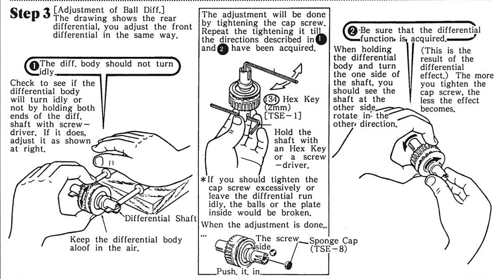

I should also mention the instructions for adjusting the ball diffs is laughably obtuse. "The diff body should not turn idly". :? WTF does that even mean?? Obviously when you turn one outdrive, the other should turn in the reverse direction, just as with a bevel gear diff...but how tight is tight enough? :?:
Oh...and "Keep the differential body aloof in the air." :lol:
