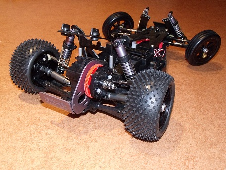

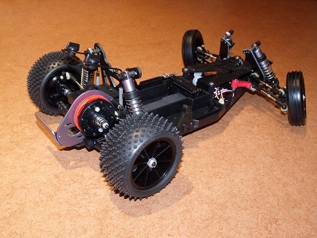

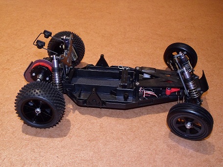

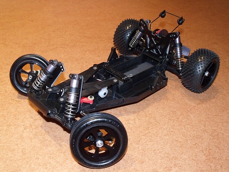

Almost done. The build is mostly stock but with a few 'upgrades' here and there - mostly Pro-SE parts and some Lunsford Ti - it's not what I originally set out to achieve but on the whole I'm fairly pleased with it. The rear shocks need longer shock bodies due to the altered geometry using the Pro-SE shock tower. I need to remove the RPM HD side bulkheads and install the servo linkage, I also need to paint the body - my least favourite bit. Might also install some period electrics as well....
I also ended up fitting some new XX rear wheels dyed black with silver step-pin tyres but it does need the body and the wing to really set it off.

I'm not too familiar with Losis, but it just looks a bit odd that the rear shocks are mounted behind the tower instead of in front...is that indeed how they're mounted?

Re: NIB Losi Jr. 2 (New build)
It's the only way I could get them to fit but yes, it is correct!Coelacanth wrote:I'm not too familiar with Losis, but it just looks a bit odd that the rear shocks are mounted behind the tower instead of in front...is that indeed how they're mounted?
It looks like if they were on the front, you'd have more length too. The chassis looks great, by the way. Love the all black chassis & charcoal shock bodies.
I did try it that way round but there was no way that the shock end was going to reach the suspension arm, even with the thick spacer. If you look back at the build, I also had to swap out the RPM shock mounts that I had installed to the early type found on the original JRX-2 as they would not allow the shock body to 'pivot' backwards. I thought the problem was originally in the way I had the H-arms mounted but after I checked the manual and some on-line photo's, I discovered that I already had them the right way round....
On the original 5-Link JRX-2 the shocks are indeed mounted towards the front of the chassis because the shock end is mounted forward on the lower swing arm.
