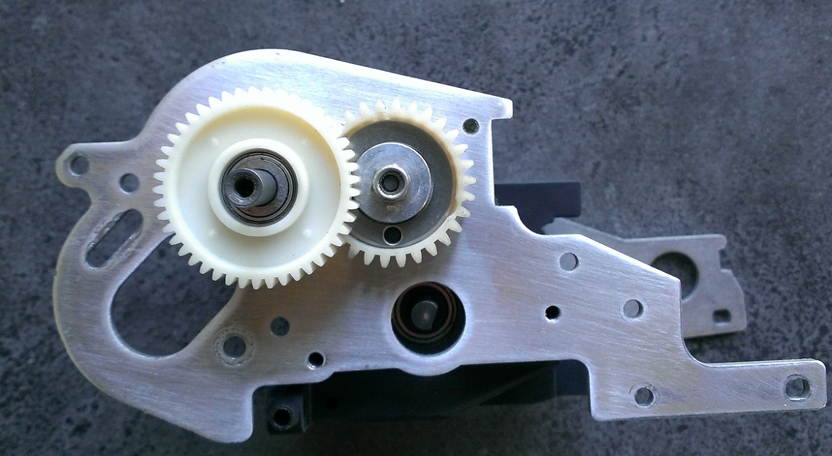

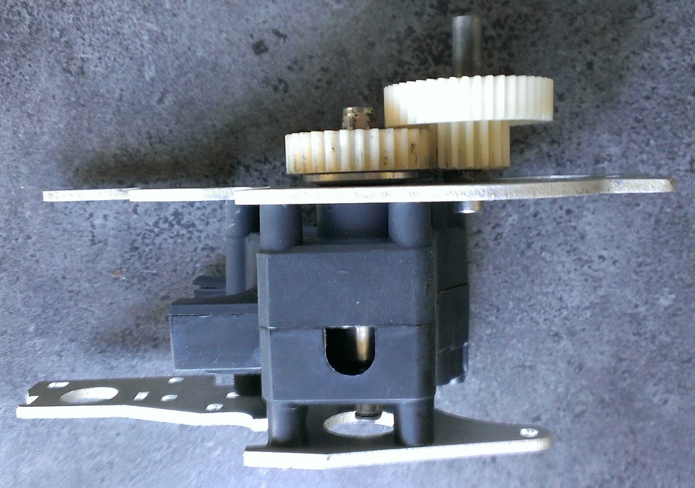

Looks interesting Dennis, what Tamiya gears is that? I’s it just a single slipper pad on the inside?
- DennisM
- Posts: 2405
- Location: Denmark
- Has thanked: 30 times
- Been thanked: 62 times
Re: Kyosho Optima for NVC
The gear on the topshaft is avante series for ball diff iirc.
I can´t remember the other gear, but It must be quite common in Tamiya cars from the eighties.
There´s Mid slipper pads on both sides. They could be replaced with teflon.
Another thing could be to resize some tlr22 or B4 slipper disc´s and sandwich a Mid pom idler gear with teflon.
Some cutdown ball diff outdrives with teflon in the recess instead of the diff rings, would be even better for the Mid Pom idler, I think.
In this first attempt my main focus was to keep the build height of the slipper lowest possible.
But with the newly found tamiya "spur" there´s good clearence against the nut.
