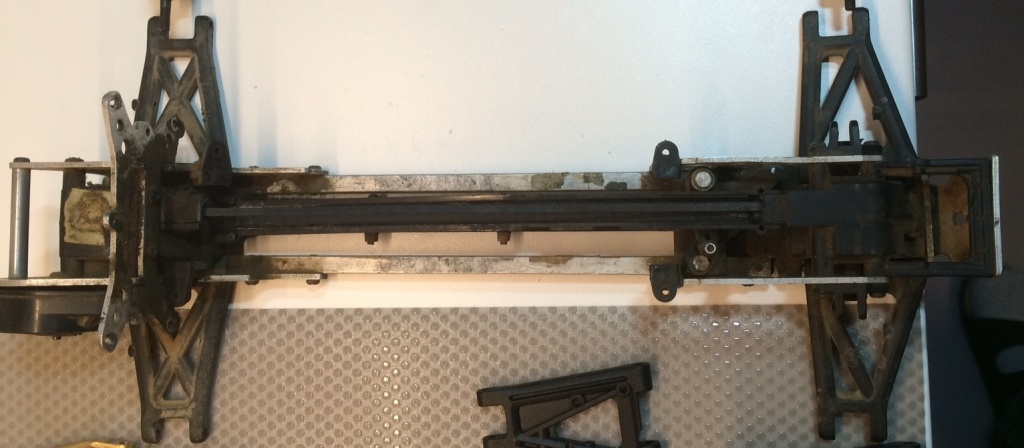

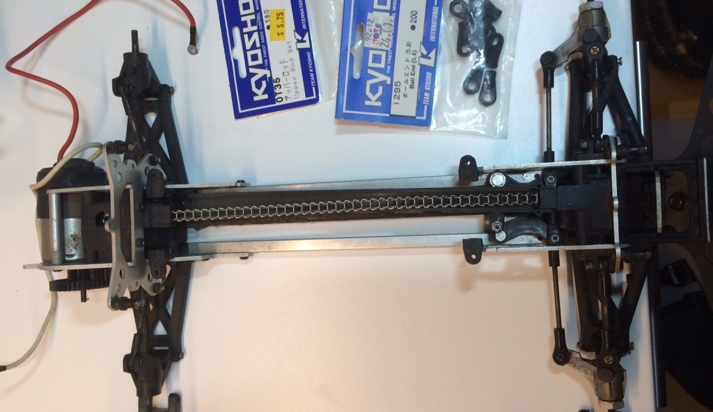

Fist I needed an Optima for start, I had a vague feeling that had one, some ware among my other cars. But I couldn’t find it any ware… So I advertised for one in the “Wanted Forum” and got two answers... Then by change when I was looking for some parts among my things for this project I found it… or rather found them! I had two Optima chassis, one with a belt conversion that I totally had forgotten about.
The other one was a regular Optima chassis. But the nice thing with this last chassis is that it seems to be new built and never driven. That will suit my project perfect, I like new parts when I try to build a racer.
Someone might wonder how you can forget about two cars... Those chassis was part of deal a friend did. The seller (Canadian if my memory serves' me right) wane get rid of all "junk" he said. So my friend ask if was interested in Optima chassis for $50 + a part of the shipping cost. I look at some pictures and decided to hop on board. When the box arrived to my friend, he discover that there were two Optima chassis. He just called me and told me "you will get 2 chassis my friend", when they arrived I just peak's at them before I put them away. This was 3½ years ago...

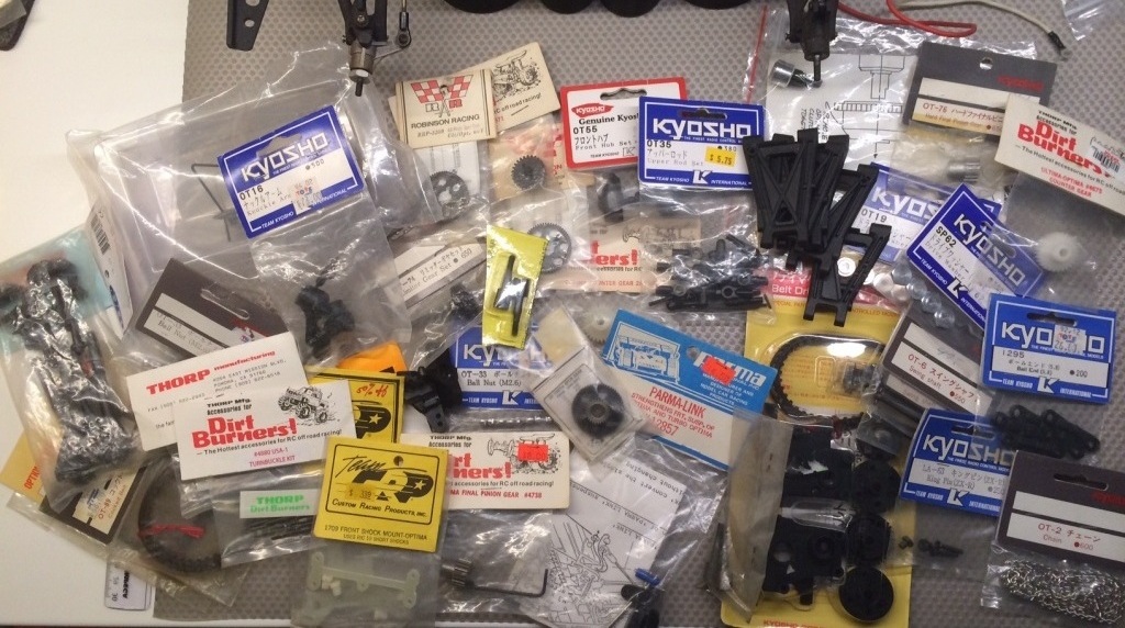

And I found some part that I gather for an Ultima project and some parts that is from my race days in the 80’ and 90'.

I'm digging the multiple hard final pinion gears and belt conversion kit. You won't need those for your build because you want to stay with chain--so send them to me. ![Mr. Green :mrgreen:](./images/smilies/icon_mrgreen.gif)
