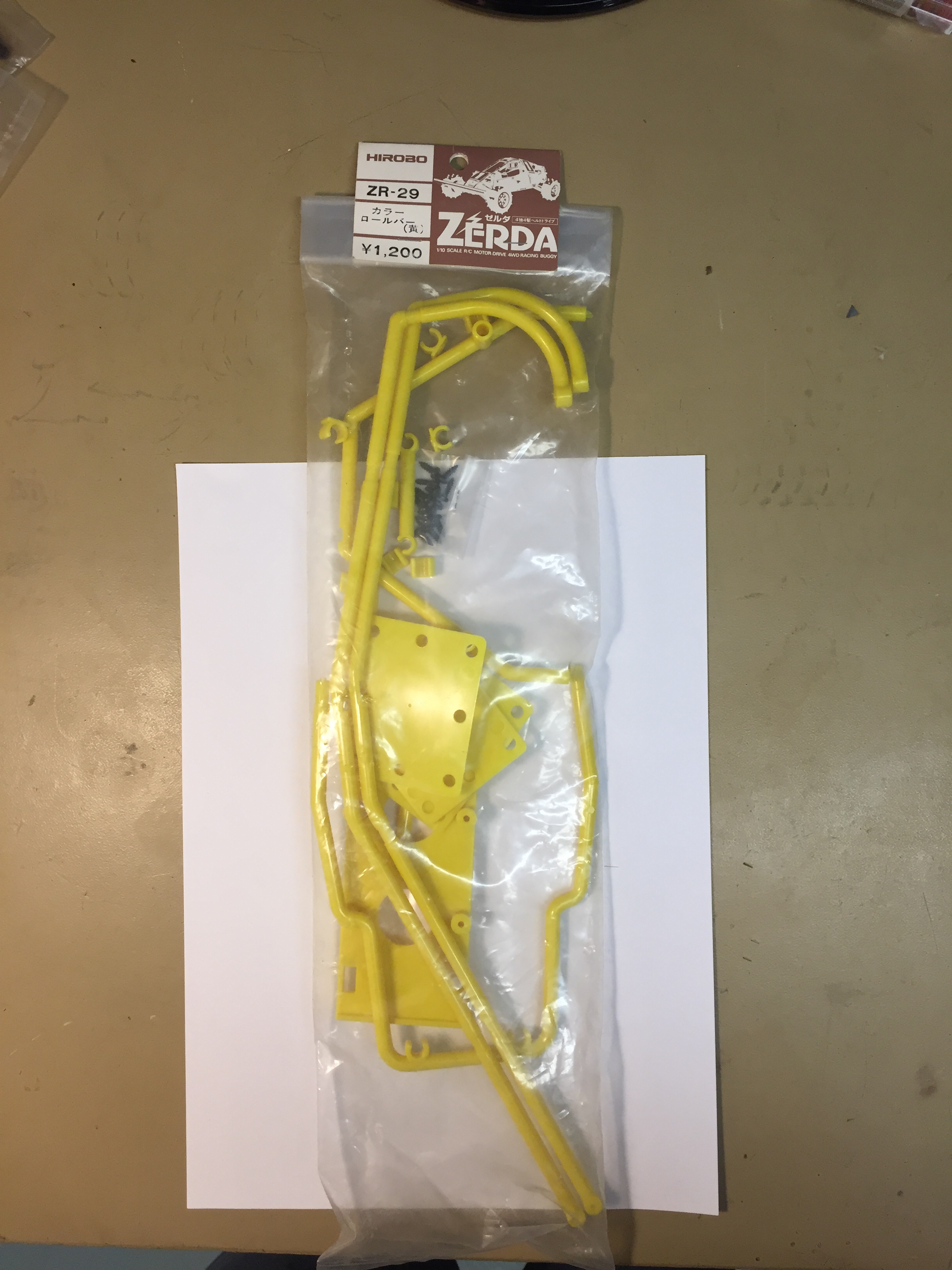

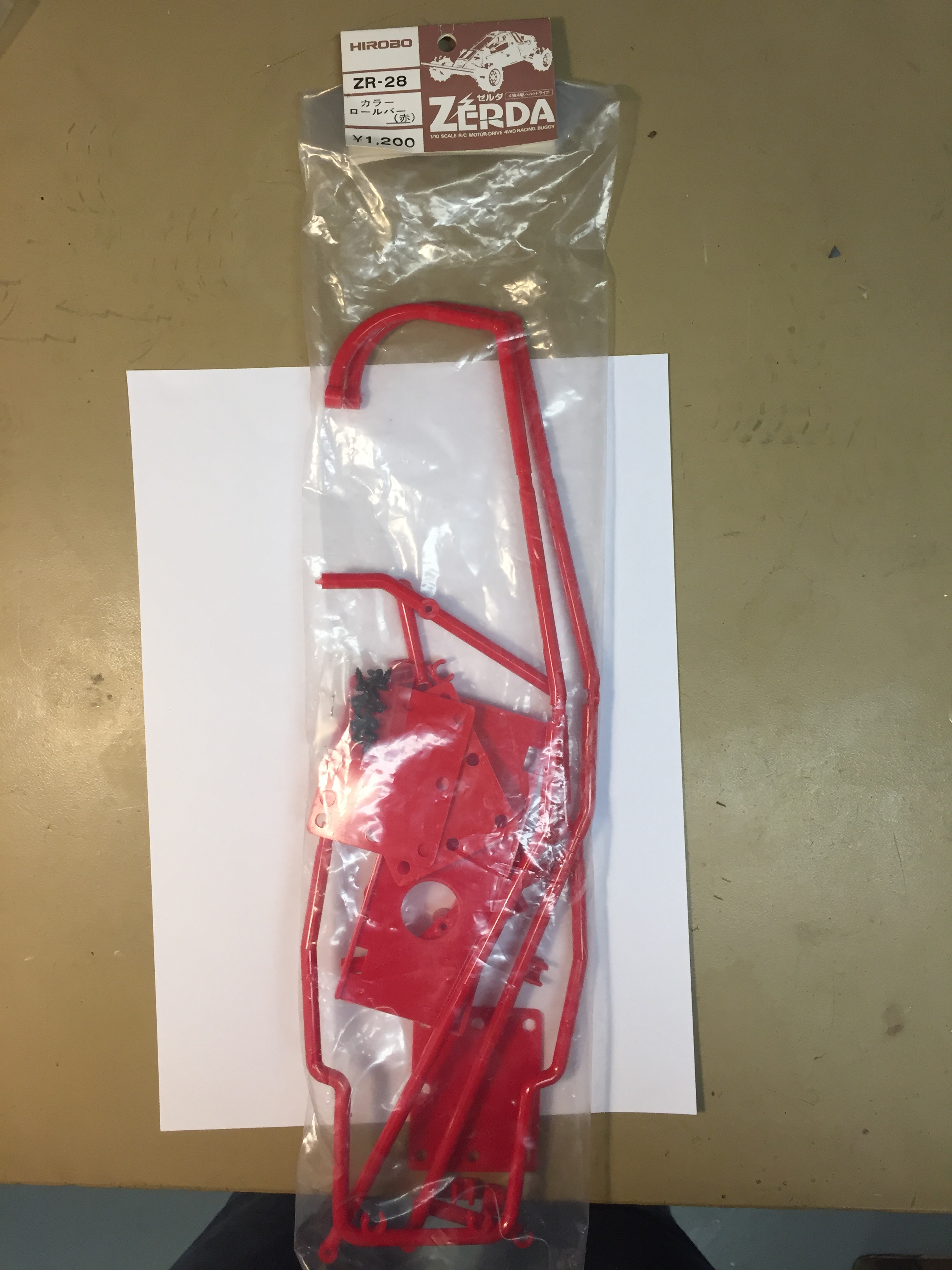

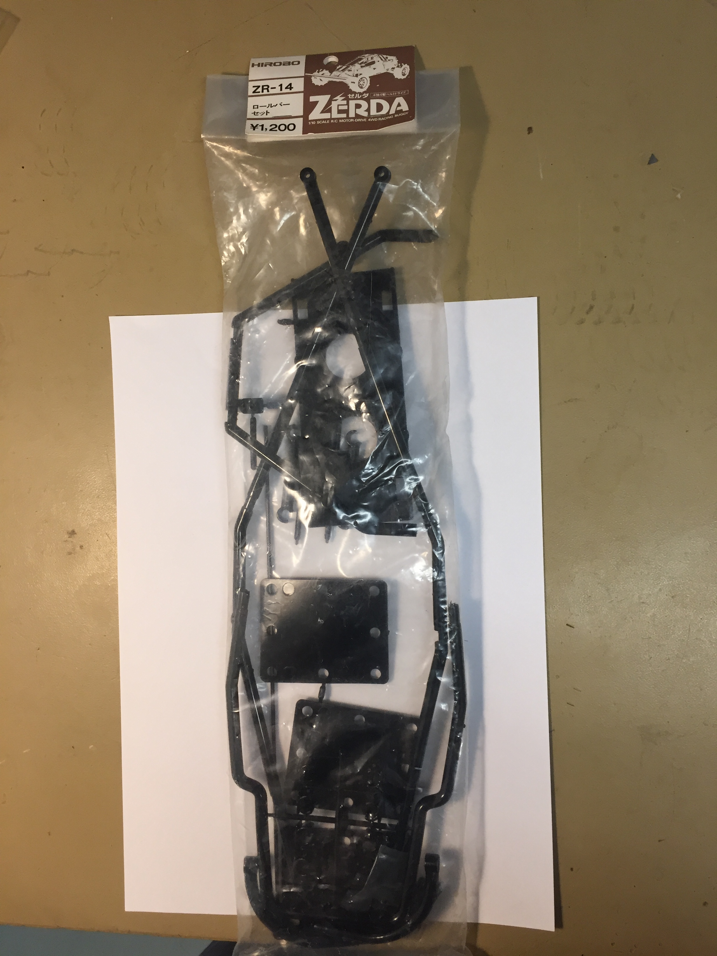

Hello,
Nice ride you have there! I have 3 new cages in different colors, red and black I have seen before, but not yellow?
Peter
Peter
