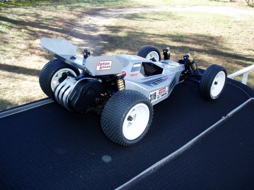

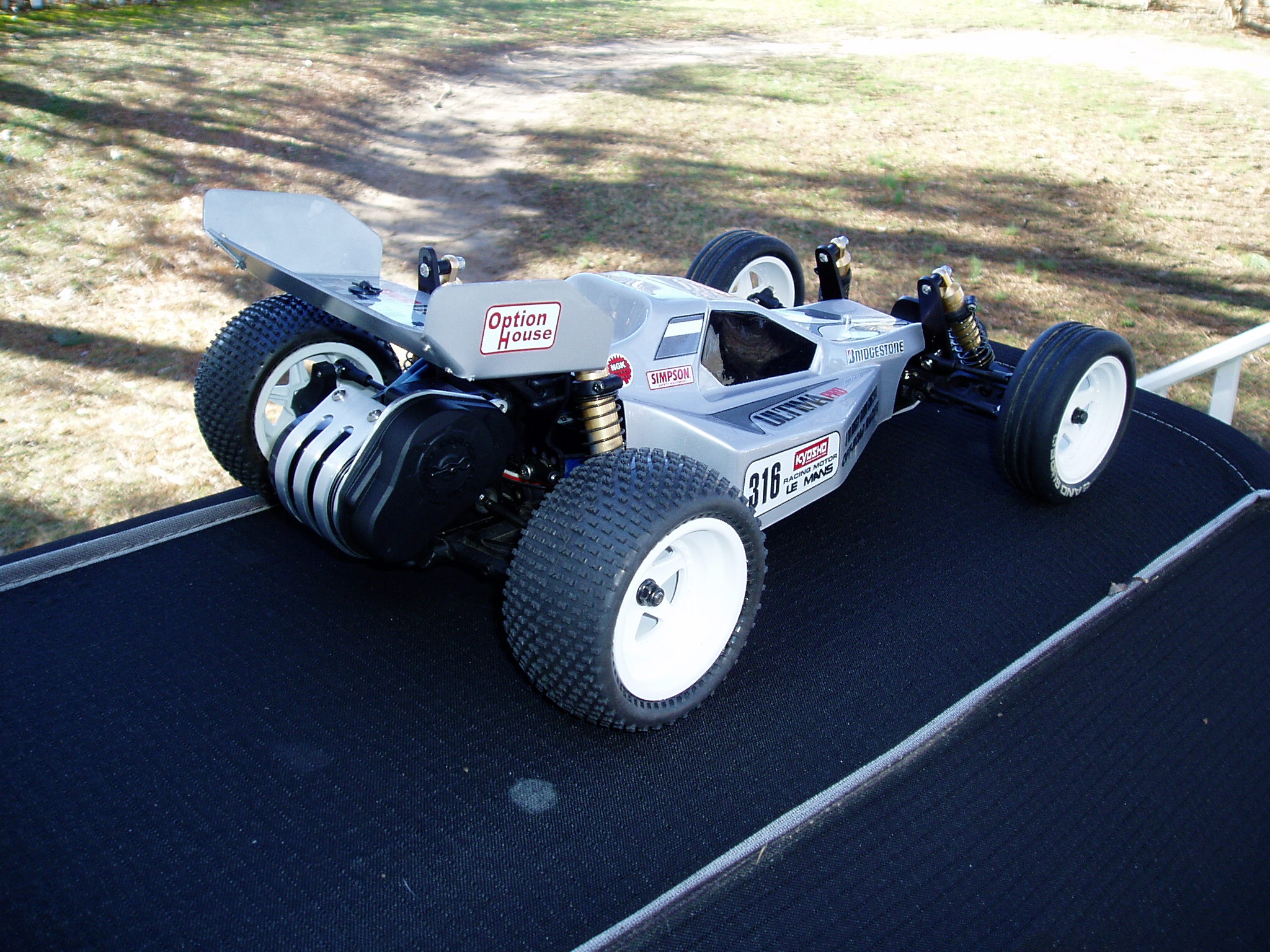

Kyosho tires removed, wheels cleaned and a fresh set of Bow-ties mounted and ready to go.
I'm trying a different set of springs; Kyosho blacks (rears are .039" wire, 12.5 coils) - a little softer than those AE silvers. These might be too soft but we shall see.
We had storms roll through here over the weekend and drop a ton of rain. Just waiting for the track to dry - low spots are far too muddy to drive on.

Well those softer springs seem to be just what the doctor ordered.
The car is very stable and predictable over the roughs and jumps.
Now, I need to focus on reducing under-steer and the car's tendency to wheelie.
I think a little weight added to front might address both problems.
It's a shame that I no longer compete - I think I could be competitive with this car.

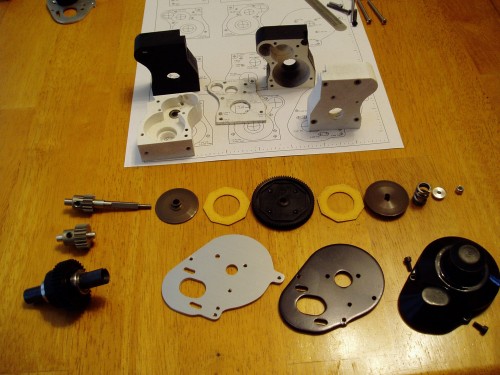

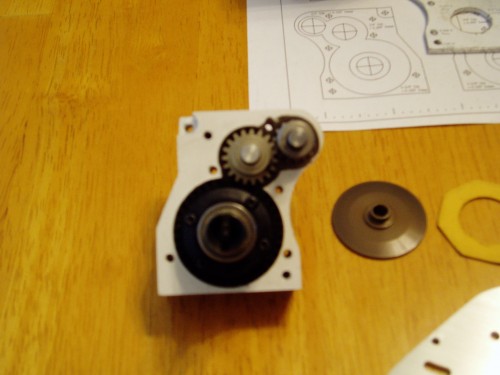

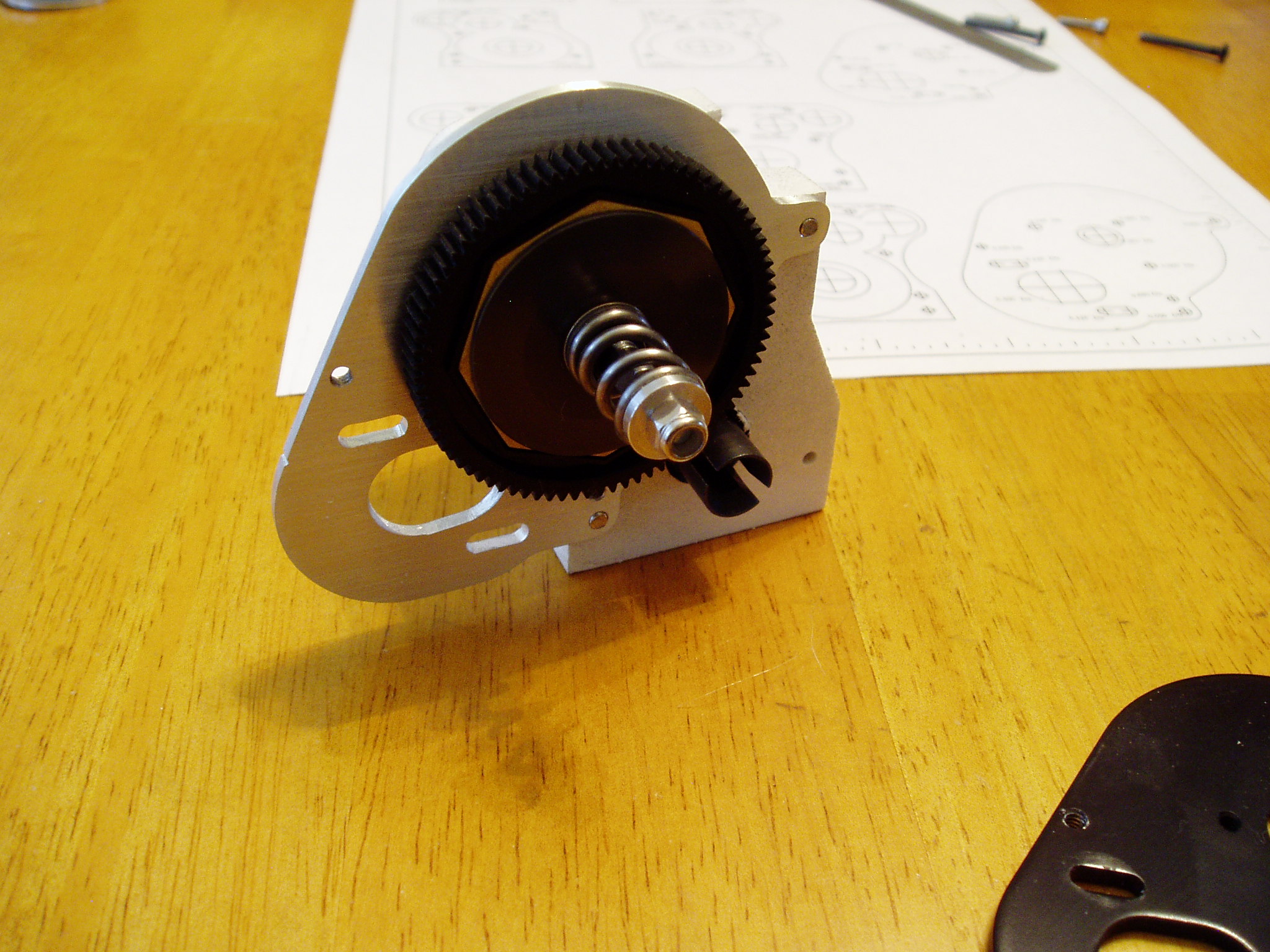

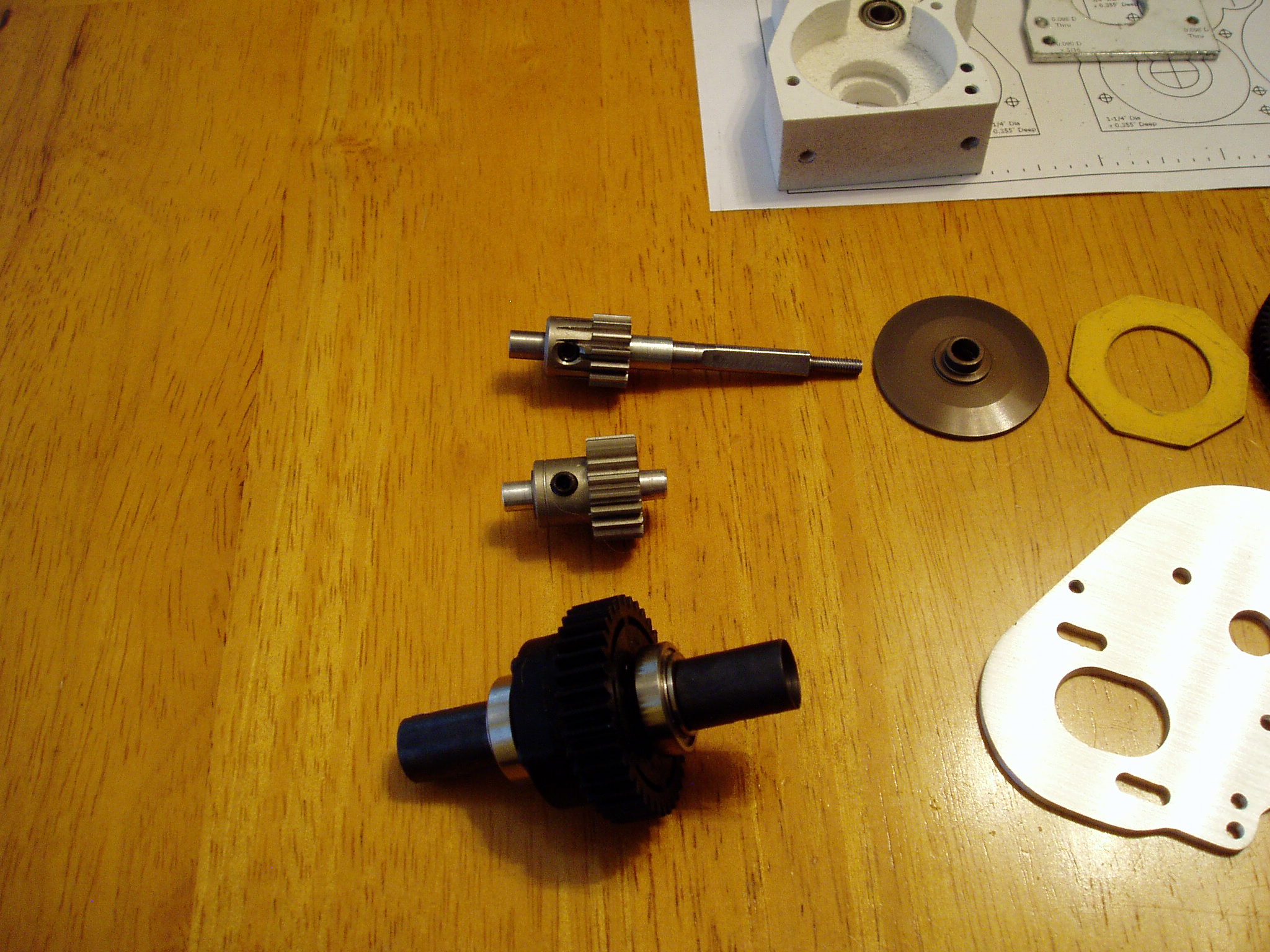

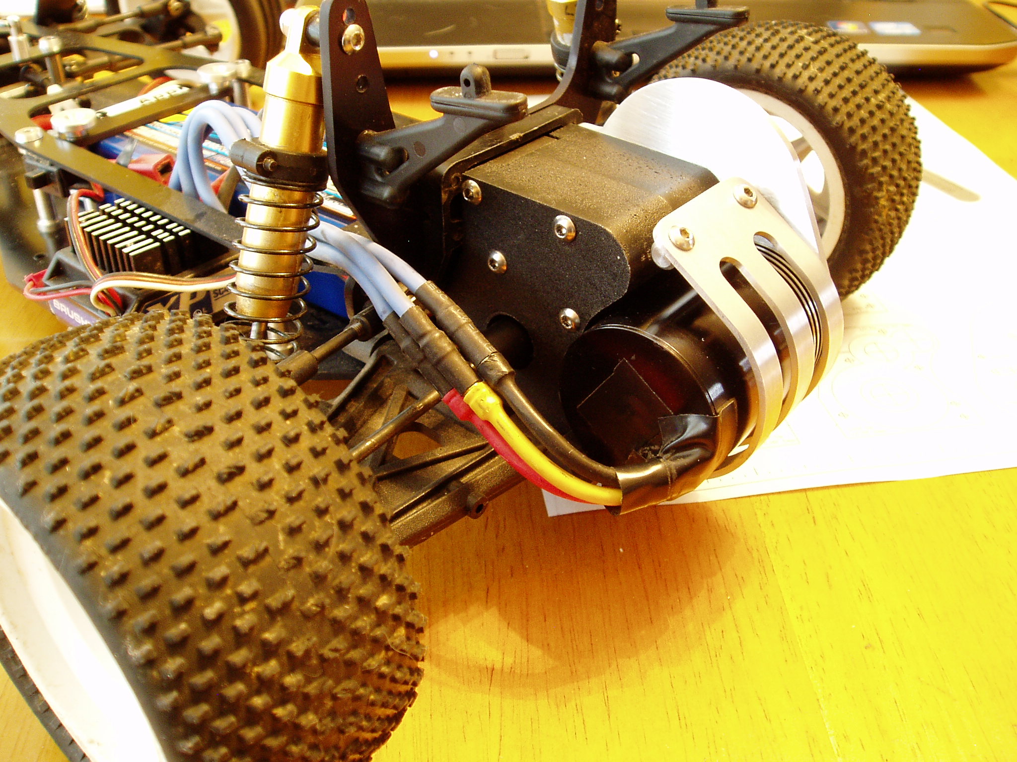

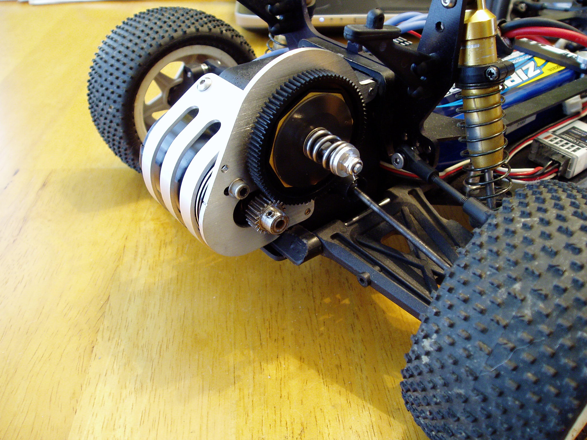

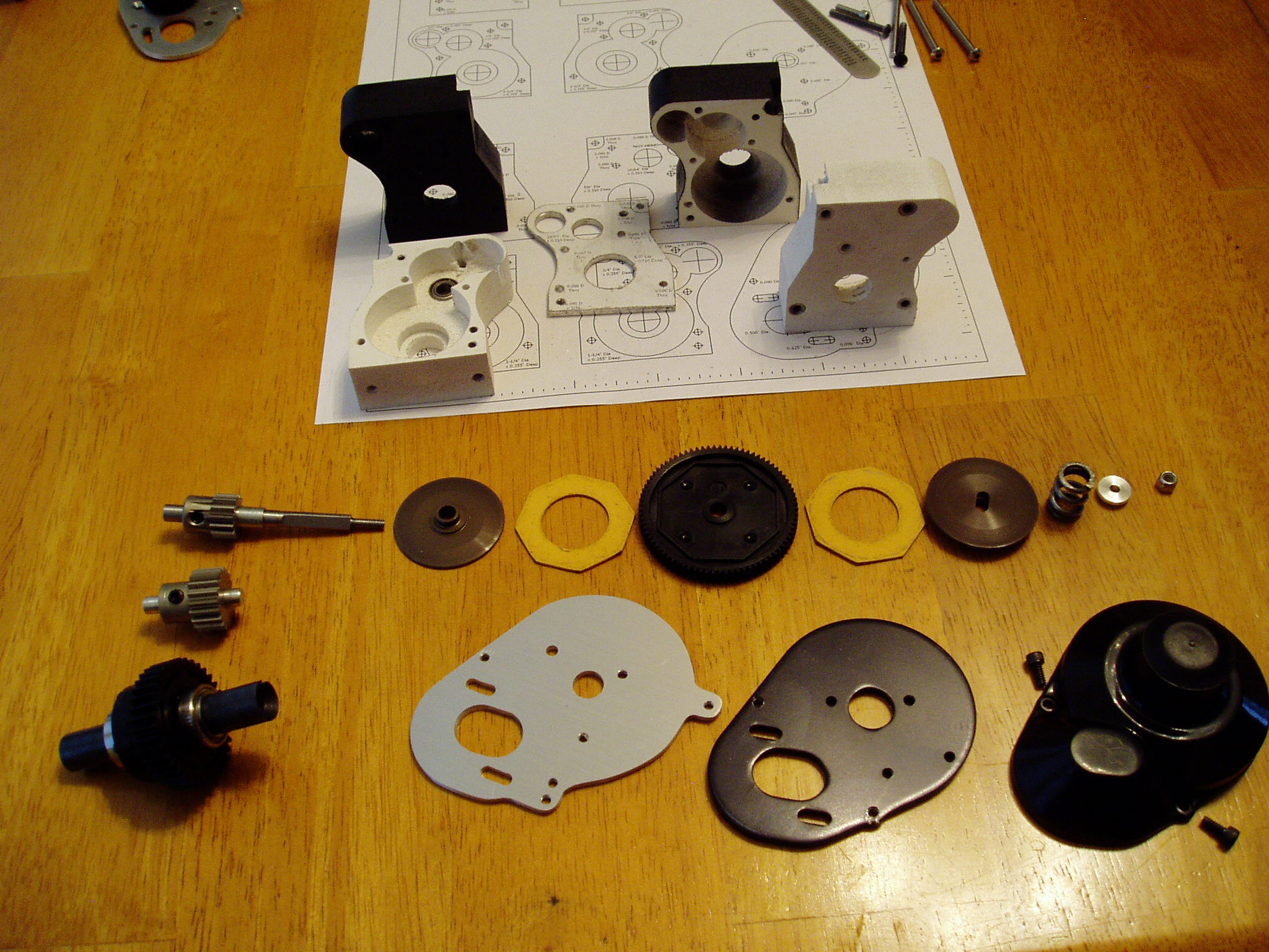

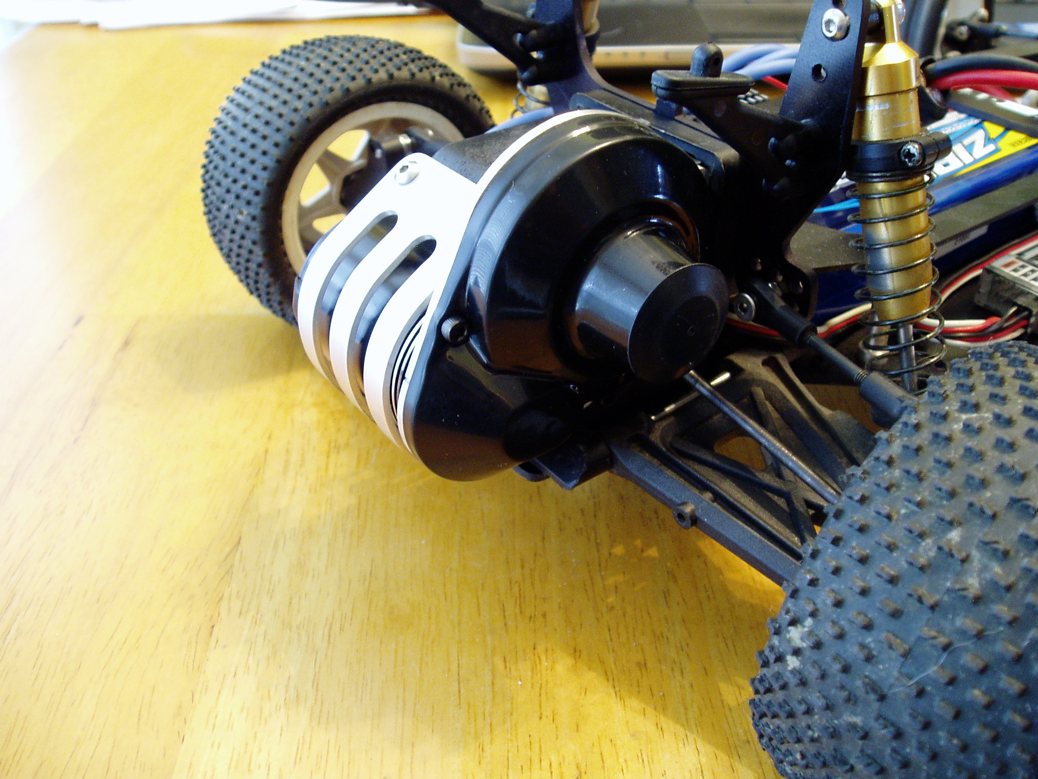

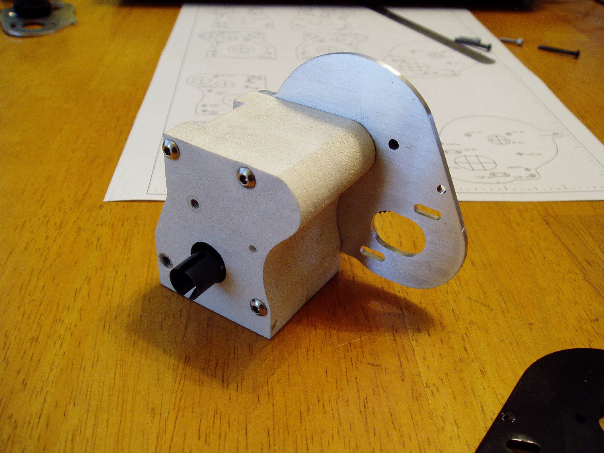

I think I’ve found a solution to my gearbox problem that doesn’t require harvesting parts from my re-re Ultima.
The design centers upon a large 14-tooth steel pinion made for a 5mm shaft that I’ve had rolling around in a parts box for a while.
The main shaft, idler gear shaft, motor plate and cases are scratch-made, spur and slipper parts and gear cover are B4 and the rest of the transmission is vintage Ultima.
Sorry for the blurry image.
The resulting gear box assembly deletes the plastic spur gear cluster (which was going to fail), incorporates a slipper clutch, and is probably much closer to the weight of the original gear box than the re-re; with its massive metal differential assembly. The ratio is 2.64:1. Since the spur gear size is no longer fixed, I'll also have a much greater range of final gear ratios from which to choose.
I've made two case sets and the better one was painted matte black and installed in the car.
I’ve ran the car for about 40 minutes total this afternoon on a damp, high bite track and it seems good.
Having a metal main shaft gear and idler gear should make for a more reliable unit. The plastic diff gear has been holding up fine.

Very nicely done !

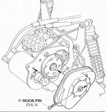

Being a total Kyosho noob ( aka AE snob) I have tried to learn how the original trans was set up.
It seems as though better than half of the gear train resides outside the case and under the gear cover with no slipper.
Only the top shaft and ball diff were in the trans?
If so, what an improvement!
Chuck
