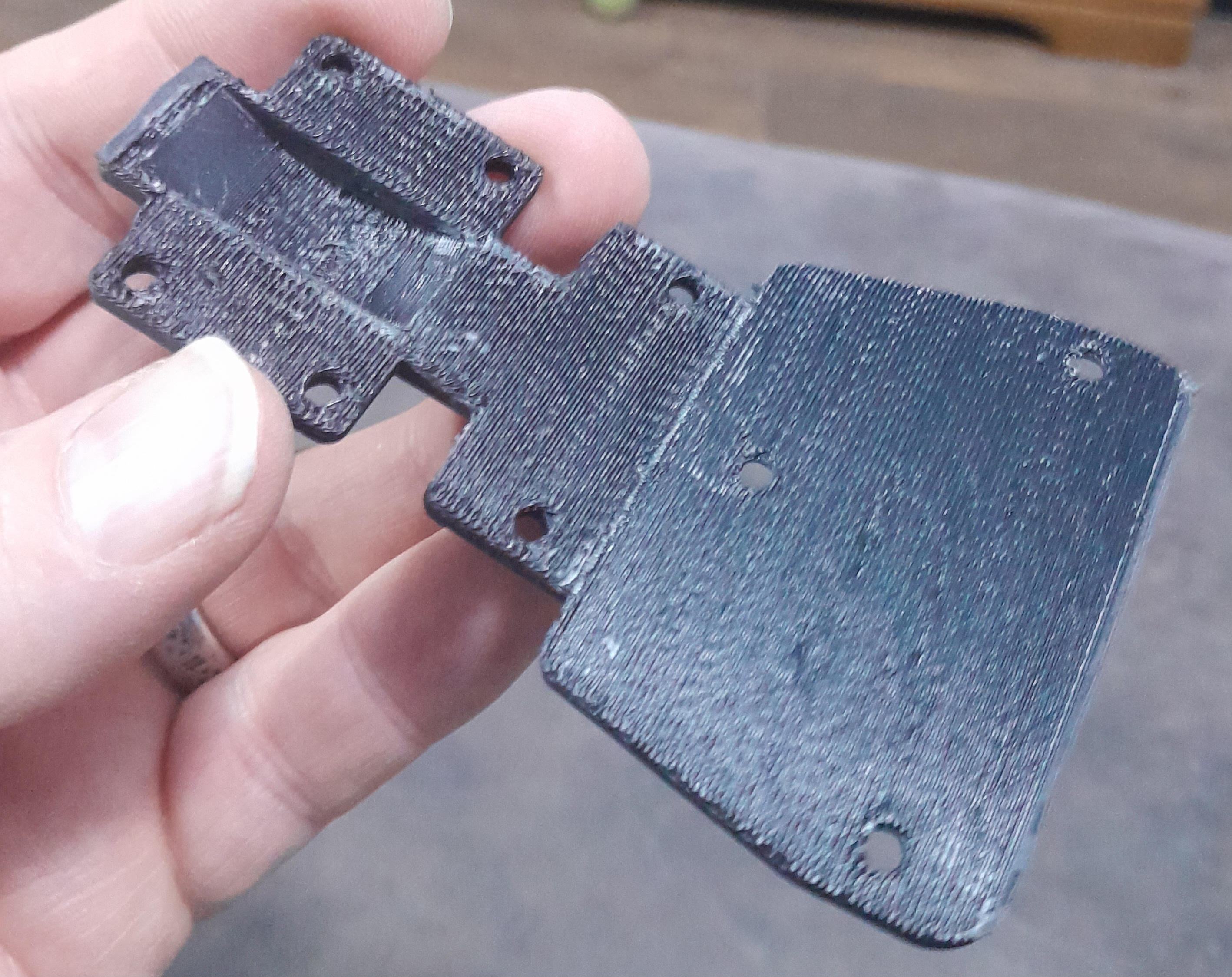

Just printed this Mini Mustang bumper mount in PP , entirely printed on support material , I thought it would be a thorough test of how hard it would be to remove the support material , I was pleasantly surprised , while it's not the easiest it was not as bad as I expected and the print surface after removal is acceptable .

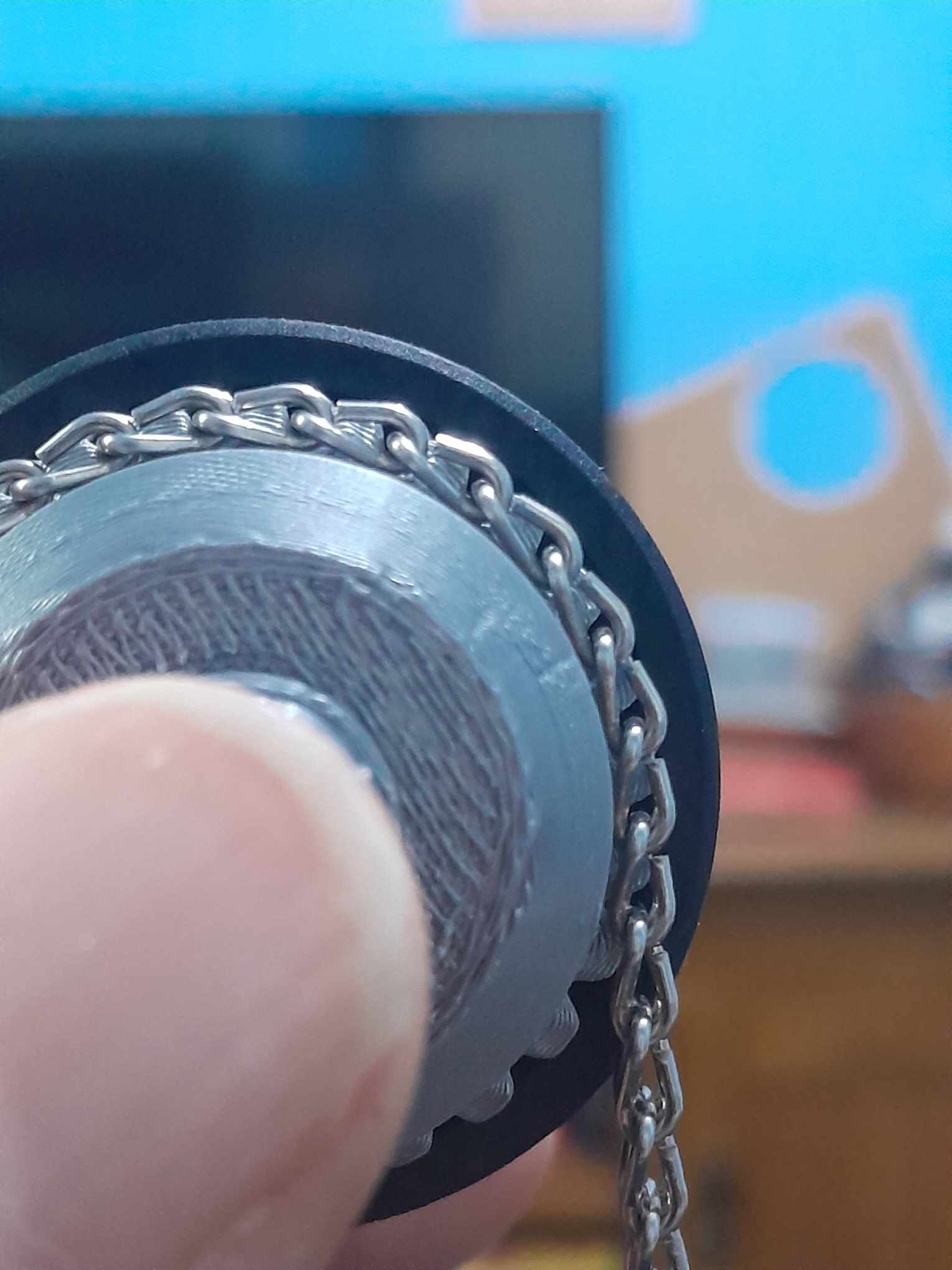

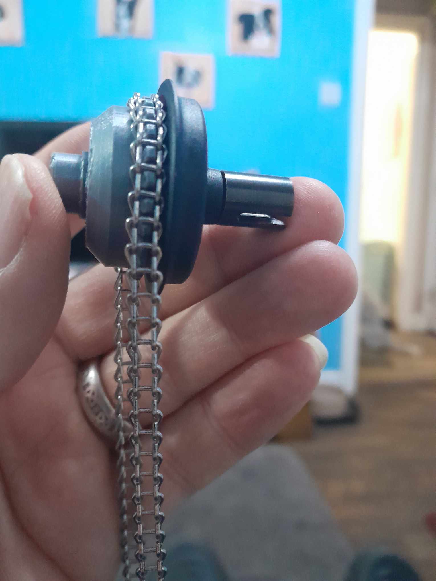

coxbros1 wrote: Thu Jan 25, 2024 8:10 am received_1315938979113103.jpeg
You guys wear the funkiest jewellery... ;)

Ladder chain bling all the way baby 8)

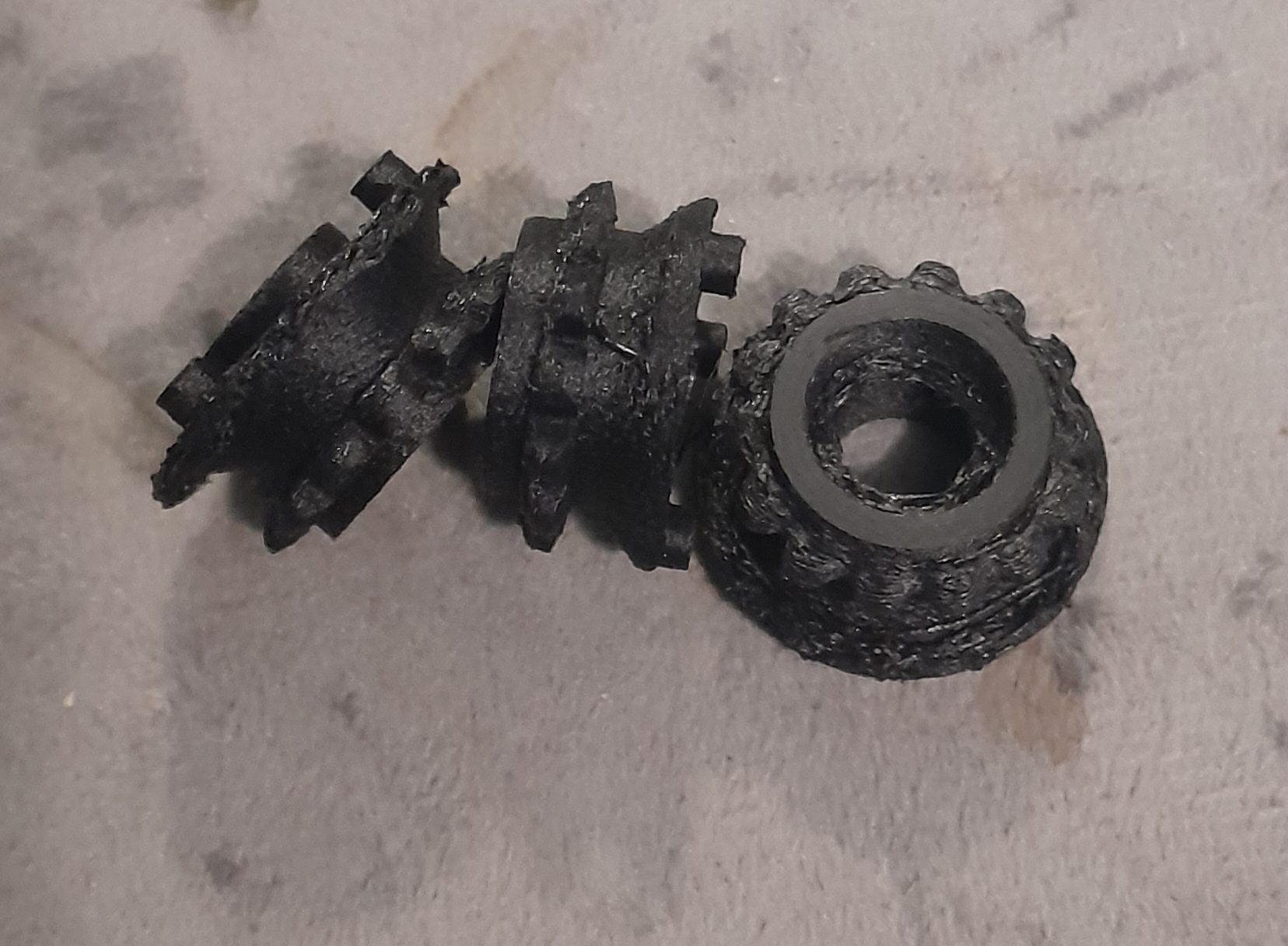

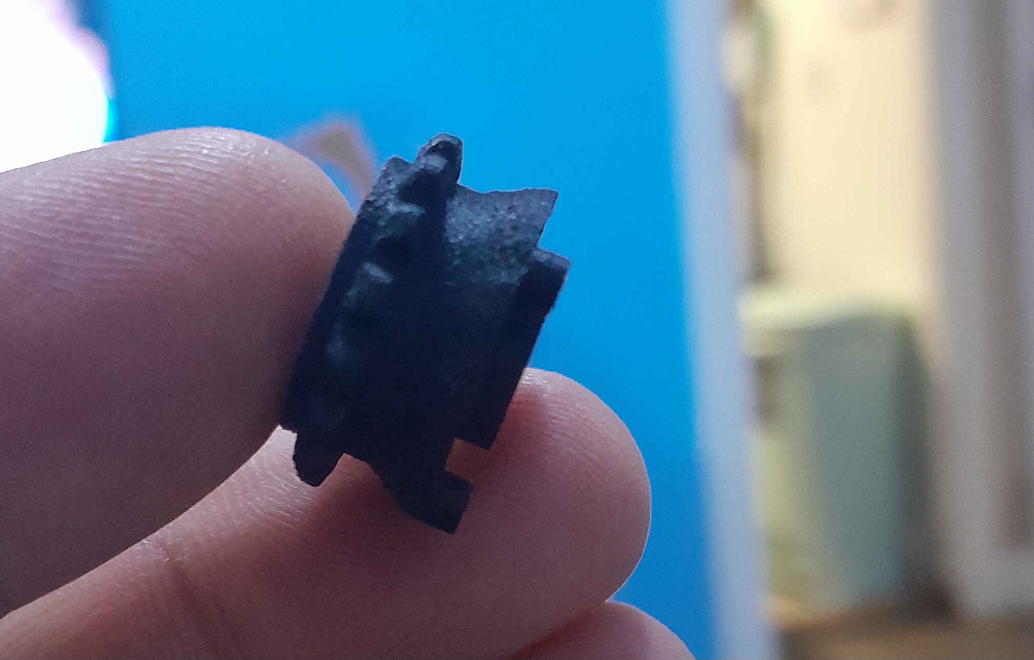

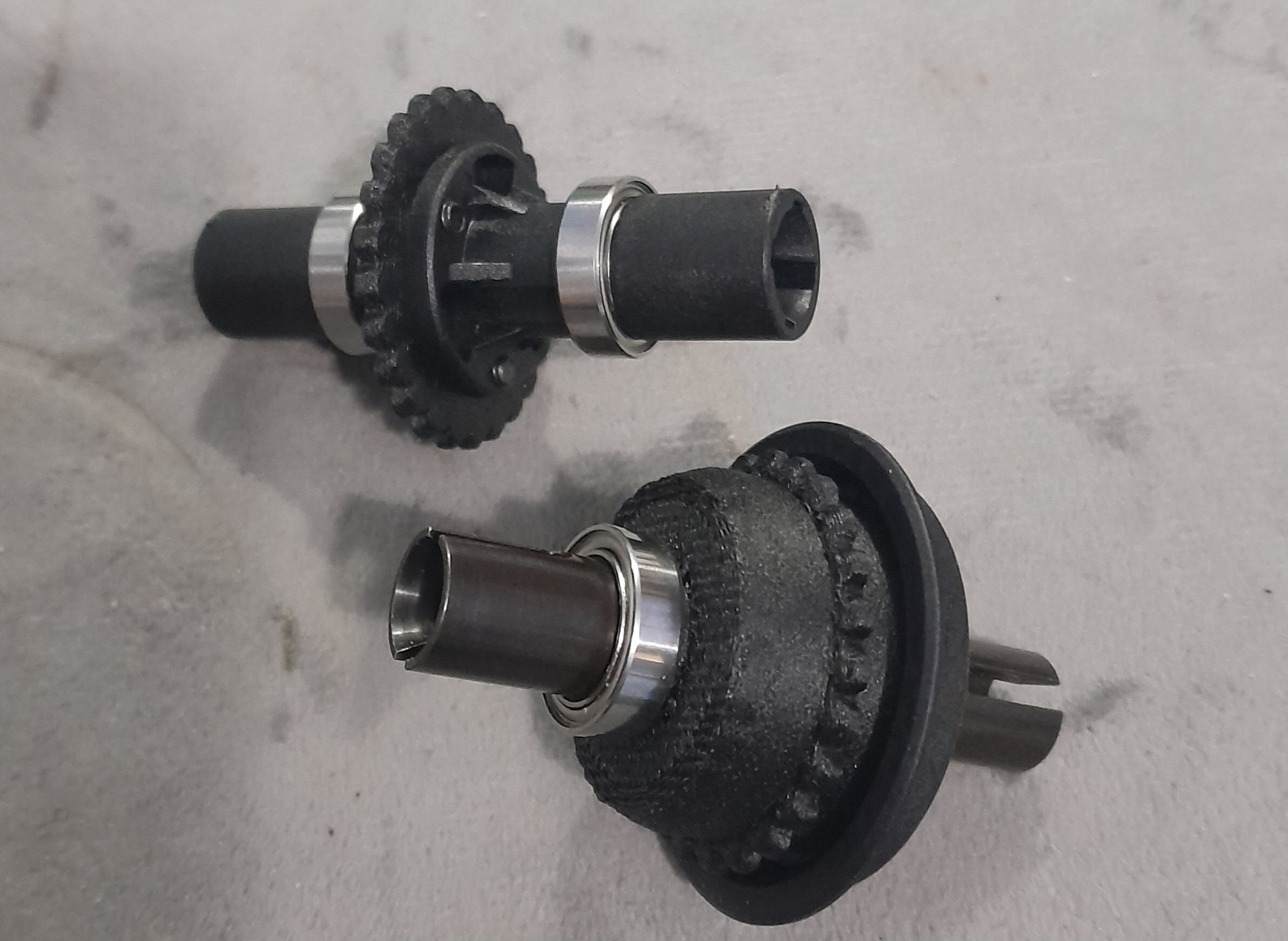

First CF Nylon parts rolling off the printer , diff is diffin, front spool is spoolin , having fun and games with the little sprockets that link up with the spur gear , proving challenging to get a clean print , if they were SLS printed at a pro shop they'd be good as gold but it's proving to be niggling to get clean home FDM prints .
These are the good bits .
This mess is the little ones to go on the spur , three slightly different iterations, fourth is on its way now , fingers crossed

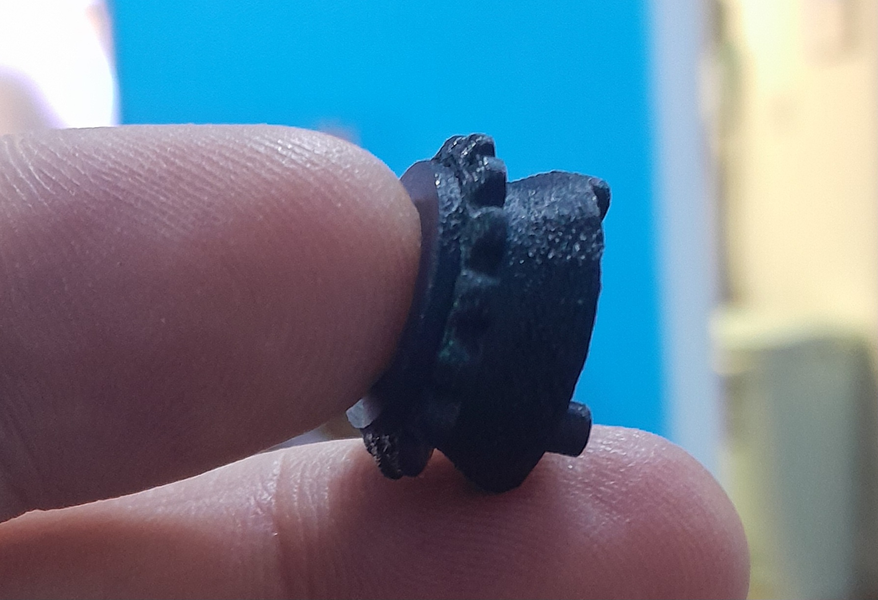

Getting somewhere , a little nudge down in temp and it should be good .

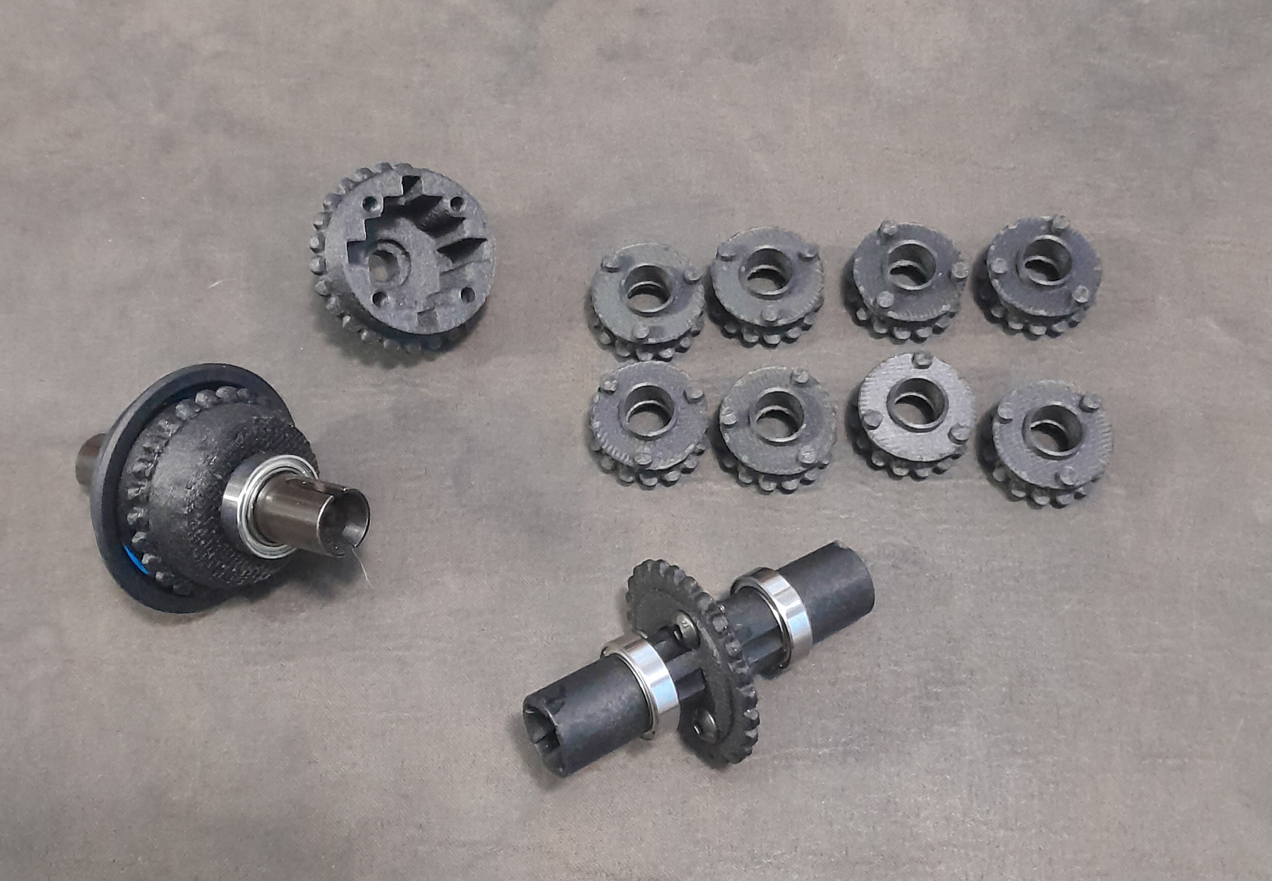

Production has begun , two more diffs ,3 more spindle sprockets and a bunch of display parts . All for Coxbros team racing .
