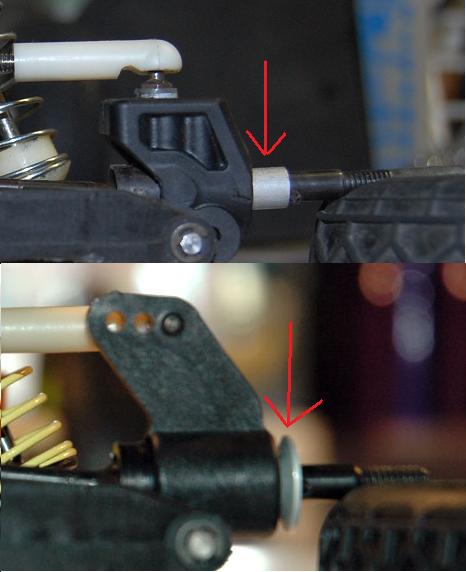

Let me see if I can find my old pictures....no, deepening the inner bearing hole & the hinge pin hole, then use B4 CVDs, not the shorter B44 CVAs.

Re: help with vintage rc10 racing
i got the b44 cvd in the buggy. i tried a set b4 and they was too long when compressed. i didnt deepen the bearing holeJK Racing wrote:Let me see if I can find my old pictures....no, deepening the inner bearing hole & the hinge pin hole, then use B4 CVDs, not the shorter B44 CVAs.
found it...on top, deep milled B4 CVD, on bottom, B44 CVA
hey jk racing my buggy looks like ur bottom pic but i got 5 washer behind the spacers.
