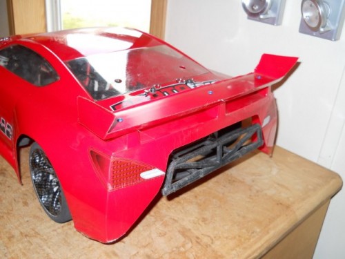

A friend of mine (andymac0035) was trying to get 100mph out of a Slash 4x4 and finally reached 99 mph. One thing he learned and this might help you is he cut the back area out so the air could pass through. See photo. It might help keep yours on the ground as well.
Jeff

The civic body is cut up to the top of the rear bumper. On the lumina body I had an idea of making a venturi tunnel on the back with the lexan. With a smooth bottom I really shouldn't need to cut out the rear but will need to depending on the height I make the tunnel.
