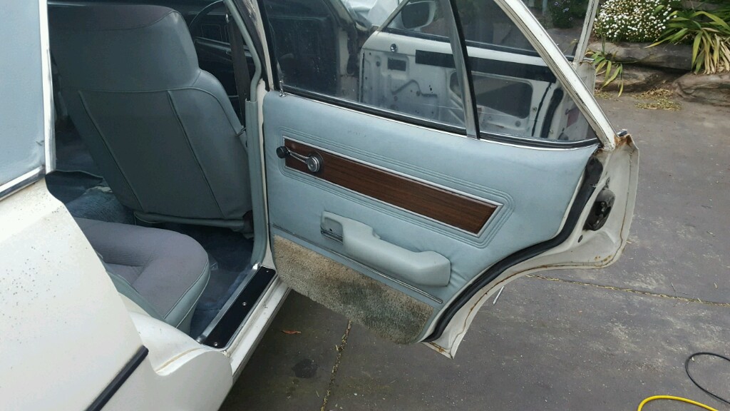

Post by RC10th »

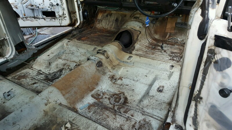

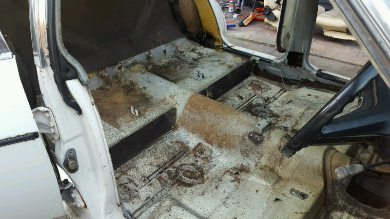

I left the car outside locked up over winter, which has been quite wet. Needless to say the interior started to get a bit of mildew on it from the carpet being wet and unable to dry. I got it in time as everything is savable, just needs a good clean. Seats, carpet, jute padding, plastic trim, door panels, seatbelts, console etc have all been taken out. Not everything really needed to come out but considering the car is close to 40 years old I thought it could do with a good and proper clean.
While I was at it I cut out a filler panel from a donor car to replace the console shifter hump. This gives me a bit more clearance to fit a ratchet shifter under the factory console.
Most everything is ready to go back in, just need to give the "bare shell" a good scrub before everthing goes in. I'll also have to get the windsheild channel fixed as soon as the car is back on the road.
Doing everything by yourself kinda sucks, it takes ages and sometimes some clever thinking without an extra pair of hands.

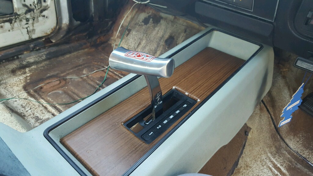

Finally got the shifter mounted which was way harder then I had hoped....

Looking good! Thought you would have cleaned and touched up the floor first though? :?

I can still do the floors but don't know if it's worth it. They are still solid for now. Bolting the shifter in was pretty major but the console has to come back out to install padding and carpet.

I've used rust converters before but have never seen that one. I've gone this far so why not do a bit of preventative maintenance? The car isn't really worth saving but..... The floors look worse in the photos then real life.

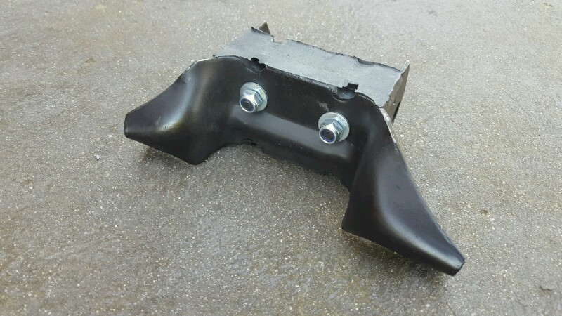

I modified the passenger side engine mount with a little old school drag racer trick. I bolted the rubber mount together which should still offer some cushion but wont allow the mount to completely seperate.
Broken engine mounts suck as the fan takes out the radiator shroud, upper radiator hose and in my case the air cleaner will hit the hood.

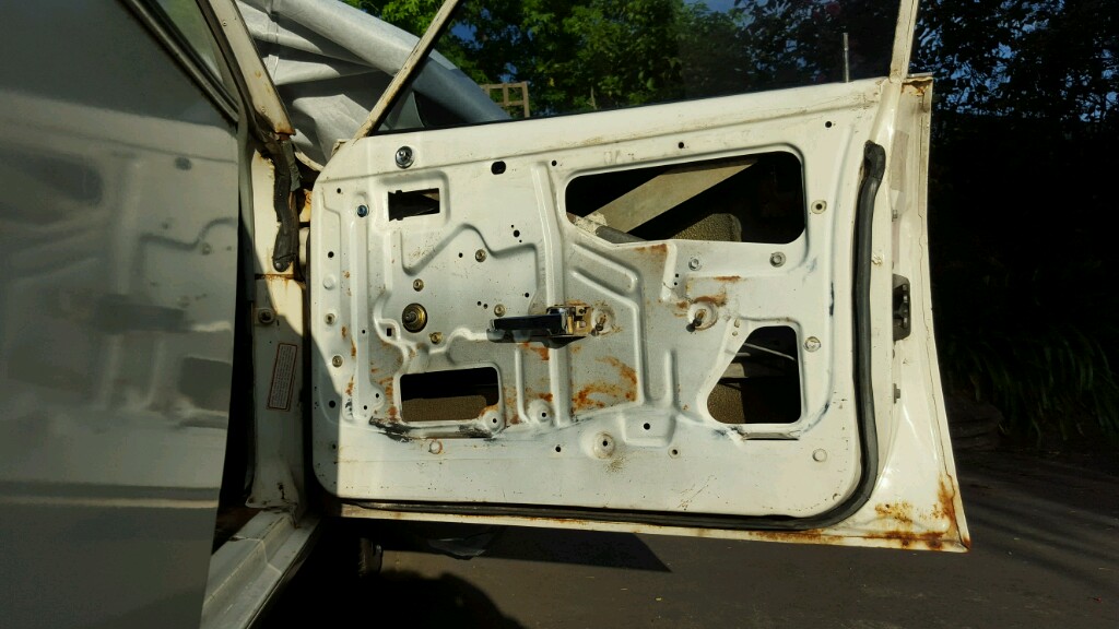

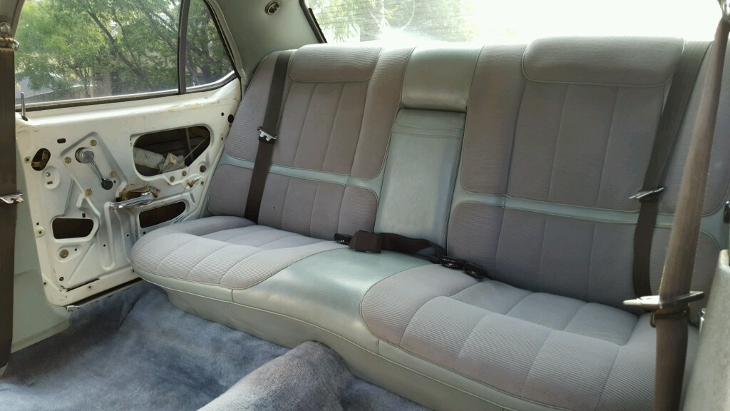

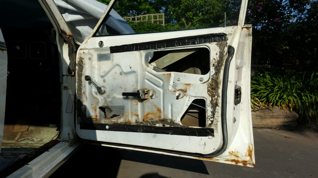

Made a bit more progress, I pulled all the broken moisture barriers off the doors and cleaned off all the mastic. It was quite a messy job but now the doors are ready for new sealer to be applied. Unfortunately I rang all over the state trying to find a non hardening or skinning butyl sealant. I finally found some quite a distance away, about a 2 hr round trip and a 1/4 tank of gas. I also cut out some new moisture barries which came out better then expected, so once I get the sealant I can install the barriers and door panels. I cleaned out the inner doors, vacuumed and fish oiled them.
I also installed the rear insulation, jute padding, rear carpet, seatbelts, rear trim panels and rear seats
Getting there...... It's a lot of work doing everything by yourself.

I have been using some simple double sided 3M tape to reinstall moisture barriers, and using sheet plastic film instead of the butyl cord and asphalt paper. seems to work as well or better. certainly easier to apply.

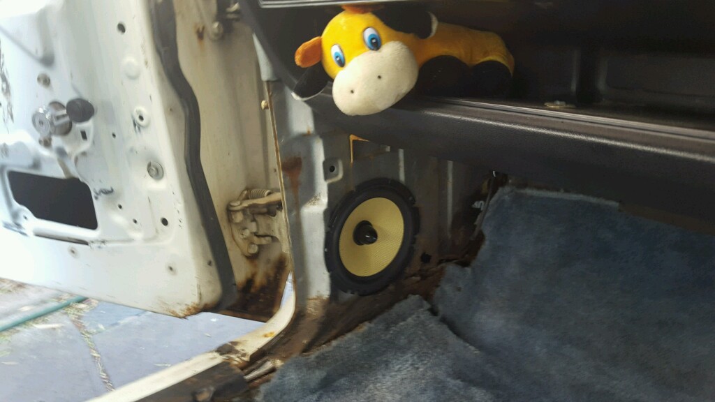

More progress to update. I got front carpet, padding and drivers seat in. Component 6 3/4" speakers mounted, you couldn't fit any larger speakers if you tried. I just need to make 2 small brackets to mount the tweeters.

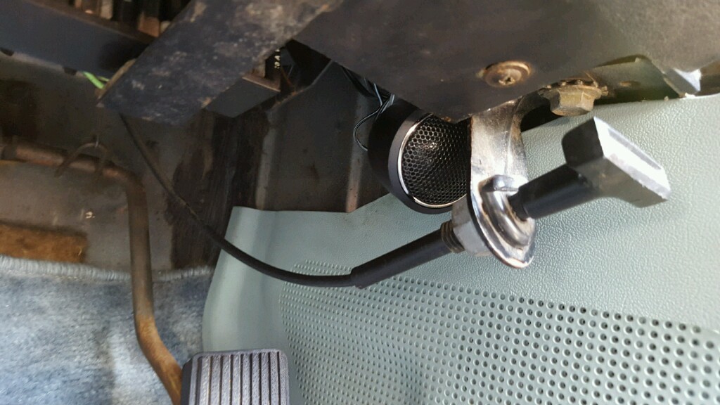

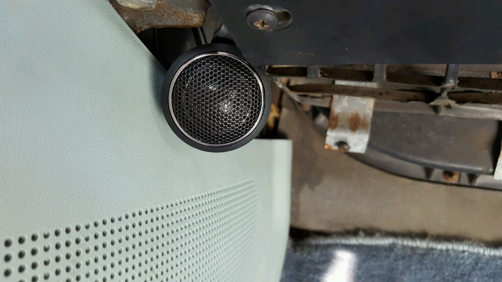

I made some little incognito mounts for the tweeters, I didn't want them in your face so I chose to mount them under the dash. From the seats you can't see them.
