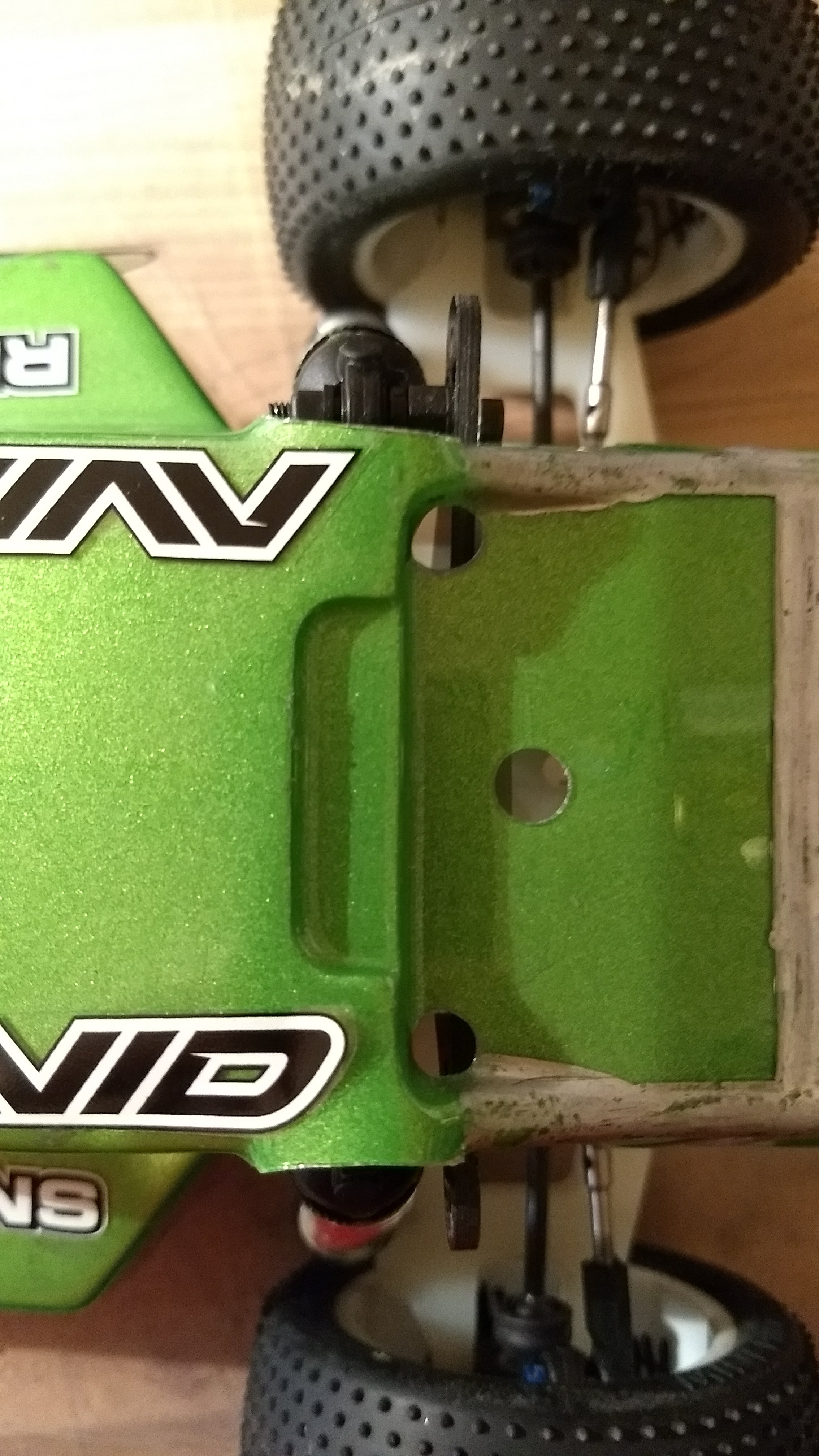

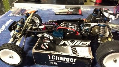

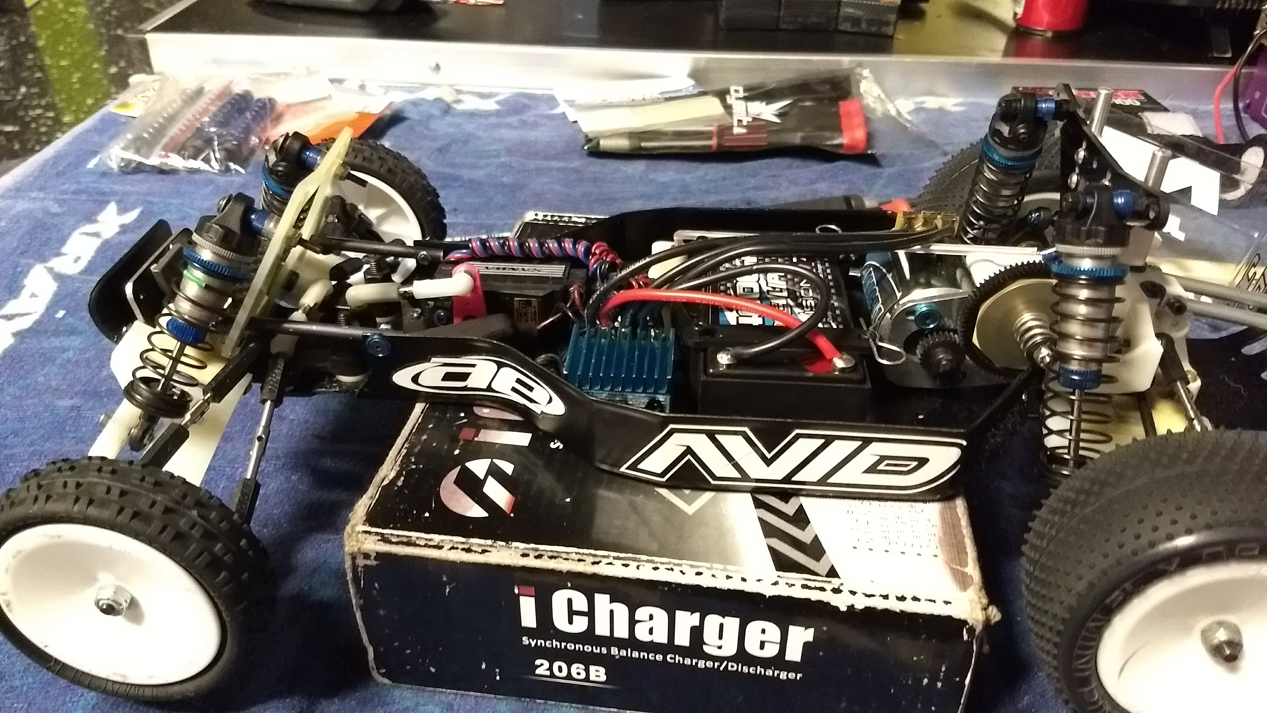

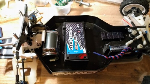

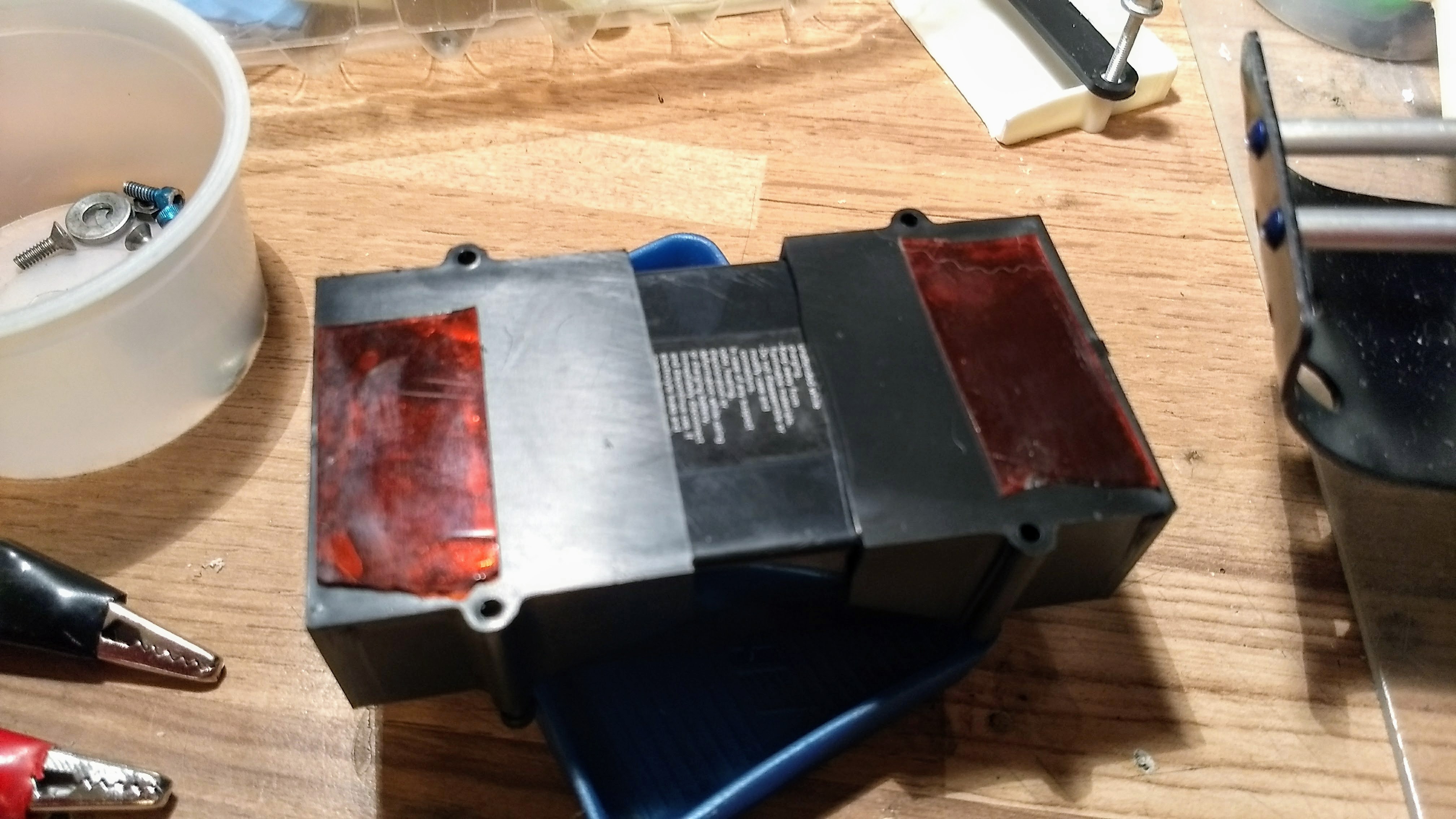

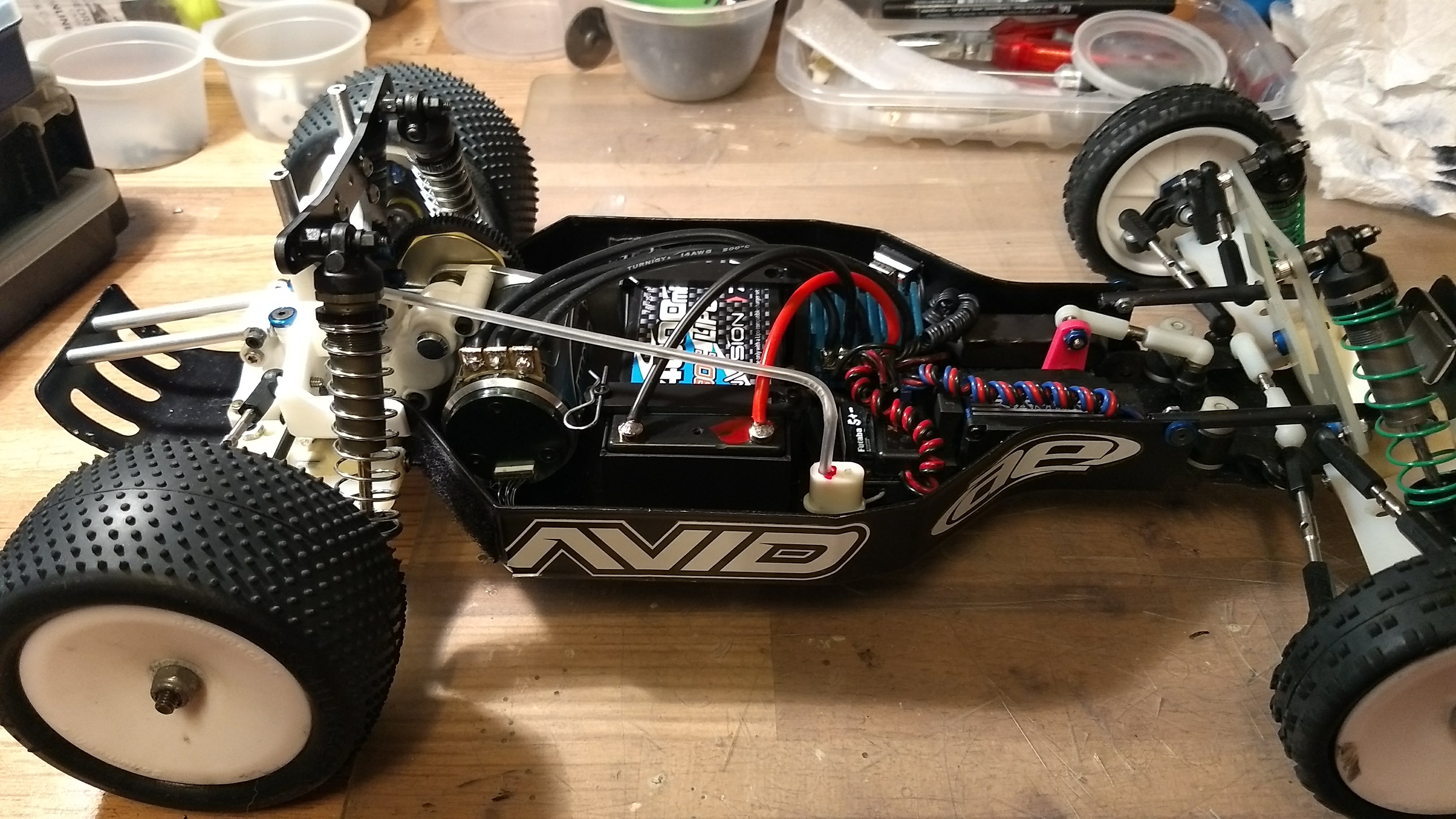

More work on the car the past couple of evenings... Fiddling with electronics placement, which is always a PITA as one wants to optimize while not spending tons of time seeking perfection, at least not on a suboptimal vintage-ish pseudo-racecar :mrgreen:
So, I started with a well known hack :mrgreen:

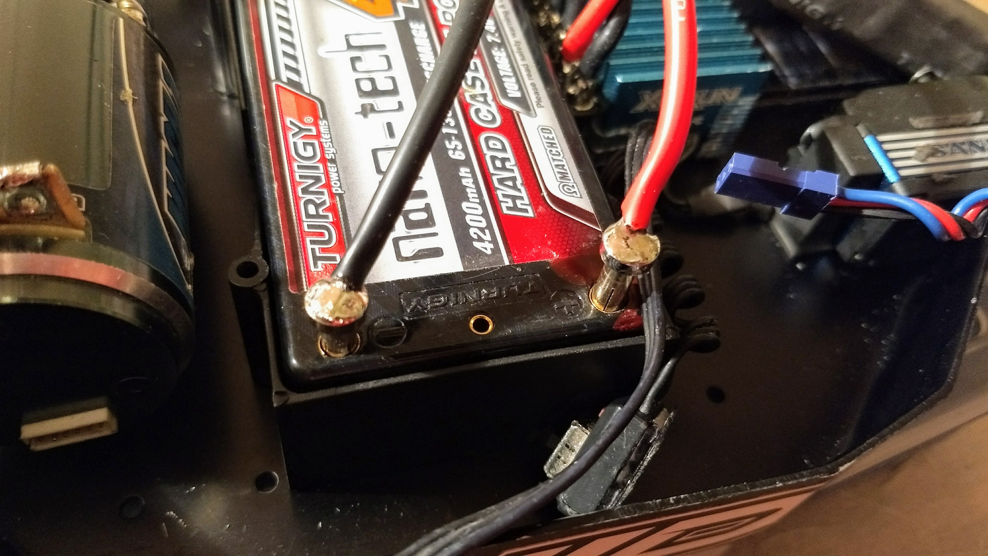

I want to play with different motor placement via spur/pinion changes, so a bit of buffer is needed:
Of course, the neat, tidy and short cables I had resoldered to my controller were too small... needed to pull out the soldering iron, and fit new wires to the speedo, which I abso-freaking-lutely HATE to do... I have an old pack of dubious quality to hold the bullet plugs while I solder the wires so I don't heat up a racepack. Joints look good (and even better in the flesh than on this pic), nice and shiny, homogeneous. Thanks to my 100W Weller :)

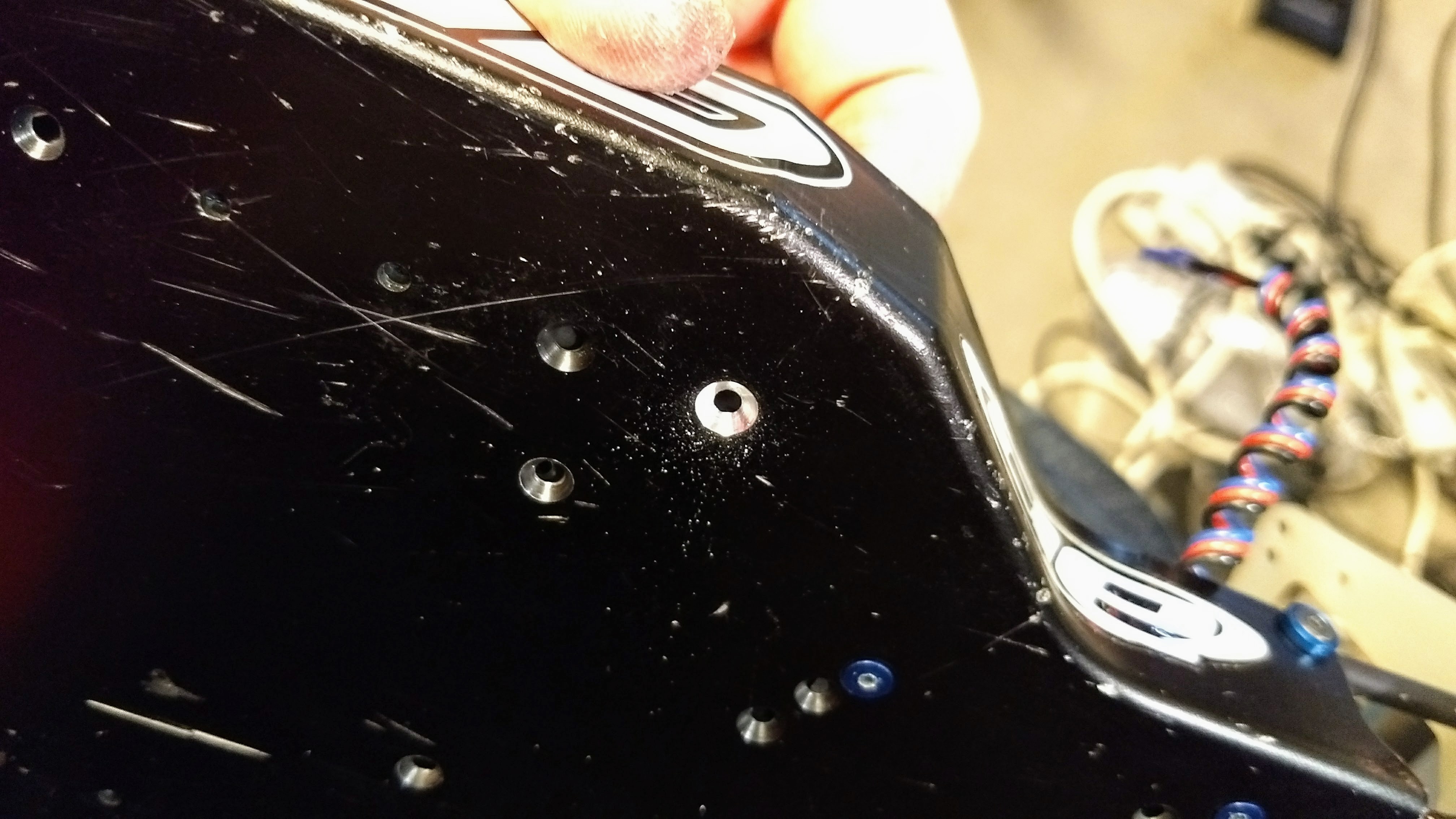

One more countersinking, still, for the antenna holder. I've drilled so many in that bitza's tub already, I thought, what the heck :roll:
At last, all done now. I fitted the shocks as they were after last race to get some reference point, and the damping is an absolute disaster (as expected). Gonna go back to #2 pistons and 35WT oil all over, and start back from there.
Over the next couple of evenings I will fiddle with shocks to get something acceptable on the bench, I won't have time to mount that new body, which is a shame. But bodies don't make racecars fast (at least not offroad bodies...), shocks do. Priorizing 3ds before raceday is key :)
Till next time...

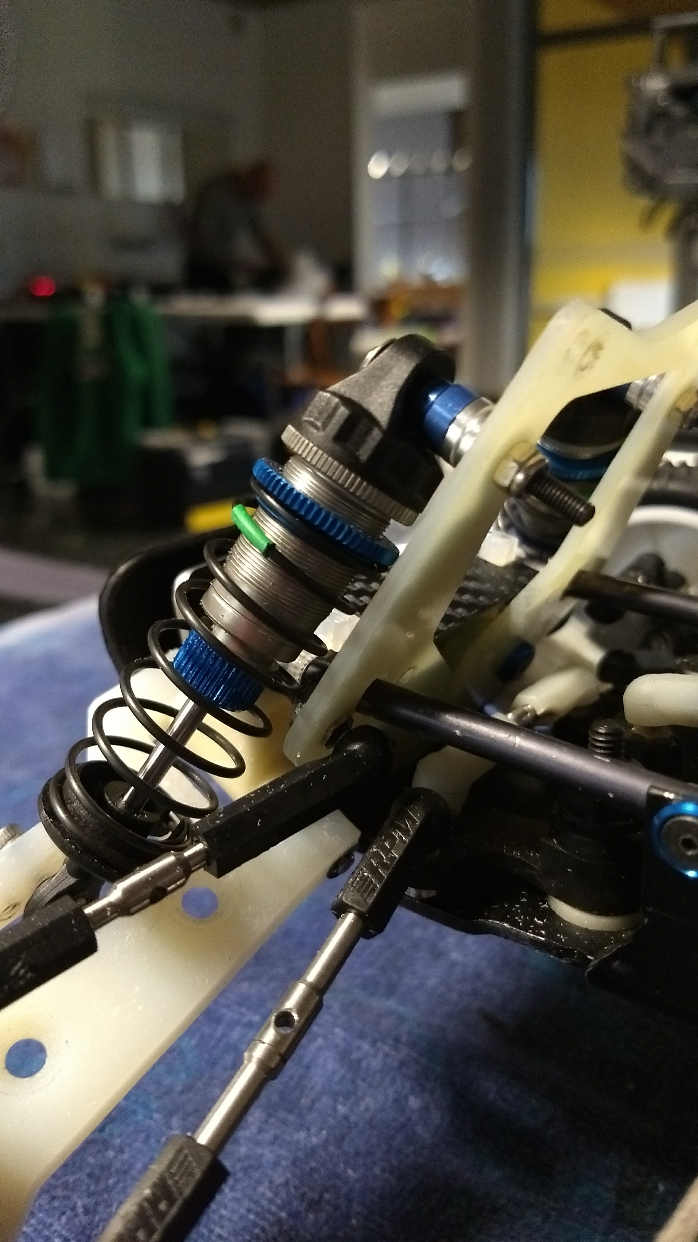

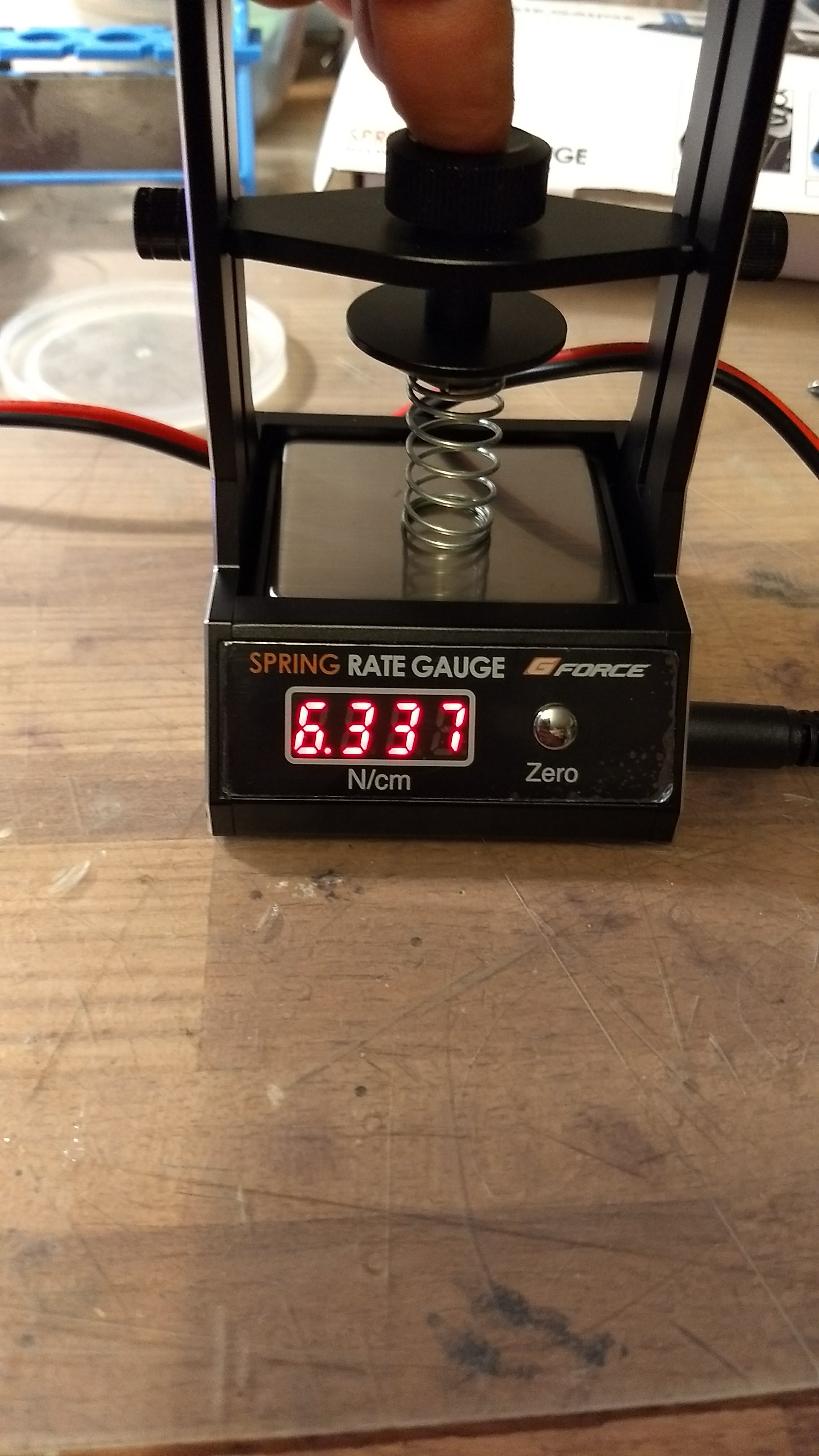

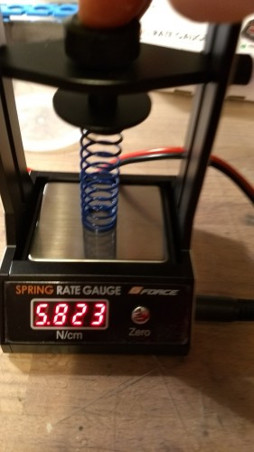

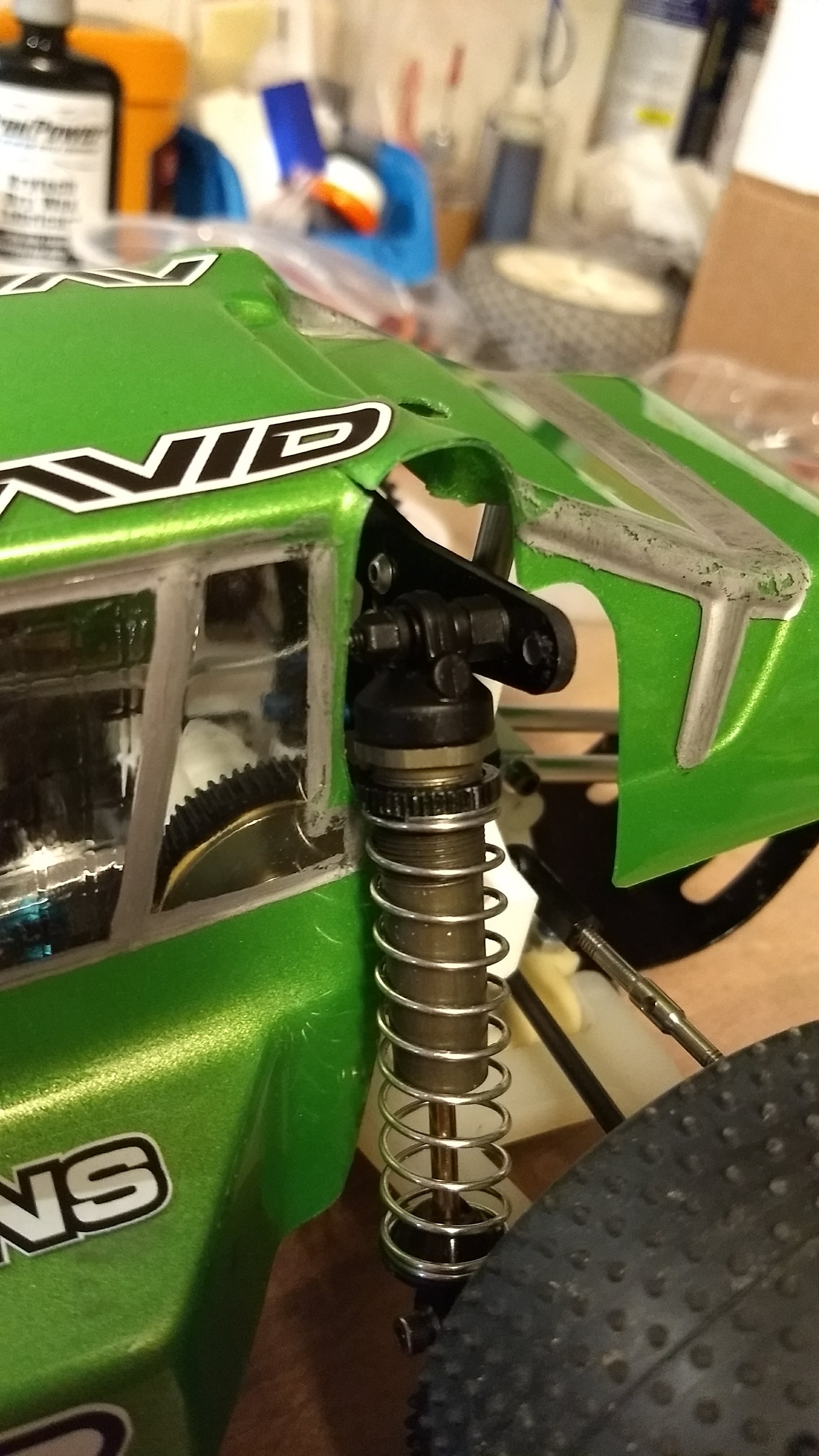

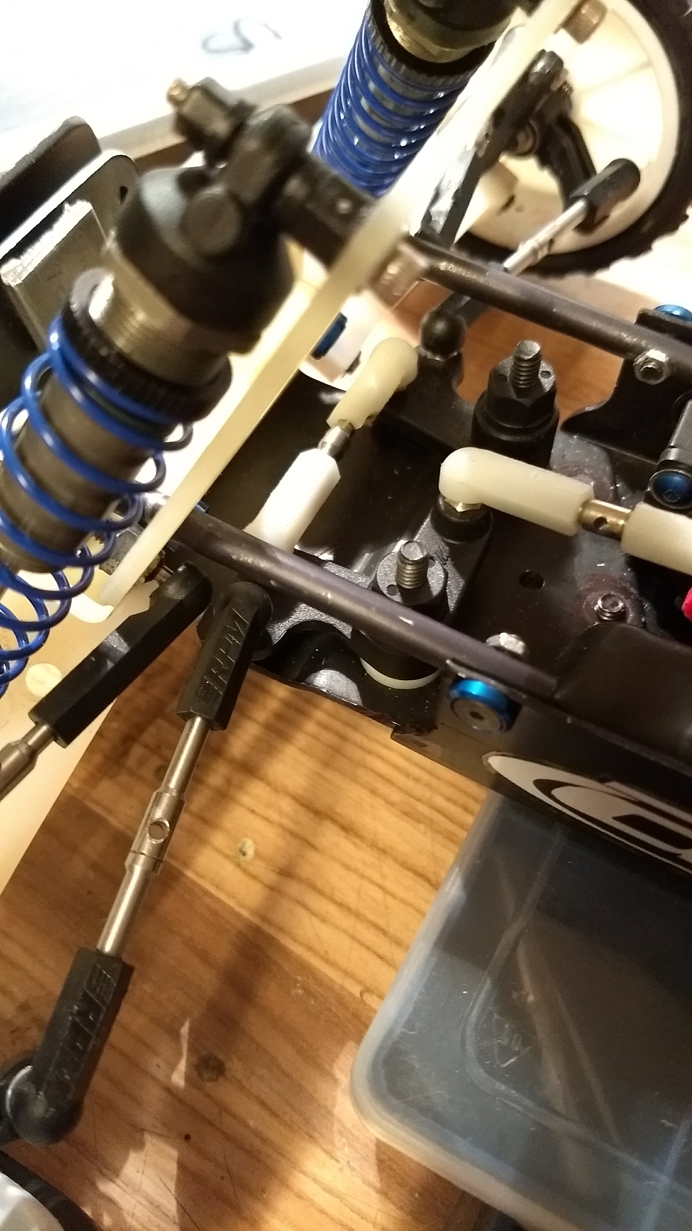

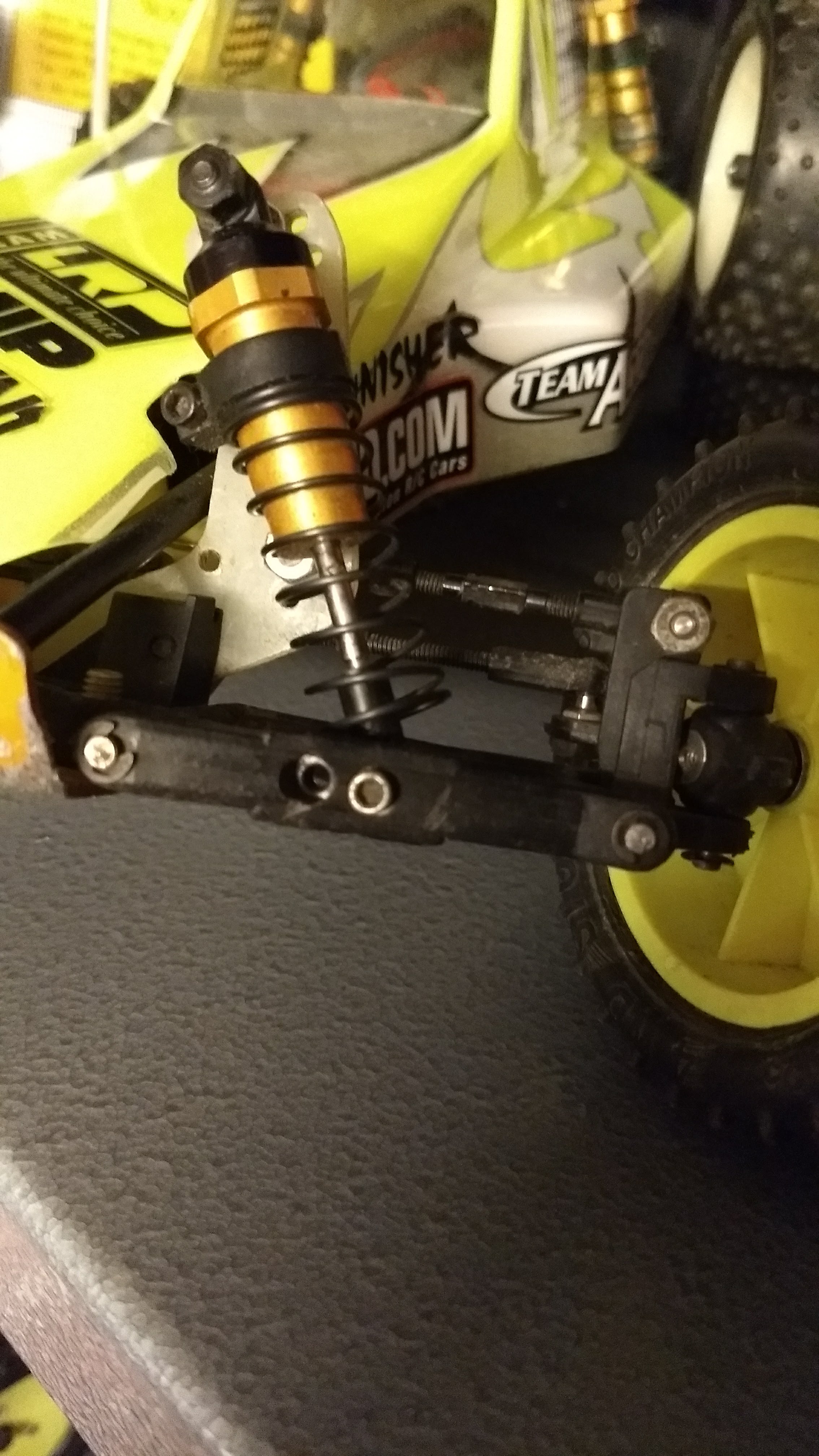

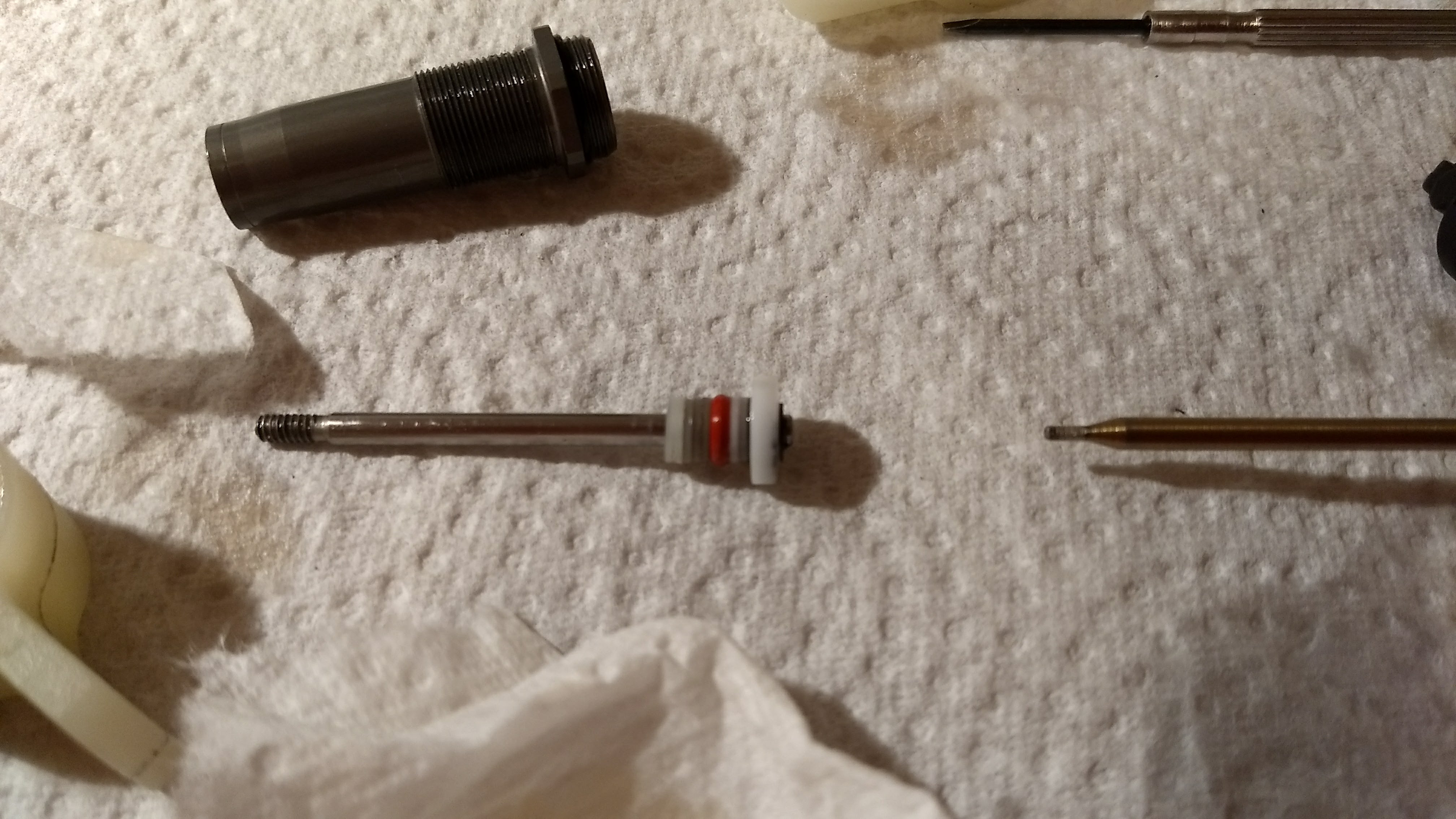

Spent the whole evening fiddling with shock setups yesterday, playing with mounting points (towers and arms), shock eyelets, collars, bottom retainers, springs, oils, pistons...
I even ran out of inner shims :mrgreen:
The front buggy shock springs (silvers) are too short, even with the shock collar screwed to the bottom... and I didn't want to use split collars, not reliable enough esp. on the "conical" part of the shock body. So I had to revert back to front truck ("blue") springs as the closest thing in the range, stiffness-wise. I did tell you I fiddled with stuff, right?
B4 Shock retainers were too long... had to pillage parts off another one of my runners :(
I still can't get the suspension where like I'd like it to be. In the end I have #2 and 37.5 all around. Static is good although not plush, but dynamic feels wrong, the chassis slaps a bit when dropped from one foot, both front and rear. It's stiff while not having enough pack I know #3's in the rear pack too much, the plushness is gone and when one drops the car you can see it "rebound", likely on the tire inserts and possibly even on the suspension plastics. Maybe a #2.5 would be the way too go but I have to admit I'm fed up with this now. I'll drive it as is, hopefully the MM aspect will help me overcome some of the crappy suspension setup.
aaaaaand the icing on the cake is, the body doesn't fit anymore... so more work tonight, still... sigh.

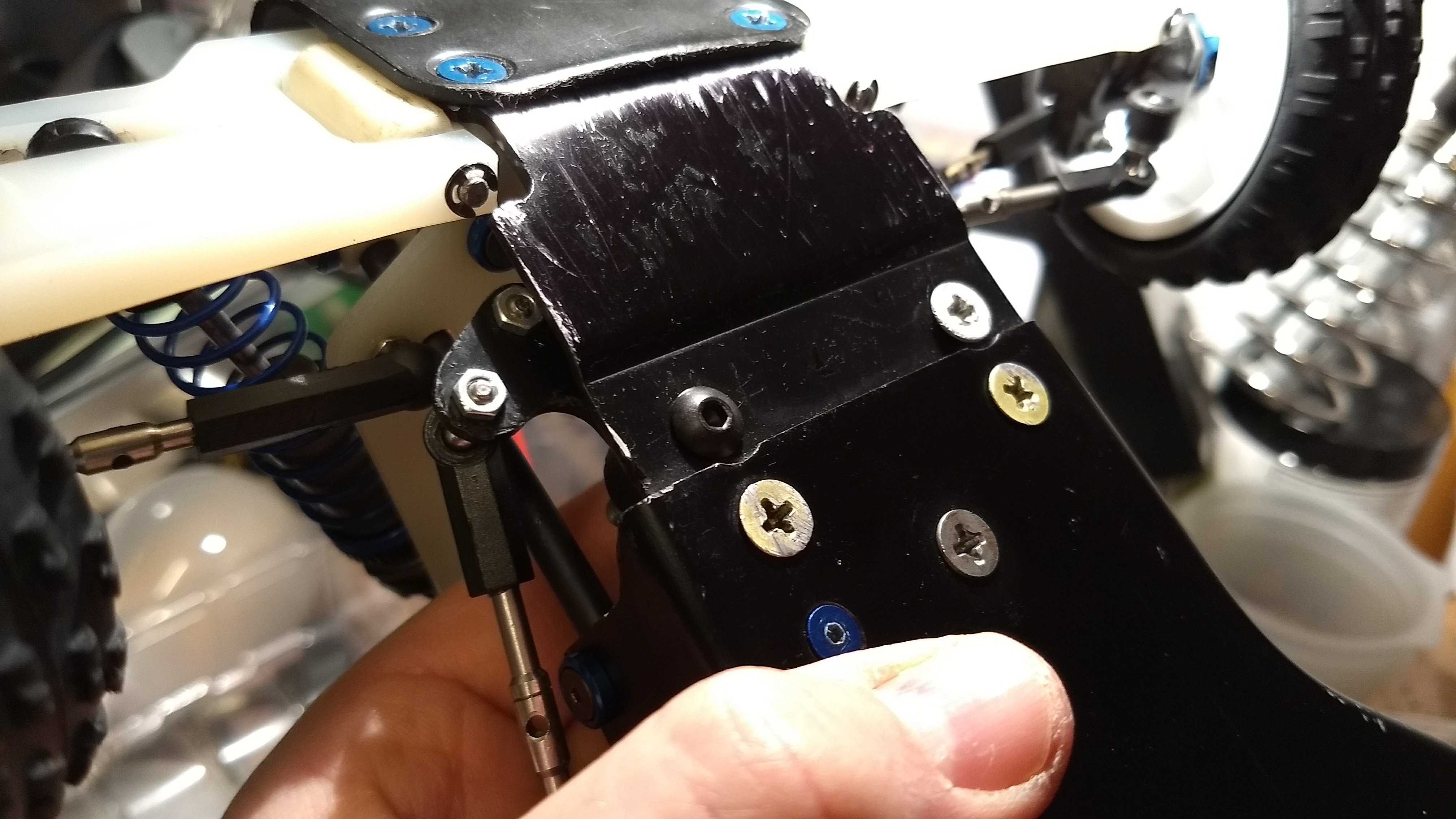

And, we're back for the second to last installment of our "how to race a vintage-ish car in a modern race" series :mrgreen:
One last couple of mods friday evening, BHS at the bottom to not damage the track, as well as new-but-dull black nylon nuts for the steering to take some off the slop off (the old ones' threads appeared stripped, actually!)

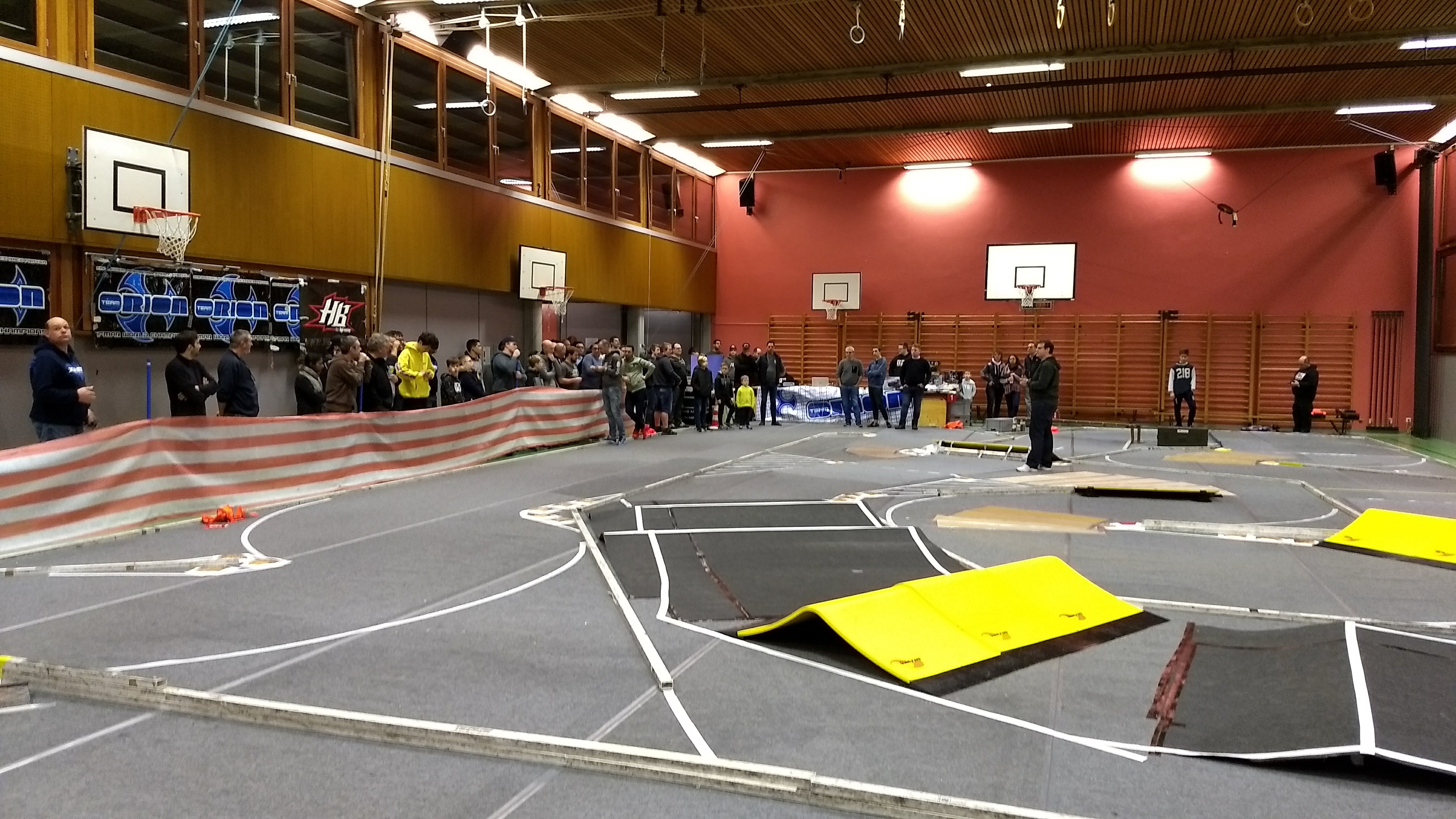

Here's what the track looked like at 7:30am saturday morning (picture taken during briefing). Very technical, not fast, no big jumps, the usual "8" jump in the middle that has become a staple of the SIORC. 50 guys signed up in 2wd, including a couple of continental hotshots who really really wanted to race that day and did hundreds of miles to be with us(a regular B-Mainer at the EOS, and a full factory Kyosho guy that usually ends up in the top 20 at the Nitro Euros), plus all the fast locals.
No free practice (not enough time, there were 100+ registrations with 4wd, SC, and Juniors). First 3mn run - reseeding, in a top-tier series (the second fastest I think), where your fastest three consecutive laps determine which qualifier you will end up with. . Only the club members who assembled the track till 1am have actually practiced the night before (which is fair - everyone can help build up the track, the reward is you get to drive it). I couldn't drive it before, So I basically have to learn the track in 3mns tops. The car actually feels pretty good, very, VERY different from the rear-motor from before. It drives almost neutrally, but still on eggs. In the non-bumpy sections it's very fine, on the jumps it's still below average, but I can do three semi-decent laps, and I end up with a 49.8s, which puts me in the second qualifier at the 18th position. The top-reseed runs a 45.2 (he built the track the evening before PLUS is immensely talented), most fast guys run hi-45's to mid-46's.

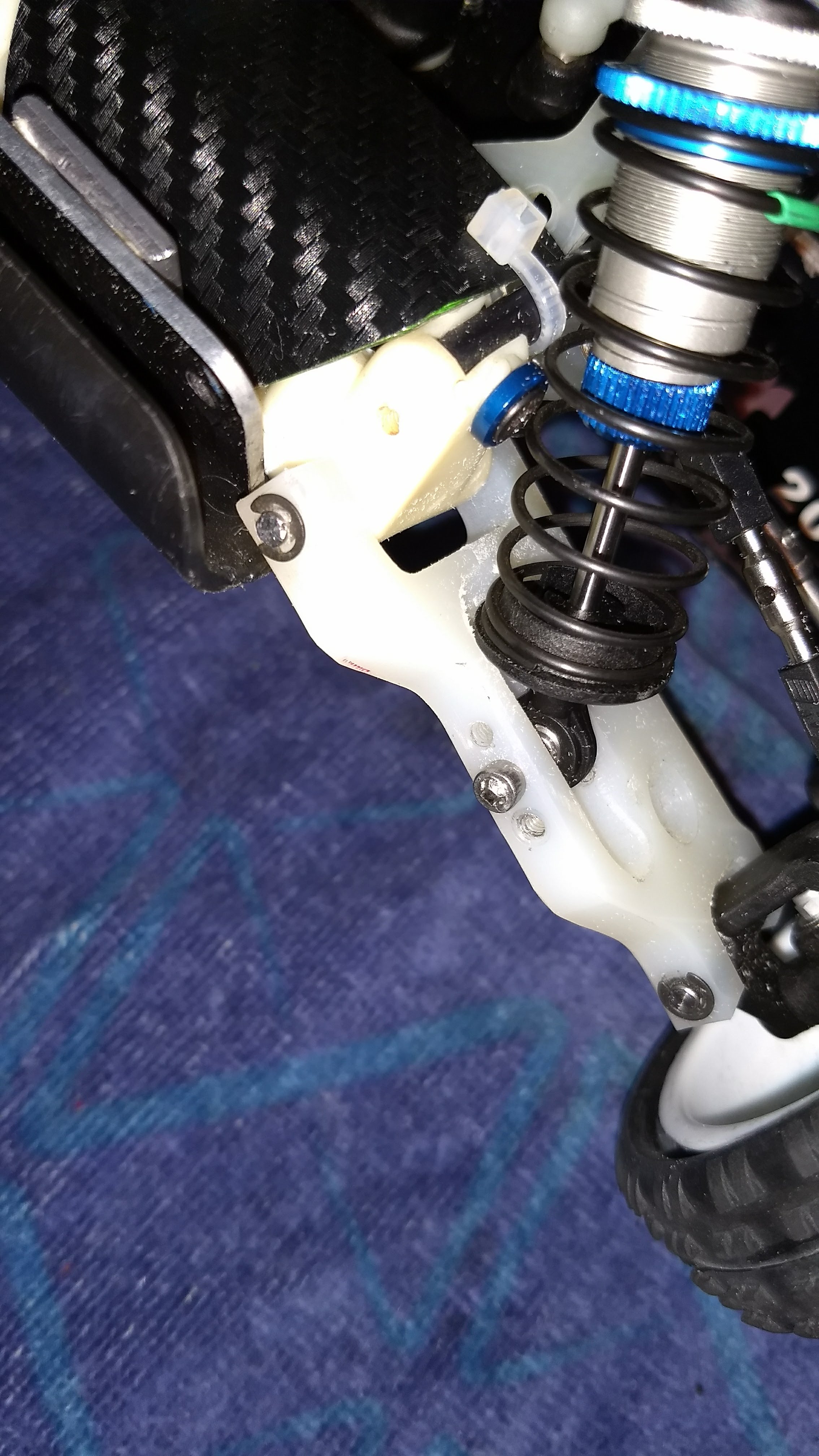

So, after a bit of work, that's what we have:
I had to pull out the dremel to remove some delrin on Jake's (Dynotechs? No idea...) lovely arms to clear up the spring retainers (didn't take the plastic set), oh well. This is a runner after all. I also had to re-use the STRC alloy mount I had on the TRX-1 as well as space these away from the front tower, what you see here are conical washers, this was not to be refined, and I still had to wrench somewhat fast (and prep my son's car and marshall it, as he was again running in the junior class)
And off to the first qualifier I go. OMG what a change... the car now has a proper suspension! Not perfect, but it's beginning to feel like a racecar. There's still too much roll, and it slaps a bit when landing, but I can actually start driving the thing on throttle instead of just clenching my buttocks all the time! I'm beginning to have fun, and to hope I can land a mid-to-top of the B slot... I am 13th for now with an 18L 5mn04, BL 16s0. Again, people are stopping by to look at the car and compliment it :) TQ is a 20 lapper, BL 15S3.
Second qualifier, even better as I'm finally racing now, but then again everyone improves their times, I do 19L 5:13, BL 15.7. That's 7th in that round (but some of the guys were faster in the first one, so I'm probably like 12th or so). I was even in the lead of my qualifier for quite a while, not being that fast but running very consistently, I just had an 18s lap and the rest was all in the high 15's - lo 16's. This was all good. TQ is now a (faster) 20L, BL 14s9.
Third qualifier - I borrowed a pair of Schumacher Cactus's which are the replacement for the no-more produced minipins which we used to run till the beginning of the season. My minipins were washed out (didn't want to dump more cash in a substandard racecar), and I could feel they were slowing me down now. So here I go with the new tires. The car has a LOT more side grip now, but this means I rolled it a couple of times too... but I was still doing good. And then disaster struck after 1mn30 or so, the car whines and doesn't move any more... I'm thinking "oh no... the diff..."... but it turns out it's the spur. That round was not going to be faster anyway as I had screwed up the first few laps due to the significant handling change, but I would have liked to do more laps just to learn this more! Oh well :(
Now... changing the spur on this baby means taking pretty much everything but the bulkhead off the car, including the battery box, everything... it's a PITA to be honest, and not a quick job. But a man's gotta do what a man's gotta do, and I change that spur as fast as I can. I run to the board and I can see I'm 6th in the B with my second qualifier, as I could DNF'ed the third. Everyone's going faster, TQ is with the EOS B-main guy (what a surprise) as his yokomo ran a fast 20 lapper so in the lo 5mns with his BL being a 14s4 :shock:

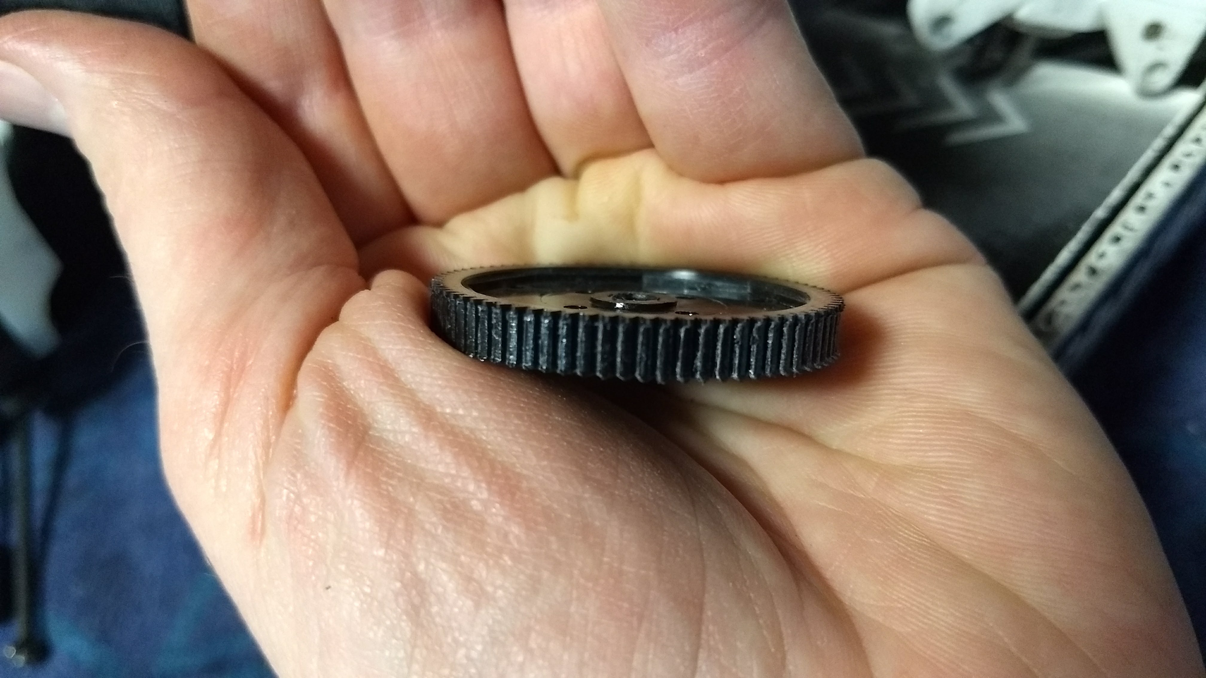

I'm out of spurs now... I had one backup, not two :? Fortunately, this is the same spur the B6 is using it seems, and there are plenty of B6 drivers around that are willing to help (at least one of them does :mrgreen: ), and I can do the switch faster. I try to set up the gear mesh on the low spot now instead of not thinking about it last time... It IS still a PITA and I'm getting tired of wrenching all the time on this car with zero buffer between my runs, my marshalling, my son running, marshalling my son, and fixing the darn thing! But I'm still ready for the last main.
The start of the second B-main is a bit less lucky for me this time... I can squeeze past a few guys but at like the third corner, I get taken out, it happens... but I'm starting dead last. I climb my way all the way back to third again as the others do mistakes too, plus I'm racing with zero pressure so that makes me faster! And at ca. 4mn30... no more throttle, but no WIZZZ this time, no clue what's happening... but I'm gutted. When the race is over, I pick up my car... and the pinion had come lose and free inside the black tub. Which is a shame, really, as this was my very best run, I was clocking 15s4's and 15'6's consistently. Oh well. The winner in the B does a 19L 5mn08 runinng low 15's consistently. The A-main winner Mr EOS did a 20L 5mn04, with BL 14.4's (and he did a few).
That gives me the final ranking of 18th, which, with a DNF towards the end of the last main, is kind of expected.

5- I am not sure where my transmission problems come from. I am leaning towards the cheap motor I'm using, maybe the shaft is off-spec, maybe the bearing is blown, I don't know... I have a hard time thinking the motor plate is flexing, but you never know :mrgreen: I will triple check everything for the next race, and use another 8.5T with a "normal" price tag that time :lol:

Ha. I see what you're saying, that's slop in the suspension you're talking about, that's creating slop in the steering knuckle (slop doesn't add, it multiplies). No, not an issue on this car, it isn't any sloppier than a modern car, if only because the suspension was actually very tight when I started working on it a few weeks ago and I had to enable the pins to move at all in the delrin :D
The steering geometry is the issue I think, because the inside wheel's (i) spindle pivot point (ii) spindle ballstud (iii) steering rack ballstud are pretty much all aligned at max lock, this plus the insane ackermann rate (the differential rate if you want).
Again, that's why modern cars have the steering system pointing "backwards", so the steering rack arms move parallel to the spindle to avoid this effect. It was probably of lesser importance on RM cars (even the B4) but as MM architecture started taking push out of the equation and load the front wheels more, this becomes an issue.
Maybe I could flip the steering rack by drilling the nose plate... but then again the ackermann tuning would be a lengthy quest... I won't do it ;)
