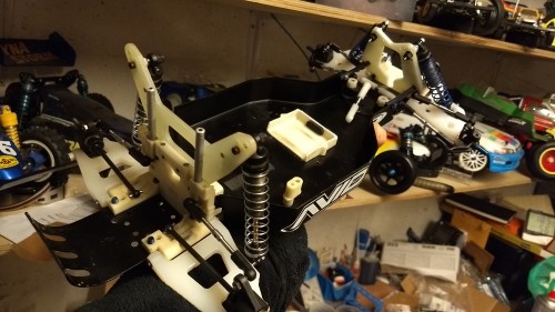

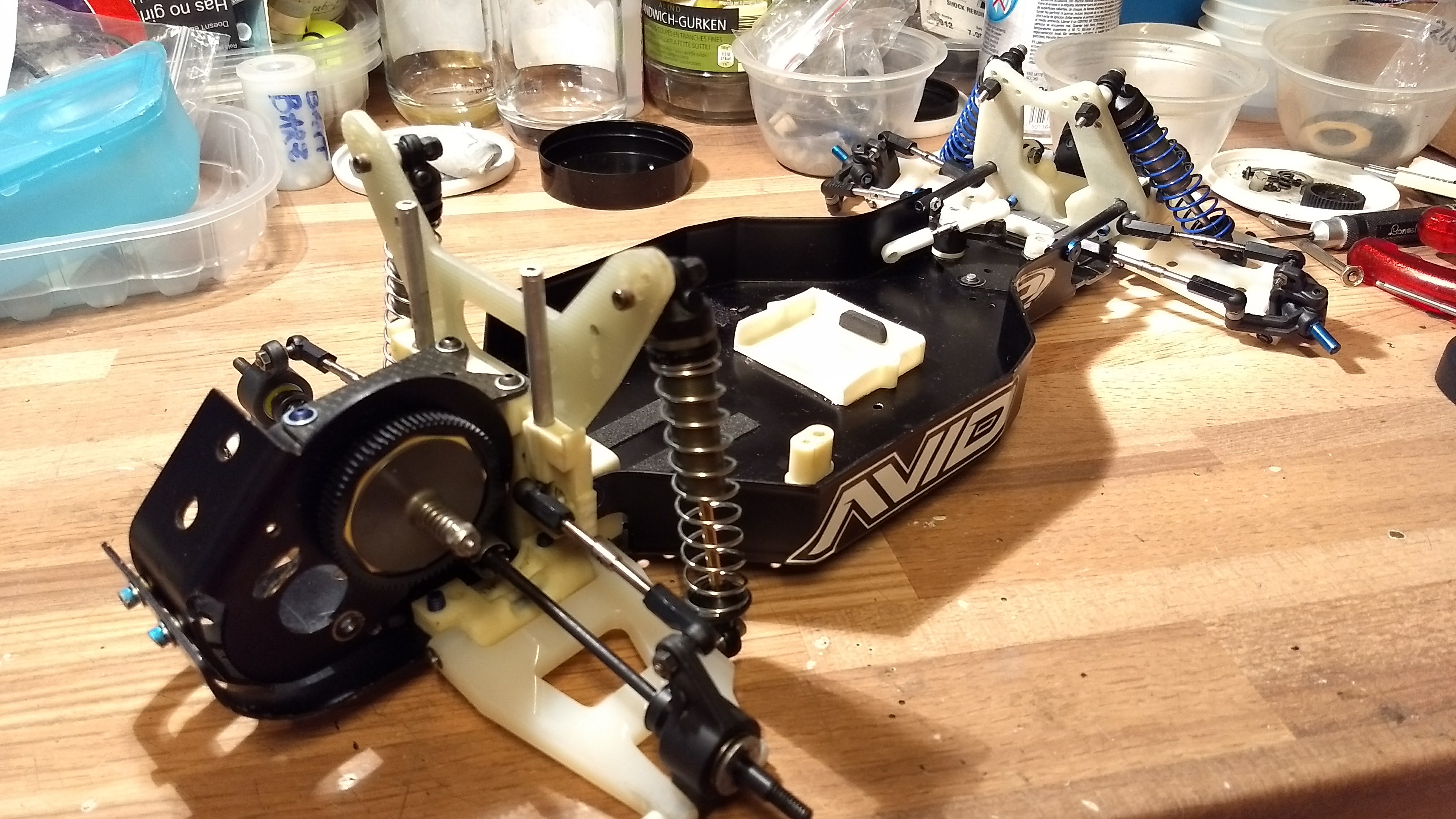

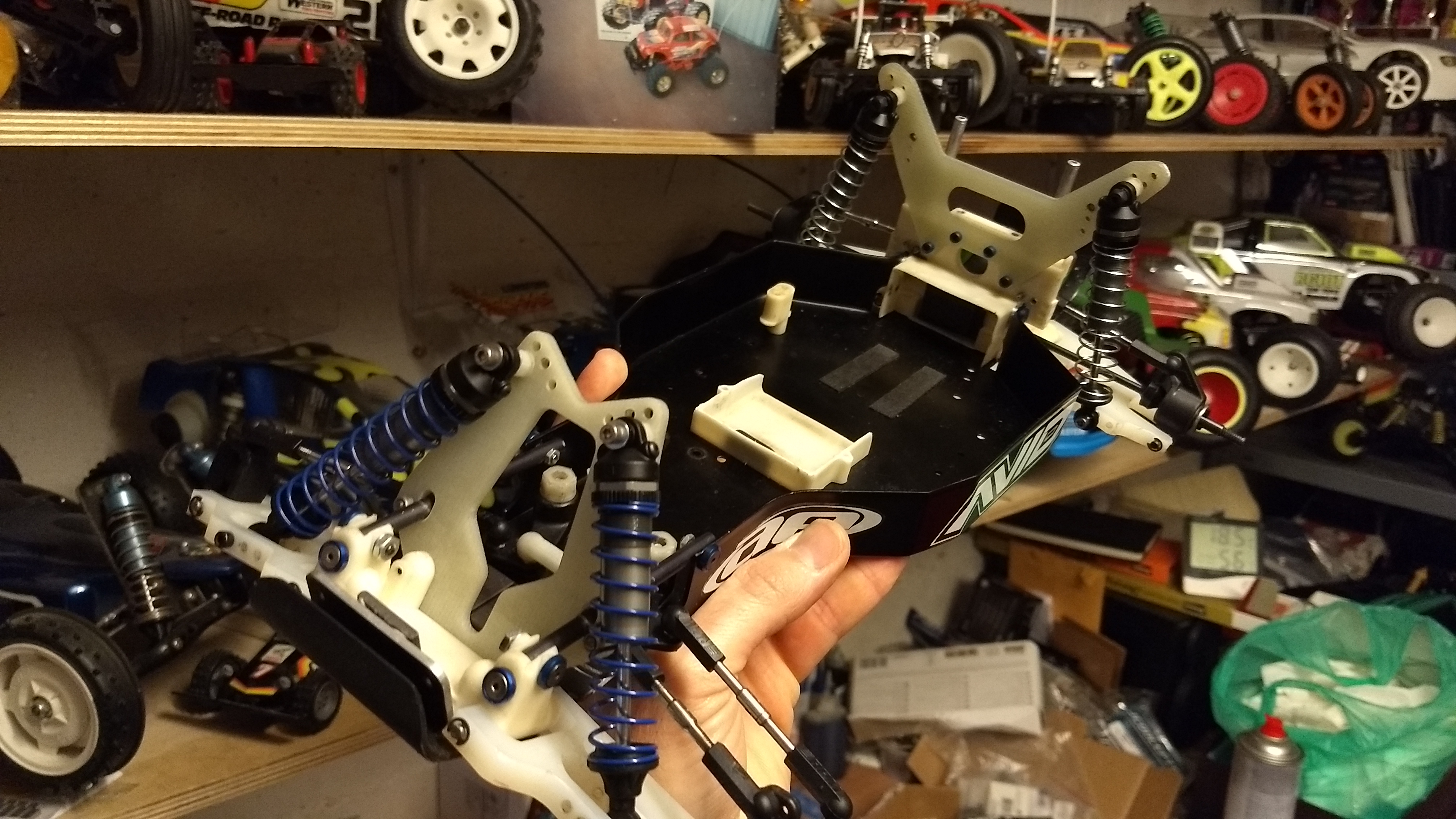

First after disassembly: working on the suspension. That's the soul of an offroader, and especially in 2wd, it has to be absolutely faultless. When I bought the car, it was faulty as hell :lol: Everything was binding, some of the turnbuckles had been screwed so far in the ballcups that the 'buckles were sticking out "inside" the ball cup, some of the axles were totally corroded. Net - there was no way this would run properly as-is. Again, if you're the former seller, I can't believe you actually managed to complete one lap with this poor thing :lol:
Here you can see the car without transmission... but with the suspension rebuilt already (although still some work to be done on the shocks, more of this later.
Basically this means filing the excess plastic on the arms so there is some clearance agains the rear arm holders and the front Bulkhead - without removing too much material otherwise there is too much slop. This means assembling, testing, disassembling, filing, assembling, testing, disassembling, filing, assembling...
Also, polishing the shaft to a newly found mirror finish (auto polish + dremel adjustable chuck work wonders) was needed as well as replacing the ballcups... I also had to cut some of the tecna's - dremel + cutting disc - as they were too long. Remember to wear eye protection, because when a disc snaps, it explodes in bits that typically hit the user's face :roll: In the end, the suspension has to fall under its own weight. Of course, when you hold the chassis flat, it does... the true test is to do it while holding the chassis vertically. If the suspension is properly built, it should move to one side or the other as soon as one tilts the chassis in the slightest way.

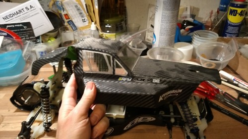

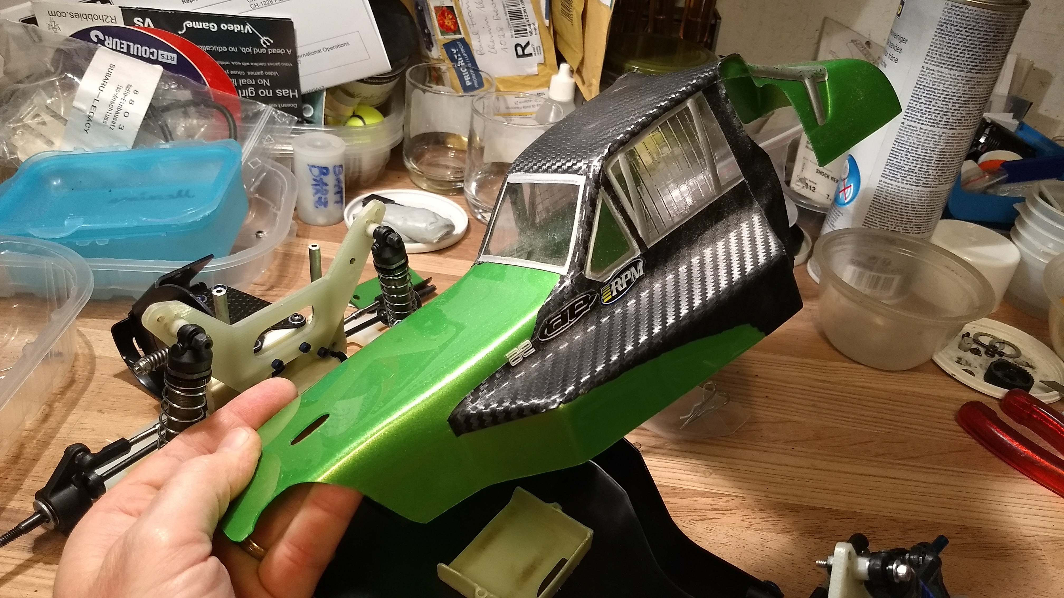

Then for no reason, I started "working" on the body. As mentionned earlier, it was covered in CWF-style vinyle - useless at the track. I peeled it off, and it was a b!tch, really.
Surprise, below the vinyle, it's green. At least that's race-able, but I have a good buddy on this forum (hint: he JUST won the BOTM contest) who has promised me a painted Protech to race that instead... Still waiting, mon ami ;)
After lots of torn fingernails and bleedy fingertips (vinyle sticks well!), we have a proper body, pics are coming soon below.

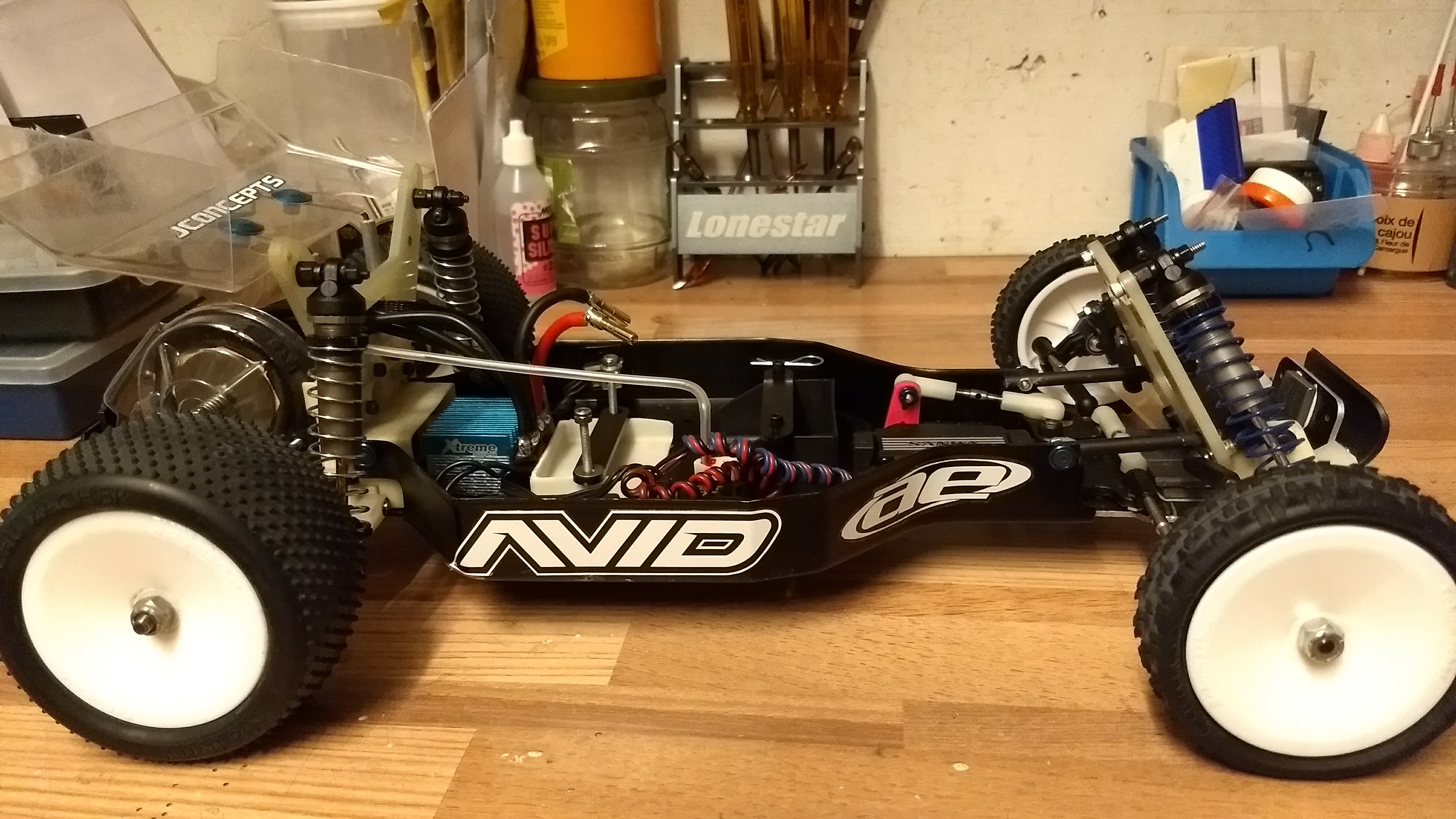

After some fiddling with washers thickness and positions, various nut profiles and stuff, the car then looks like this:

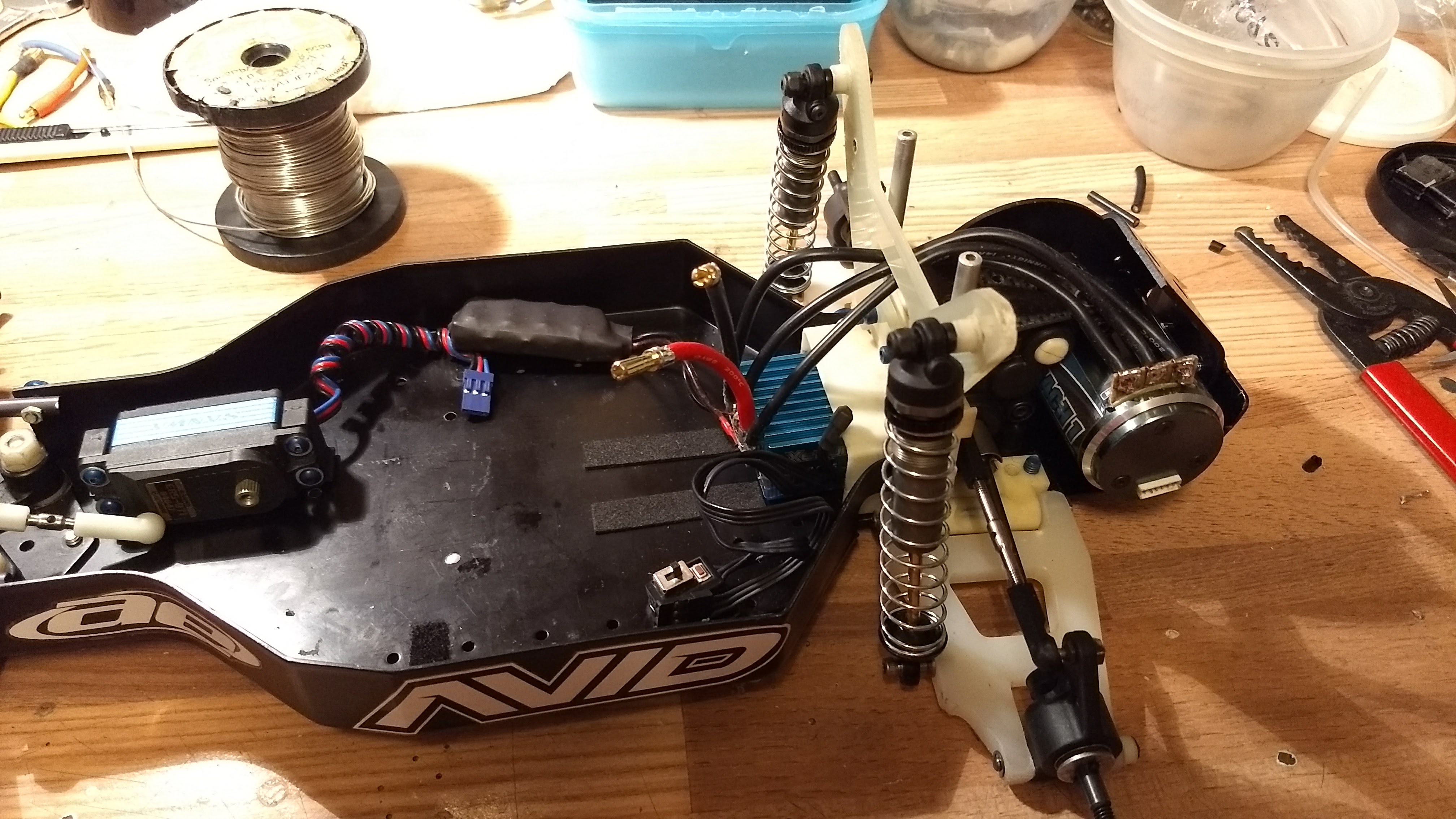

Next step is the electronics.

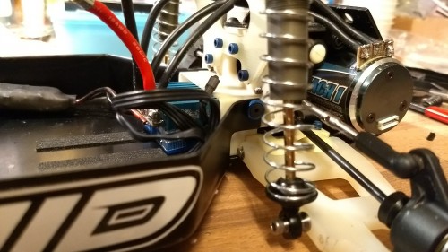

The idea was to reuse existing RC gear rather than buy new one. Given that I'd only race it twice AND that it would likely be uncompetitive, no point blowing $250 in top-of-the-line electronics... But I'd race it and I can't be bothered with truing comms during raceday these days, so it has to be brushless and given I had two shorties sitting idle, it'd run on shorties.

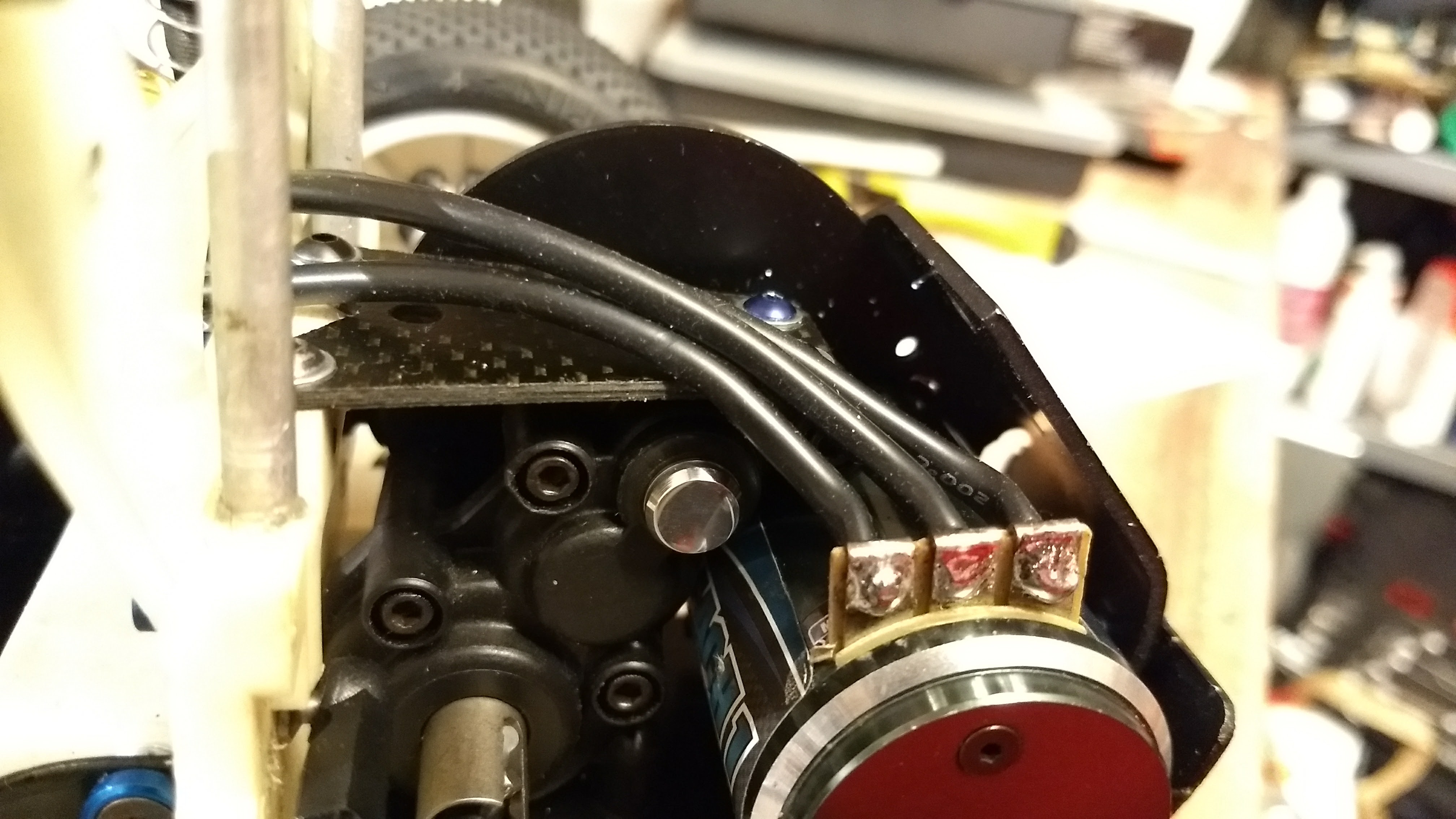

So I recycled my old trustworthy Hobbywing Xtreme Stock as controller. It's basically a 60A version of the V2.1 from 5 or 6 years ago, but with a smaller footprint and a better cooling system. This one has had several lives in my racecars already (DTM and 2wd OR) and I knew it'd be up to the business, so off to the soldering iron for recabling it goes. A mockup assembly shows it fits under the bulkhead, so that's perfect for inline shorty placement.
Next is the motor - this is a non-adjustable Turnigy (read: hobbyking) 8.5T, sensored. Again, it's beenraced in the past in 2wd, the powerband is wide, it's not a thorougbred but it does just well in 2wd... and it's paid for already. Ticks all boxes, then :lol:

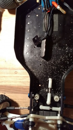

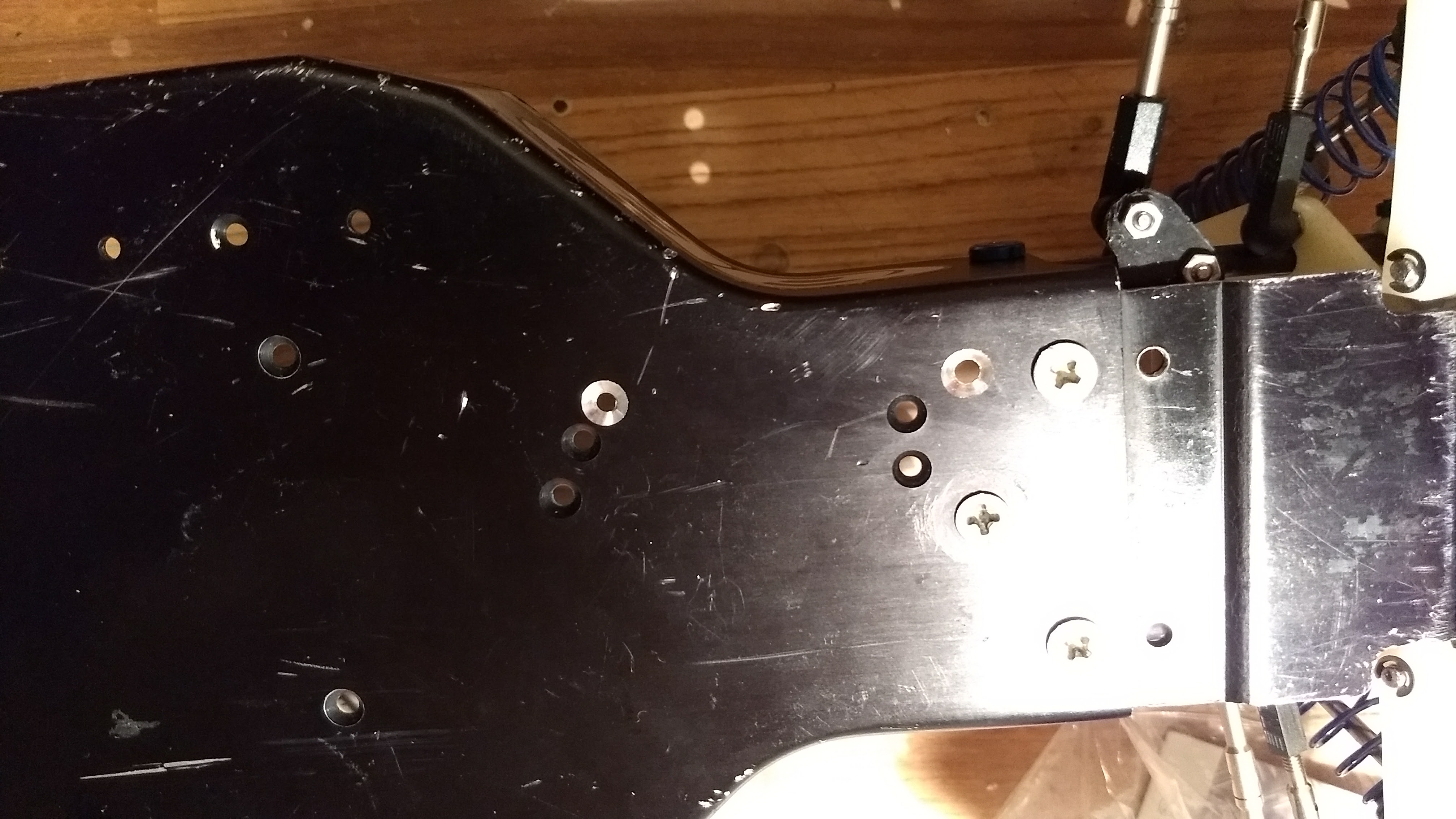

Servo. I've always hated how servos are mounted on RC10's, the way the servo link is aschew drives me crazy.
A cool (and in my mind, the best) solution is to mount a lo-profile servo vertically, but it doesn't fit under the buggy body. It does work wonders on the RC10T, though:
So I had to settle for doing something which i HATE doing, i.e. drilling a B-stamp chassis (yes, I know it pains you too...)
(TBC'ed)

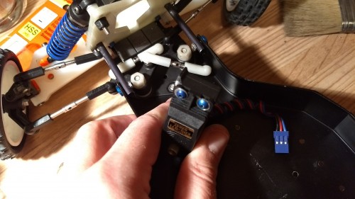

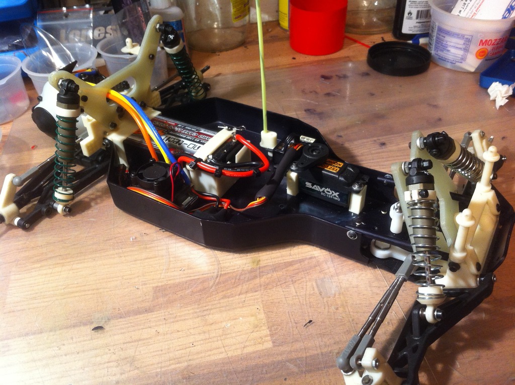

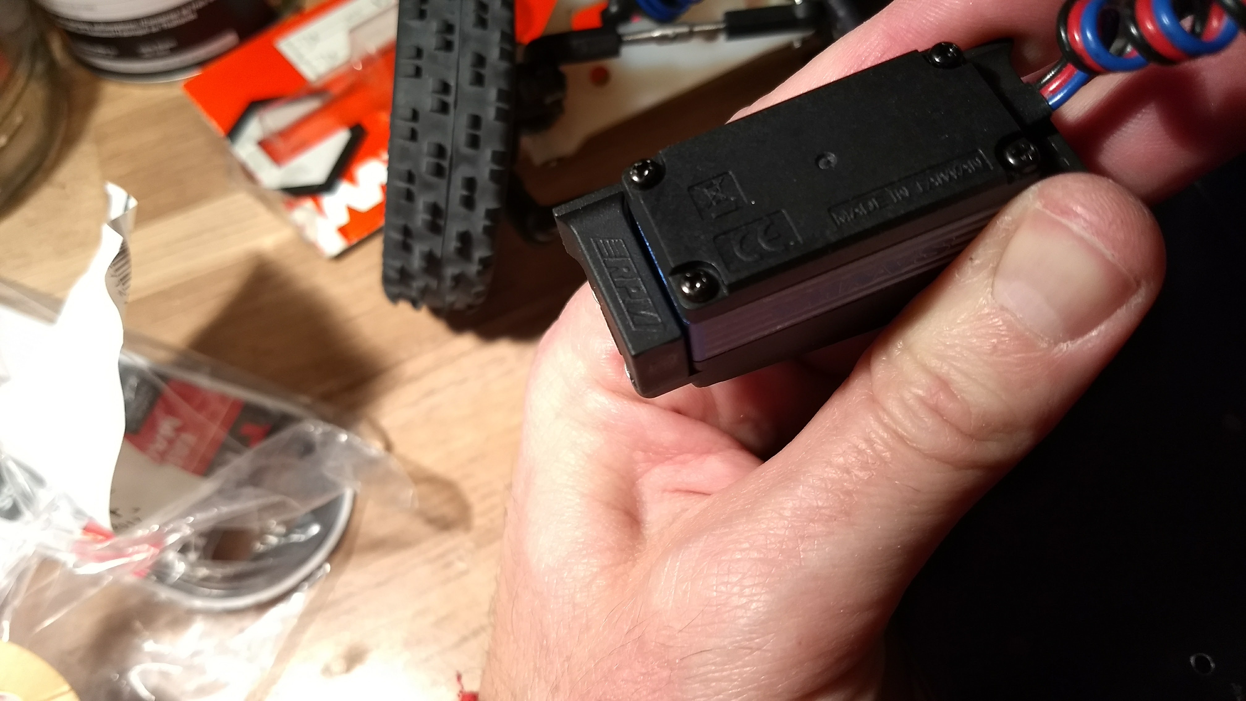

So - servo. In 2017 you can get some crazy servo performance, both from a torque and speed p.o.v., even in a lo-profile package.

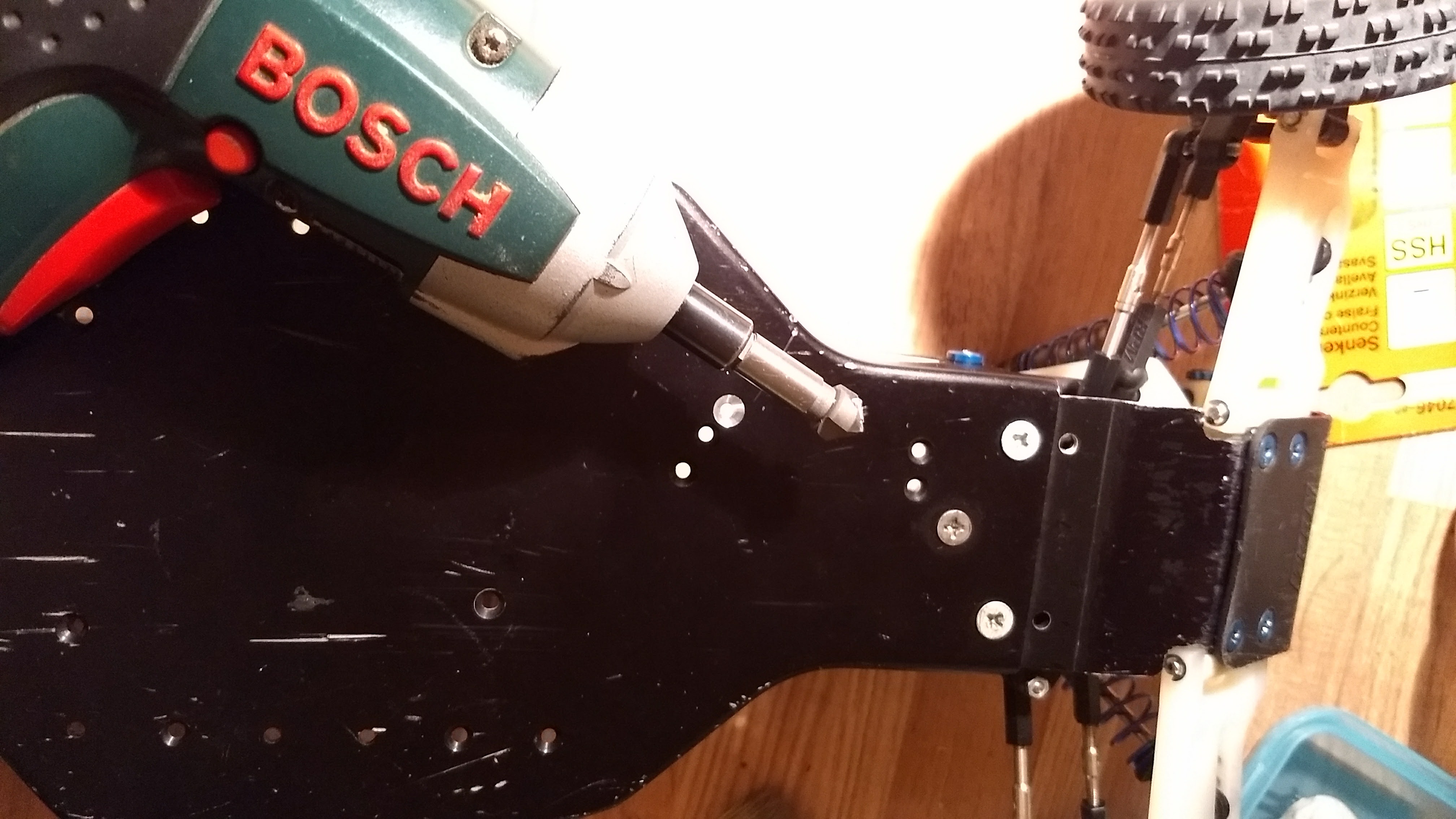

I recycled my Sanwa ERS971 from my Xray: 0.09s/60 deg, 9kg.cm, plenty enough for a 2wd, and low-profile so the servo link can be close to straight... but this means drilling the B-stamp. A man's gotta do what a man's gotta do:
and countersinking... very manual as you can see! :D
Old-school RPM servo mounts... spoiler alert: some cutting will be needed!
because otherwise it hits the front plate, but that was planned - wanted the servo as far front and right as possible!

Final holes. Method used: trial and error :D

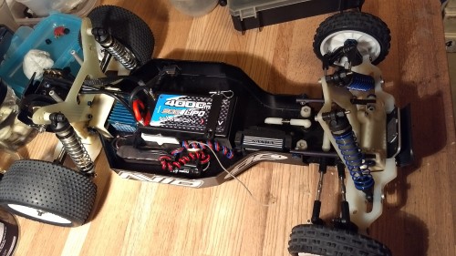

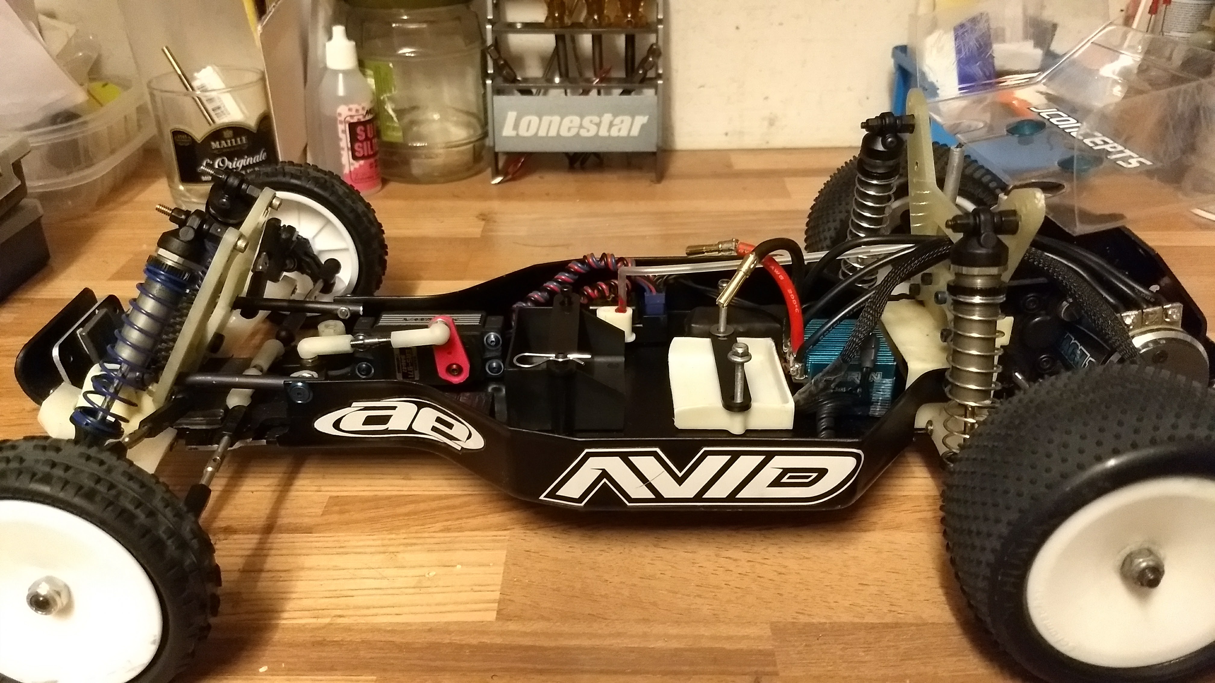

Now with the servo and electronics fitted (skipped a few steps here...)
And now with everything, including a funky-looking and thermo-formed antenna wire, a pure-80's fluo pink KO servo horn, a not-too-pretty battery bar maintaining system (cut M3 threaded rod...) that allows to recycle a bastardized white battery half-box, and then some:
(more to come)

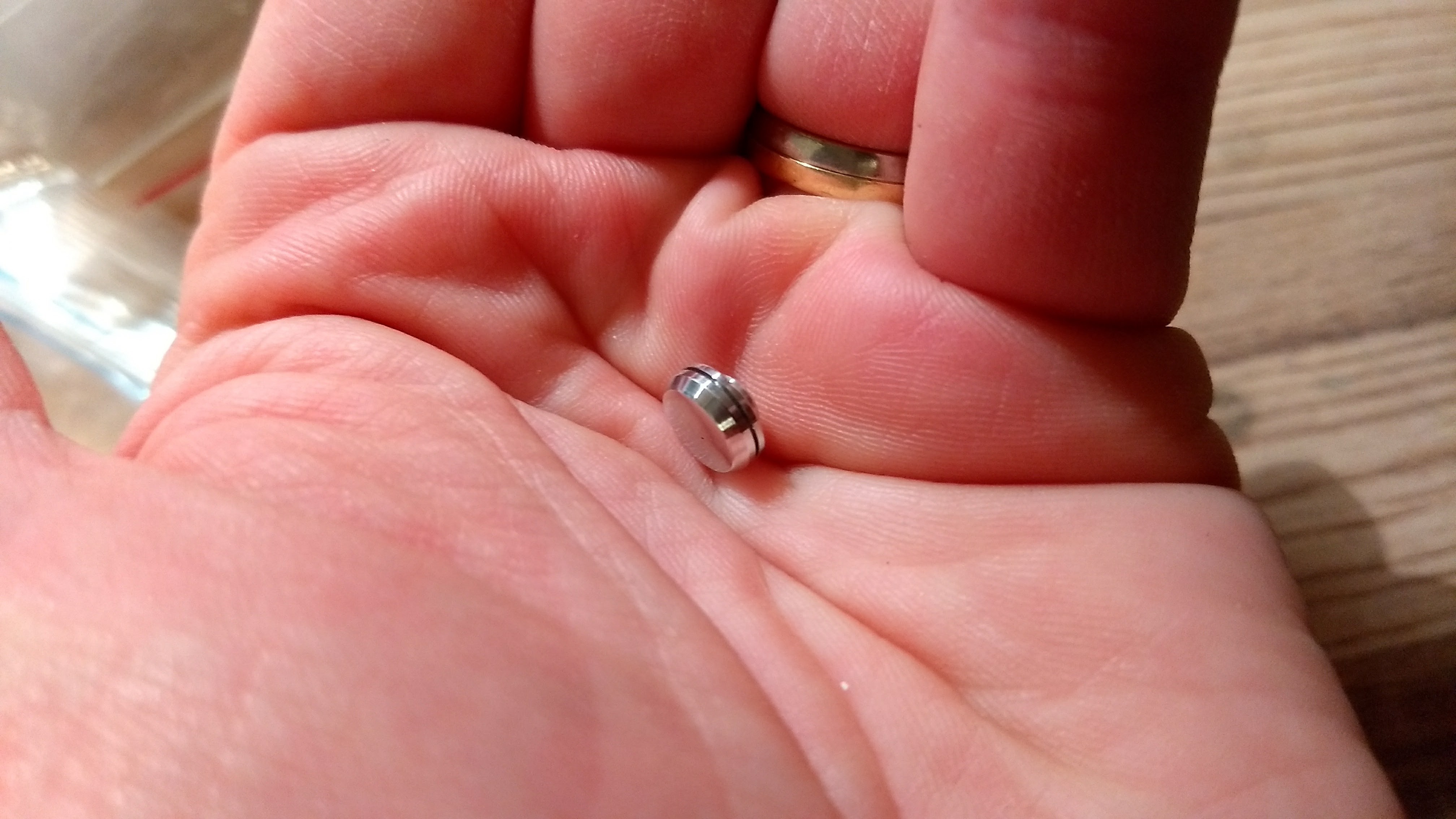

A very talented forum member whose lathing skills are primo kindly sent me this:
me thinks it looks lovely!
(thank you again!)

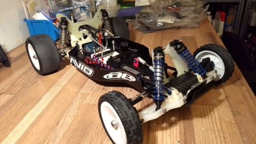

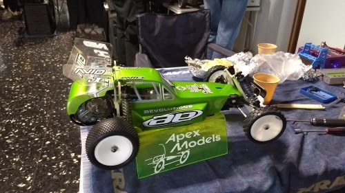

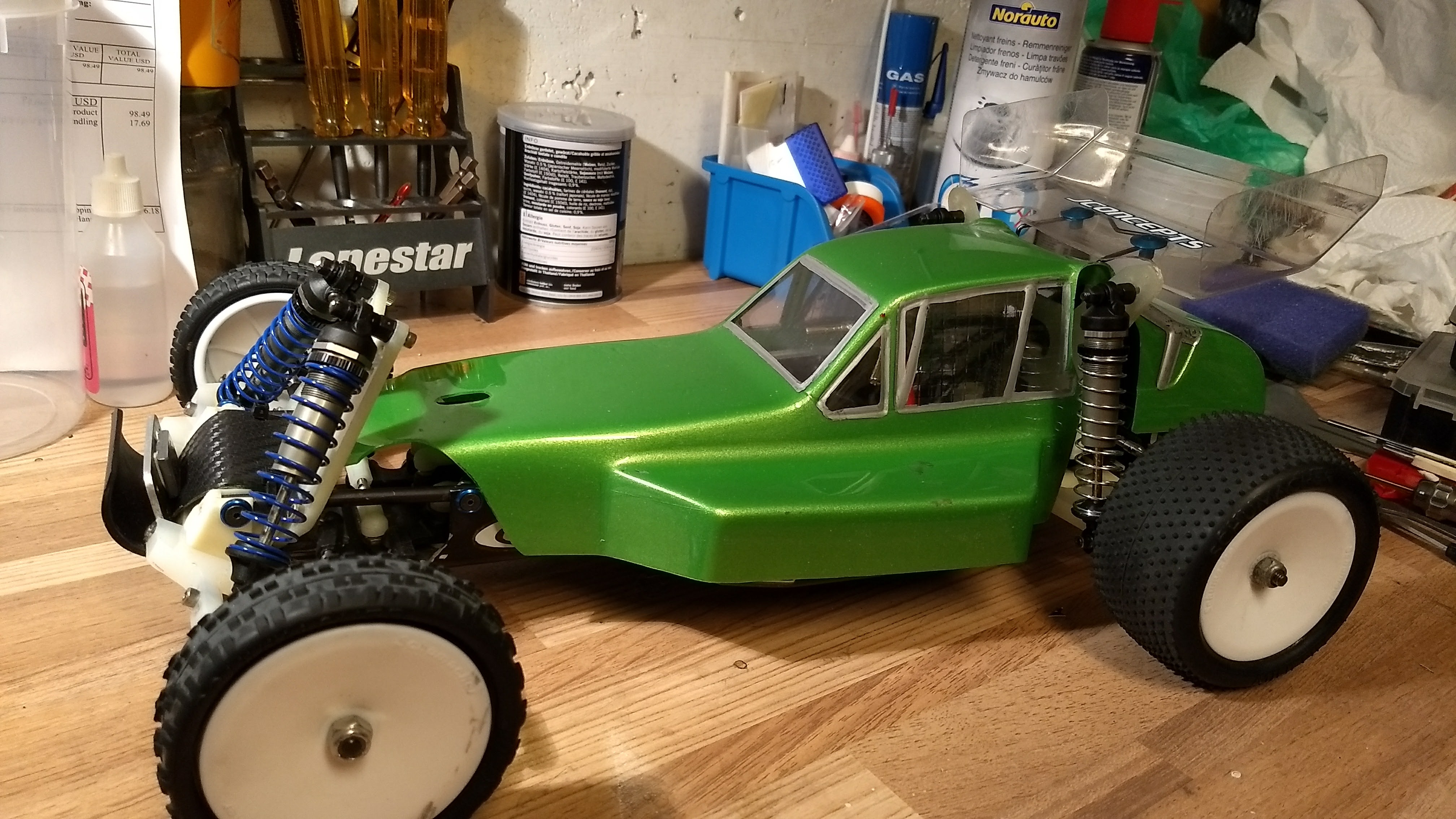

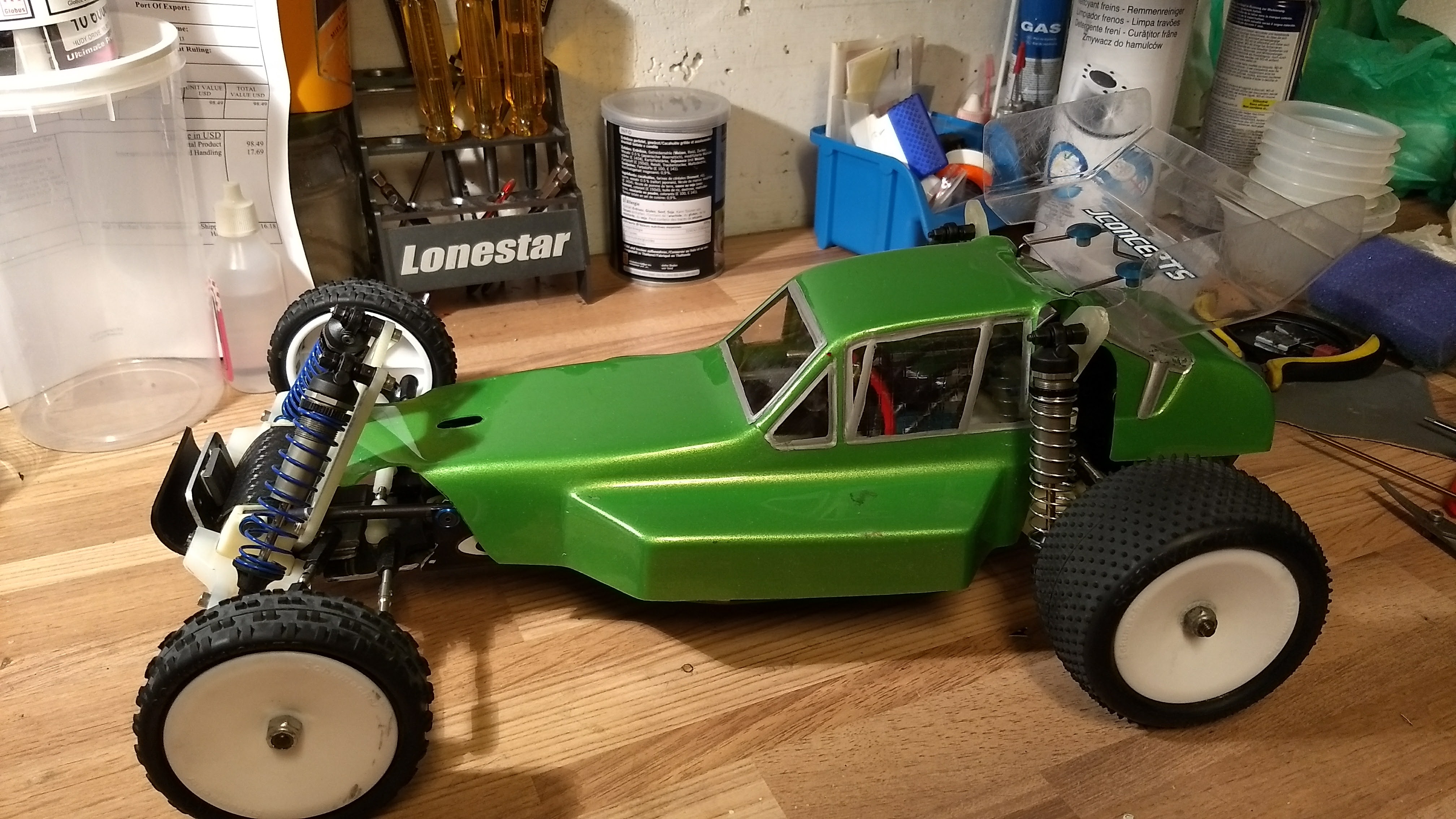

Car is now done... I was expecting a good looking body from an aforementioned forum member, but it hadn't come yet, so I stickered the crap out of that green body - although not concours material, the result isn't too bad, this is a pic taken during raceday:

Personally, I think that stickered green body looks fantastic. I would not be ashamed to run that one bit. Anyway, a great build overall.

XLR8 wrote: Thu Dec 07, 2017 2:33 pm Personally, I think that stickered green body looks fantastic. I would not be ashamed to run that one bit. Anyway, a great build overall.
I agree... except for the upside down AE (EA?) logo :mrgreen:
