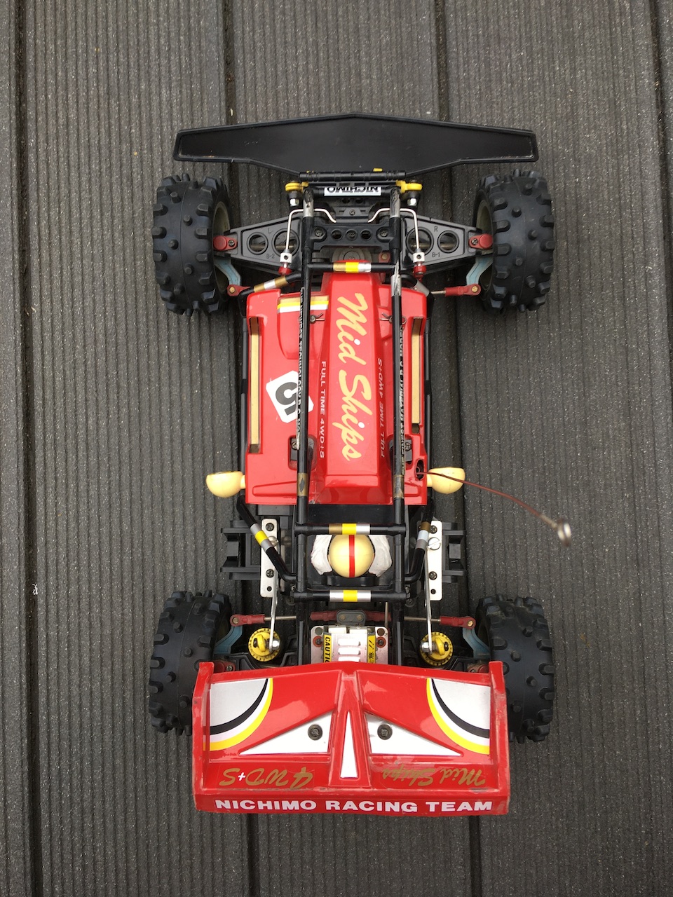

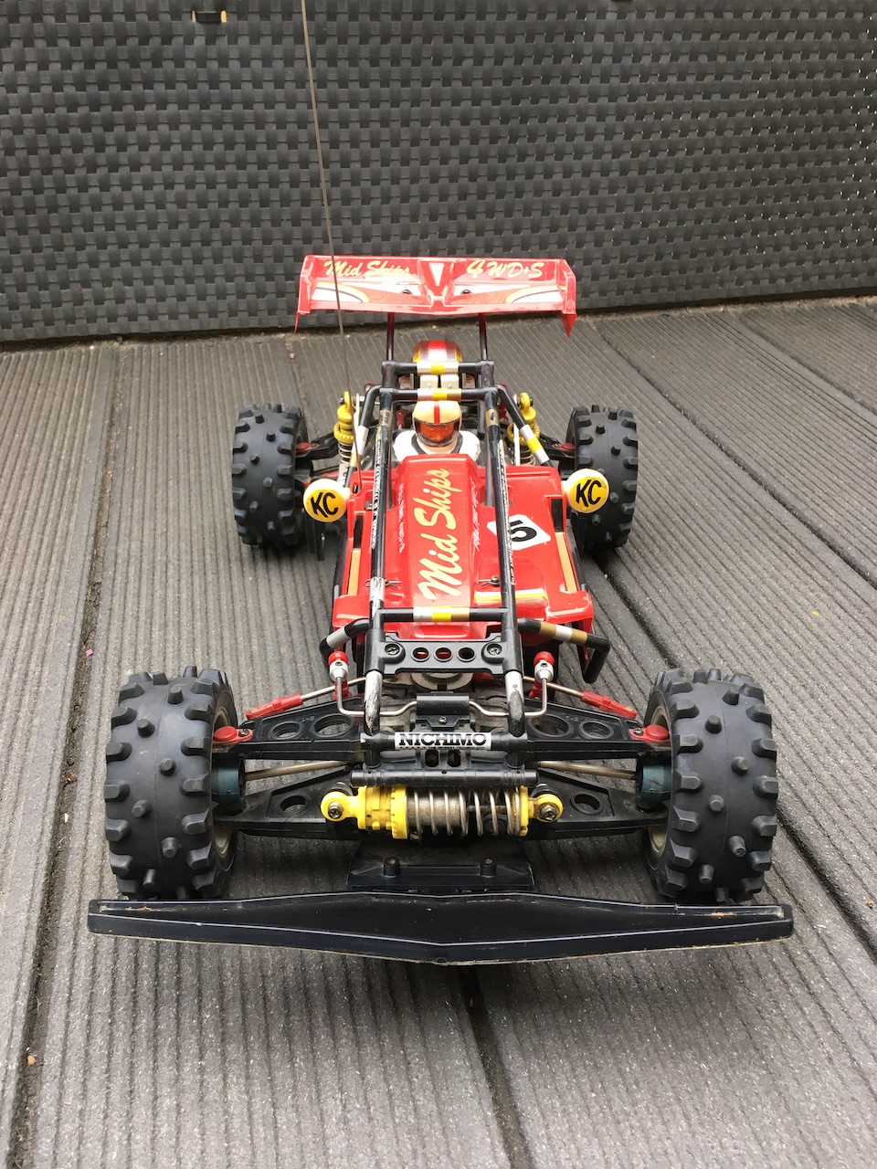

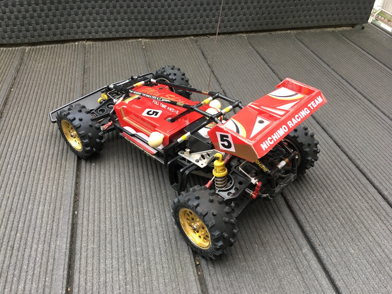

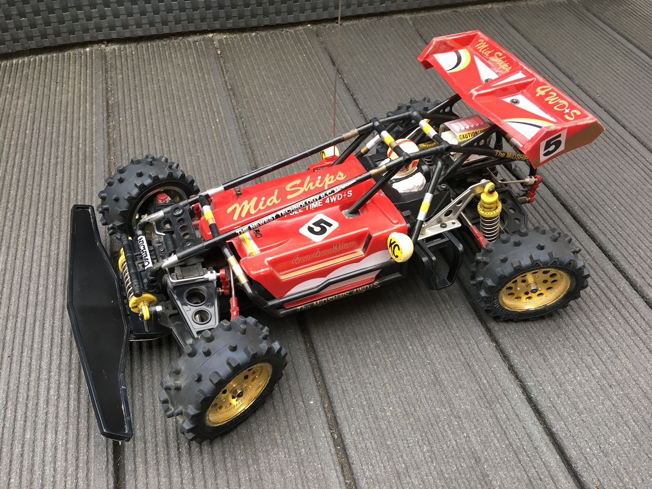

I dont want to hijack your thread, but I am very happy to find this forum and your thread. I recently rescued my old rc car before it had been sent to the trash. It's in pretty good shape, there is an aluminium plate to strengthen the piece in front of the car, that worked very well and is decent looking. At the back the cage has been fixed, minor issue. Maybe I should clean it.. ;) I really liked that car, but rc planes were and are my main rc hobby… :) My back to boy phase is rising… ;) Here are some photos I took…

Welcome on this thread and on this forum... The Midships is a quite rare car, and yours is in nice state compared to the one I modeled which is currently travelling to reach his owner...
In case you need parts for yours, I plan to put the files for the plastic parts at some point in the near future on Thingiverse...

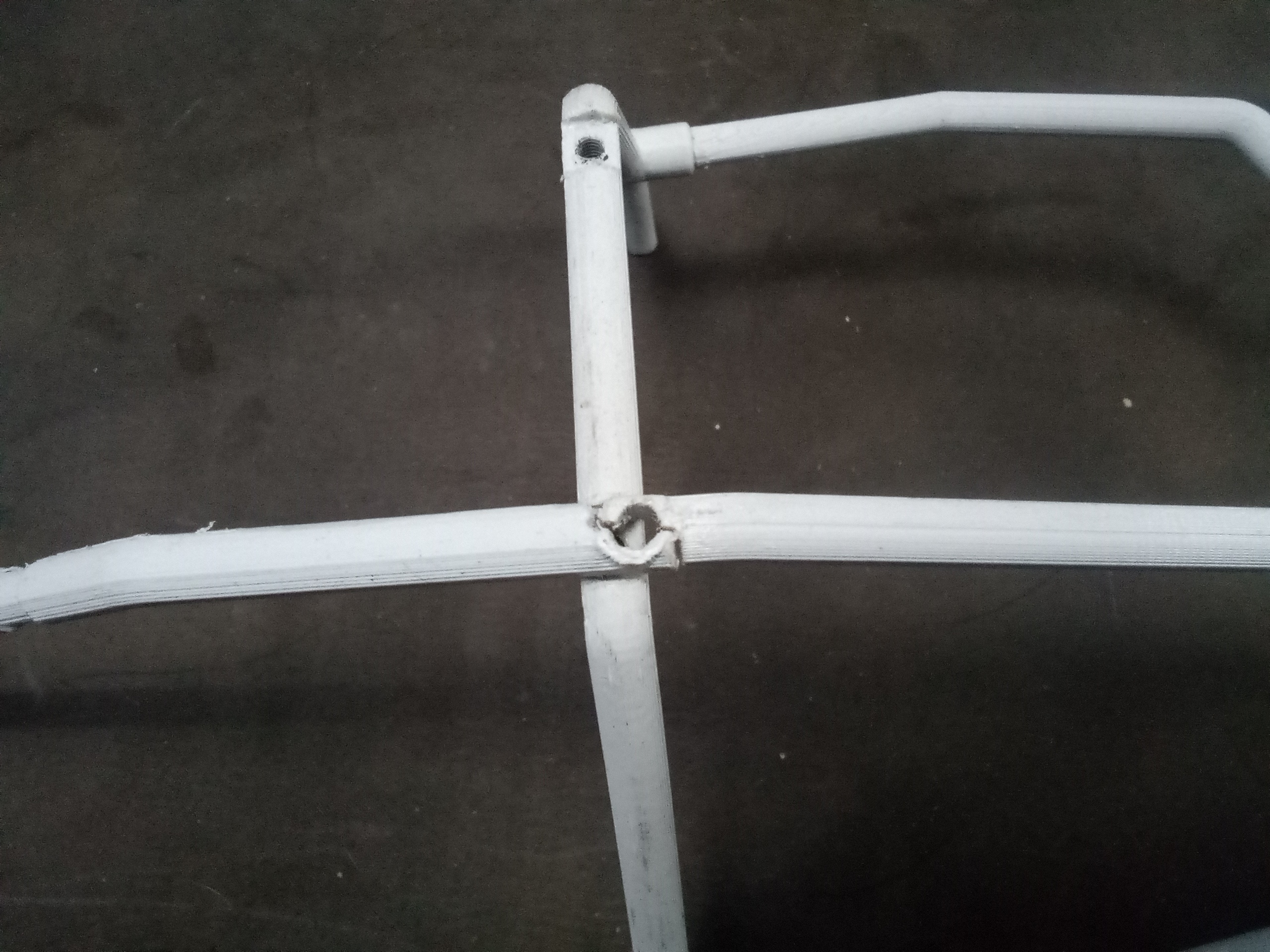

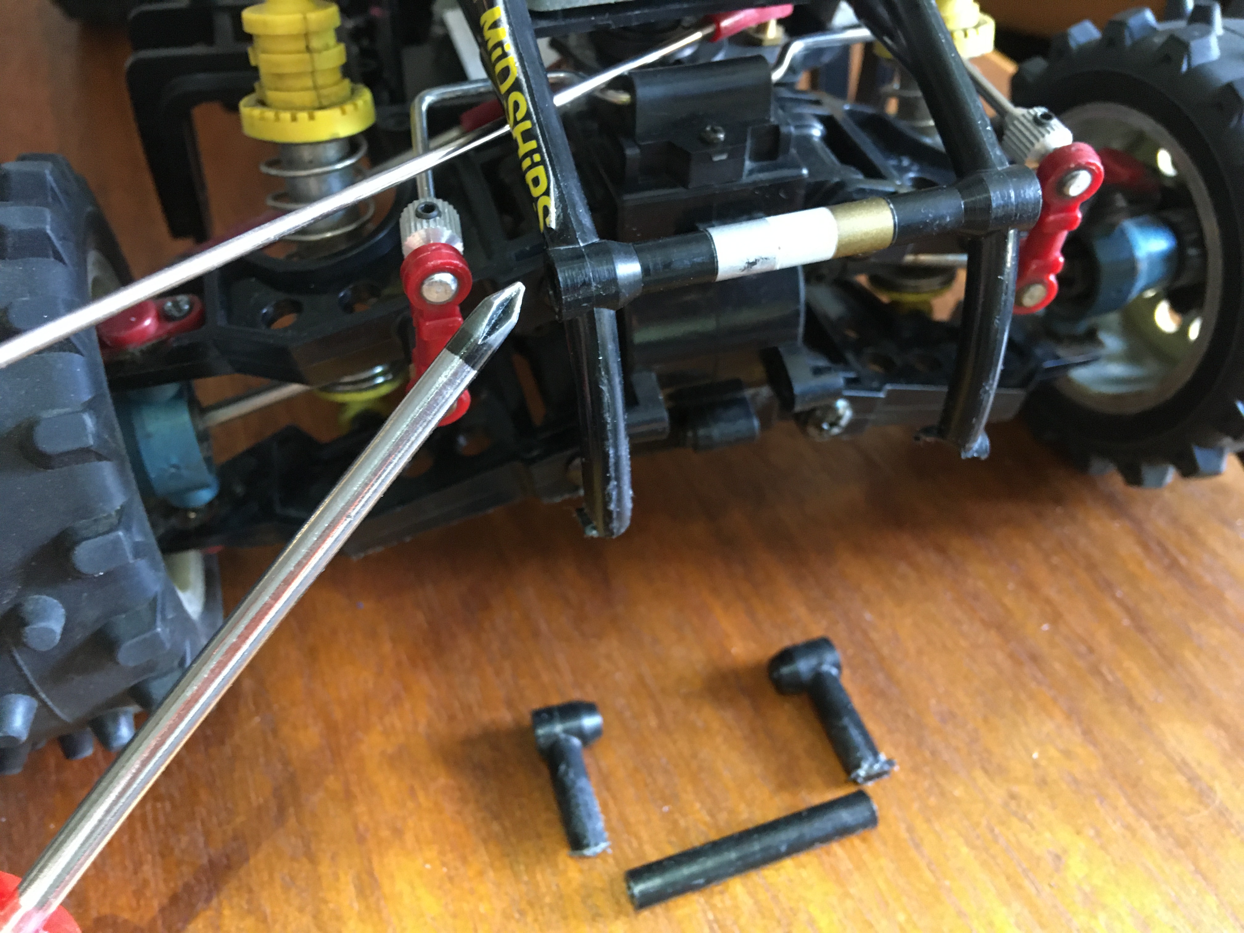

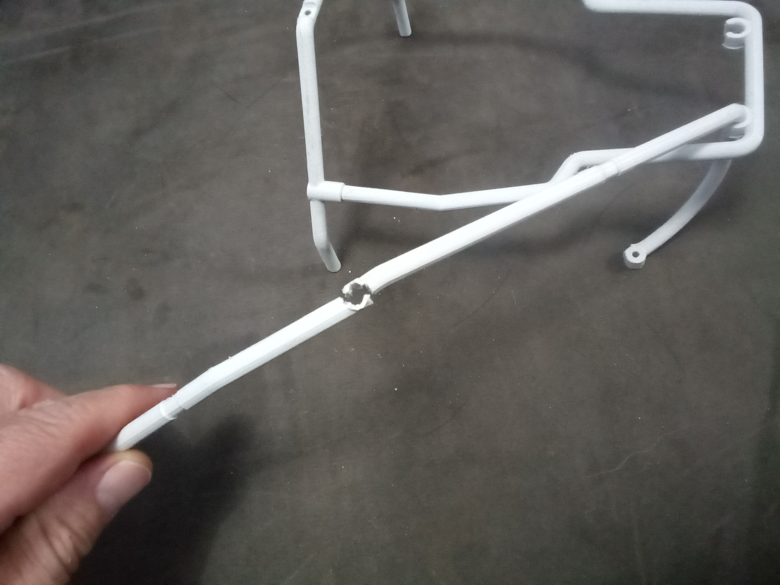

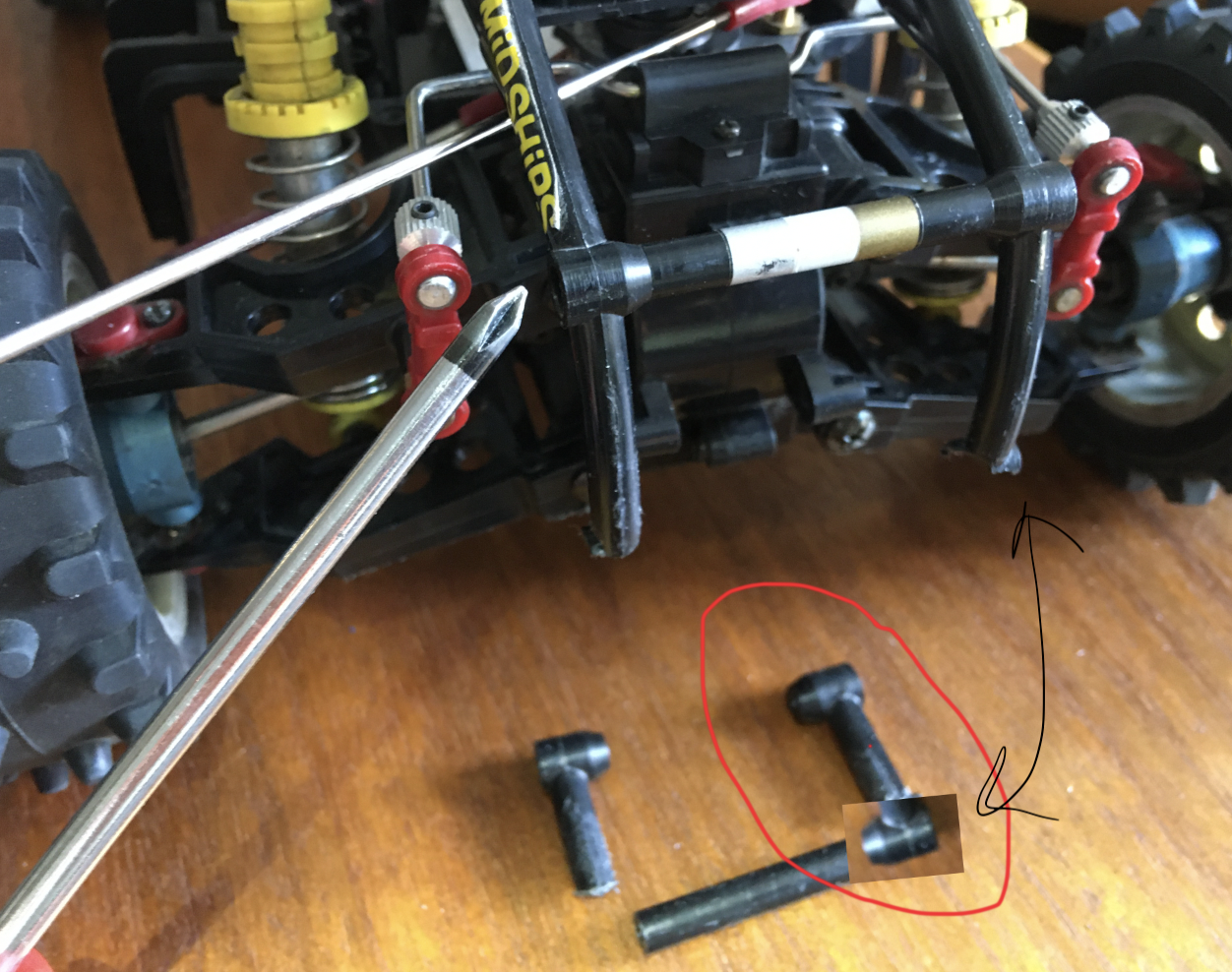

I thought I could repair my broken cage at the end, I pulled off the tape and saw there are two "things" missing. I think these things could be easily replaced with 3d printed parts, maybe that elements for the screw with a sort piece of rod on bothe sides, then I could cut off a little of the existing rod and join everything with something inside, what do you think? Do you have 3d printing files for this part? :)
Here is a picture of that part (the screw driver is pointing to the part which is missing for reference):

The roll cage parts are quite long, and they may be too long for a viable 3Dprint. I'll check this.
As for the files, I'm not finished yet, as there is still some ongoing work, but I'll publish them at some point (I'm not sure when yet). Keep watching this thread :)

Those long members of the cage look like they may be similar length to the Zerda , if so they may just fit , otherwise if it's just for you could you rely on the before mentioned "flexibility" of cage parts and play with the angles a bit of put a slight curve in the shorter straight rear cage sections to shorten the length a bit ?
Or do what I did with the Zerda for a test print and split the part .

This way of splitting would not work on the Midships... It's part of the activities noted down on my todo list to find a way to split the cage.
No easy way, as I'd like to find a way to do which is not visible easily and which remains solid to allow runs, and that is not that easy...

Impressive work and thanks for your response. For my car I just need the last little element of that cage, that should be no problem for a 3d printed part. Maybe I will just glue it, or I will strengthen the joint with some thin carbon rovings.

Concerning the whole cage, maybe you could print the cage as rods, not solid, and use some 1-2mm carbon or metal inside the rods to join and strengthen them... just a quick idea...

kabel wrote: Wed Jun 15, 2022 5:56 am Concerning the whole cage, maybe you could print the cage as rods, not solid, and use some 1-2mm carbon or metal inside the rods to join and strengthen them... just a quick idea...
Had already some thoughts about this : the problem is that Nichimo plastic are not very strong and making a roll cage too rigid may be bad for the chassis. The roll cage have to be flexible enough to absorb part of any shock during a roll over...

You may take the stls from the Spirit FF roll cage, and take the piece you are searching for from there, and split the body to get it :-)
Otherwise you'll have to wait a bit more for this, as I do not have access to my personal computer right now...
