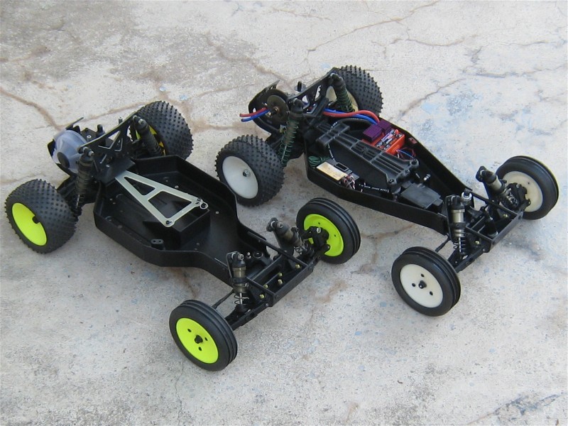

Re: RC10 B1.5

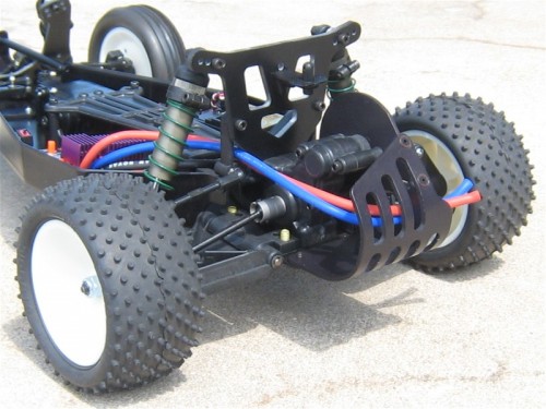

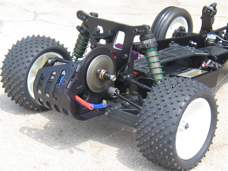

i doubt this one will ever be run. but i wouldn't mind picking up a used t2 to build a clone of it to actually be used. but that being said, i don't even use the runners i already have.

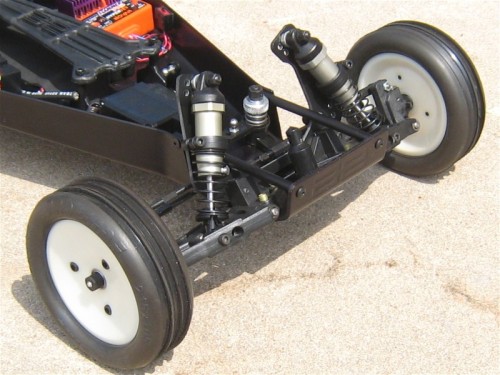

i doubt there'd be much difference. the suspension, and it's geometery, is exactly the same as the worlds car. other than the .89 front shocks. the only real difference would be the 2.60 trans. total weight should be very close, too.

Thanks for the updated pics! I've begun a copy of this buggy myself; you've inspired me. That has got to be the best thing about this forum! Personally, I can feel a real difference in the stiffness of the back end, because there is less flex in the bulkhead, and I can't wait to drive it on a track.

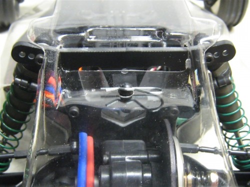

if it wasn't for trying to put something together that associated "could've made", it would open the body choices up. but, i really only have one associated option that'll fit, and it's a viper. my only issue is that the tower sits towards the rear more than and standard rc10. so creative cutting, as well as making some lexan filler panels will need to be done to cover it.

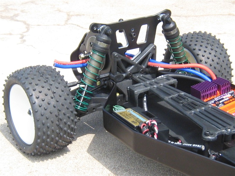

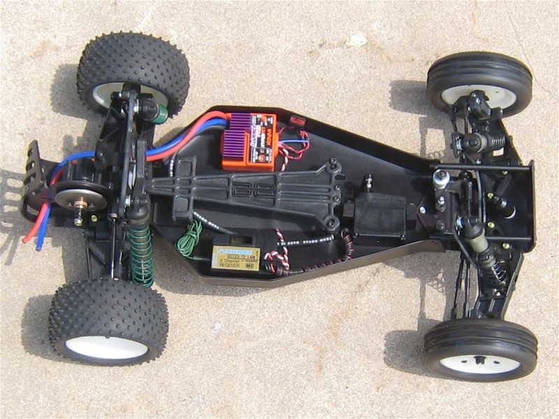

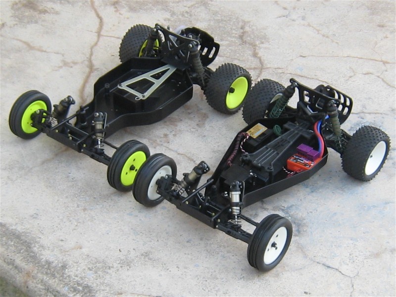

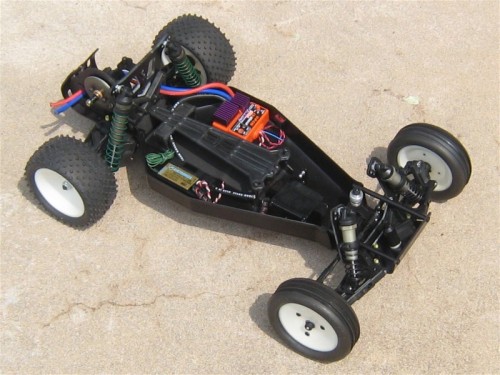

not much since the last couple of pics. i got the trans built (thanks again for the parts). i was gonna just use a b3 slipper on it since i had new hubs for it. but when i went to put it on the car, i couldn't find any b3 discs. just ones for the robinson lightweight slipper. because of that, i decided to hunt for a new 2.25 slipper inner hub to go along with the new outer you sent me. i already have a couple new discs for those. al is hooking me up with a new inner hub (thanks al).
i had a new airtronics receiver laying around, so i put it in. when i can score a nip novak polaris receiver, it'll get swapped out. i got a nice ds spec motor for it from flipwillis (that's the motor that is in the t2 truck in the manual i have), but i really want to find a "mint" green label reedy sonic for it now. i'll put the ds motor in it temporarily. i also need to get some new 1700 scrc cells, some of the correct reedy battery connectors........ and a turnbuckle for the steering, too.

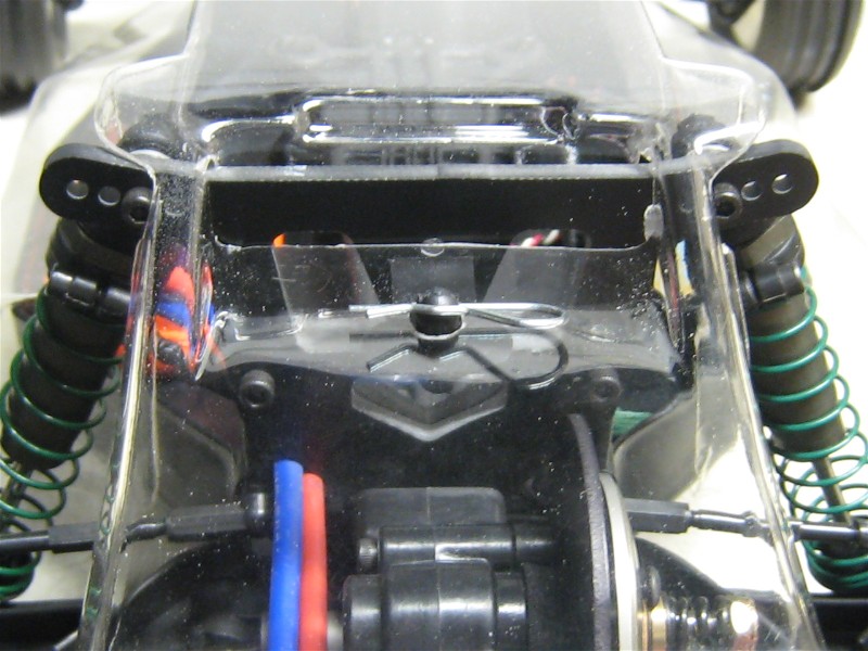

Re: RC10 B1.5
i think a b2 would be way too narrow at the front. so, i'm going with the viper. it's really the only associated body that'll fit the shape of the chassis.
biggest problem is that the shock tower sits further back than a standard buggy. so, i'll be making a panel to cover up the area i cut out. right now, i just notched it enough to fit the body. after the body is painted, i'll install the panel from the inside with servo tape.

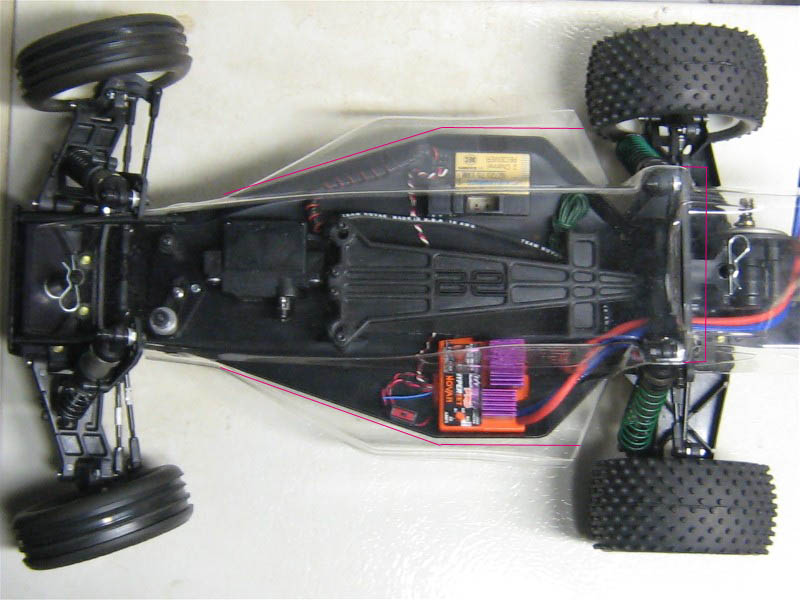

Re: RC10 B1.5

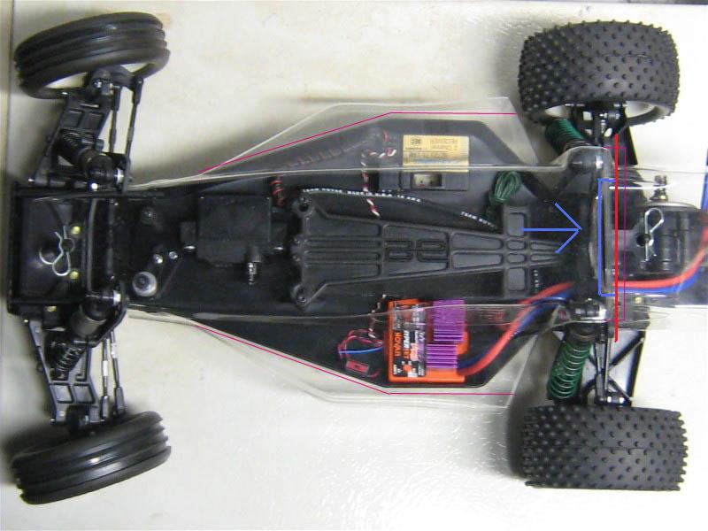

Well, let me know if you want to do anything crazy. I was thinking the sides could be taken in and the roof line lengthened. See the attached pic.
- Posts: 16816
- Has thanked: 36 times
- Been thanked: 1319 times
Re: RC10 B1.5
i wouldn't want to pull the whole rear edge back. where the bump outs are above the shocks, i'd only wznt to take it back to the red line. that way they wouldn't look so huge.
the real problem area is where i marked it in blue. that section needs to come back like a 1/4".
for me, i kinda like the look of a bulky body. if i'd do anything to the sides, i would actually flair it out more at the rear tire....... kinda like the turbo mirage.
