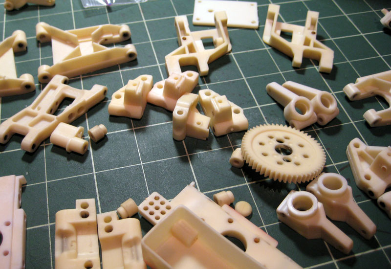

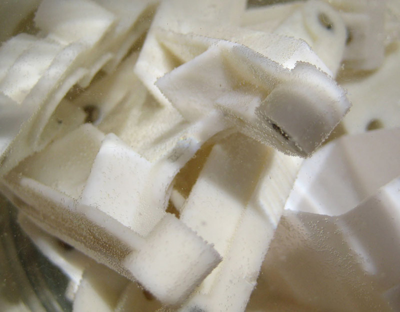

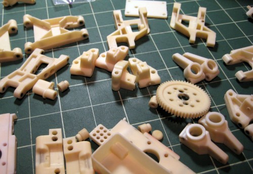

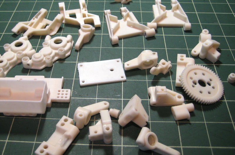

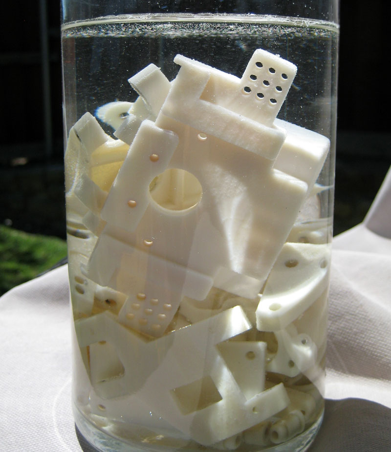

Well, these are my results (this is very exiting). I drop a bunch of parts in a glass flower vase with regular hydrogen peroxide from the pharmacy and they where outside for 4 sunny days. I move the vase once a day to keep the sun hitting the vase for most of the day (I also turned the vase around) and I would stir the parts with a stick 1 or 2 times a day.
At the end I washed them with regular dish washing soap.
Before
During
After
I don’t remember the last time I had parts this white in my hands, cant wait to built up a new car.
Thanks to MrLex from bringing this up.

gave this a try myself. put a bunch of parts in a glass jar, filled to about 1" over the parts with peroxide, and put it on the tree stump in the middle of the front yard. I left it there for 3 days, with the cap loosely applied. shook it 2x per day, and just let it sit. Parts are super white. and to my surprise, the peroxide is still active after 3 days. The small cuts on my hand fizzled when I grabbed some of the parts out.
I wonder how this would work on the mags on my dyno that have gotten quite yellow?
Don't know where I'm gonna find a pickle jar big enough to fit them to try :roll: :lol:

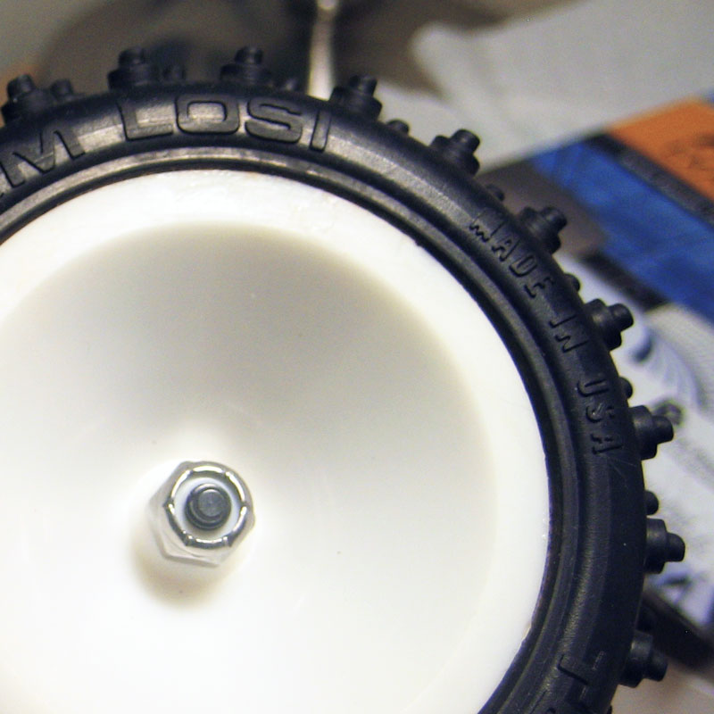

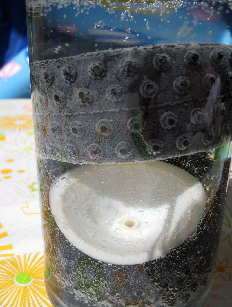

Anyone tried this with glued wheels and tires?
delsami
Posts: 242
Joined: Mon Mar 23, 2009 7:49 pm
Location: detroit mi u.s.a.
Re: Anyone tried this? Yellowed parts white
Post by delsami »
H O L Y @ # * !
xxx,lunchbox,blackfoot,t4,2 rc10ce's,rc10 graphite,rc10 worlds car,2 rc10 t's,xx4---GONE:mip4wdrc10,rpm worlds,houge rc10,super clod,sand scorcher,f103,frog,xxxt,b2,b3,tc3,jrx2,fox,yr4-m2 usa,yz-10 many more LOL
m_vice
Posts: 1312
Location: Dallas, TX
Post by m_vice »
OK, I did this with a set of fronts and rears and I did not see any damage to the rubber and the white got whiter. :D
I guess they wheels where not very yellow but they where yellower than the fronts so after the dip they did get whiter.
One of the tranny braces I had from above was very yellow and bad I decided to give it a shot and it came out like new. This was all a 4 day dip, 2 of the days not too sunny but the other 2 straight sun all day.
Original before dip.
During
After
