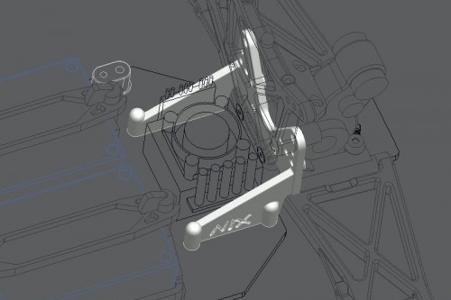

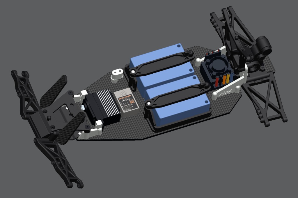

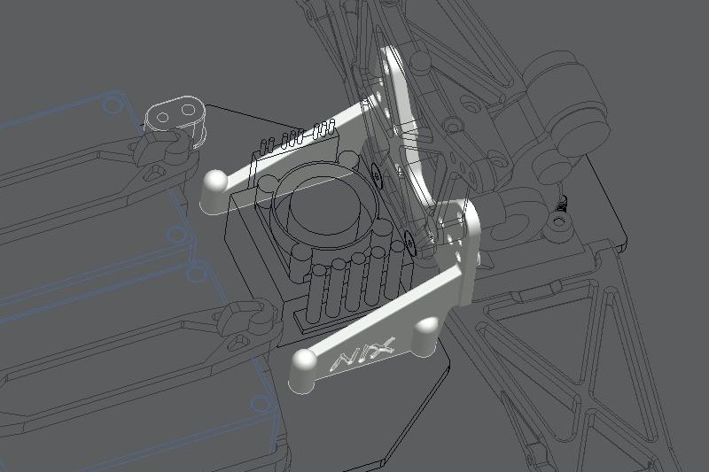

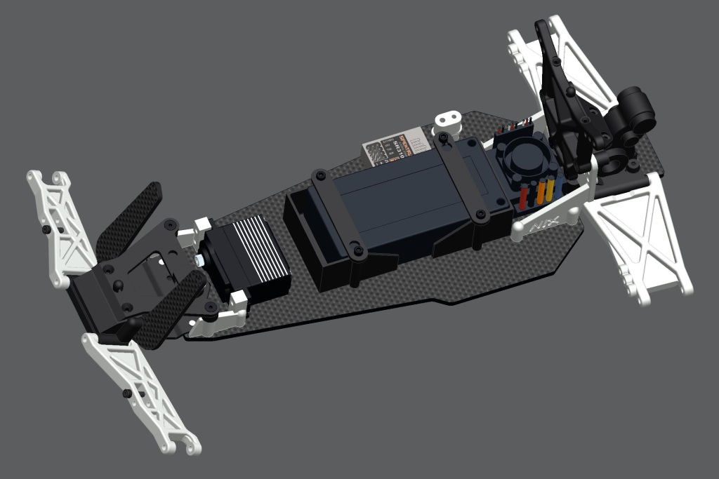

For example like this...
or
or

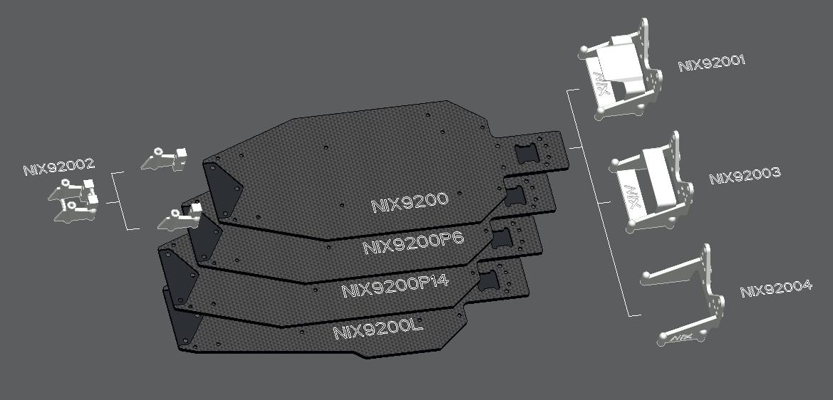

These are the options at the moment:
-Niki-

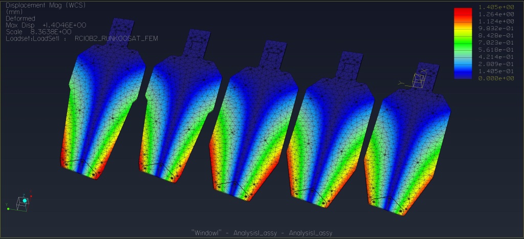

Dang Nikki!!!! You rock son! lol. Awesome work buddy. Do you think with the longer chassis, it might flex too much using 3mm carbon 660? Do you think a top deck would be a good idea or simply make the chassis out of 1/8" carbon? I've got all the parts except the white parts and chassis for this build. I'm using B3 parts for this bad boy.

Re: RC10B2 (B3) Graphite
You're welcome.
I'm no expert on judging chassis flex but I think carbon660 material is really rigid in 3mm. Personally I wouldn't be afraid of making NIX9200LP14 of it.
Top deck affects mainly bending stiffness (or how should I say it). Torsional stiffness comes mainly from lower deck.

Re: RC10B2 (B3) Graphite - NIXconcepts
I made a quick torsional stiffness comparison based on just chassis geometry.
Color indicates displacement. Bending has been exaggerated to make it clearly visible in the picture.
Bending force is equal on every chassis. These are the maximum values in front corner of each chassis.
NIX9200 -----> 1.192mm
NIX9200P6 ---> 1.205mm
NIX9200P14 --> 1.251mm
NIX9200L -----> 1.295mm
NIX9200LP14 -> 1.374mm
For example:
NIX9200P14 compared to NIX9200 is 1.251/1.192 = 1.049 -> so it has around 5% more flex.
NIX9200LP14 compared to NIX9200P14 is 1.374/1.251 = 1,098 -> around 10% more flex.
For example:

I just got Fibre-Lyte price information about all NIX9200-chassis versions. All versions have same price because dimensions are so close to each other.
All versions listed in my previous message costs:
GBP51.75 + shipment in 3mm Carbon660 material (VAT included, only inside EU). Outside EU price is GBP43.13 + shipment.
GBP64.95 + shipment in 3mm Fullcarbon material (VAT included, only inside EU). Outside EU price is GBP54.13 + shipment.
Just Email them chassis version and material you want and that's it. DXF's are all there
-Niki-
-Niki-
