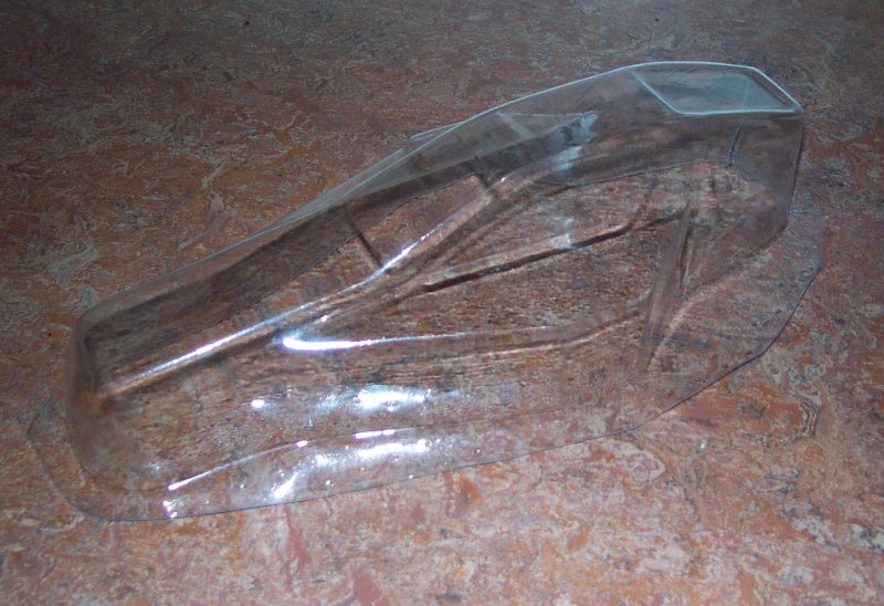

So I finally made a vacuum former and ofcourse the first body I had to test with it was this cars one. The hacked up b3 body i'm using at the moment is falling to pieces. Got a used deja vu tu body and moulded it with plaster then got gyprock wall plaster joining compound stuff and modified it with that.. Mainly just built up the front to sit a bit higher and added a scoop for ESC cooling.
I didn't quite get the surface smooth enough though in some places but it turned out ok apart from that.

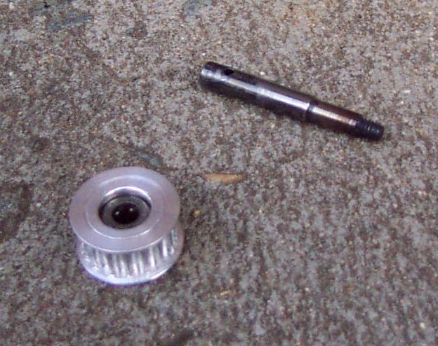

Made a one-way front pulley for it, gets quite a bit sideways now, need to make an adjustable one now so I can get some front brakes still.

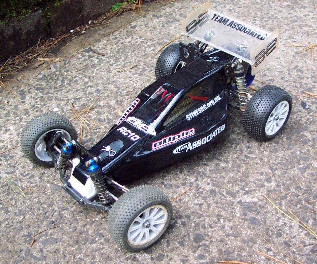

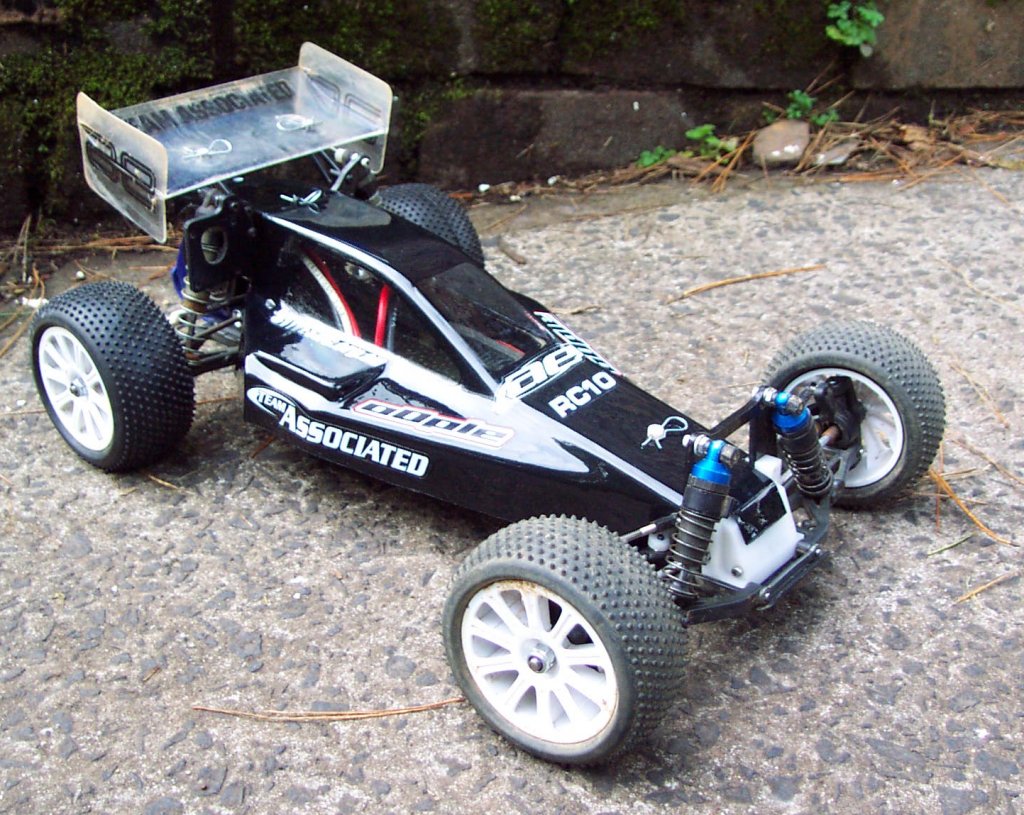

Painted the new body, pretty happy with it, paint seems to make most of the small imperfections go away :D

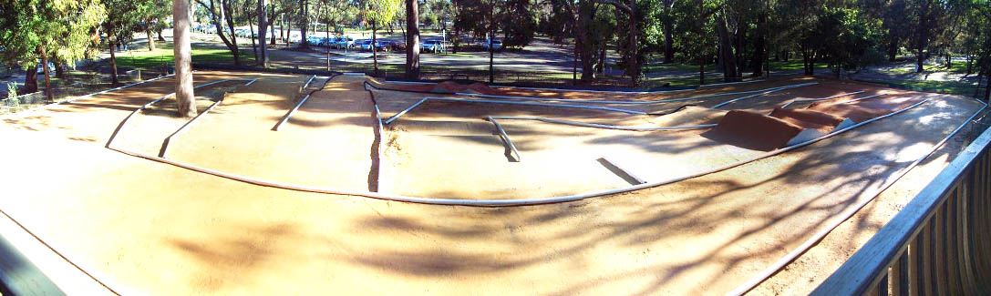

Made another onboard vid at St Ives this time
http://www.youtube.com/watch?v=UUlWDY3Hc3Q
Here's a pic of the new track
