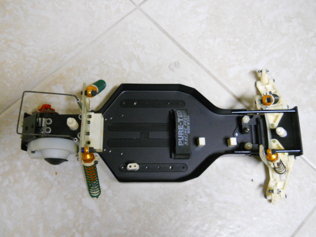

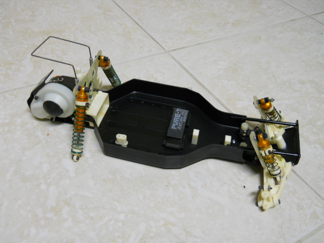

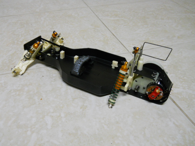

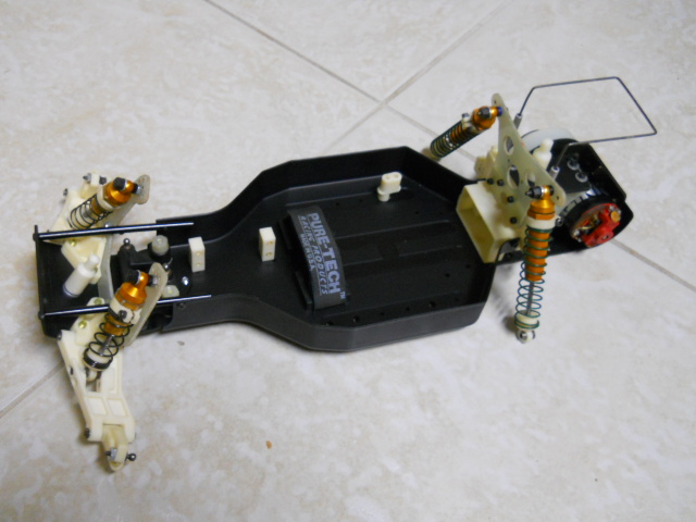

well here is mine. i didnt buy the complete kit just got the chassis,nose and nose tubs. since i have so many extra parts i used them instead to keep it on the cheap. still waiting on some backorder parts from tower to finish it up. also have a painted ss body coming i ordered
