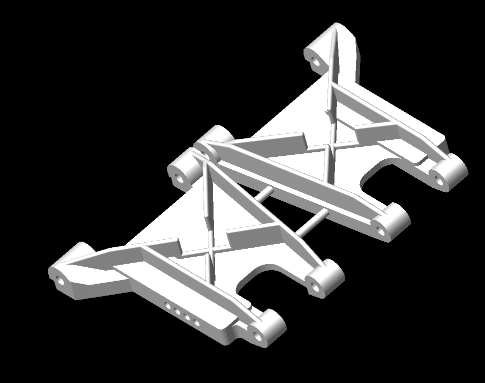

I tried the arms last night. I'm going to make a few revisions and then they should be good to go. They are 1/16" too long each. That's not much but it's enough and easy to fix. I'm going to redo the shock mounting locations. I modeled them based on the RC10 arm locations but let's be honest, no one uses the inner two locations and they are all a bit far apart. When the arms were widened, the outside mounting hole ended up too close to the tire. I'll revise these to be more usable locations. The last thing I'm going to do is to add the cross brace pattern on the top of the arms that were added in the later worlds rear arms where the braces aren't cut down as far. The material gets thin in this part of the arms and that little bit of material will help. These are all simple to do so I should have them done and reloaded by tonight.
EDIT: I updated them already. They are now loaded and made public.

No pics on the car but here's the update model. Yes, B4 hubs and cvd's.
In case anyone is curious, I've built in a whopping $1.83 profit into these in Shapeways to cover their fees so I'm not trying to make anything off of them.

quick question on the front arms - from what I've seen in other threads, these should be approx. the same length pin-2-pin as they Klein/Dynotech front arms, at 60.3mm, correct? Any reason they wouldn't be basically interchangeable with a truck front end setup?
"dynotech front arm specs.
center of inner pin to center of outer pin = aprox 60.3mm
over all length = 68.5mm"

My wide front arms did end up very close in length to the Dynotech front arms but they aren't interchangeable since the inner hinge pin side of the arm is shaped differently. The bulkhead for each is a different size. A Dynotech arm could mount on an RC10 arm mount bulkhead but you'd have tons of shims to take up the open space. The opposite is incompatible.

These arms are designed to use B4 rear hubs with RC10 inner arm mounts to achieve the same width as the modern cars with modern wheels while retaining the look of the stock RC10 arms. The point is not to copy B4 geometry or shock mounting locations so they weren't factored into the design.
