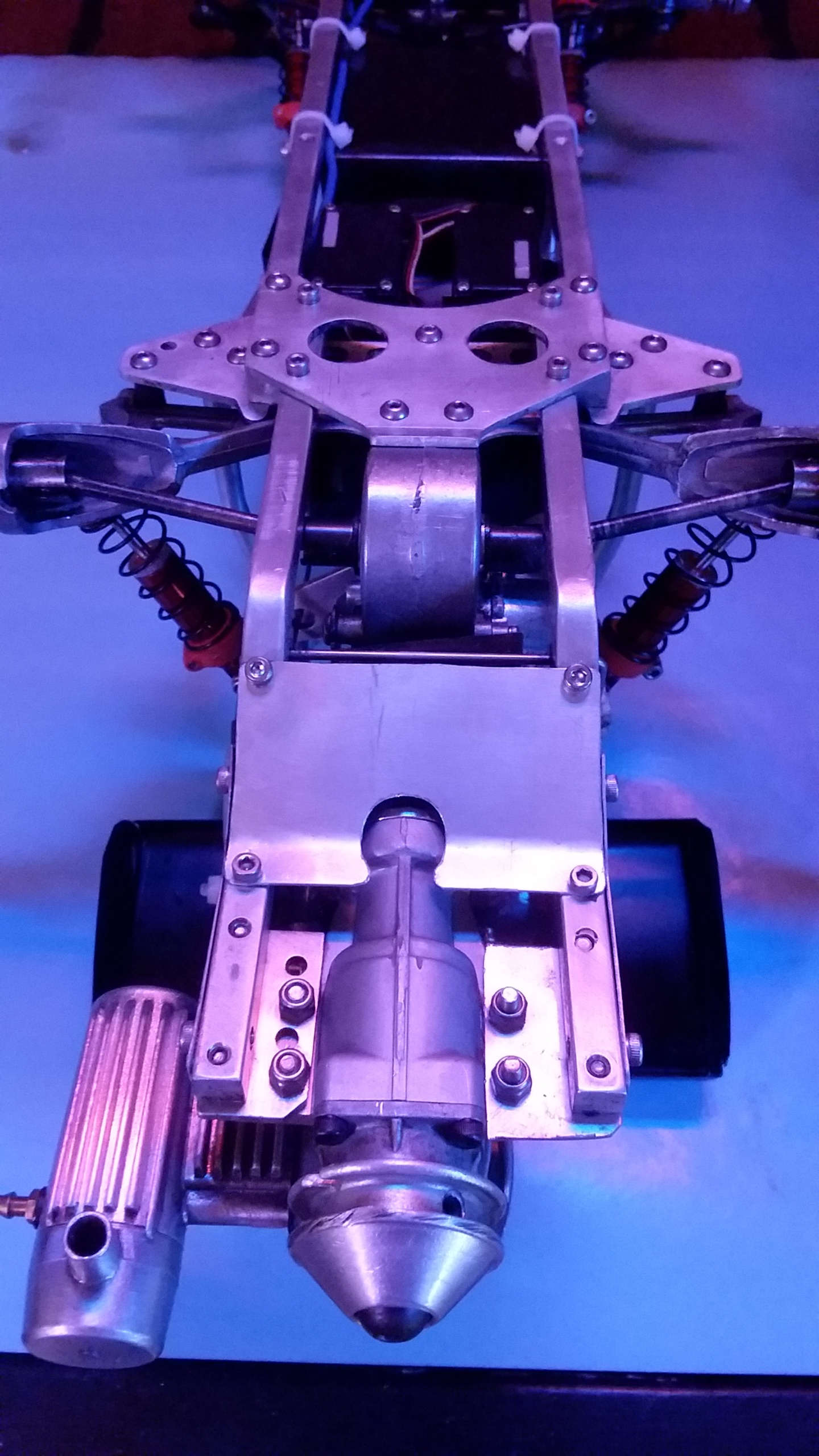

Factory flywheel protector
Had to make one for the basket case cause didnt come with one, not exactly factory lookn but it will do

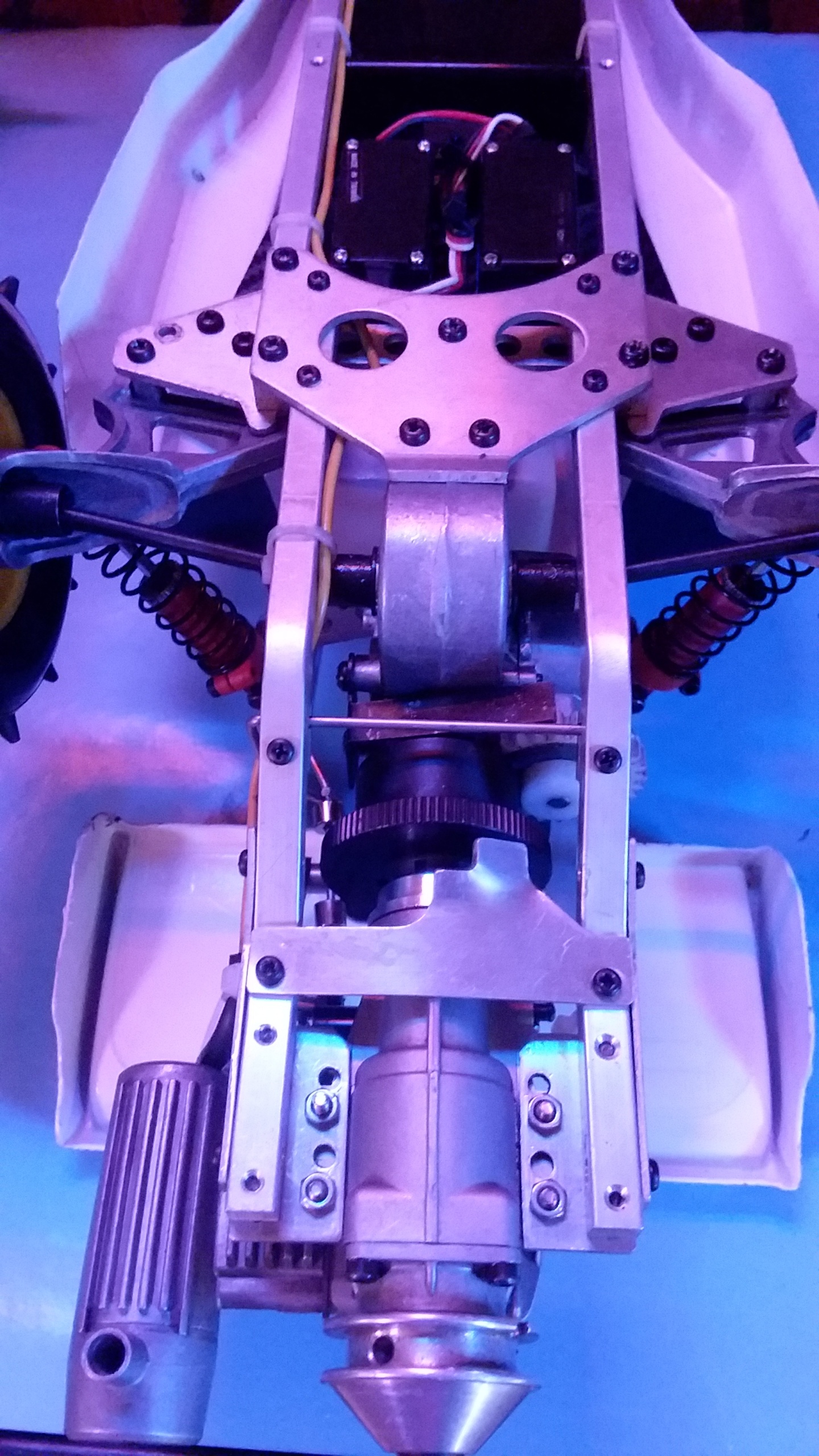

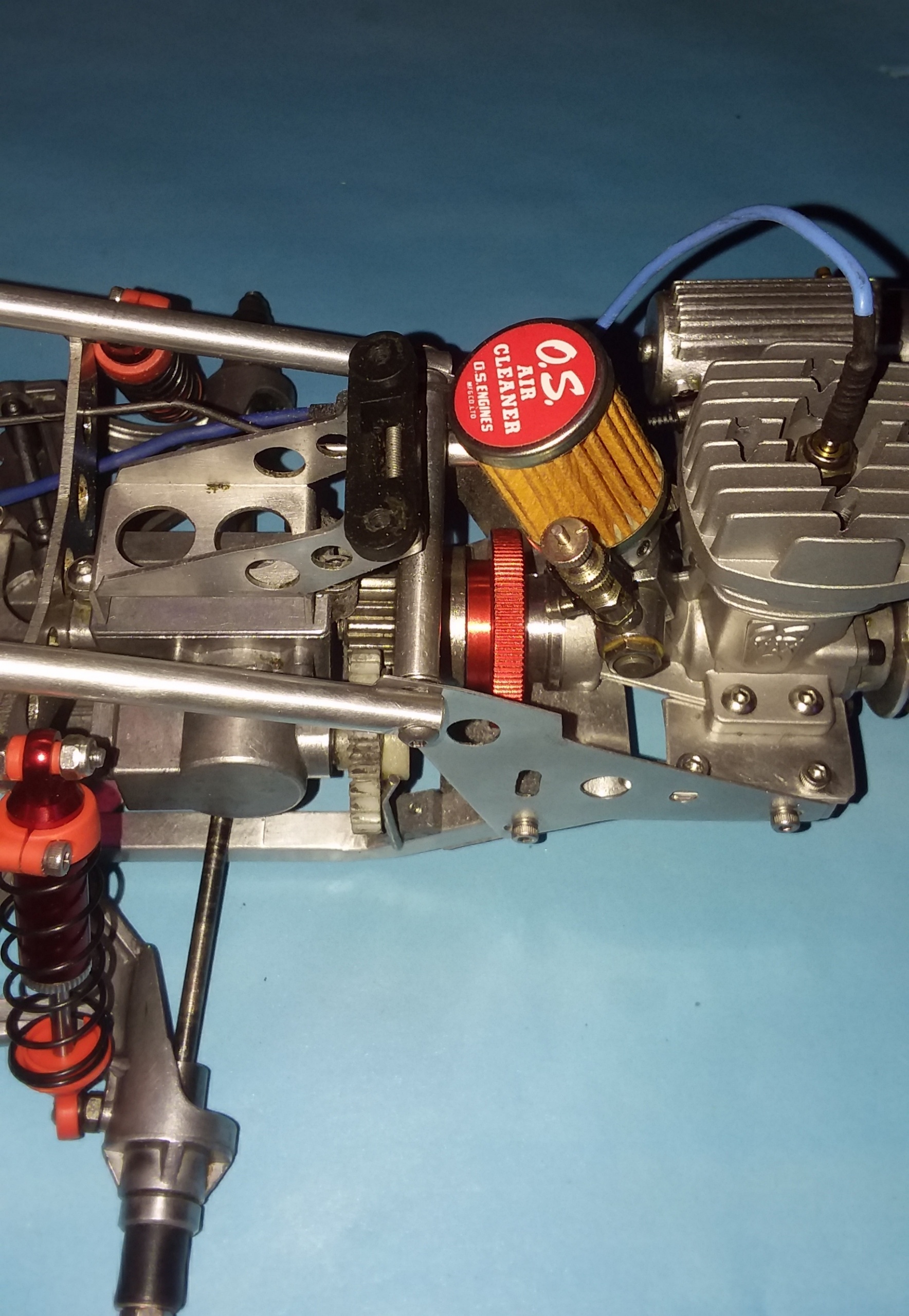

Opted for a red flywheel i had layin around, figured it matched the shocks and looked pretty rad. Its aluminum vs steel on the stocker, should yield quicker spool up too, not that its a good thing on these cars

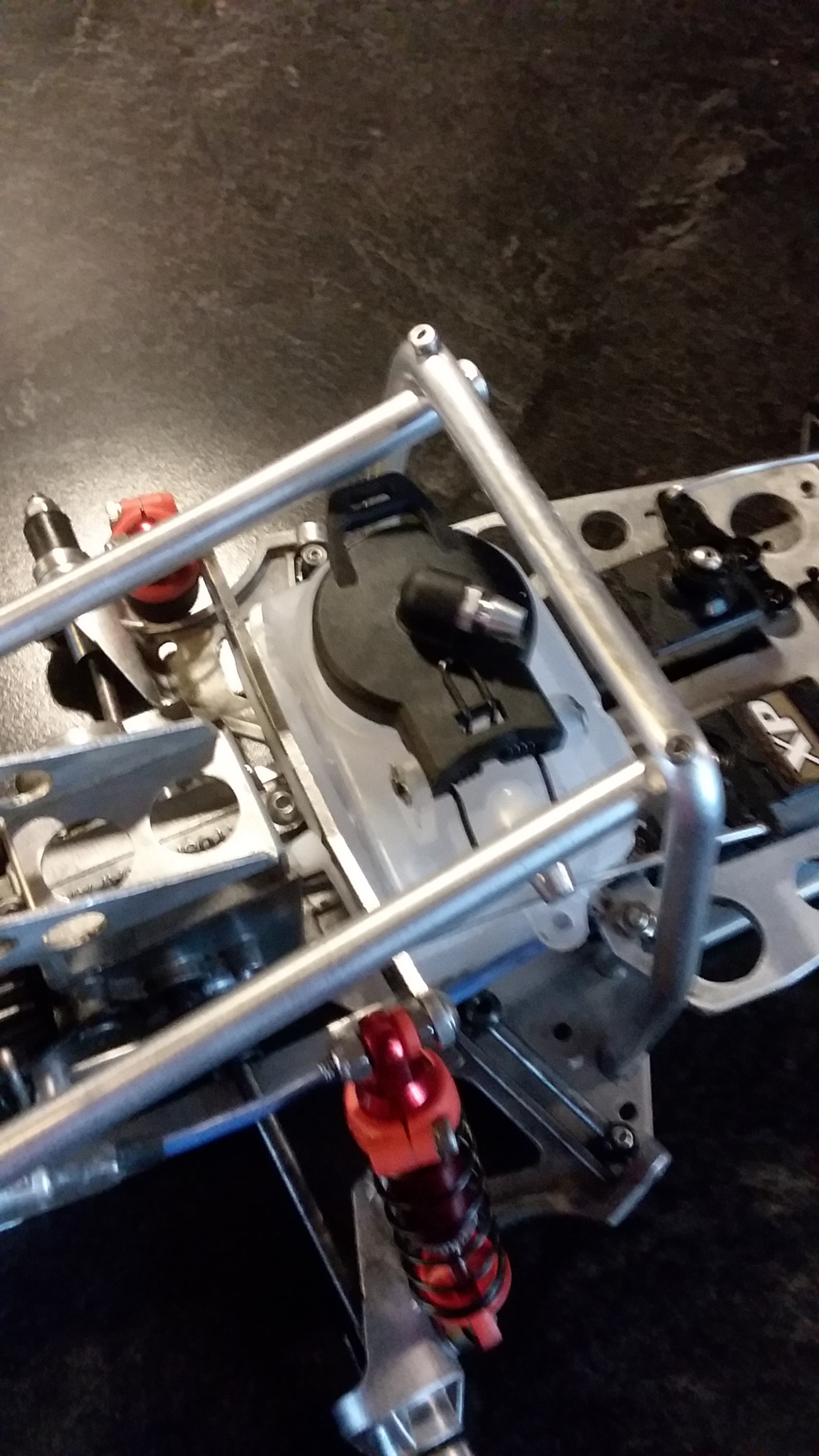

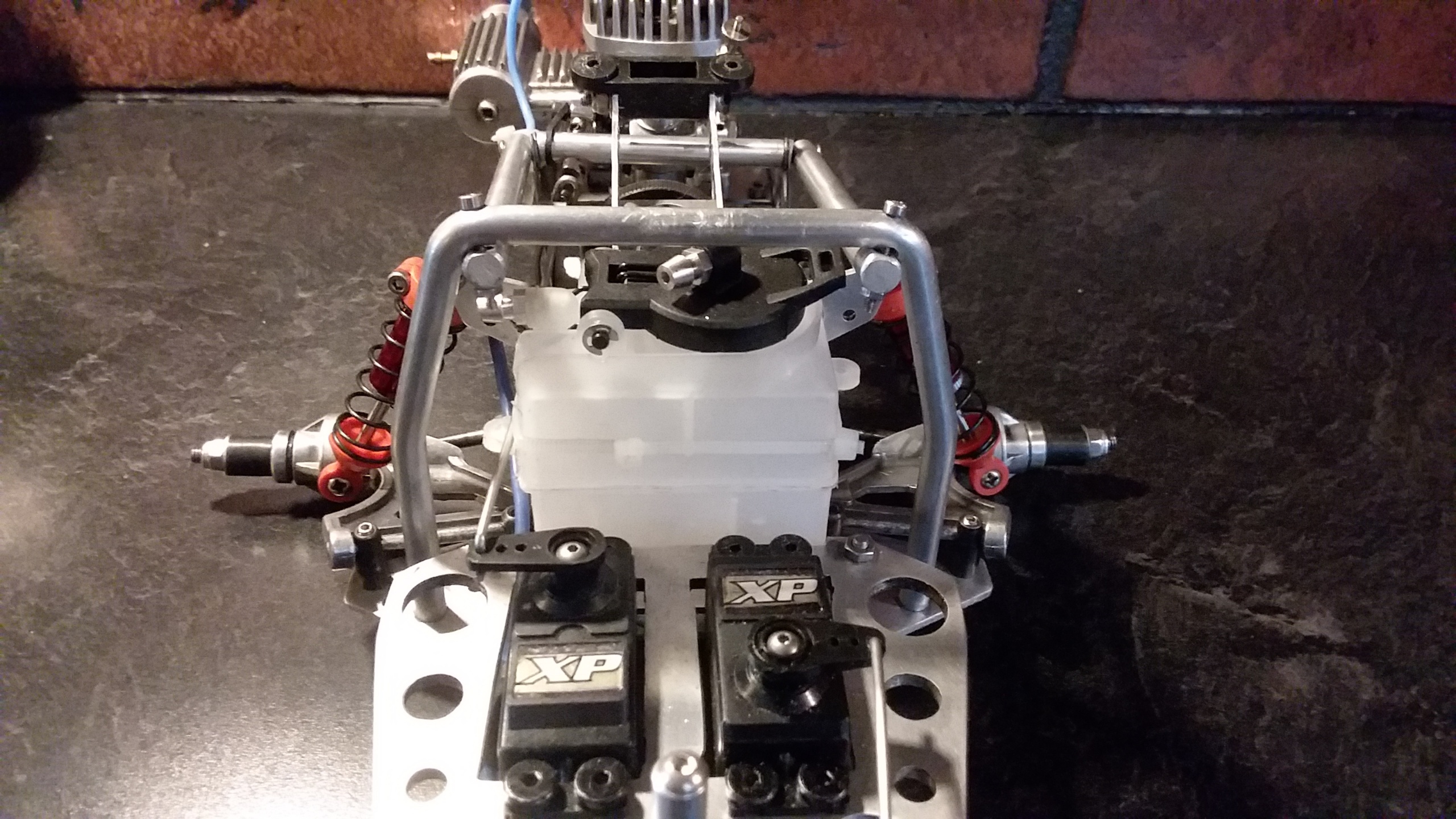

Update on flywheel :( I had to remove it, it just didnt have the intertia the factory one had, which is 3x heavier. Idle just wasnt as consistent. A little bummed cause it looked cool. On a positive note, i got a new 75cc tank in for $8 shipped. Its modern style lid. I almost gave up getn it to fit cause its so much bigger than the stocker, which i dont have for the basket case car. After some mods i got it to fit perfect and it even looks factory. Pretty stoked cause that modded nitro brute tank leaked all over the place i was using
