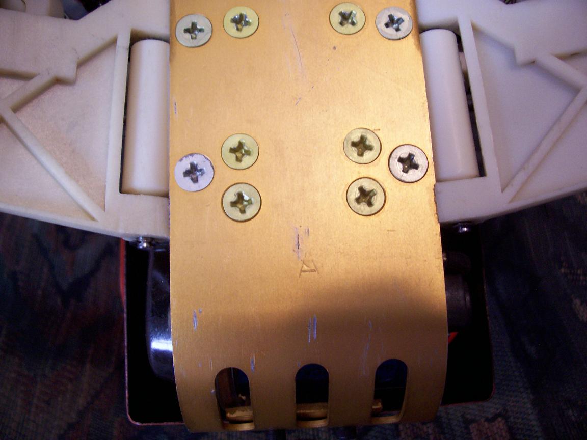

does anyone have any pics of "a/b double stamp" gold pan , or the ones stamped from the bottom??

I have a gold pan stamped A B .Why both I don't know .It is drilled and counter sunk for the for both the six gear and stealth trans. And a early Bottom A stamp gold pan . I don't want to take the trans out of the A B chassis for a pic. But here is a pic of the A stamped on the bottom chssais . I may be wrong but only the early edinger chassis's had the bottom A stamp. I am not up to the RC10 history as far as letter stamps on the chassis just passing along what I have learned so far.The A B stamped chassis that I have came with the CE stealth kit that I assembled back when they came out . I still have the car and have never ran it .
