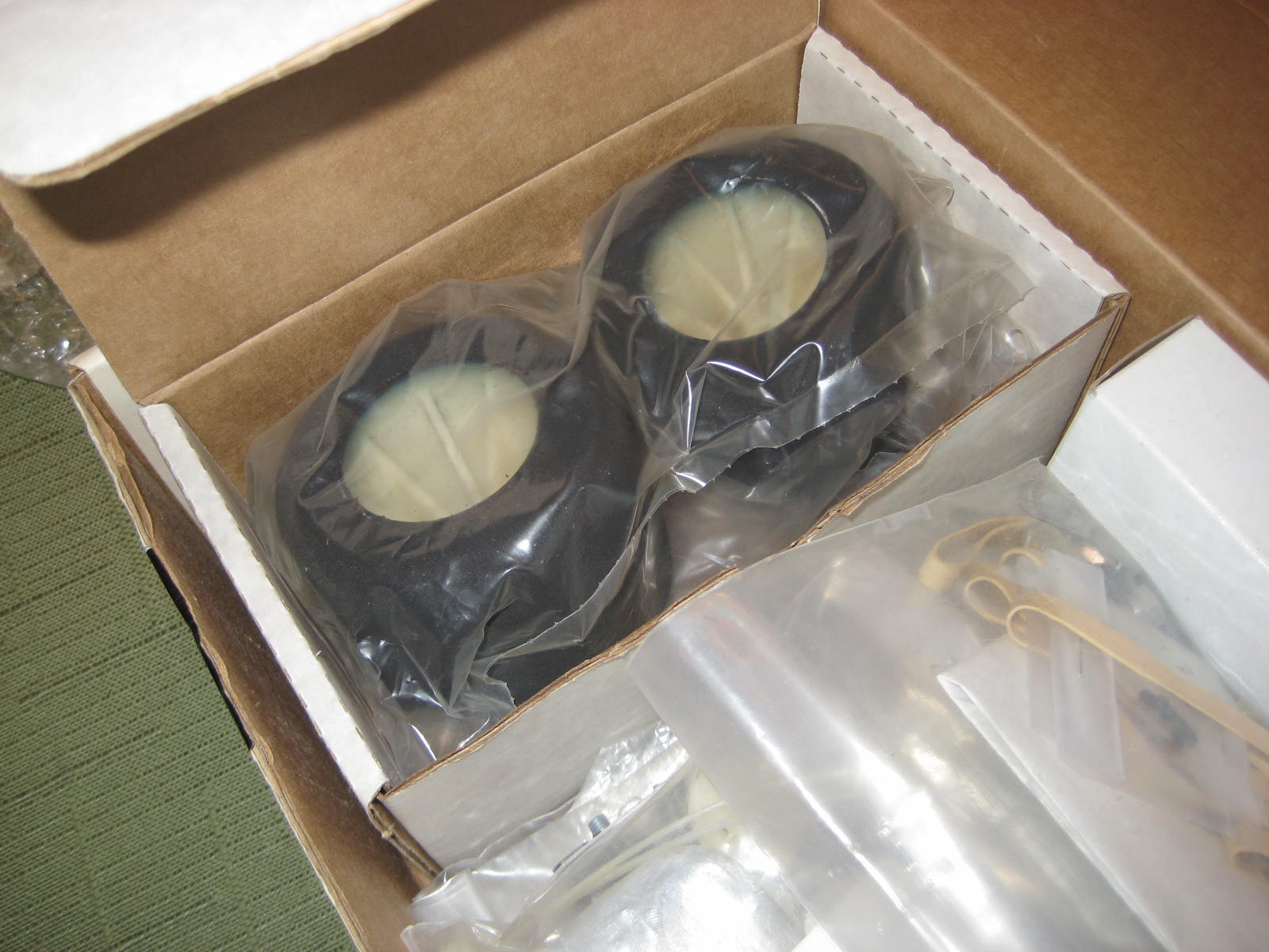

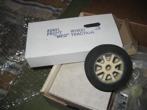

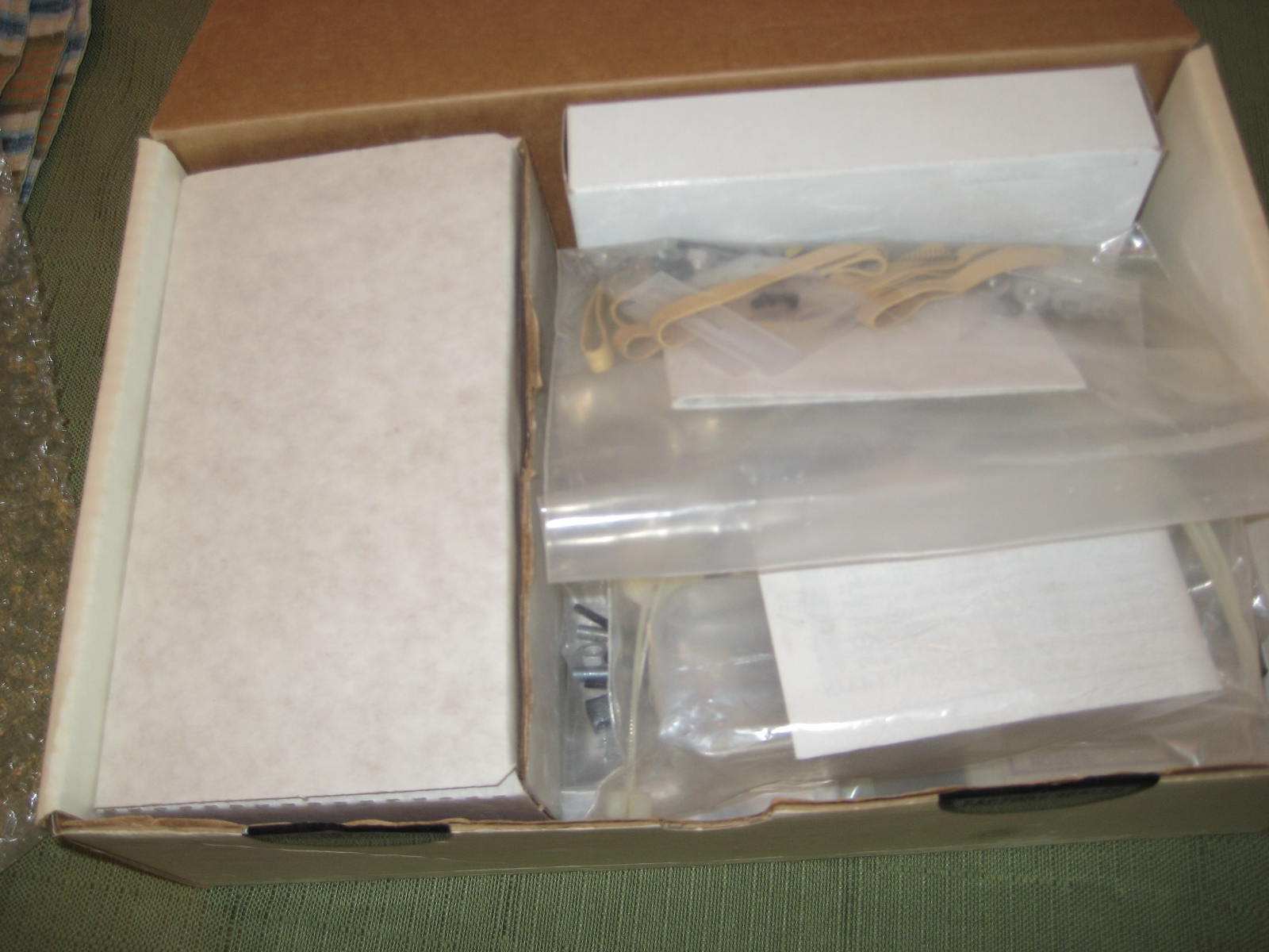

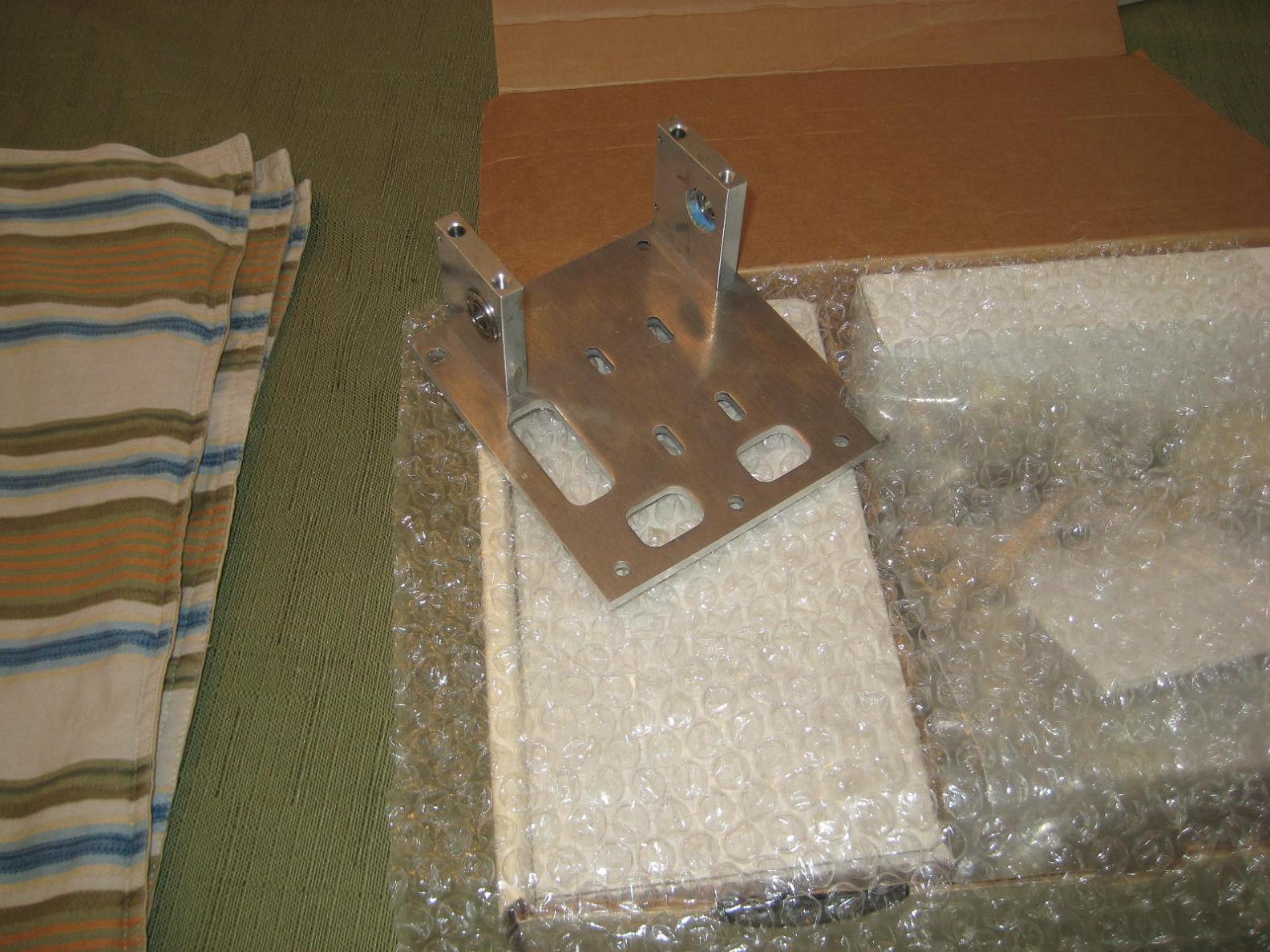

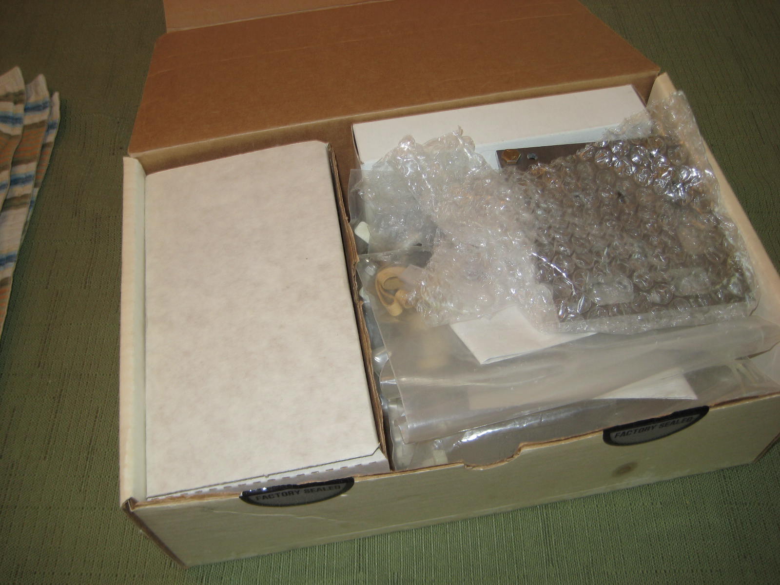

I found this on eBay and was really excited as I had been looking for a nice 1/8 scale car for a while, someday I'll get a RC500 but for now this will have to do. It was posted a whole 15 min. when I saw it and I knew it was the right thing to start with and the price was right. The previous owner is into airplanes and so he decided to get rid of this with not enough time to play on the ground. The assembly was already started by installing the left and right rear bulkheads but that's as far as he got. This model is similar to the RC300 but does not have a diff and has bushings instead of bearings. I've already got the bearings to replace the bushings but that's about all I'll be able to upgrade as the diff parts are very hard to find and this will be built as a RC250 not an upgraded RC300. This kit appears to be a later kit perhaps from the 1992 timeframe as that is the date on the 1/8 scale catalog that was in cluded in the kit and it is supplied with a Sullivan fuel tank instead of the tin ones that the earlier ones came with.

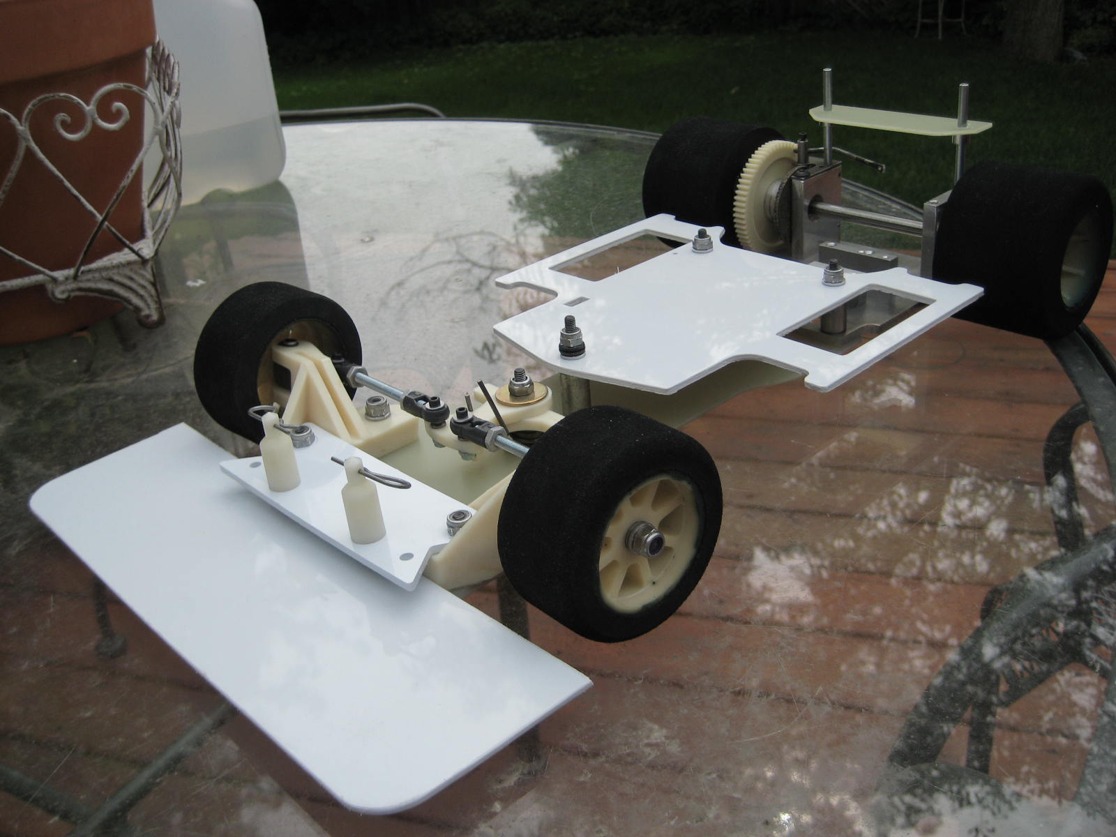

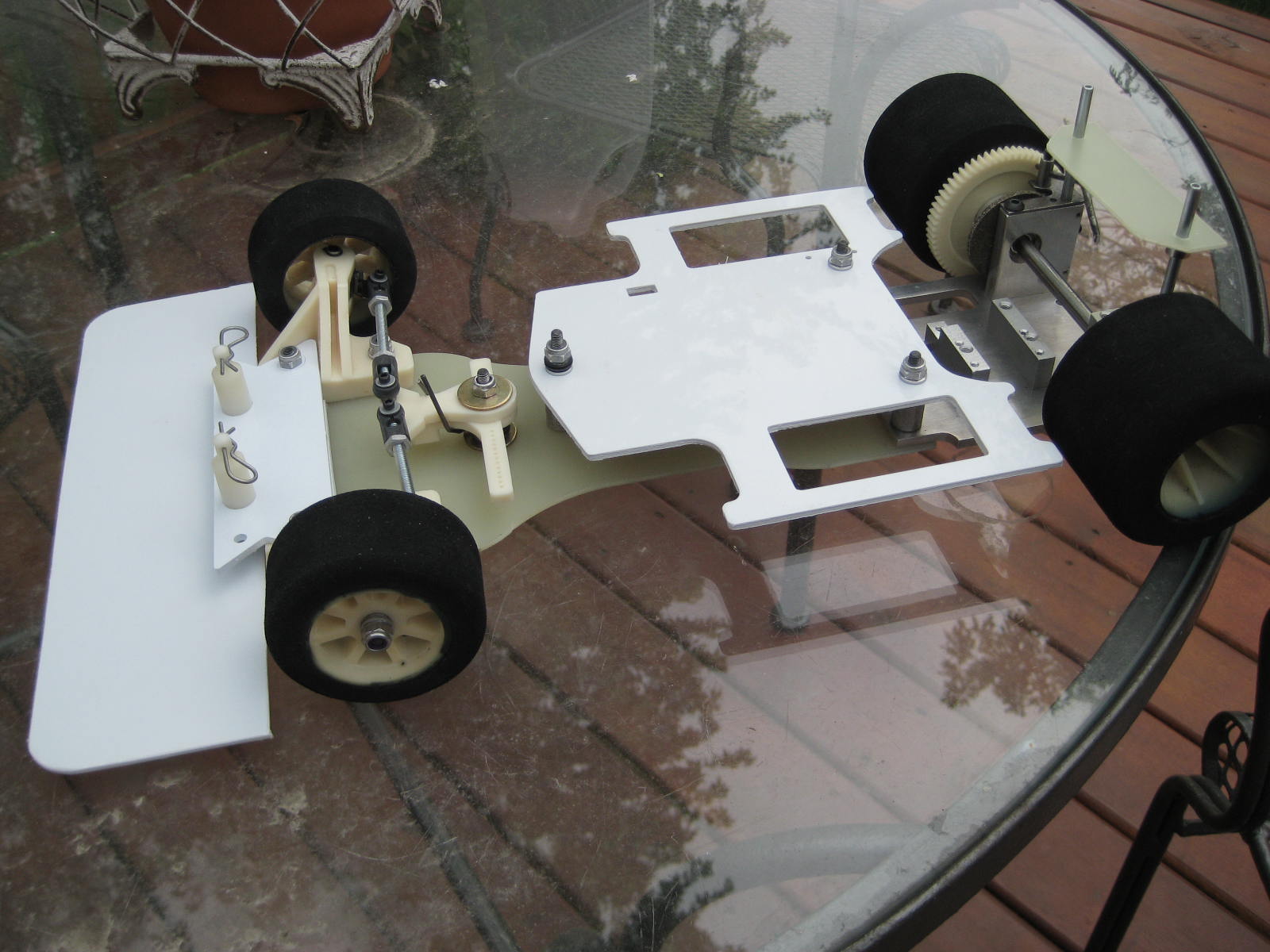

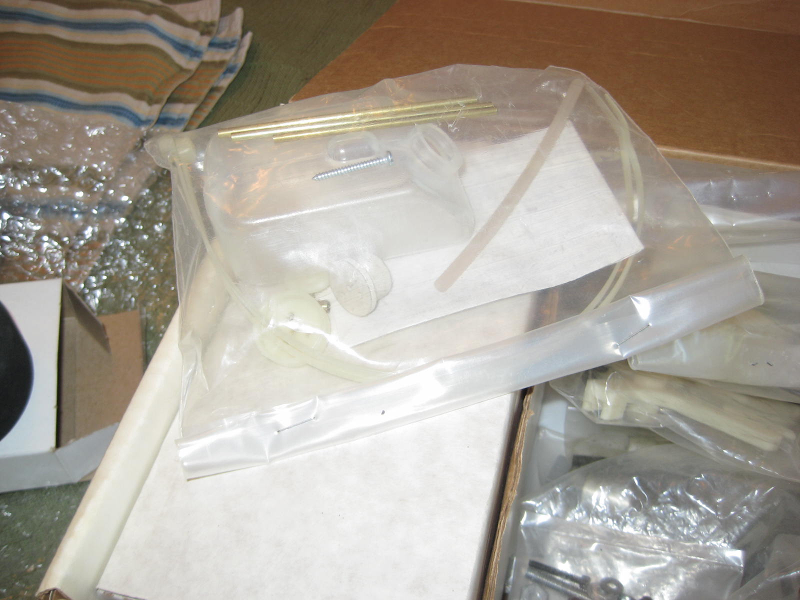

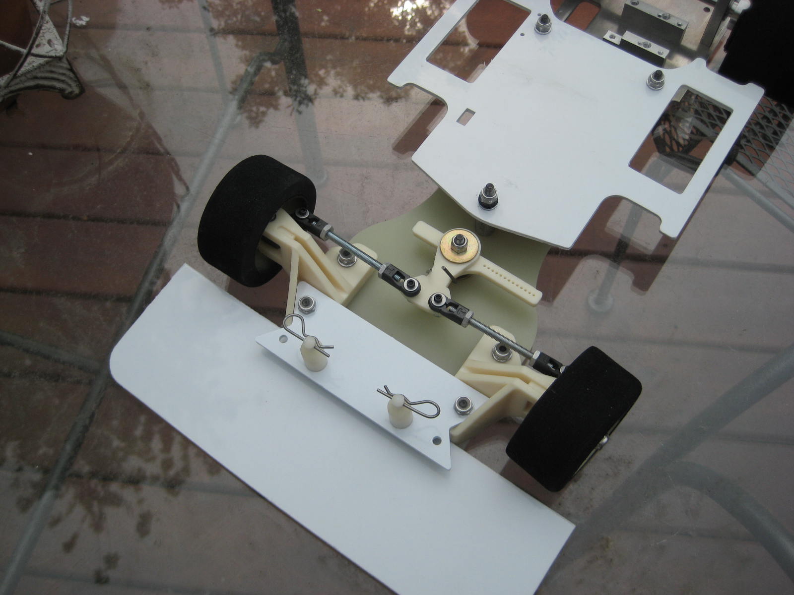

I got busy assembling this kit the last couple of days, so I thought I'd shoot a picture or 3 and post. It didn't get any comments before but for $125 I think it's pretty cool to have the fun of putting together an old 1/8th scale car like this. Instructions are not the best I've ever seen but It does resemble a rolling chassis. That has got to be one of the biggest front bumpers I've ever seen. Not sure what I'm going to do about a fuel tank as I'm not sold on the Sullivan tank it came with, very little chance of finding a vintage Johnson fuel tank and filler so I'm still undecided. The engine is also up in the air but I have a couple of leeds and maybe I'll find something like an old K & B 3.5 or a Nova Rossi .21.
Certainly would like to hear any helpful comments or any leeds on the pieces I need to complete.

looks good, what are you going to cover it with. I would try to find a k&b as I believe that is what the motor mounts from the stock kit are made to fit. My rc300 has an enya powerplant in it and has had the motor pod plate drilled/slotted to get the clutch to properly line up.

Yep, the motor mounts and flywheel provided are for the K & B but not a lot of those out there unless for marine use. I have referred to your RC300 build many times, Anthony it is a great car and you did a super job rebuilding it. I'd like to find a nice period Can Am body but they don't come around very often so I'll have to be patient which is not one of my better traits.

.....a01buta.....GREAT BUY at 125 bux!!!............i have 2 of these cars and a bunch of parts......i have ordered a Porsche 917 body from Bruce at www.historicrc.com for one of my 250's......great bodies and great service.....if you mount a late model .21 the pod will have to be drilled or coustm motor mounts will need to be made as the old .21's used narrower shorter crankcases......i took Serpent mounts, turned them around 180 degrees and drilled my pod....works great...i'll post pics later........Matta01butal wrote: It didn't get any comments before but for $125 I think it's pretty cool to have the fun of putting together an old 1/8th scale car like this. The engine is also up in the air but I have a couple of leeds and maybe I'll find something like an old K & B 3.5 or a Nova Rossi .21.
