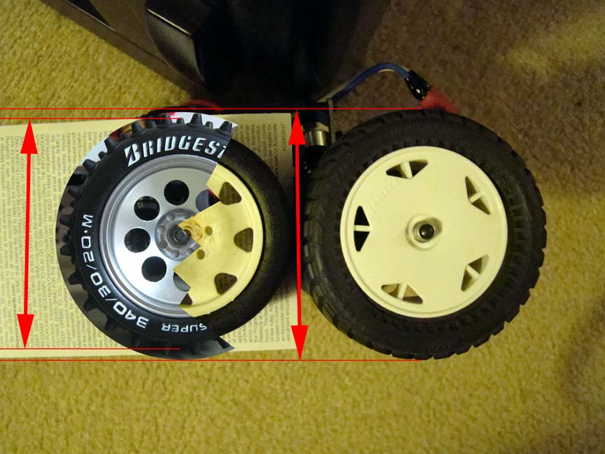

I know this thread is kinda old but I've been pondering this as well and thought it would be better to add to an existing thread rather than start a new one.
Nobody asked the thread starter what tires he was using. If he happens to be using modern larger diameter tires then all suggestions need to be adjusted accordingly.
What are people using on their Ultimas with modern tires? I'm running CRP front axles which adapt to Tamiya wheels. My wheels are from a "Desert Gator" IIRC, and I'm trying to use Pro-Line Dirt Hawg tires. These are quite a bit larger in diameter than the stock old-timey Ultima tires.
I'm thinking I need a 12t or 13t with these big tires.
James
James

Hey Jim, modern tires are not bigger on the outside diameter. They have a larger inner diameter for the larger wheels. The idea is to reduce the tirewalls higher so it deforms less under sideway loads

Ed, thanks for the reply.
I do understand the principle you are talking about. And I was aware that that was the goal back in the late 80s when the 2.2 wheels first came out. However I got it in my head that in the ensuing years between then and now, 1/10 buggy tires grew in diameter for some reason. The picture below shows why I got to thinking that.
I have here an Optima wheel with a street tire on it (from one of the scale series kits) next to my Desert Gator wheel shod with the Pro-line Dirt Hawg. I overlaid another Optima wheel and tire over mine in Photoshop because I didn't have any vintage dirt tires to compare with. I did the jaggy cutaway to show that I have properly maintained the scale. Anyhow, you can see that if you ignore the spikes, there is a drastic difference in diameter. On the Optima side, I put the red dimension lines about half way up the spike height since I figure that's about equal to the Dirt Hawg tread depth. ...So this is why I said what I did. I don't have much else to look at around my house to draw other conclusions. Are the Dirt Hawg tires just abnormally tall in side wall??
thanks,
James
thanks,
James

Part of the issue is the dirt hawg tires. I find that they do have a higher sidewall. I think the reason is, if running these "streetish" tires on say a concrete off road course, the additional sidewall gives additional ground clearance. A useful tool if running off road on hard concrete. (saves parts!)

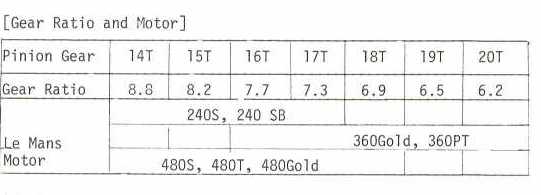

Yep, that is quite handy, thanks. Given that I was going to run a LeMans 240ST, and my larger tires, I'm thinking of trying a 13T.
