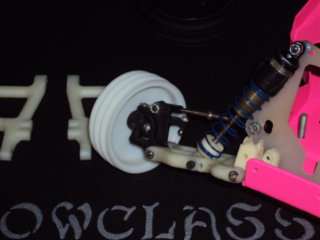

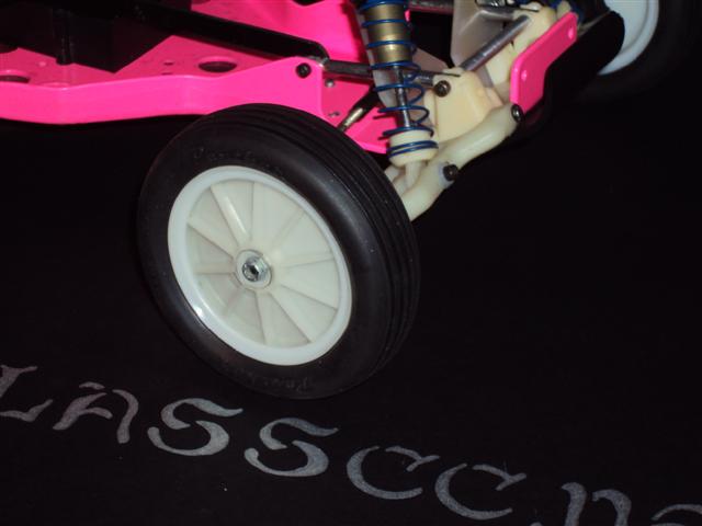

since this topic has came up again i figure i would post these pics of one of my projects since it has the losi xxx front axles, spindles, caster blocks, and losi xx front wheels.
the with has changed a good deal. its pushing aprox 9.75" wide. roar rules states 250mm width max which comes out to a little over 9.8". so i'm pushing my luck and will need to keep an eye on tire width in order to stay within the limits.
now as far as how good it will do i couldn't even begin to tell you cause the car has yet to be finished. but hey i don't it so i could have front rims that matched the rear rims i wanted to use.
