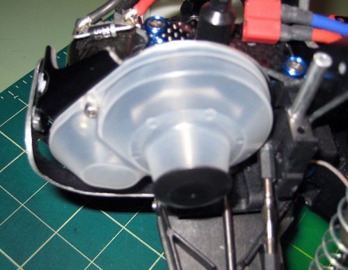

A bit of an update to my runner;
http://www.rc10talk.com/viewtopic.php?f=35&t=5265&start=0

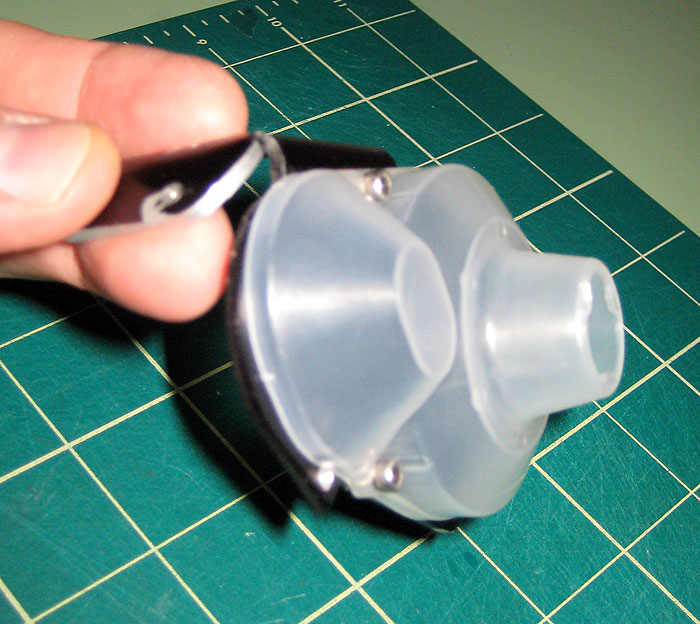

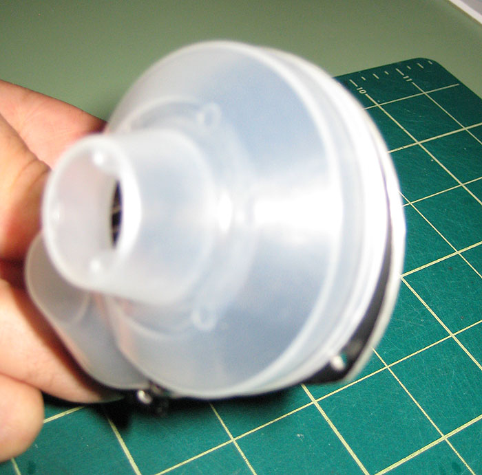

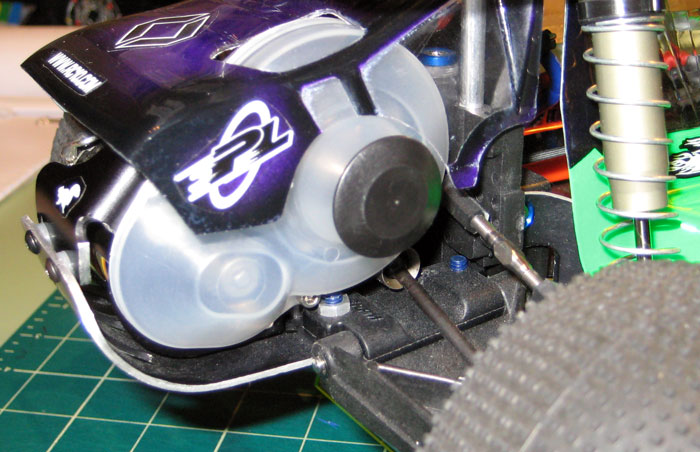

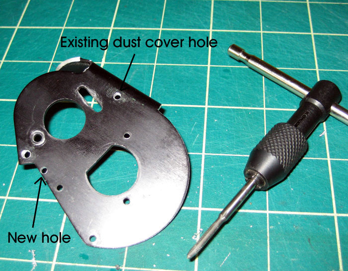

I used a B4 molded cover and it woks perfect. You only need to make one hole on the stealth motor plate (the lower one) and use the existing upper hole.
The trick is to:
1. Mount the dust cover with the top hole
2. Rotate the cover to center the top shaft of the tranny on the torque clutch opening
3. Mark the lower hole
4. Carefully drill and tap for a 4-40.

I wonder how a B2/B3 cover will fit? They still offer them as well. And I think you could get away with a 2-56 or 2mm screw, lessen the chance of drilling through the edge of the plate.

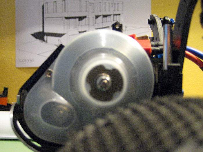

I made a new stealth motor plate that used the B2 cover

SnoopMaxx wrote:I made a new stealth motor plate that used the B2 cover
Nice fab work Snoop
