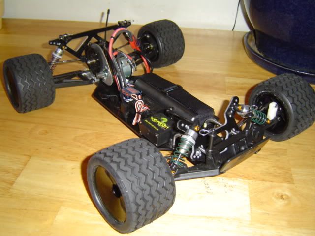

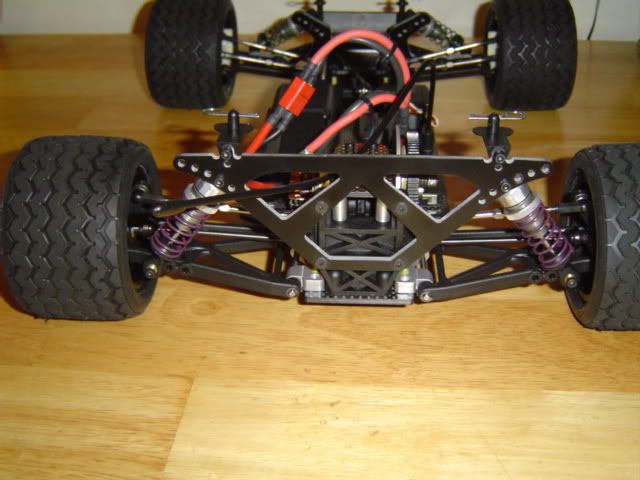

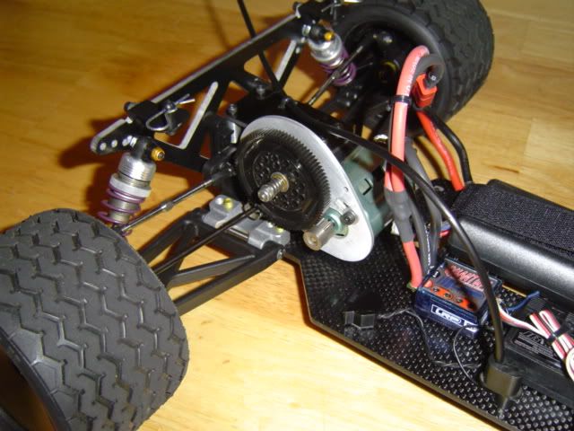

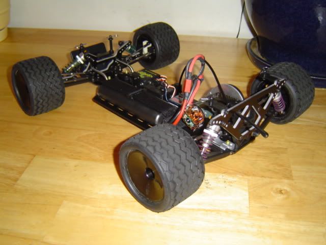

Dave, I run a Kranzel's 10T based truck like scr8p described. I bet if you posted a wanted ad on dirtoval.com com you could find an original kranzel's RC10 terminator chassis plate for really cheap. It makes for a really nice oval truck, especially on carpet. Here's some pics of mine with factory works shock towers.

nice rear arm mounts, who makes em?

those are the GPM ones that were blown out on Liquid RC a few years ago, I bought a few sets, and ended up selling a couple of the sets to people that needed them,,, now I wish I had them for other projects!
As far as making your own chassis check out my build thread in the Truck section.
