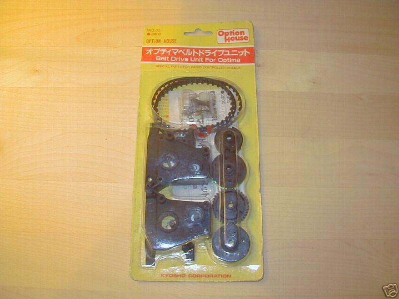

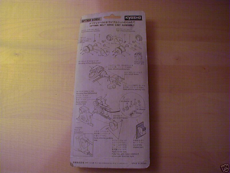

Re: Optima Belt Drive
here you go........
picture copied from ebay
Yes, that's the one. I ordered 3 of these from Tower Hobbies back in 1998 along with many other "OT" Optima parts still floating around in their inventory. Long gone now.
