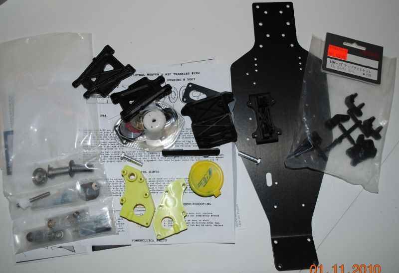

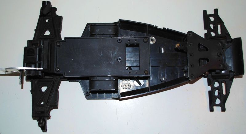

Hey guys. I have a couple of Ultima based builds going. I thought I'd post a few pics. The first one is a buggy that I would have liked to build back when I raced my Turbo Ultima. Originally when I restored my Turbo, I thought of doing this...adding tons of hop-ups but I got kinda nostalgic and restored it to box art...plus a few Option House additions: motor guard and turnbuckles. So far I have a minty-fresh Ultima graphite chassis and A&L Leathal weapon transmission along with several other minty parts. The second build is just a restoration of my brother's Outrage, plus a few hop-ups. He bashed the crap out of it and I'm adding some of the used hop-ups I replaced on my Turbo.

Nice start to a great Ultima build. What arms do you have for the front of the long wheel base chassis?

I haven't decided on front arms yet. I haven't done any measurements yet as I'm trying to figure out how to get 2.2 front wheels all around. I know several have done similar conversions but I'd like to do some of my own research. I like the long wheelbase Ultima chassis too because I think it looks better with the larger wheel/tires.

With Academy griffin parts you're done in no time for the 2.2 conversion

first generation: everything looks near identical to the ultima but the bearings are 10X5mm instead of the awkward 8X4 ones.
On the other hand: team crp's adapter to 5mm axles are an easy solution too and could even be simply combined to the academy's wheels

Yeah, I think the longer chassis makes a difference. It's funny, even the lowly Outrage has the longer chassis setup.
I've obtained a set of equalizer shocks too to go with my build. What are you using for front arms on your Ultima?
