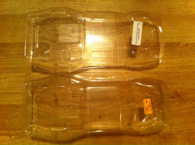

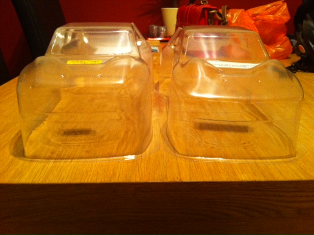

I had a look at the 2 shells side by side, there appears to be no difference in length at all, the only real difference is at the front. It seems the 'CR' shell has the front mounting holes further forward, and apart from a slightly larger frontal area, there's no real difference.
The shell you have will fit just fine, its just that the mounting holes will sit further forward.
I've attached a couple of pics, but they were taken with my phone indoors, so not that great :?
I actually prefer the older shell to the CR one, I may think about getting another one now :roll:

Thanks Ben for going to the trouble to dig out those shells & taking the photos. The difference between them is rather minimal to say the least! But like you I think I prefer the more aggressive 'humps' to the front on the original XXT shell.
I actually came to the same conclusion when I cut the shell out last night & offered it up on top of the chassis... the rear holes have to drilled as per the moulded-in 'pimples' or else the rear shocks will not pass cleanly up into the lumps on the back of the shell - the variation to take up the length has to occur at the front - as confirmed by your photos of the 'CR' shell. The only problem I can see (& the reason I guess why the CR shell has a 'flatter' front) is that the XXT shell will sit a bit high at the front - as the mount are now further down the slope of the shell..... if you catch my drift? Now the challenge now is to drill the front holes... taking into account the angle of the mounts.
Here's how it looks cut out & (temporarily) placed on top of the truck

DerbyDan wrote:The only problem I can see (& the reason I guess why the CR shell has a 'flatter' front) is that the XXT shell will sit a bit high at the front - as the mount are now further down the slope of the shell..... if you catch my drift? Now the challenge now is to drill the front holes... taking into account the angle of the mounts.
Yes, I was thinking that when I posted yesterday, something you will have to live with I think. Its also why I mount and cut my bodyshells BEFORE painting, its a whole world of pain trying to do it afterwards!
Probably best to drill a very small hole where you think it needs to be, and then see where it ends up, then drill/file from there perhaps?
