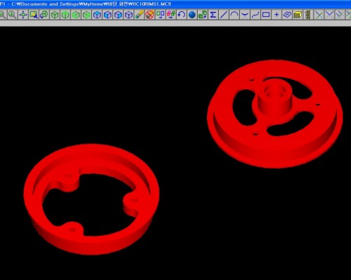

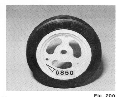

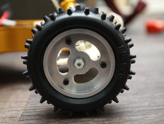

the optima alloy wheel guy (http://cgi.ebay.com/ws/eBayISAPI.dll?ViewItem&item=130261010483) is making alloy outer rims for #6854 wheels. my first idea I gave him was larger #6850 sytle wheels.

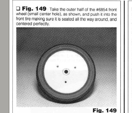

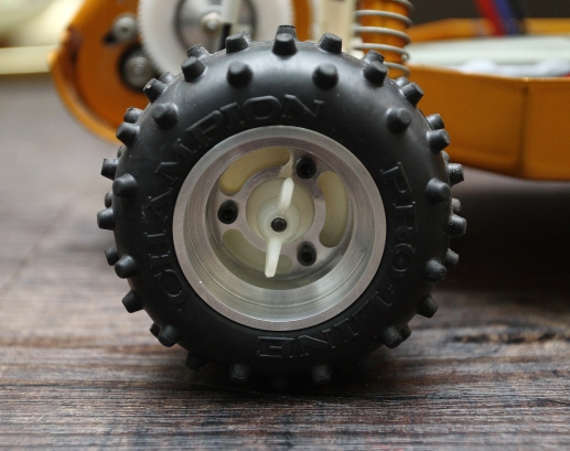

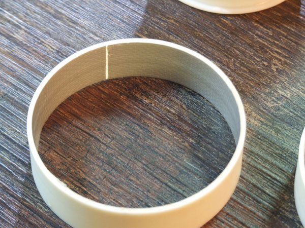

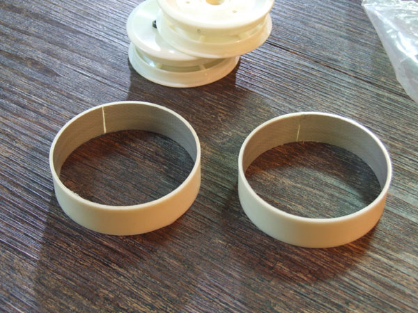

I noticed yokomo put 2.2" tires with 2.1" #6854 wheels in japanese version RC10 box. they attached single layer of thick 3M tapes inside of the the plastic rings to hold the tires tight. I tried same thing on mine, and it works fine with 2.2" tires. yes, front rims got fixed.

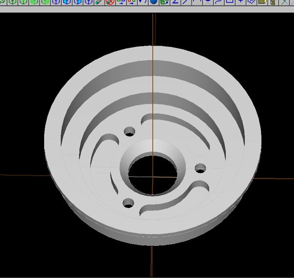

on the rear wheels, it's easy to make original style outer rims for #6804 wheels. and, still have problem with getting the right size tires.
do you guys have any good idea on rear wheels size?
1.9" is good for using inner rims and rings of #6804
2.2" 1 piece is good for recent tires, but has tire gluing issue.

- 2.1" #6854

- original #6850

the plastic rings in the top 2 pics are from yokomo kit. tapes were added insides.

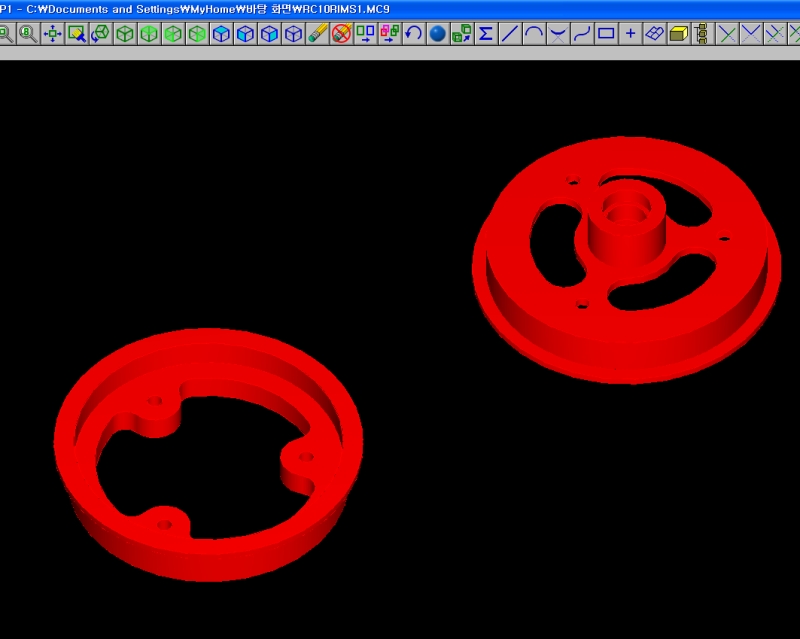

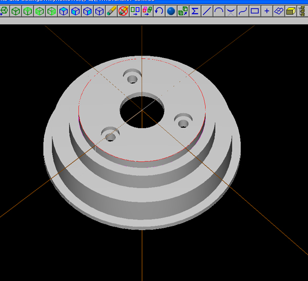

and, the rest are rear rims 3D design.

i wish i has a bit more input here, cause this is a great project that im sure will sell really well..
my suggestion, and i dont know if anyone else will agree here etc..
Make a 2.2" Front/Rear Rim Set, with front and half backs, to use modern tires, on a classic rc10 1/4" axle.
1.9 and 1.6 Tires are impossible to find, other than some tamiya models etc. There is obviously the resto crowd that will love these rims in the original size... but having them in modern size wheels would be incredible too i think.. just my 2 cents..

as mike said, 1.9 and 1.6 tires are hard to find. but, it'd be nice to get a set of these for the original rc10. my only suggestion would be, if possible, to add the jelly bean slot's to the inner rear rim. that way when they're put together, you can see through them..... just like the fronts. if it's not possible to make them like that, you should just make them 1 piece rims instead of 3. then it shouldn't be an issue.

100 sets might be a tough sell, but possible.

anyone back on topic, definetly see through "jellybeans" would be sweet for the rears.

i know one thing. i wouldn't even waste time making just outer wheel halves. anyone who is gonna shell out as bunch money is not going to attach them to an old set of inner hubs. and with how hard new original rims are to find (rc10's anyway), and expensive when you do, i don't think they'd be a huge seller. a complete 1 or 3 peice wheel would be a much better investment, in my opinion.

o.k you guys are going to 2.2". I'll care of thatmikedealer wrote: 1.9 and 1.6 Tires are impossible to find, other than some tamiya models etc. There is obviously the resto crowd that will love these rims in the original size... but having them in modern size wheels would be incredible too i think.. just my 2 cents..

thanks. I agreedscr8p wrote:i know one thing. i wouldn't even waste time making just outer wheel halves. anyone who is gonna shell out as bunch money is not going to attach them to an old set of inner hubs. and with how hard new original rims are to find (rc10's anyway), and expensive when you do, i don't think they'd be a huge seller. a complete 1 or 3 peice wheel would be a much better investment, in my opinion.
