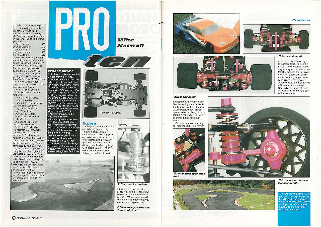

Post by Jirka »
This is a scan from RRC 1991-04:
