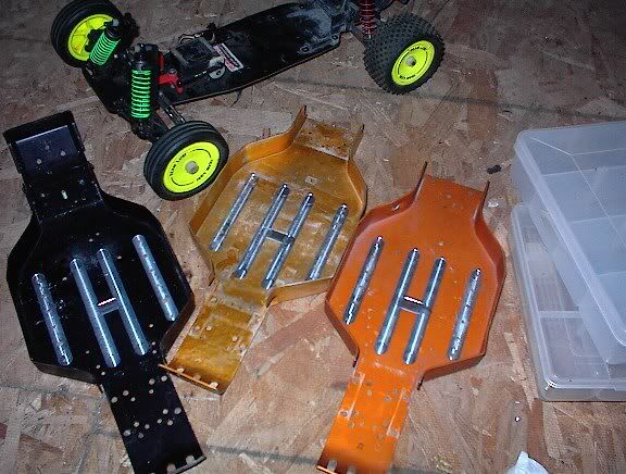

I milled mine with a 1/2" slot at the depth of a washer. Took some measurements off of my worlds tub and they turned out pretty good...IMO.

Those look nice, Klavy. To anyone itching to try this, just don't make the mistake I did in highschool; trying to mill a used and bent chassis. The slots got deeper as I went along...
