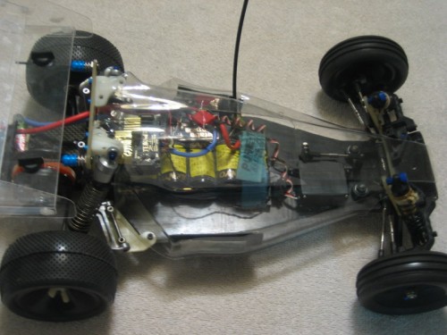

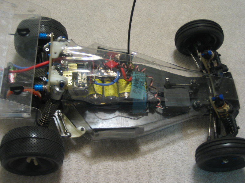

Re: Old is New Trailing Arm Project
Here's mine. Its a bit different now. I'll have to update the pics.
I've always loved trailing arm cars too. I thought it would be cool to do a mid motored one.
What I found with my trailingarm racer was that it's difficult to get enough suspension travel without running into extreme angle or angle changes.
I Think the solution would be to use longer arms but don't have the tools to make something descent.
