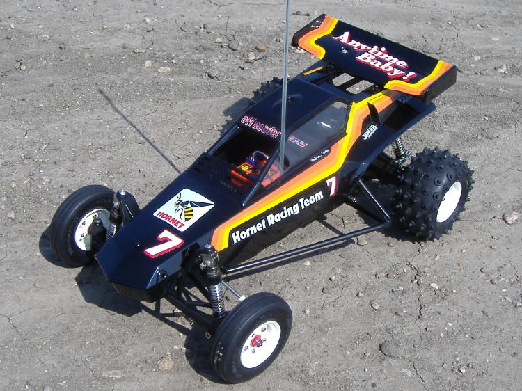

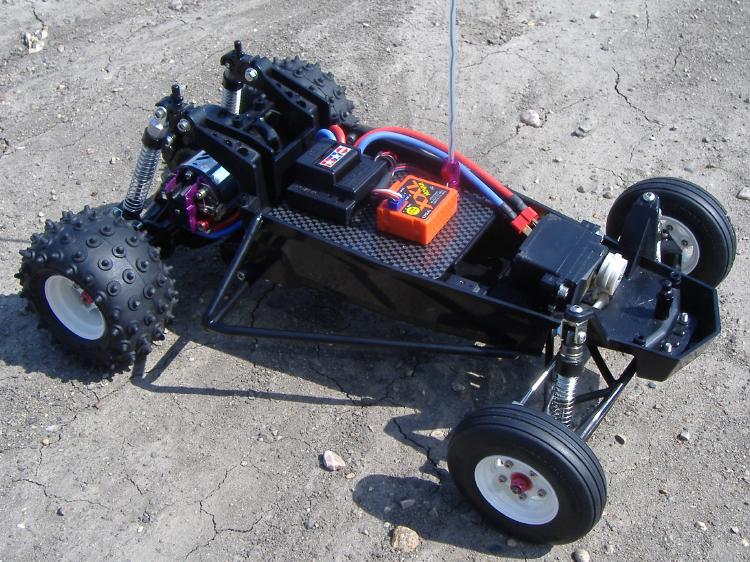

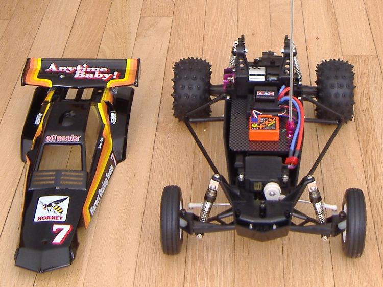

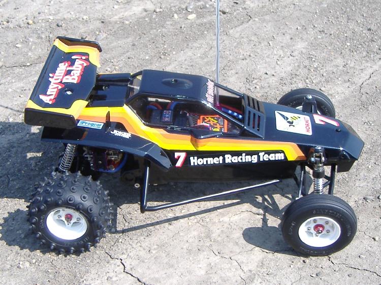

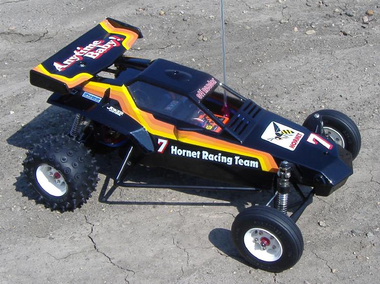

Finally finished my Hornet
Integy Mini-T Rear Oil Shocks on the front w/Super Hornet A-Arms
Stainless Screws from RC Screwz
Made a radio plate
Full ball bearings
Stock 540 armature in a HPI motor can(stripped and polished)
Stock esc with: Novak wires, Deans plug, rewired so only 1 connector is needed to connect to the RX.
Aluminum ant mount
Made a radio plate
Full ball bearings
Aluminum ant mount

What do the super Hornet arms do? Do they widen the front track any? It looks like the increase the wheelbase slightly as well? Thanks.
- Nouseforaname
- Posts: 32
- Joined: Sat Mar 06, 2010 12:18 pm
- Location: Bull Mountain
Re: Hornet
They widen the front track, and have a lower shock mount, those shocks would not fit with stock arms.losiXXXman wrote:What do the super Hornet arms do? Do they widen the front track any? It looks like the increase the wheelbase slightly as well? Thanks.
Wheelbase stays the same.

i have to ask is that a homemade plate or can u buy these im working on making a similar one for my frankenhornet project...
