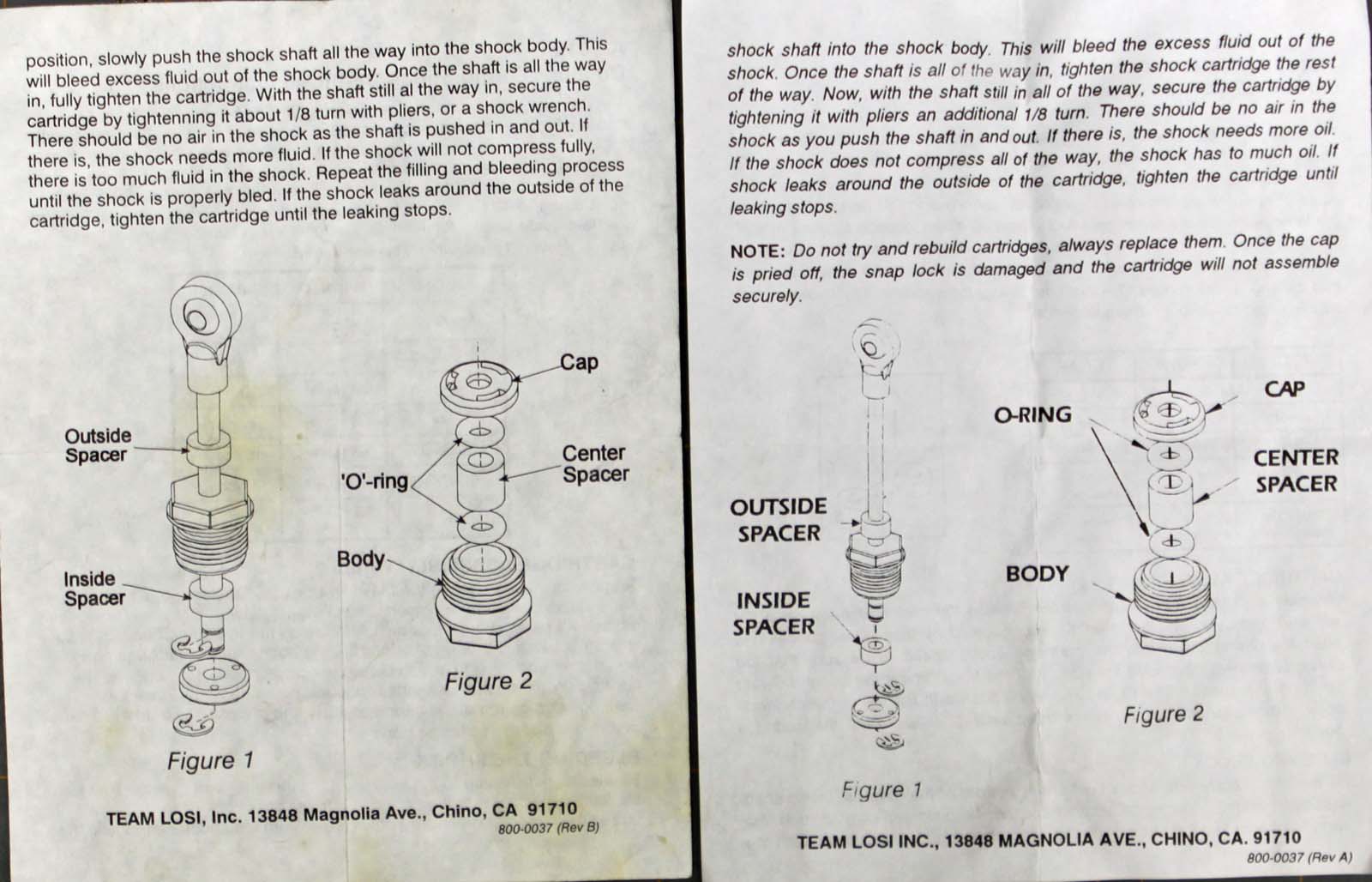

the 5015's should come with 2 spacers of different heights. Here is a scan of the 2 instruction sheet revisions that I could find that shows where to put which spacers. Interesting that they show different combinations for different vehicles despite them all having had the same cartridges to begin with.
I'm not sure if the newer 5015 packaging includes the sheets anymore.

I looked through my parts box and just found a newer 5015 package, with the turquoise header card. It has a revision"C" sheet which only contains the "Cartridge Assembly" paragraph and figure 2 from the original sheets, no info on where to use the spacers, but it does include them, and they are still pictured on the stock photo on horizon.com
